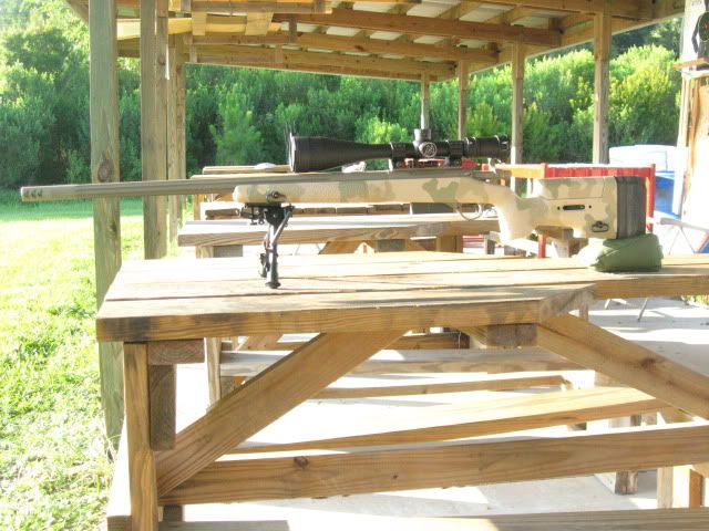

After quite a long wait on all the parts my new rifle should be here next week. Heres a picture.
[img:center]
[/img]
Specs: Stiller pred action, Broughton #7.9, - 9c twist, Thruster Break, finnished at 28", 6 deep flutes, Rifle basix, Seekins DBM and 20 MOA rail, McM adj A-5, flush cups left side. Cant wait !!!

what kind of coating did you go with?
What color is that?
Re: New stick 7 WSM
I believe the color is Dark earth lightend up a little with a little tan mixed in. I'll ask Chris what coating he used, I have no idea. That was left up to him. I'll get some closer pic's when I pick it up and get optics and other dodad's mounted

Good luck with it brother. Great looking rig, hope it pleases you as much as it does the eyes.
Re: New stick 7 WSM
That is a nice looking stick. I have the same stock coming soon. Seeing yours makes me glad I went that direction.

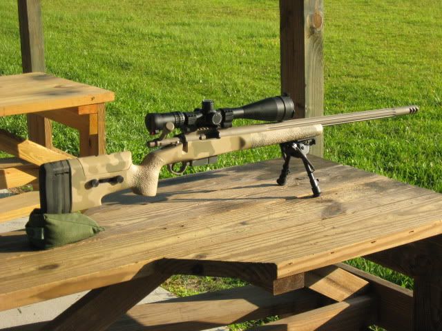

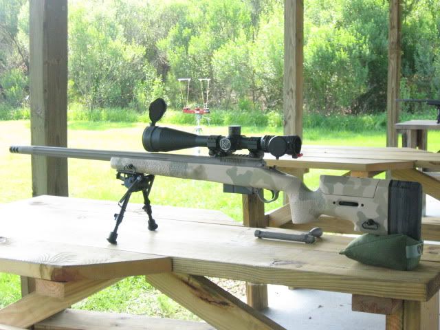

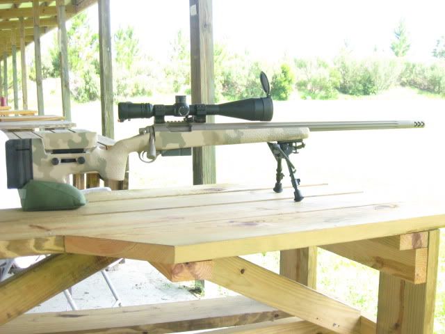

Went to the range this morning to find the max charge weight. Loading in .5 grn increments I managed to accomplish this in three rounds. 69 grns IMR 7828ssc under a 162 A-max loaded at 3.025 running 3200 fps. Glad I loaded there and didn't pre-load a bunch. Now that I have found the max I'll be back at the range Sunday looking for a good load.
Enjoy the pic's

Sweet. Right now I am trying to decide between a 260 or 7wsm for my next rifle. I had pretty much decided 260 but everytime I see a 7wsm and the ballistics it is capable of I drool.
Now I will have to get both!
Looking forward to your range report.
