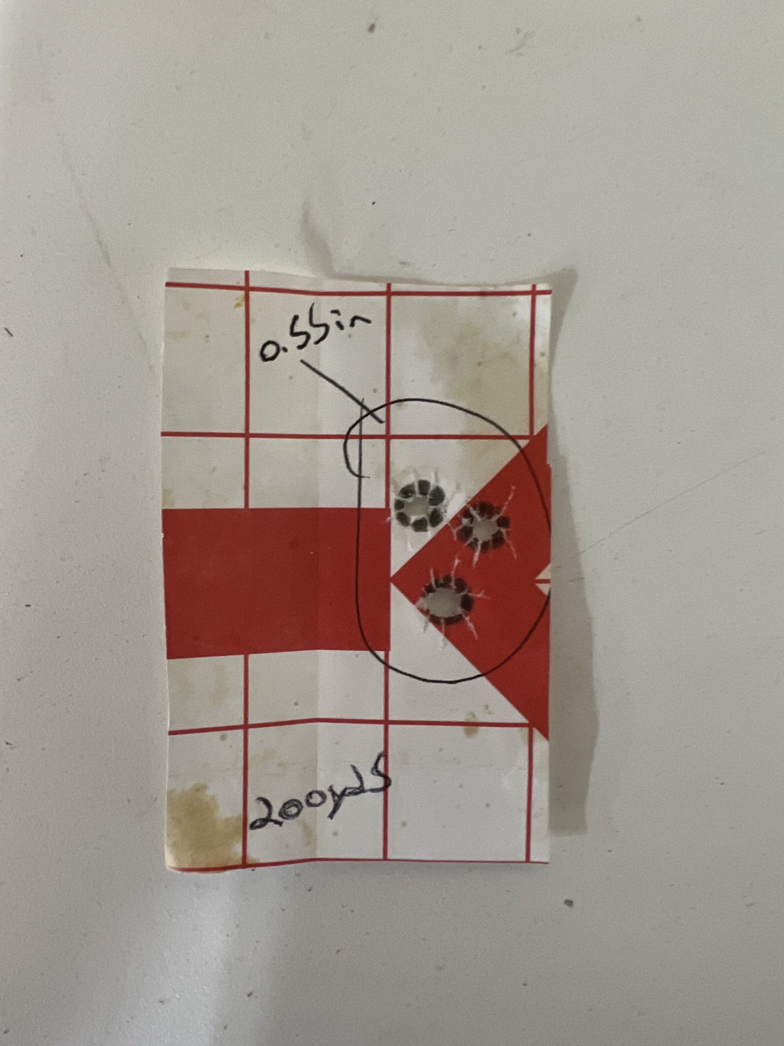

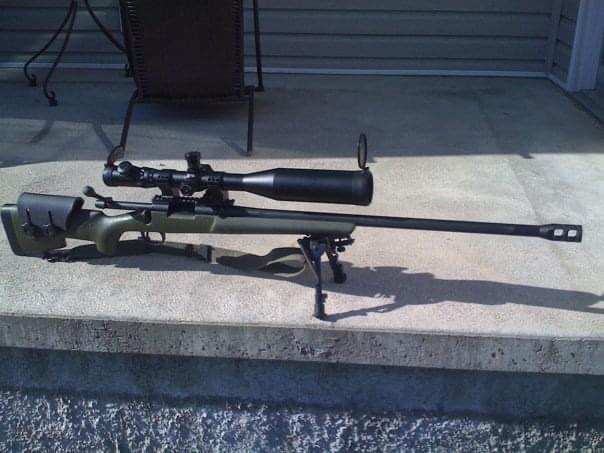

My first bolt gun is Remington 700 Tactical XCR it’s the best out of the box gun I own. Can shoot 0.55” group at 200. Custom rifles are awesome but out of budget for me
What optic is that? Surprised the scope clears the barrel with such low rings 😄
Hell of a rifle to hold consistent 1/4 moa at 200 yards though
It’s a budget scope Millet LRS 6-25x56. It’s got 35mm tube so I just use the rings it came with their super high hence the kydex cheek rest
Where are you getting the barrel? You can find prefits at various places in stock,

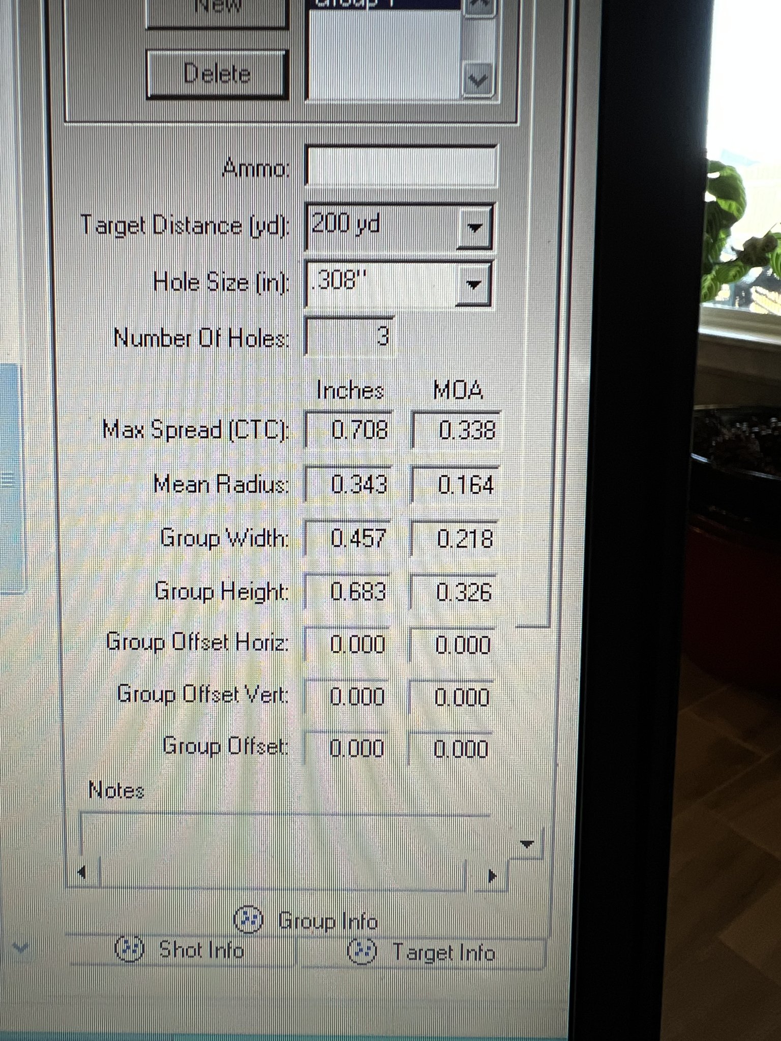

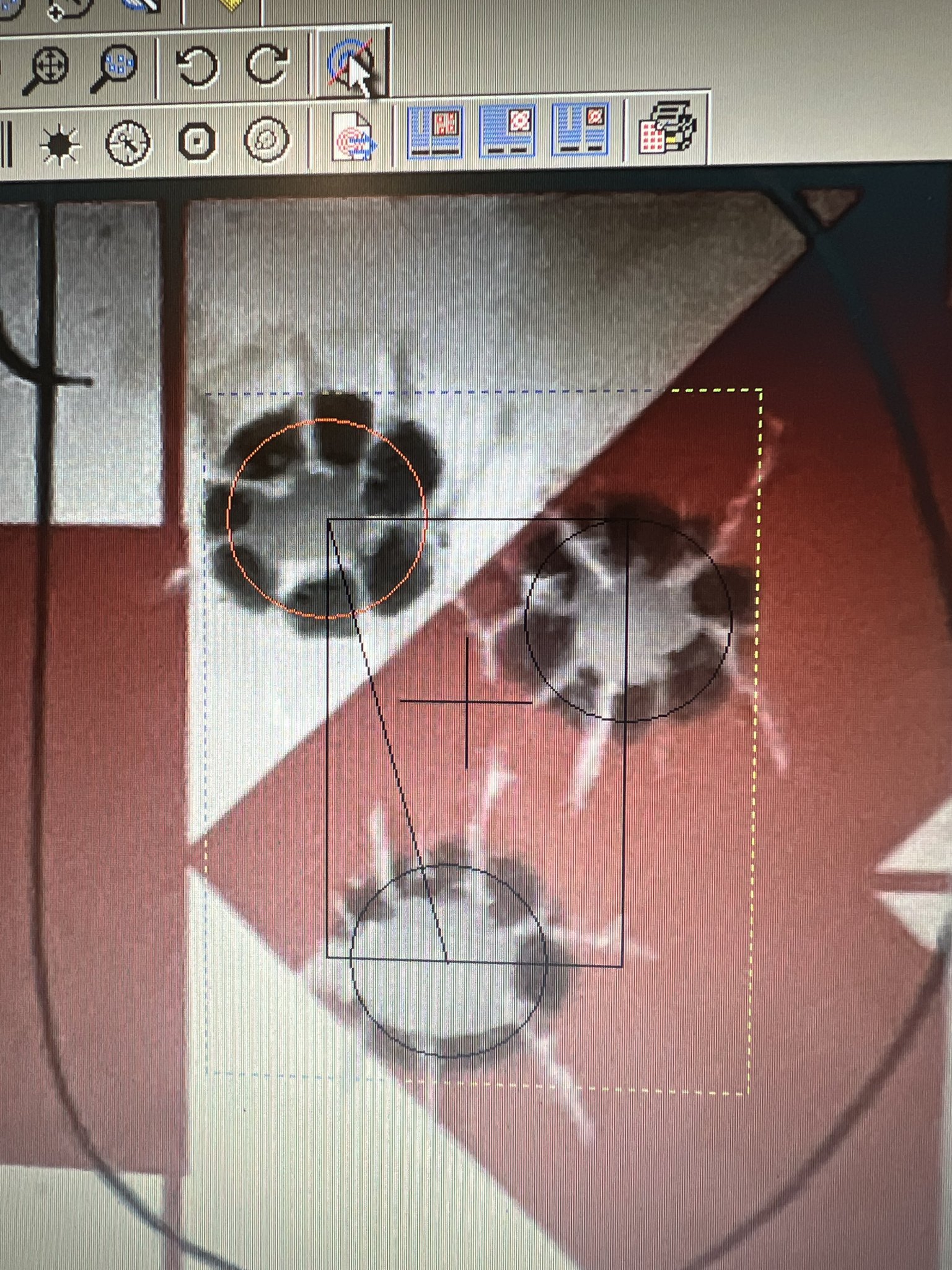

Ya post pics of this "0.55” group at 200" or .... :)
Better yet, post pics of four or five of them on the same target
