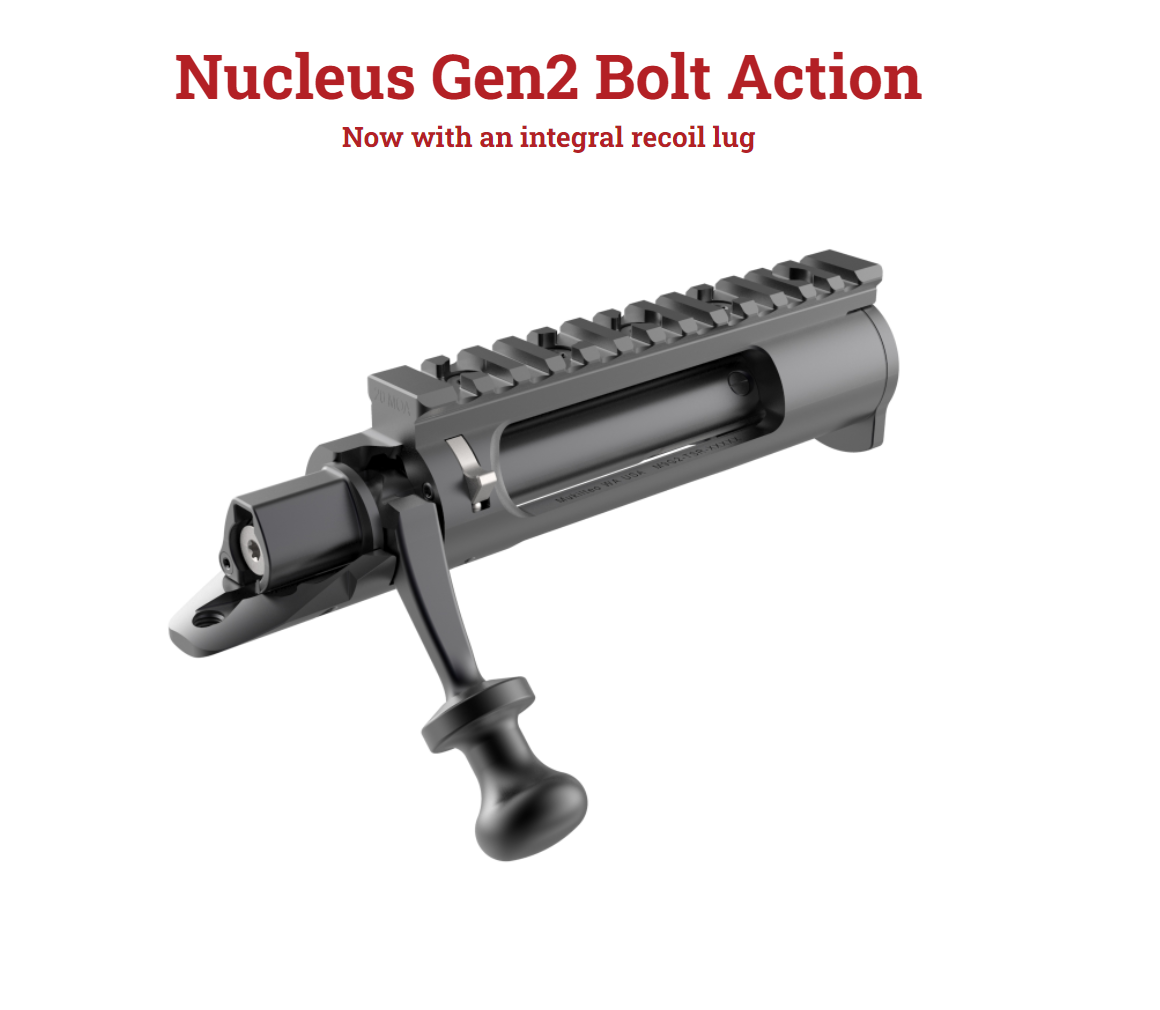

I thought they switched the "new" new Gen 2s to integral recoil lug with the new right side bolt release? Website error or perhaps I'm mistaken. Could've sworn I saw it in a video too.
Interesting, I pulled up ARC’s site before I replied to your post, it still says keyed lug. Maybe it hasn’t been updated, couldn’t say.
Reactions: Evintos
Just remembered where I saw the info about the Nuke integral recoil lug now; it was in the ARC Black Friday thread.
Starting from this post
Oh nice, good find.
OP, I will now also recommend the Nucleus lol. Bear in mind that ARC prefits are harder to find than Origins, but by no means impossible. They’ll also take small-shank Savage barrel-nut barrels, as will the Origin and TL3, plus however many other actions.
