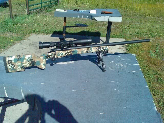

Finally got my rifle all screwed together, and painted up this weekend.
Specs are:
Falcon 4-14 FFp
EGW 20 Min. One Piece Base
Burris XTR Rings--Lows
Tubb Speed Lock, and cocking piece--factory one crapped out on me.
Winchester SA Trued, lugs, etc.
Badger Bolt Knob--Installed by US Handgunner
Bartlein 1:9 #6
Manners T4, Duracoated by me
Harris Bi-pod
Williams Bottom Metal
Bedded in Devcon Pic:
Forgot to add chambered in 22-250 Rem.

As usual pics don't do it justice, these are taken with a cellphone, it blends in quite nicely.

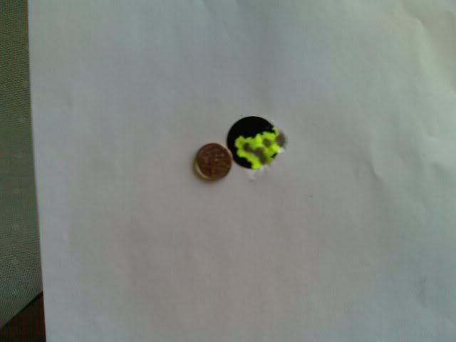

And After load testing, 33.4gr H380 under a 69gr SMK=

Not too shabby, only took a week for the smith to chamber, true, and cerakote the barrel, action, and bottom metal. I am very pleased with it.

Thanks, prairie dogs and yotes beware. This is my first aftermarket barrel, and all I can say is wow! So much easier to clean, hardly any fouling, smooth as silk. The wait was definitely worth it!!

Nice paint!
How did you do the pattern? Did you cut out vinyl by hand, or did you use tape?
I cut vinyl on a similar paint job. It took hours cutting the paint.
Re: "New" Toy
<div class="ubbcode-block"><div class="ubbcode-header">Originally Posted By: HiTechTactical</div><div class="ubbcode-body">Nice paint!
I cut vinyl on a similar paint job. It took hours cutting the paint. </div></div>
Thanks, I used stencils from this guy----catalog.bulldogarms.com He has many patterns to choose from.
They come off very easy and leave a nice sharp edge. They are pretty cheap too, ship fast.
Basically, spray a color stick on stencils, spray another one, stencil...etc. This is my fourth paint job. I had to redo this one, because it came out shitty the first time. Thanks for the comment!
