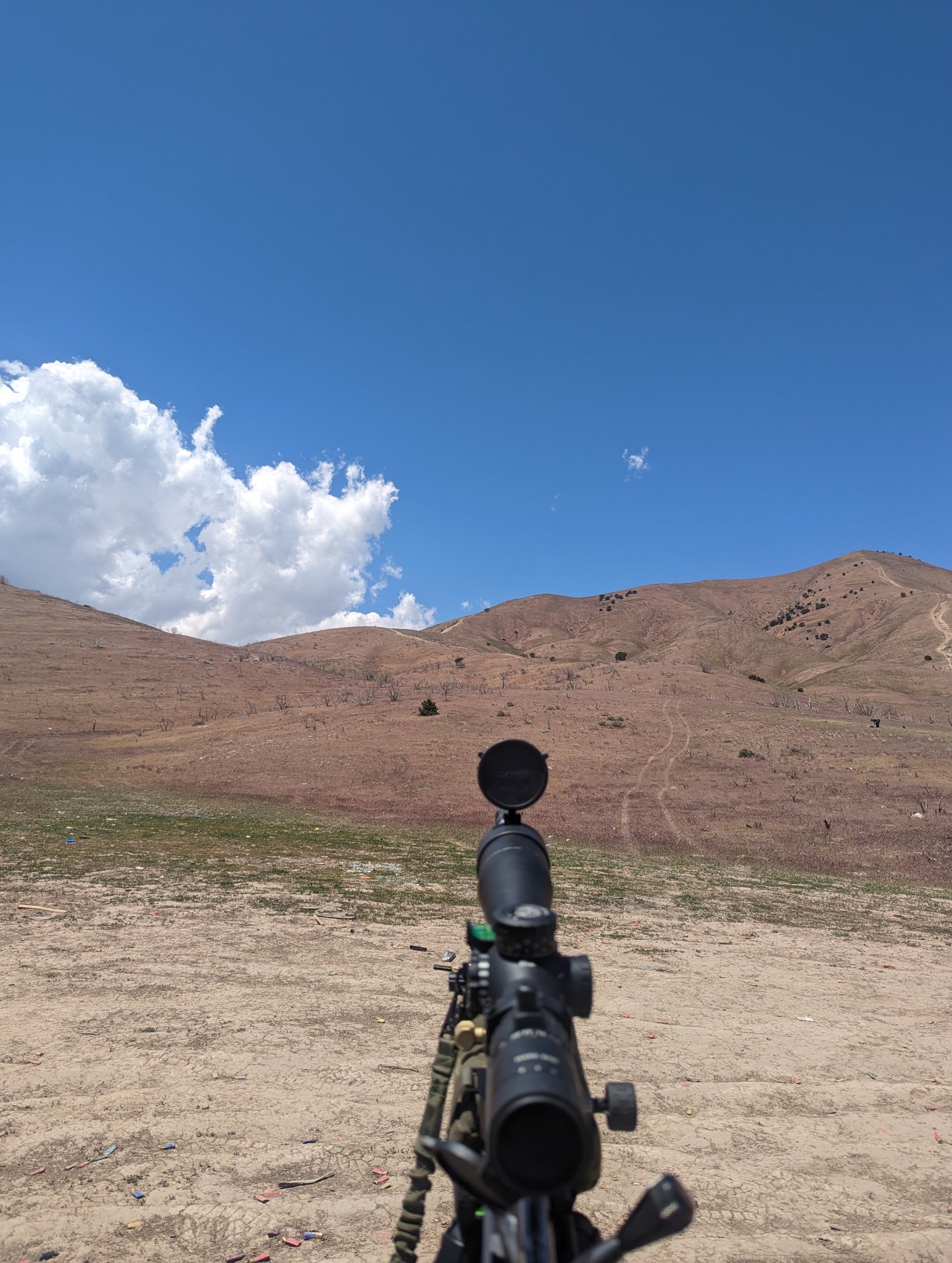

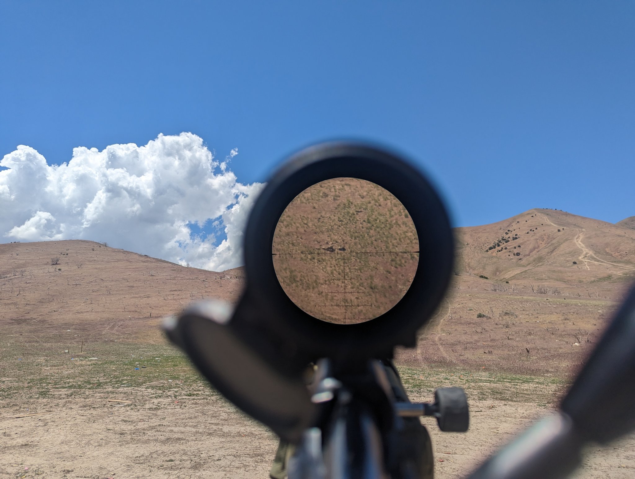

I just bought one but I haven't had time to get it out other than shooting it across the fields by my house.
I have the regular version also and my ab version out ranges the original by several hundred yards on everything. Neither are a slouch though
Yup confirmed 12 degrees at 1150 first round hit dead center on an 18" tall rock.
Most likely would have missed the rock if it wasn't calcing for inclination

12 degrees isn't much, but good shot 😎

Was recently able to get out and find my laser is centered in the bottom-right quadrant of my reticle, and data was matching Kestrel very closely.
My lasers centers in the exact same spot on both my ab version and regular version. Interesting 🤔
Yeah 12 degrees isn't much but .3 mils is still around 12.5 inches at that range..
