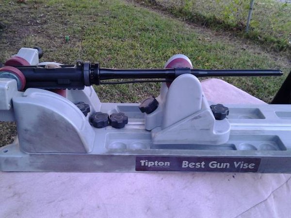

    Dura coated the thing!
    We will see if worth the preparation and expense.
    Followed thier game plan looks good.
