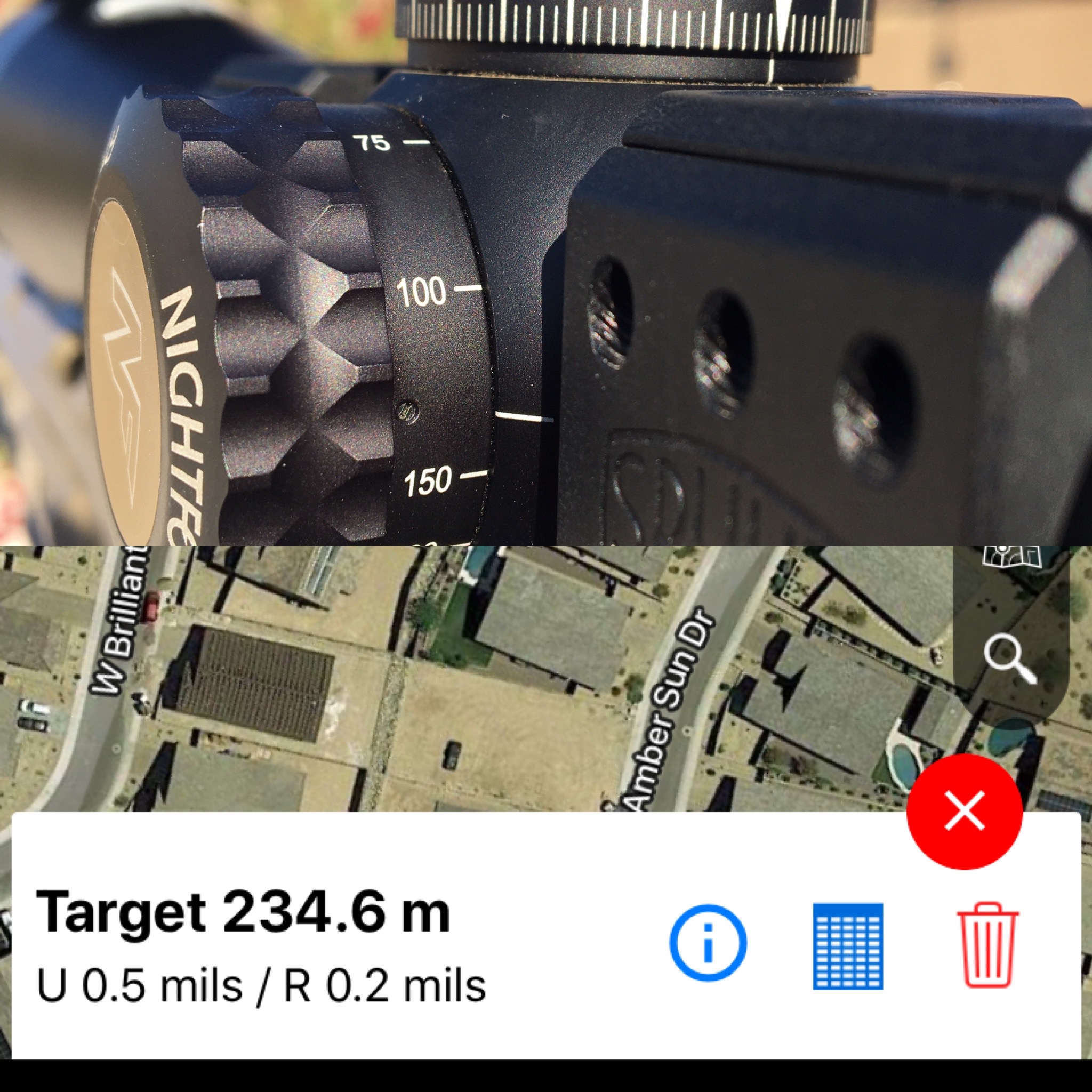

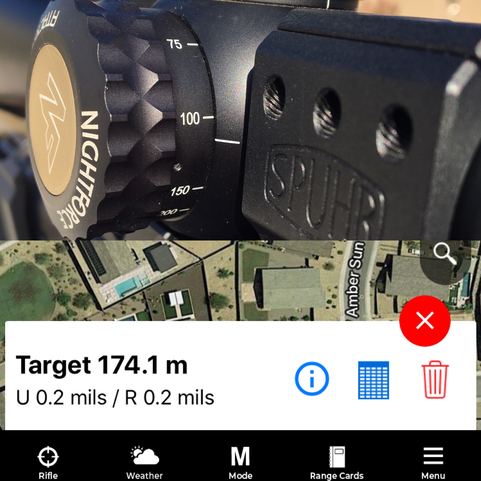

Just picked up 5-25 F1 ATACR and the parallax(reticle movement free) is off. At least when it’s parallax free, it’s a clear image.
Regardless, that’s going to make PRS tricky. Two targets. Distance between the targets is 60m and yet the parallax didn’t even change 60m in accordance with their marking. “Markings are for reference only.” That’s a big negative. That’s not even “reference” worthy.
I’ll hit farther distances to see what it does.
