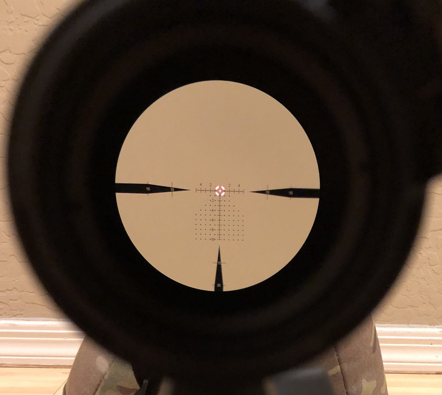

- FOV is a bit cleaner in appearance as well, if you don't like a busy tree style reticle, although the NF FC-DM reticle is by no means overly busy or cluttered.

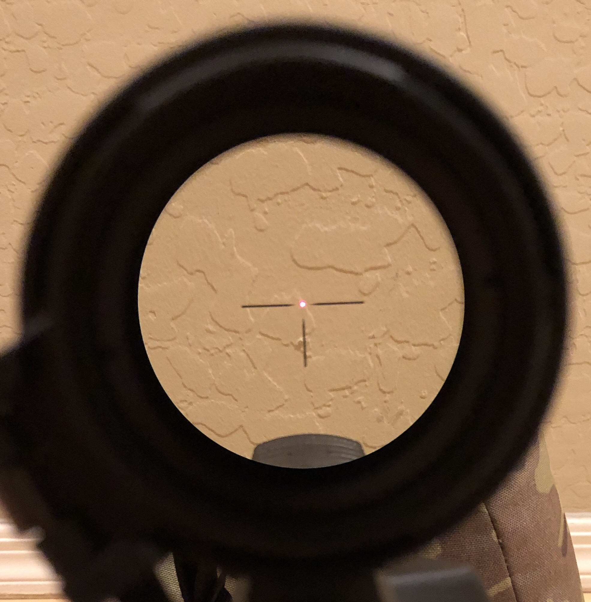

I think you'll have to boil it down to which options/features you prefer, as well as reticle choice and focal plane. The ATACR reticle, being FFP, changes with magnification, but the reticle stays the same size *in relation to the target* irrespective of magnification - whereas the Kahles reticle, being SFP, always stays the same size, irrespective of magnification, and reticle/holdover values change relative to the magnification setting. I think of the Kahles SM1 as a much more refined Eotech style reticle, with elevation holds and a very fine center dot, which is better for pinpoint aiming vs. the ATACR center dot.
