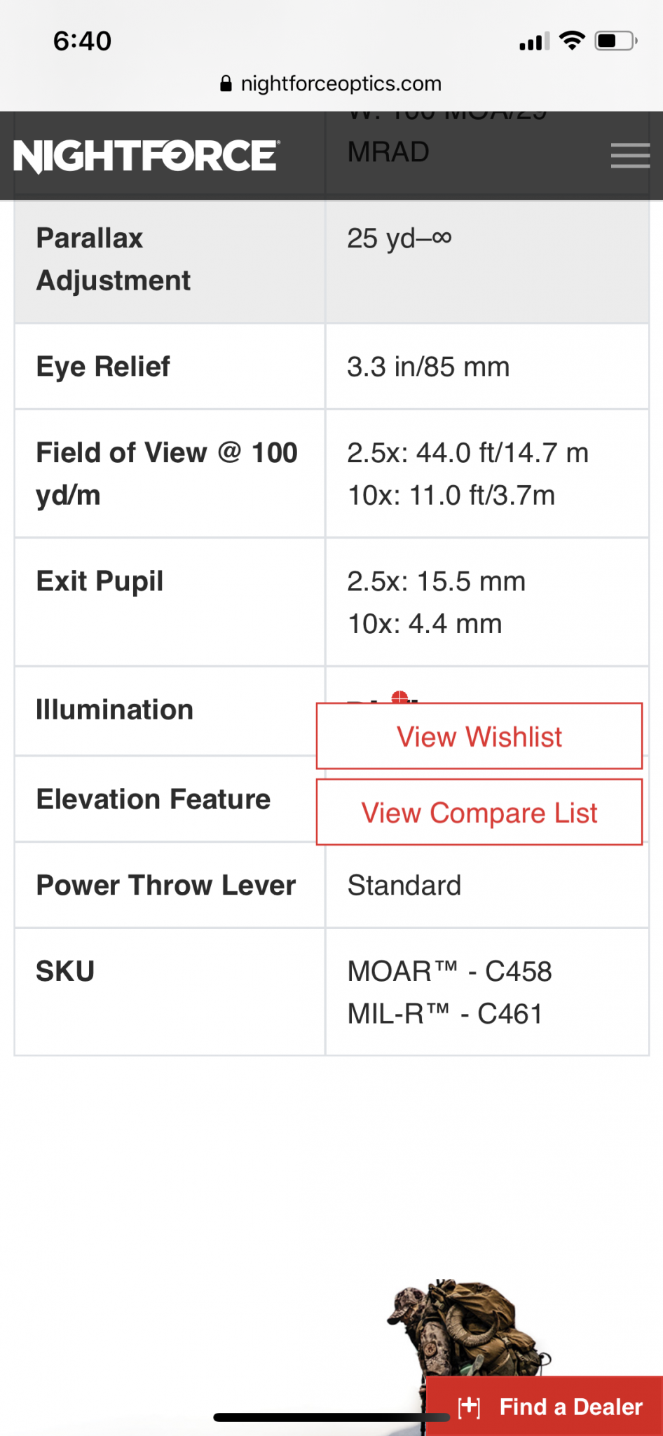

Just got my brand new NXS 2.5-10x42 Mil-R the other day. Running into the exact same issues that OP (and MANY others have run into with NXS) scopes and it is a bit disheartening to see so many people referring OP to fundamentals of marksmanship and setting scopes up rather than address the elephant in the room, which is the finicky $1600 scope.
Over two days of shooting I've established the following. The NXS is difficult to properly set diopter up on relative to other scopes, in one part thanks to the ridiculous amount of diopter adjustment turns, and another part due to the difficulty of turning the adjustment itself. Combine that with the vague manual that doesn't specify the parallax setting for the diopter adjustment, on a scope that certainly has a great deal of interplay between the two adjustments, you've got a recipe for a difficult diopter setup.
Now combine that with a bizarre behaving parallax adjustment, and what after some research I've determined is a common NXS issue, an inability to eliminate parallax and focus the target at shorter ranges (150m and in).
At a VARIETY of diopter settings I was UNABLE to eliminate parallax at 100m, without sacrificing target focus. How is one supposed to get a 100m mechanical precision measurement out of their system like this? How is one supposed to do a 100m zero like this?
I've set up scopes before, and dealt with scopes that had broken parallax adjustments out of the box, and my NXS 2.5-10x42 is simply not a team player. Crap groups at 100m. Same day, and my AR10 with a Steiner printed sub 1" all day while the NXS couldn't get below 2", and was doing "parallax error" groups all day with 2-3 shots in a 0.5"-1" group spaced about 1"-2" from another group of 3-2 shots also in their own little 0.5"-1" group. Typical of parallax error combined with inconsistent eye placement behind the scope (the eh tier eye box didn't help much either).
Called Nightforce today, but no one was around. I'll try tomorrow, and hopefully they can provide some additional directions for setting this scope up, but so far I'm disappointed also in my NXS 2.5-10x42, and if can't get a parallax eliminated in focus image at 100m for purposes of zeroing and mechanical precision measurements, I will be letting go of this optic.
OP, I had the exact same issue. At 100m I could not get the target into focus without the parallax set at infinity, and this was done at a VARIETY of diopter settings. The resulting parallax error certainly reduce the quality of my groups. Also to the fudds claiming that lower magnification results in better groups, that simply isn't how precisely repeatable POA works.
When the diopter is properly adjusted, the side focus setting that removes all parallax error from a given target will also focus that target unless there's something wrong with the scope or the shooter's eyesight (which glasses should fix).
I've been researching this all day, and LOTS of NXS users report being unable to get parallax eliminated and the target in focus at 100m. Plenty of cope posters say they just zero and group at 200m or greater, which IMO is NOT an option, as the extra distance introduces additional variables that result in a less than optimized zero/group measurement, not to mention difficulty of finding a nice indoors environmentally controlled 200m range.

I’m going to add my not asked for .02 and say this is a diopter adjustment issue. My last 2.5-10 focused just fine at 100. Actually less for that matter. Attachment is straight from the horse’s mouth. I just bought another and will probably forget to weigh in after setup. If you want one I’d buy one. They’re drying up and may not come back.
