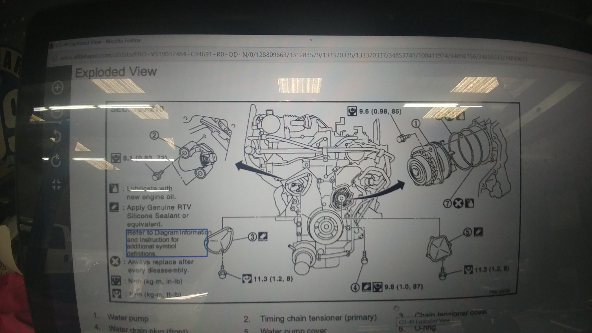

    Tell them to quit being dicks and check the water pump. If it leaks it will leak into the oil. Repair procedure does not require timing cover removal. But if high mileage a new timing chain might not be a bad idea.

    That is one stupid ass water pump design. hopefully it is the water pump.

    Pretty common water pump design now a days. If you notice it has two o rings or "gaskets" which is not where they leak. they leak out the shaft seal.
