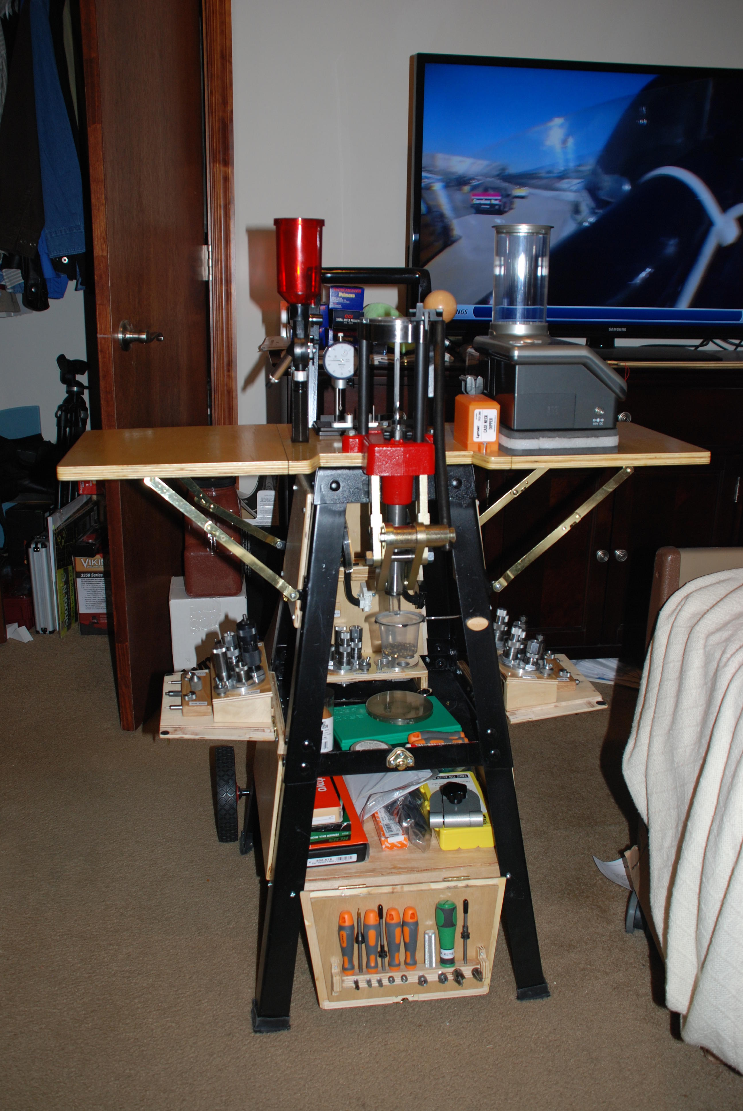

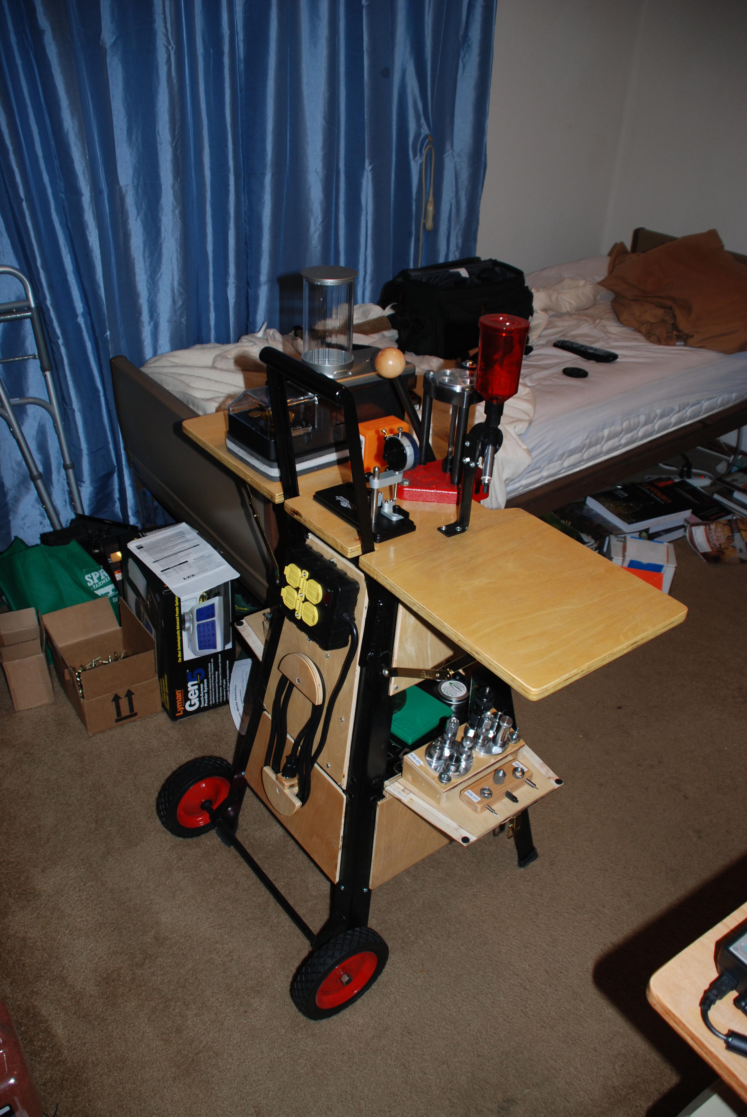

About 1.5hrs and voila…
from one 4'x8' sheet, I have enough wood left for 2 or 3 more, going to build a modular system so I can have everything else ready to roll and on the same height… Thank you to everyone who chimed in on the thread, you were all tremendously helpful and I appreciate your time.

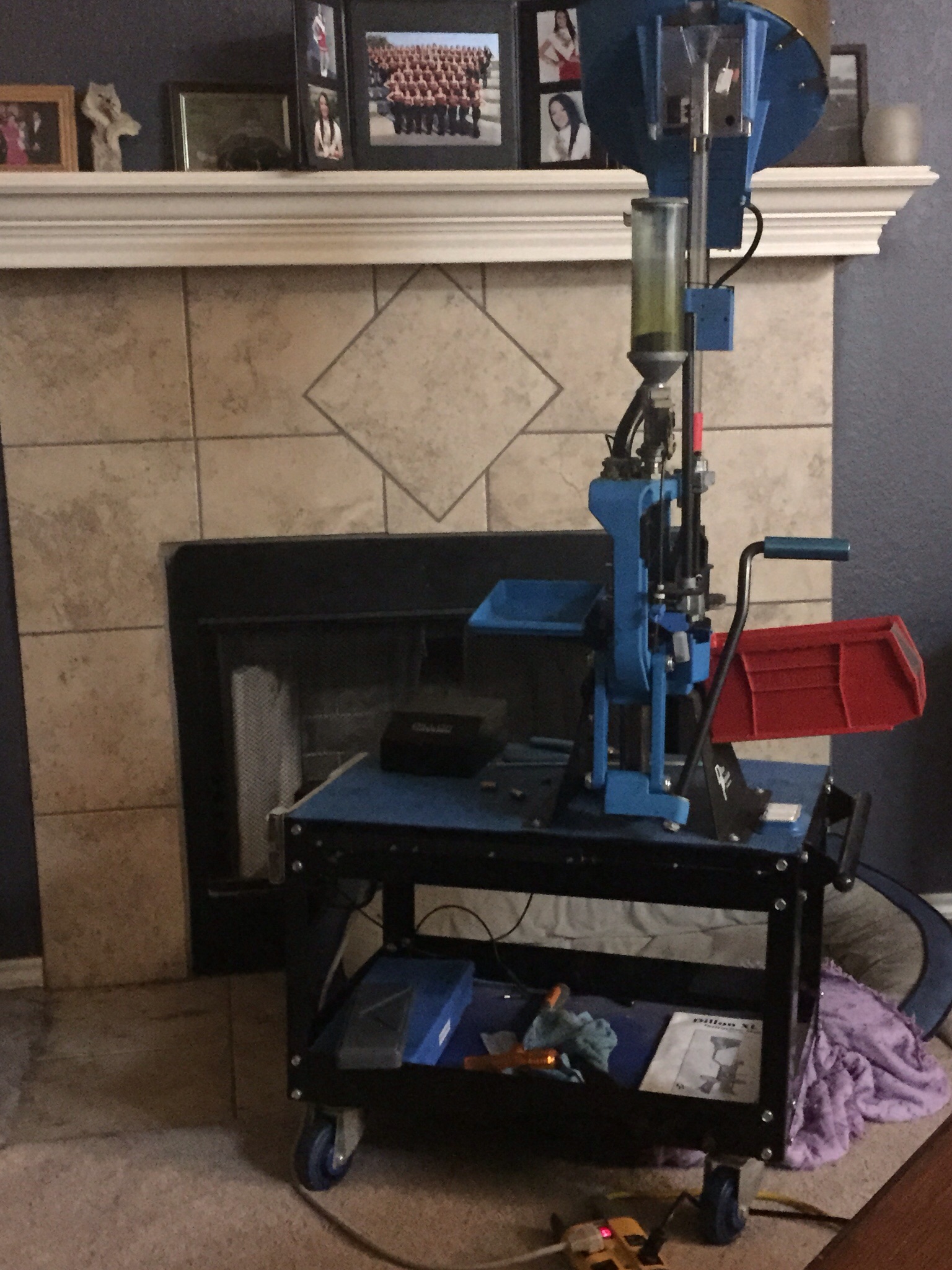

This is what I came up with, I like to load while in the air conditioning and on the couch. Cut the height of the cart down to the right level when sitting and wired it for power. Loaded well over 50k rounds with this set-up.
