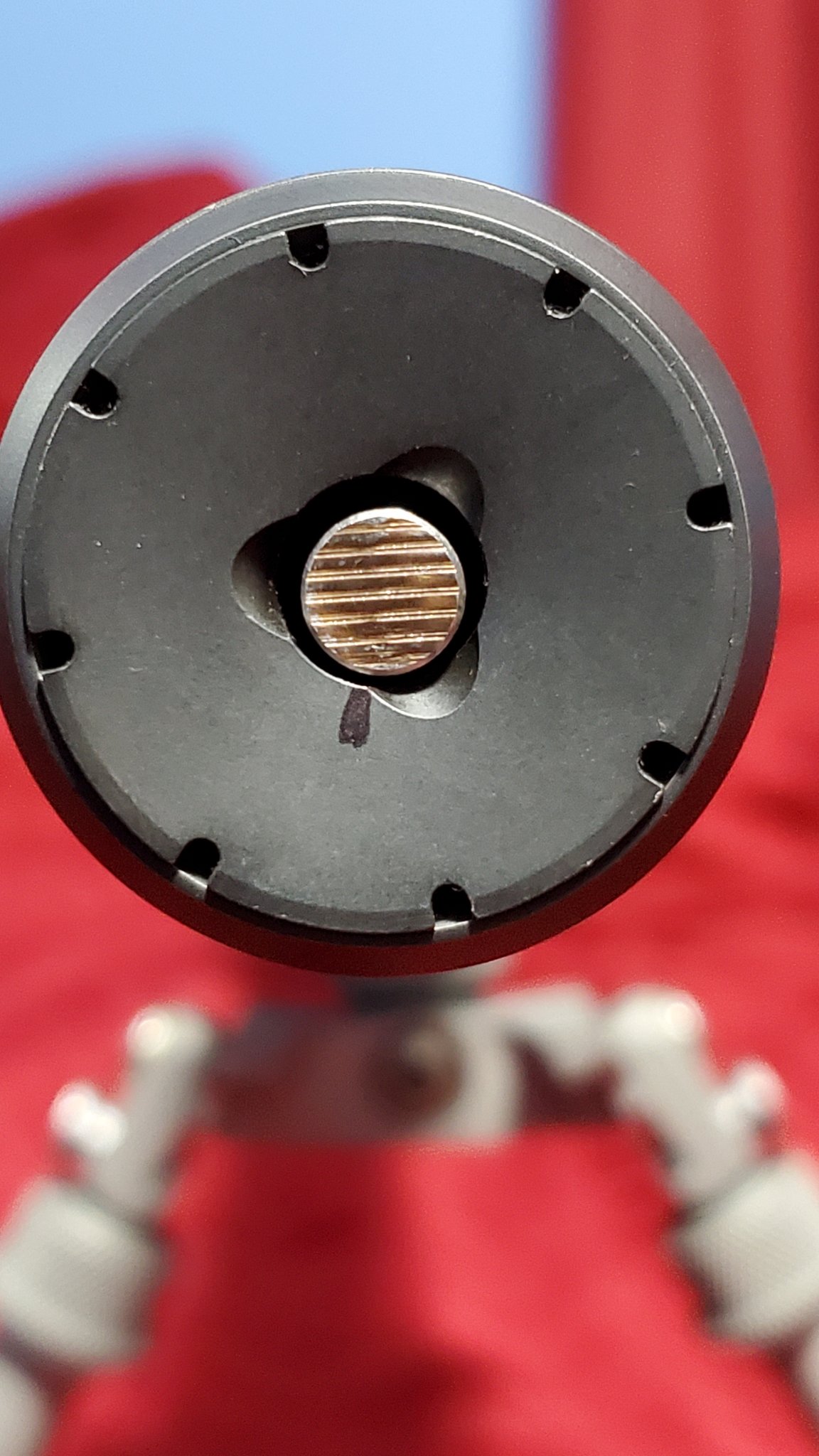

    If your can is not concentric to the bore, but the alignment rod is in no danger of touching the end cap, would you worry about it?
    Does it effect accuracy?
    I have sent my can in twice, first time it was hitting the end cap, and came back better, but not right. Second time, I just wanted it right, and it came back just the same.

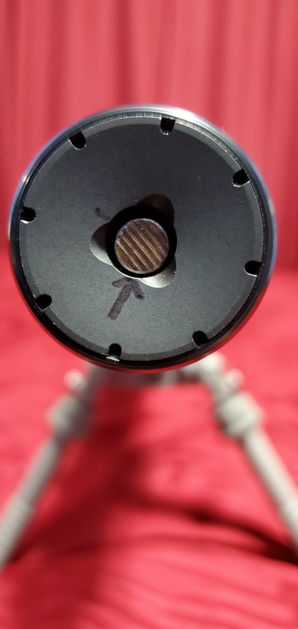

    This is with the barrel right side up.

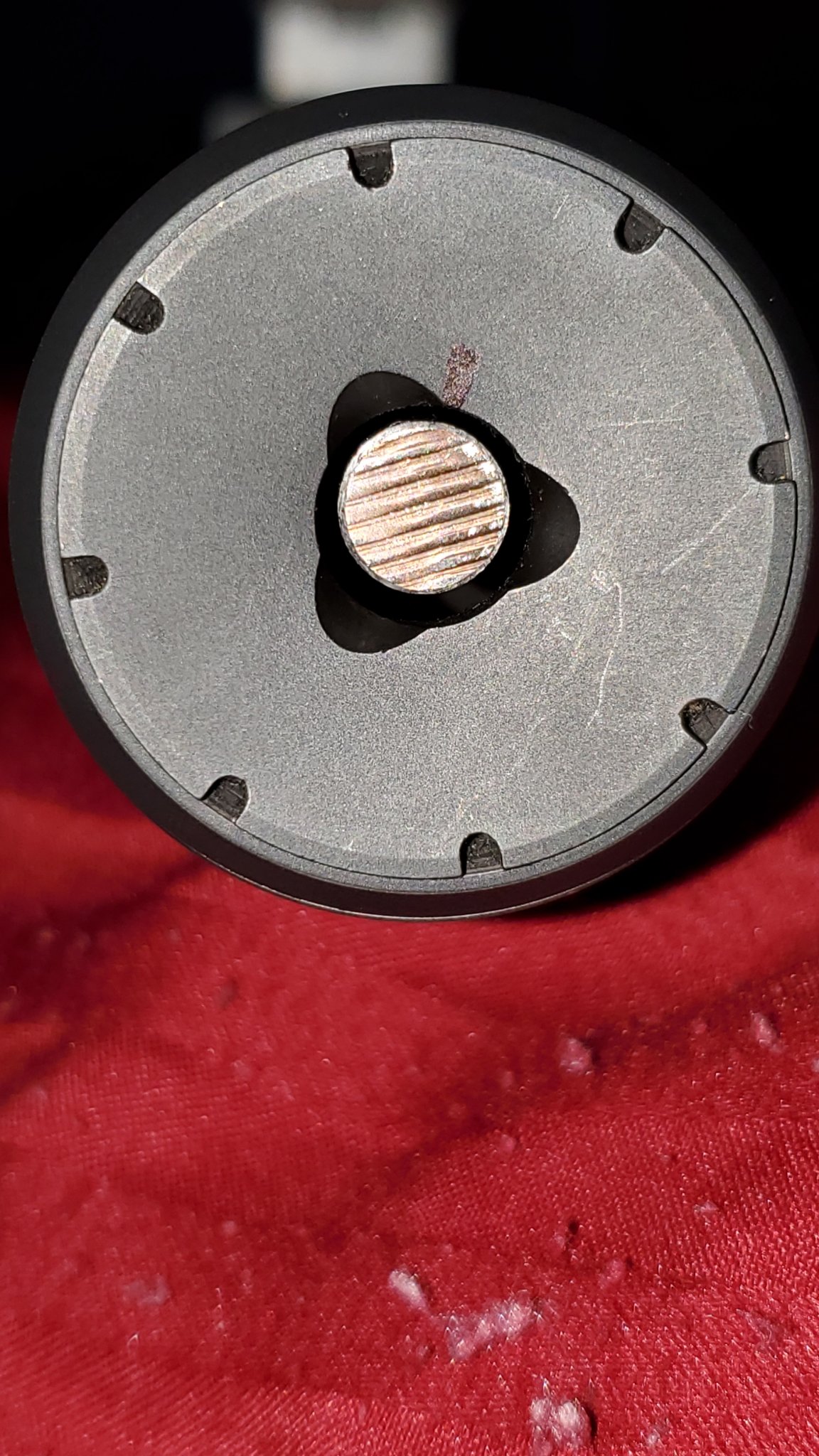

    Here I flipped the rifle over to eliminate a drooping rod, and it's still the same.
    Definitely not centered, but not going to hit either.

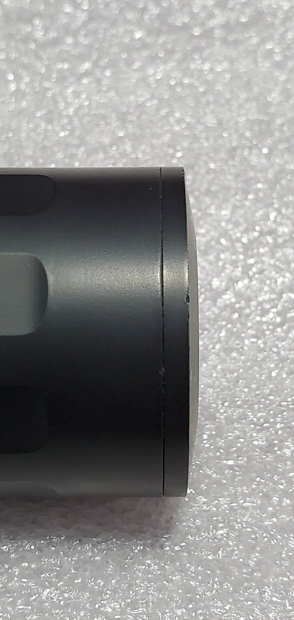

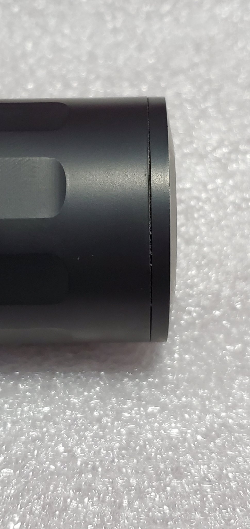

    The issues are hard to get on camera, but the gap is the thickness of a dollar bill.
    Then on the opposite side it's tight.

    You can spin the rod 180, and flip it around, it's the same story. I have probably done this a dozen times now. It's not the rod.
    You can feel the can wobble the more the threads engage.

    On this particular product, it's a monolithic welded core that has a titanium tube pressed onto it. Due to the nature of the welded structure, it can have some distortion to it and that's why the tube may appear to have a gap where it meets the back cap. A light chamfer on the edges of those parts can make it appear worse than it is and cerakote can mask that or make it look worse. In any case, I'd have to see it in person to say if there's truly something wrong with it. The seam will always be there, but we definitely don't want it to have a gap for visual reasons, that's for sure. The role of the tube on the Sandman-Ti is to hold the engraving and to add hoop strength.
    On the alignment, it's good to know the following about the Sandman products. We EDM after welding to give it a nice, straight bore. The cap is placed on after this. The bore of the cap is oversized by the tolerance allowed in the runout of the welded structure. That's why it's typical on a Sandman cap to see this. If you remove the cap and see the bore rod isn't perfectly centered, then we know it needs help. The amount you're showing in your picture with the alignment rod is very typical for a long welded can. If a bullet is getting within 10-15 thou' of the bore wall of the cap, then you'll start seeing some POI shift or even precision issues. You're well within that based on what I'm seeing.

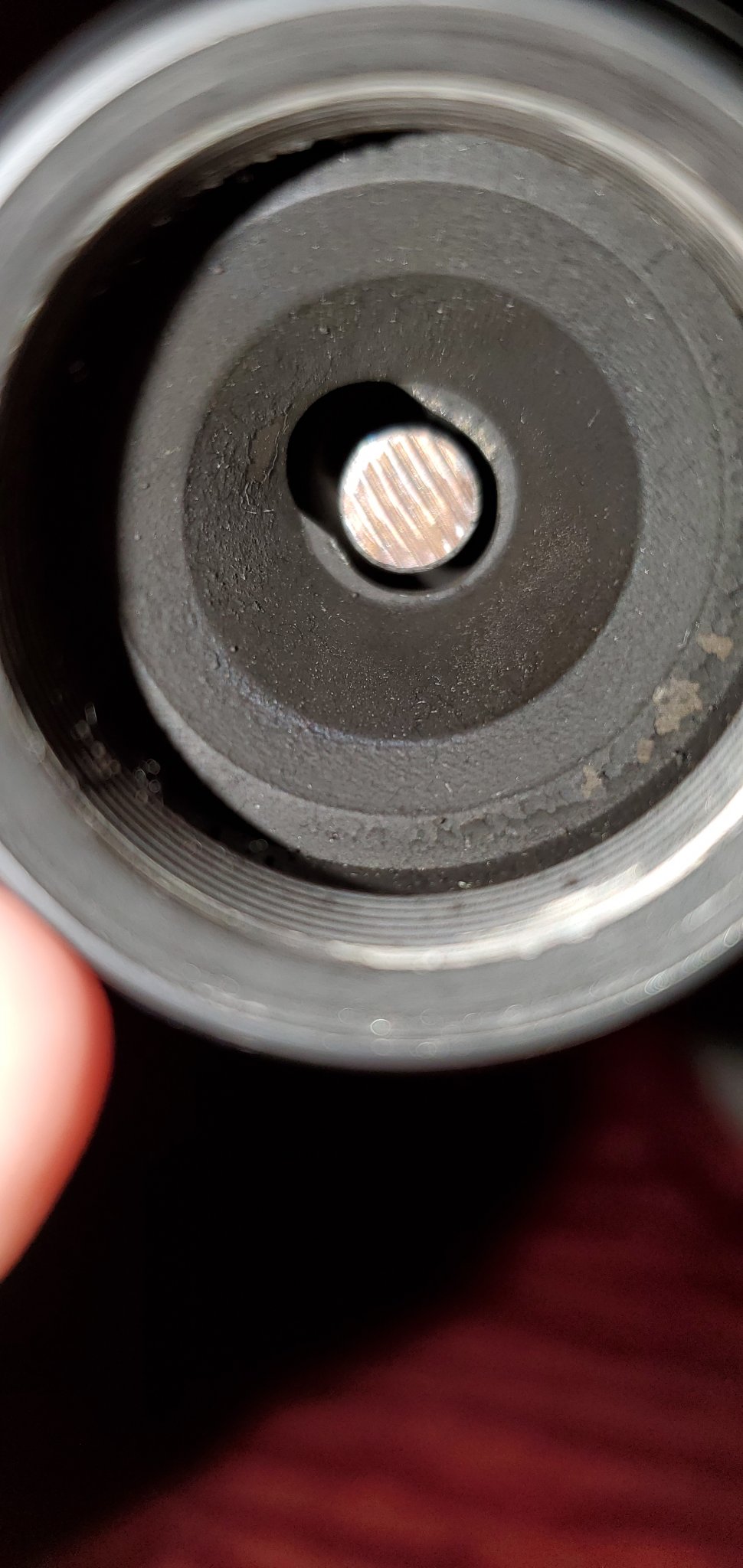

    Here are two more pics. One with the end cap off, the other is with the E Brake.
