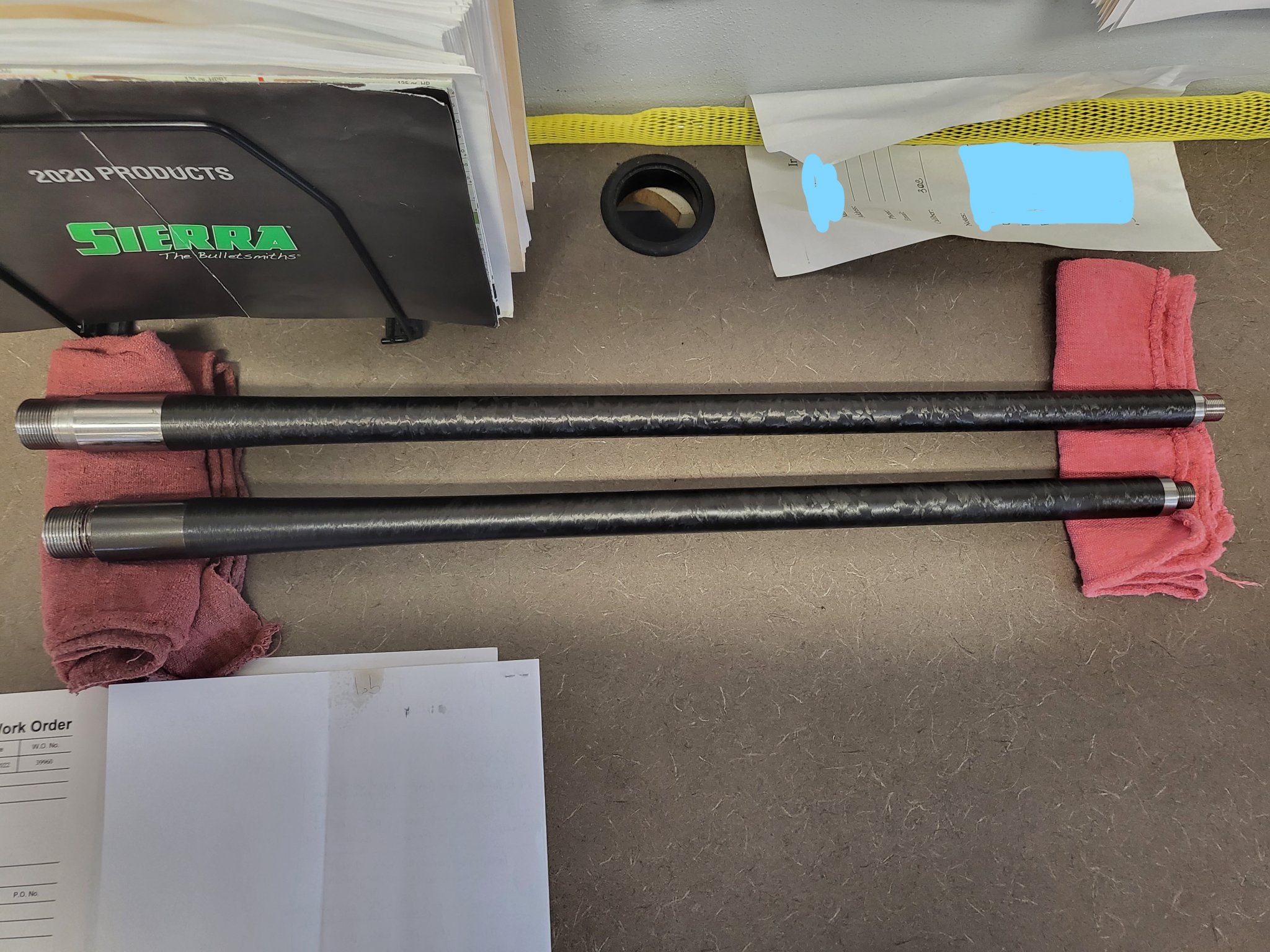

Guys I cannot tell you how many now this year but just had another customer send in barrels that are not ours. In the attached pic....the customer bought components (along with actions) and think the shop he bought them from did all the gunsmithing work. Shop recommended our blanks and customer went with it. Guns don't shoot. So customer calls us up and sends the barrels in for inspection.
The 30cal barrel is a button rifled barrel. Has 5 grooves but not 5R rifling.
The 7mm barrel is a 6 groove. We don't do 6 groove rifling on 7mm's. 4 groove or 5R only.
If you are buying guns sight unseen and or components and getting the machined work done before you receive the components. Especially if you are dealing with a shop you've never dealt with before......ask for the s/n of the barrel. It's stamped on the breech face of the barrel and gets lost when the threading and chamber work gets done. If you know the s/n you can always call us and confirm if it's ours or not. Also if you buy the barrel from us the s/n will be on your invoice as well. Record the s/n for your records.
Also most barrel makers don't s/n they're barrels. If the shop says there is no s/n tread lightly.
I bum for the customer because he is out money and has guns that don't shoot and we've got to be the bad guy to break the news to the customer when this happens.
I've even received complete guns in this year where the customer complained they wouldn't shoot etc...and upon inspecting the gun and trying to figure out what is going on we find out not our stick on the gun.
One shop and I won't mention names sent me not one...not two but six 30cal barrels all chambered in 300wm and the complaint was they don't shoot and need the barrels replaced. So when the barrels got here and I looked at them.....and I called the guy up and told him I'm not replacing them! He asked why? I said for starters they are button rifled. Second... I said they are all 6 groove 30cal barrels. We don't make 6 groove 30cal barrels. I looked up his past orders and they only ever bought 4 grooves from us and not a lot of them. Not a steady customer. So either they kept the barrels for themselves and bought cheaper 30cal 6 groove barrels from another shop and tried to pass them off as ours and tried to get them replaced.

Like I said, "I bum for the customer/end user!" Doesn't matter if it's intentionally done or not. He's eating it.
Then we got time invested in it as well now which we don't get paid for (and I would never ask the customer to pay for that as I feel that's just another poke in the eye and it isn't right).
One of my guys spent time inspecting the barrels as they where received, cleaned them and then inspected them again. He knew something was wrong but couldn't put his finger on it and then came and got me to look at them and I picked it up right away that they were not ours. All in all as other guys in the shop noticed us looking at them...we had like 6 guys look at the barrels.
To help the customer I/we also measured the bores and grooves to give more info. to try and help him and answer his questions. The 30cal barrel in the cfw area the bore/grooves got bigger. We told him...it's never going to shoot. Being button rifled and the steel getting turned down so small the bore more often then not will open up on you. When it does...you cannot make it go back.
Gonna measure the 7mm today as we didn't have any bore gauge equipment set up for 7's as we are not running them right now. Will be interesting to see what the bore and groove sizes are on that one as well.

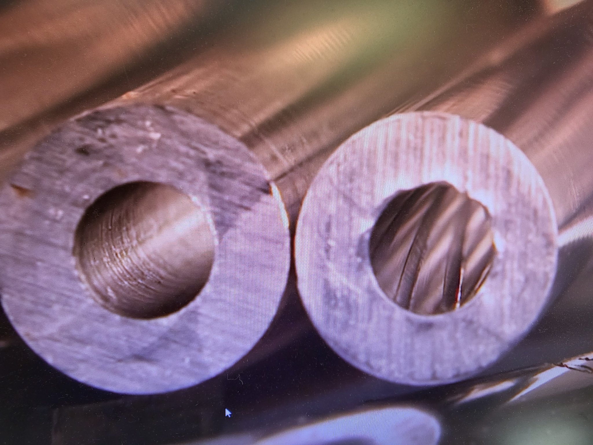

Take a look at the attached pic. This is the end of a button rifled blank. You can see how the steel gets deformed when the button goes thru. Button rifling displaces material it does not remove the material. So the closer you cut the o.d. of the blank down and get to where all this pressure/stress is....the machining operation will let it end up relieving the pressure and when this happens...you cannot make it go back.
I've seen it very common with button barrels when you thread the muzzles....the bore opens up and right where the shoulder of the threads are the barrel gets tight again.
I've also seen barrels where the shooters got it so hot during shooting the same thing happens. The bore opens up. This isn't as common but it does happen.
I have my guess as to how made the button cf barrels I posted pictures of but I'll keep that to myself. One it's a guess and two the point of the thread wasn't to hack on this or that barrel maker.
Frank a carbon fiber barrel isn't something you could easily throw together in your garage, do you suspect that these 'counter fit' barrels are being made in a large Asian country and being imported into the US? Then sold to unsuspecting gunsmiths or not unsuspecting.
No made here.
It's not a counterfeit Bartlein Barrel per say...but customer was told he was getting a Bartlein and got something else. Doesn't matter if it was done intentional or not....customer is the one eating it in the end.

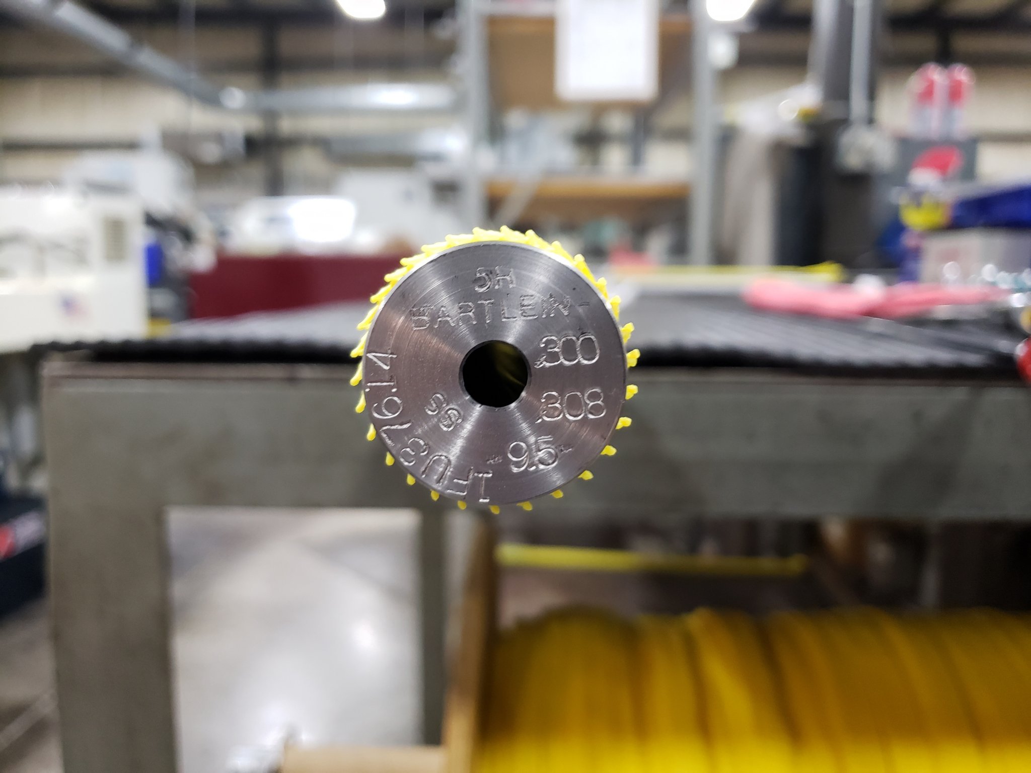

It'd be a + if the barrel manufacturers had some sort of maker's mark engraved somewhere on the outside of the barrel rather than the breech where it's often lost. No more "I don't know whose barrel it was" on a resale, and the customer knows he's getting the blank from the manf he expected and paid for.
Then the scumbags would forge the mark on their junk barrel
If a blank had a barrel maker‘s mark when new, it would likely be removed when the barrel is turned to final dimensions.
But, when ordering a new barrel, the customer could request to have the barrel stub returned with the completed rifle. There’s your proof- of counterfeit or genuine origin.
Mile High sends you the stub with your new truck axle. Piece of mind.
