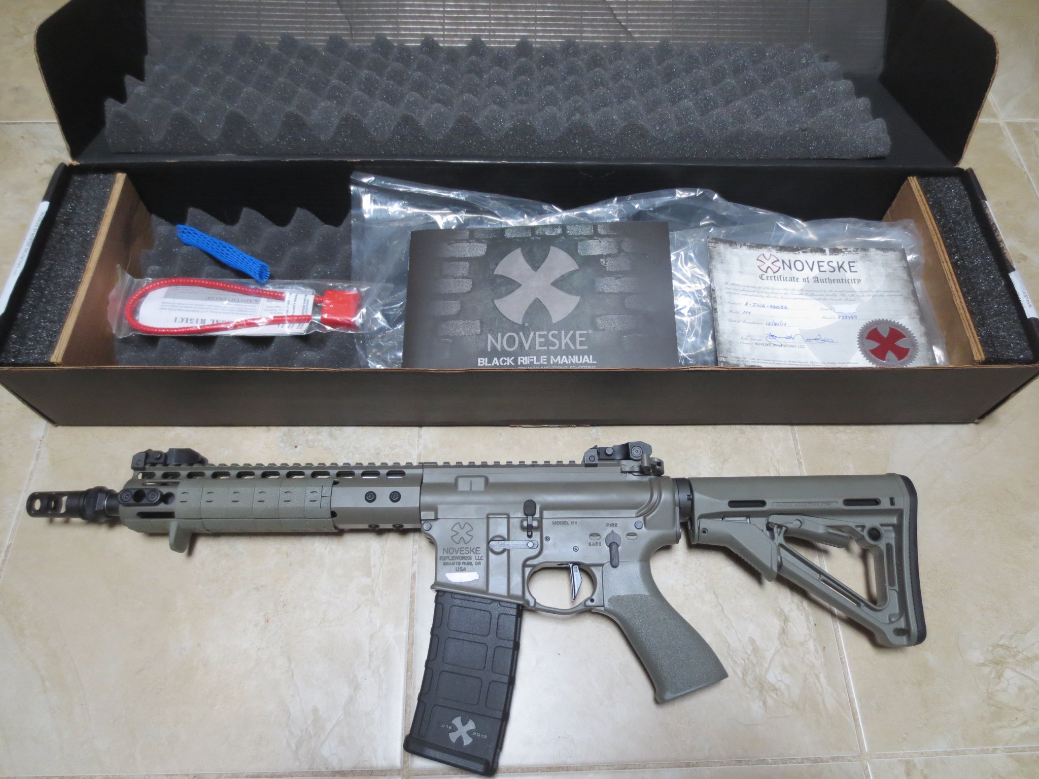

Speaking of John Noveske, here's a number 70 of 250 Johnny Rifle, which came out right when he died. I think they maybe were supposed to have been signed by him? I think had they been actually engraved vs. just Cerakoted they may have attained a higher value too. Super light and handy. Still unfired, got it for the wife who turned into an ex, among other things.
