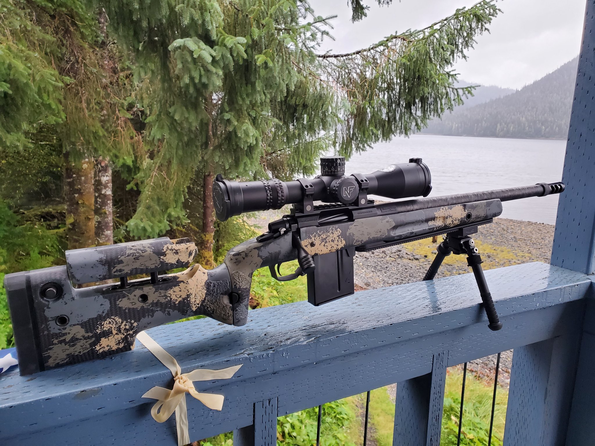

Here is my new 6.5 Creedmoor, built by Caleb Morris of Alpha Omega. I should know what to expect when I commission a rifle from him, but my god he never ceases to amaze me and exceed my expectations.
I had him build me a 26" CF Bartlien barreled rifle with a Impact action and a Foundation Revelation in LH for the NRL Hunter Open Heavy division. I can't wait to go out and zero it and break it in then start load development on it. I do think I want to ditch the full Arca rail for a front pic rail with small arca section by the mag well but other then that it is about 8 Oz under max weight as configured with a Armageddon gear sling. View attachment 7958427
How is the balance of this rifle. I want to build a similar setup. But I’m worried it will be pretty heavy in the rear. I go back in for between this and a manners lrh. The foundation definitely looks better!
The LRH is a fair bit lighter, I have a friend with one and we have compared them. Mine feels really well balanced, but I picked components that would take advantage of the class. A CF barreled build in a LRH is a better Open Light gun, where this stock seems to make it a good open heavy candidate. To be honest it feels allot like my Fluted RH gun from above, which is what I wanted... it was my favorite rifle I had ever had in RH.

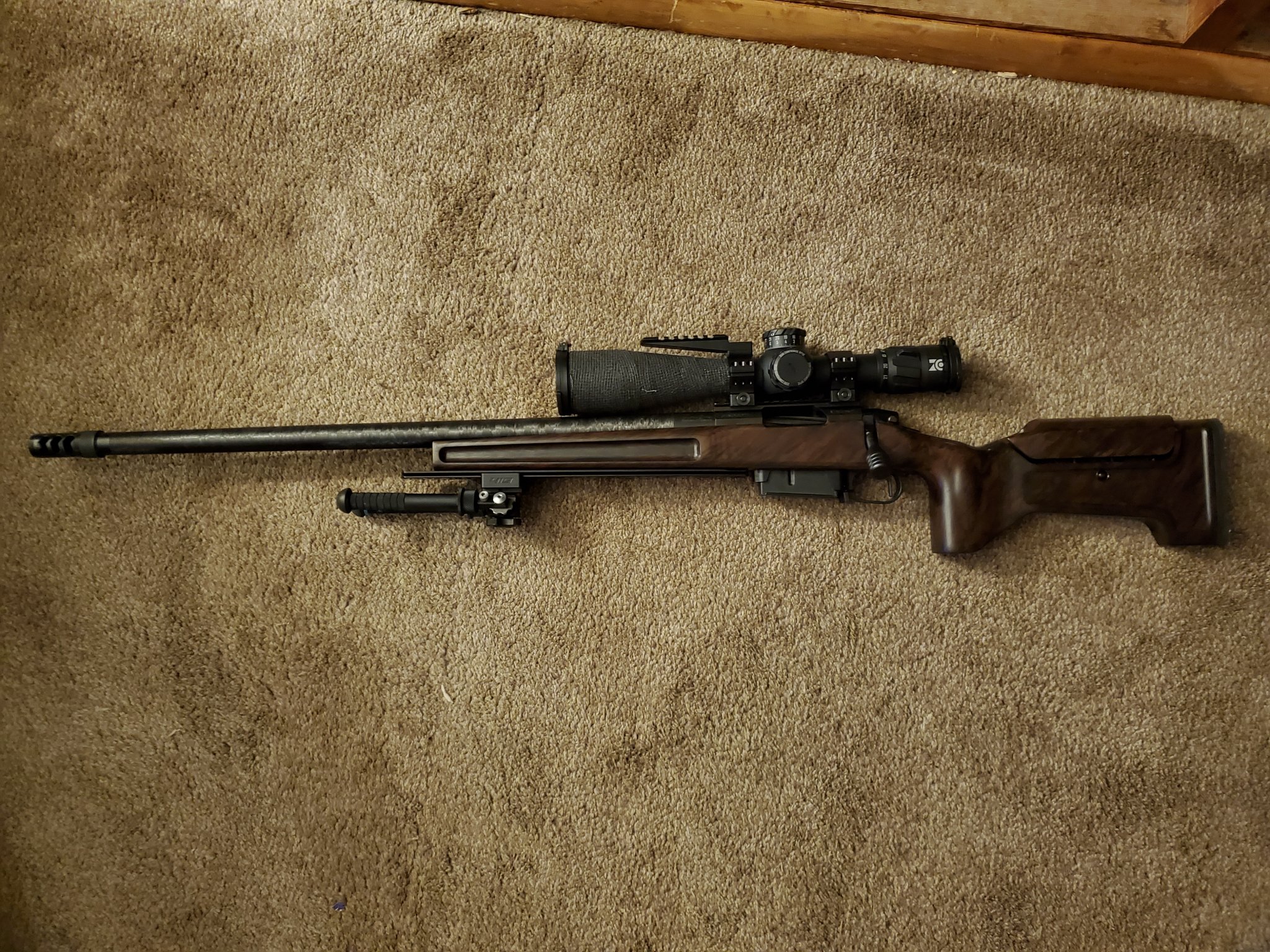

I ran a 24" Heavy Palma in a Manners CF Elite stock, and had no issues meeting the weight in the heavy class. I couldn't make weight with my normal configuration of McMillan A5 with M24 profile barrel.

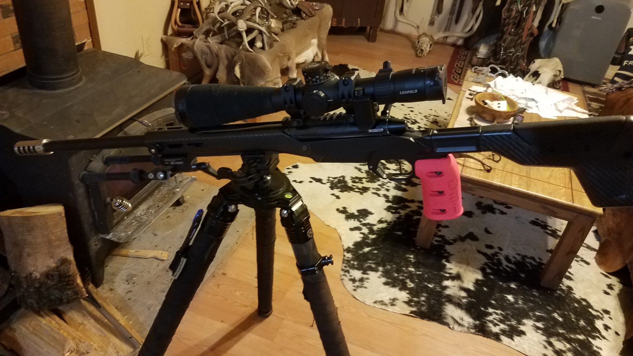

I also have another 6.5 Creed he built me that is a shorty so velocity would likely be short of power factor or on the edge. View attachment 7733028

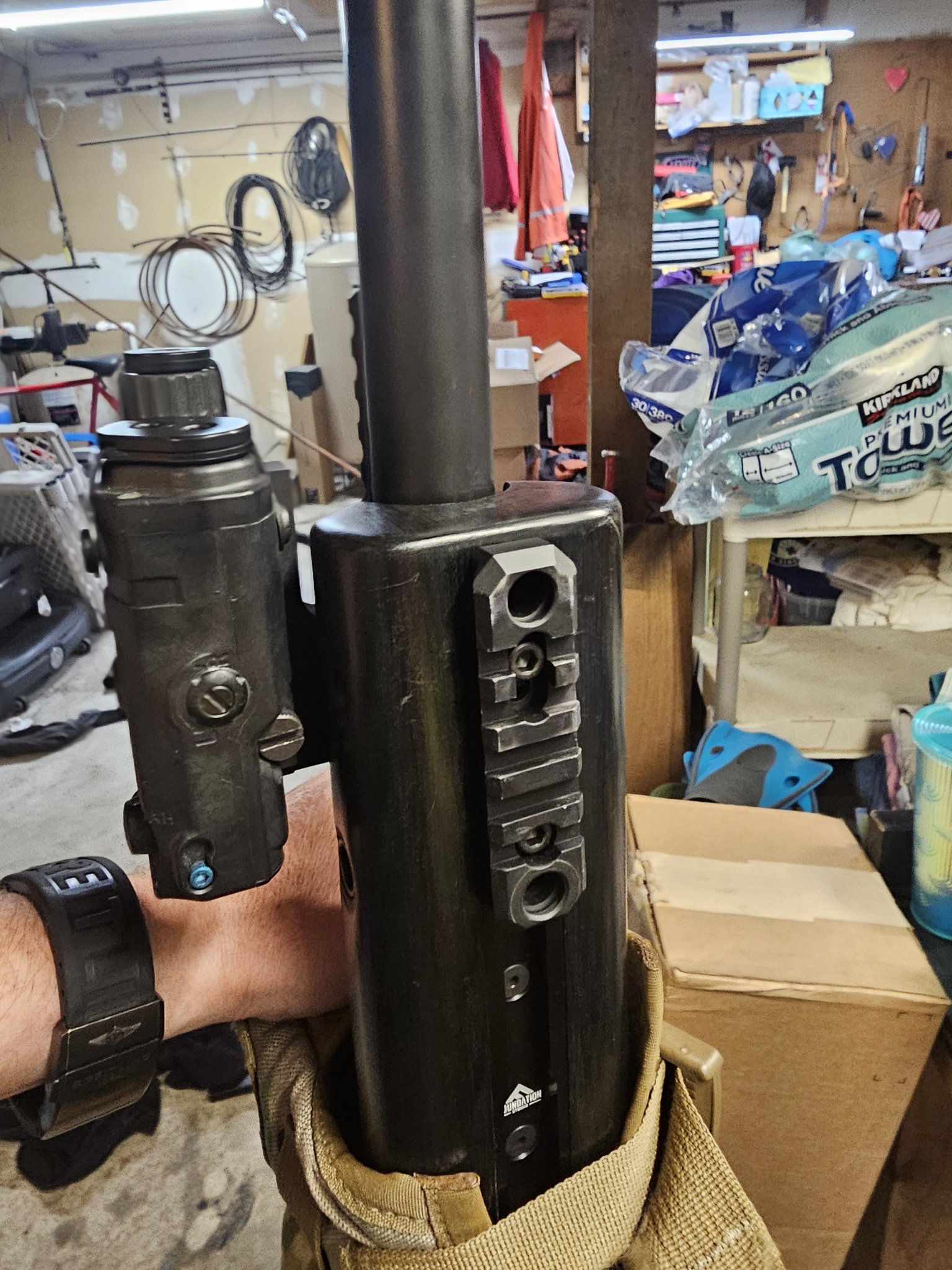

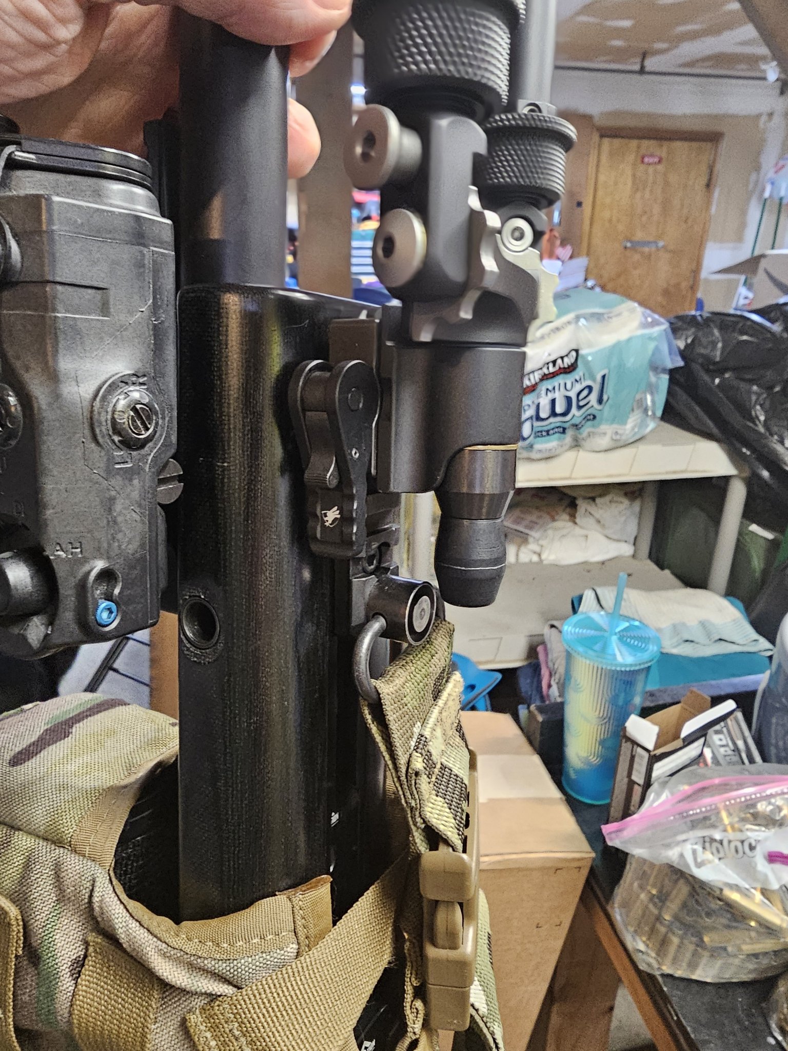

How do you sling the rifle with only one qd cup in the rear?
Or it must be this
3.1 ” 5 Slot Picatinny Adapter for Foundation SS Rail​
I run the same setup on my work rifle... it is very similar to the factory setup on a Manners LRH as well. I also use the small Arca section back by the magwell.
