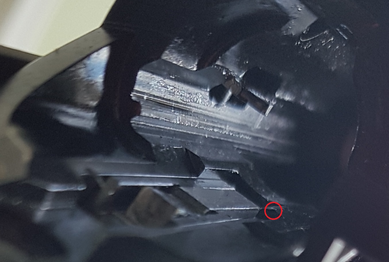

Took a look at my action last night, and ended up with a similar observation. When bolt was pushed to the right, it had a familiar feel to a rough Savage bolt sleeve that I once had. Ended up polishing it real quick with a 7447 Scotchbrite pad that I had lying around. Makes a huge difference. Also noticed that the bottom of the recess for the bolthead pin can catch on the corner of one of the rails on the receiver when the bolt is moved with some downward pressure. I added some grease to the edge of the recess to help with any wear. Overall, not to overly worried as I don't run the bolt to the right anyway, but thought I'd share what I noticed.
*edit, highlighted the correct spot catching on the bolthead pin recess.
