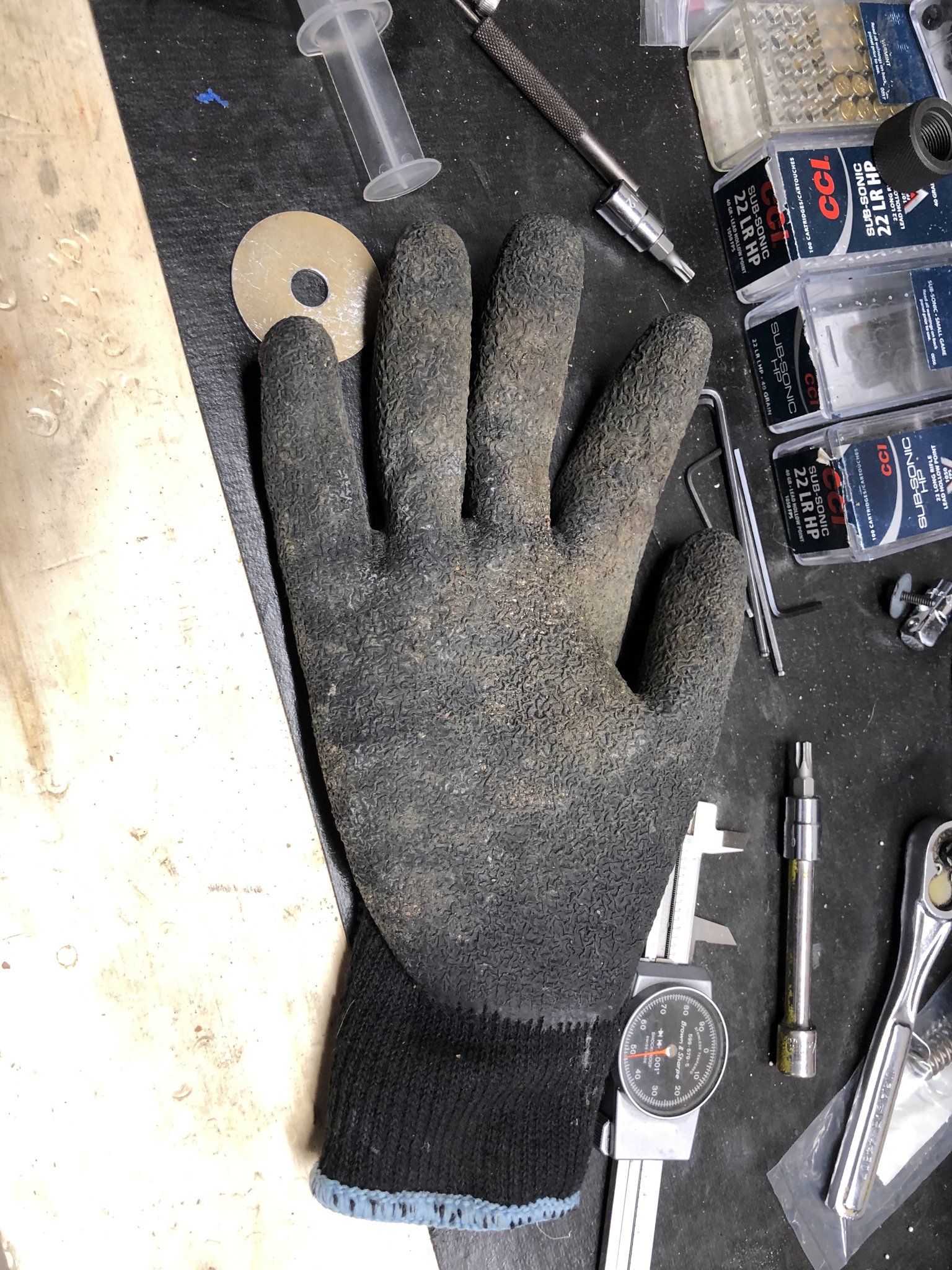

For you guys changing springs, what are you using to do it? I think using the washer is going to be a bitch trying to compress a 25lb spring.
I chucked the washer in the trash. I just do it with my hands. The 25 lber was tough but doable. I found it’s easier if you only thread in the striker retract screw a couple threads. Maybe if you use grippy gloves it may help if you’re having issues with slipping.

I put the washer on top of my vise jaws towards the outside edge, with the striker facing down, pushed it through and then unthreaded the lock nut with my other hand. It wasn't bad at all doing it that way. I am going to run about 100 rounds sat on the 25# and see how it feels. It's noticeable, but not too bad if it will give me peace of mind on reliability.

Something using a vise was what I figured would be the easiest...helps to be able to use your body weight effectively.
Thanks for the ideas guys. I thought about using my vice as a press but it isn't large enough. From your responses it doesn't seem to be as difficult as I was expecting. I am going to have find out what an egg handle is, though. I'm not much of a cook!

This is all you need. It was easy to swap the 25 lber in and out without issue.

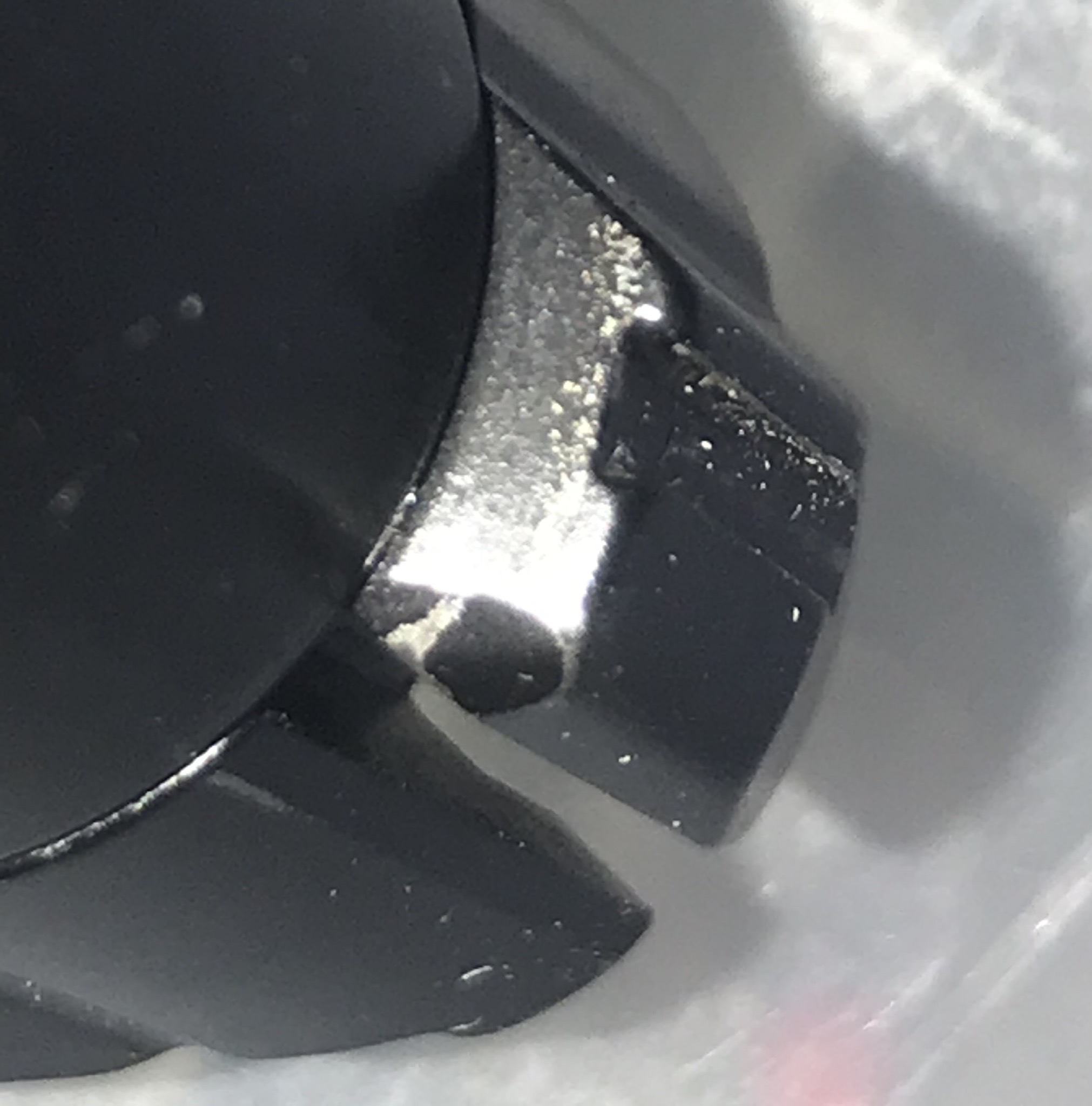

On your nucleus when you hold the bolt body are you able to rotate the bolt head back and forth?
On my replacement bolt head I have a small amount of rotation between the bolt head and the bold body.
The new bolt head pin hole seems to be slightly larger than my old bolt head as I do not remember my old bolt head having any play.

Mine has a bit of play similar to my old savage but less.

I also tried the 25# spring... it's a bit fun to hang onto the washer while trying to compress the spring and start the castle nut without launching everything into the ceiling. The 25# springs makes a very noticable difference in bolt lift compared to the 19# spring, but it's still not terrible IMO... especially with the long barbell knob since it gives you more leverage.

Yep, neither the crosspin nor bolt head are press fits so there's going to be a little movement. Both my long and short action have it. The bolt head is going to align to the case and lugs when closed and in battery.

Is this normal?
Yes, it's a floating bolt head and that's part of what you're trying to make happen when you have swappable bolt faces like that. The little bit of wiggle in combination with the toroidal lugs in ARC actions allows them to ensure a square lock up with full contact even if their tolerances on the receiver and/or bolt head are slightly wider than one-piece bolt actions like an Impact Precision or Remington 700.

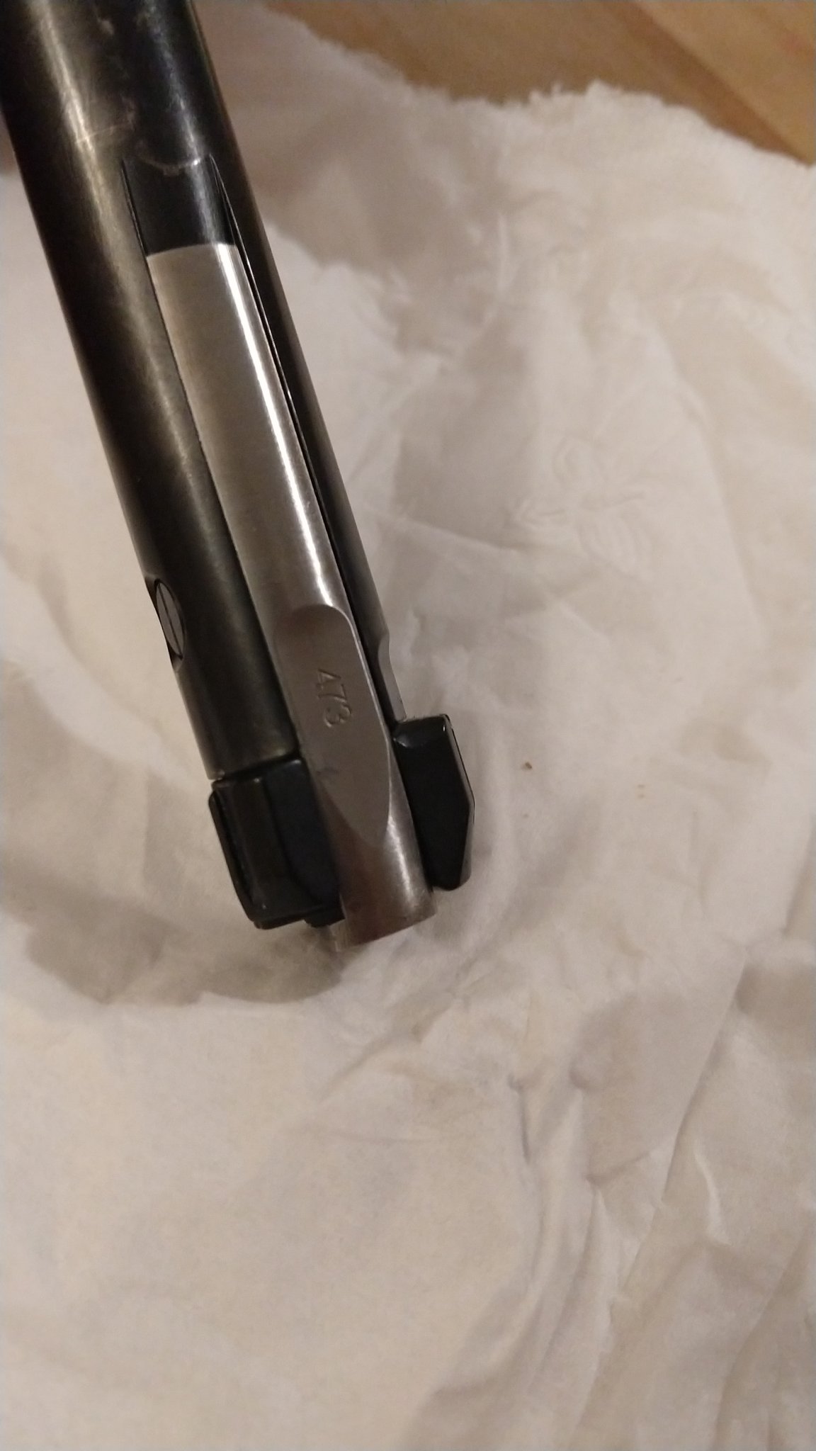

Hard to get a good pic with it installed.
I wish they’d update the bolt head retaining pin to be captured by the bolt body itself vs using the striker to do that. One has to imagine the pin is rubbing on the striker on some level, and when using the “wheeler” method to check distance to lands it would be great if you didn’t have to cobble something together to keep that pin in place.
Just use the screw and washer to restrain the striker while doing that test or adjusting your FL die; screw it in until the striker is held against the washer. The screw and washer removes all the load of the striker spring on the bolt so you can feel what's going on, and the firing pin stays in place to retain the crosspin.
