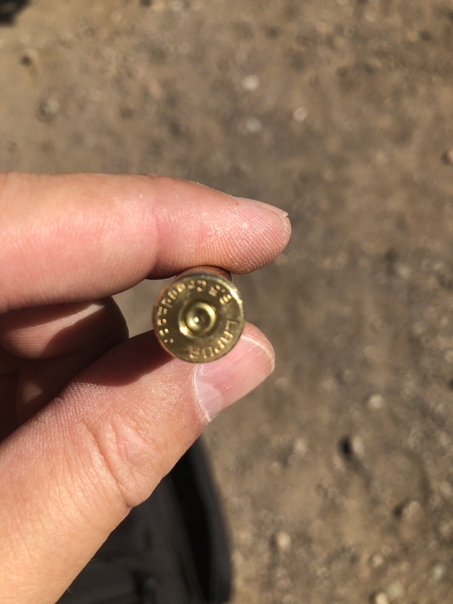

I have about 600rds on my Nuke and had my first light strike in a match today shooting factory Hornady and 16lb spring. Was pretty disappointed to have it happen with factory ammo. I did find out a little bit later that my anti rotation pin and screw fell out somewhere so don't know if that may have had something to do with it or what.
I probably have about 500 rounds of CC2 200 and FGMM through mine, no issues.
I then tried running some M118LR through it. Two fired first time, two fired second time, about five rounds wouldn't fire at all, no matter how many times the striker the firing pin. This is with the standard spring weight and a TT trigger.

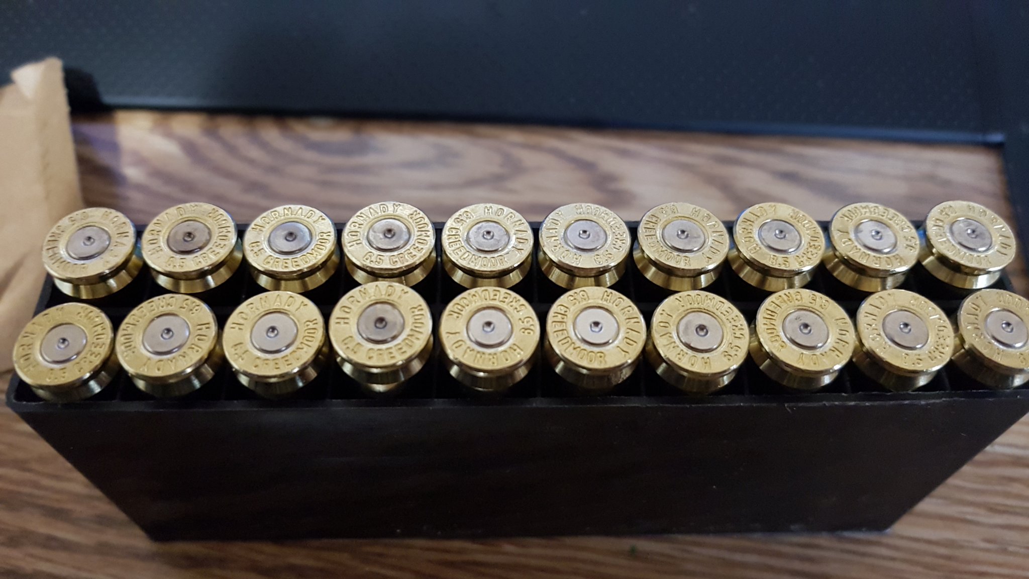

Did some testing this morning. Small sample size of 10 rounds each with CCI 41, CCI 450, Federal 205m, and Factory Hornady 140 ELD M. Had one FTF from CCI 41 and couldn’t get it to ignite. 16# spring.
If that is the FTF round, im surprised as that looks like a pretty healthy strike.
Interesting
That looks like a solid hit.

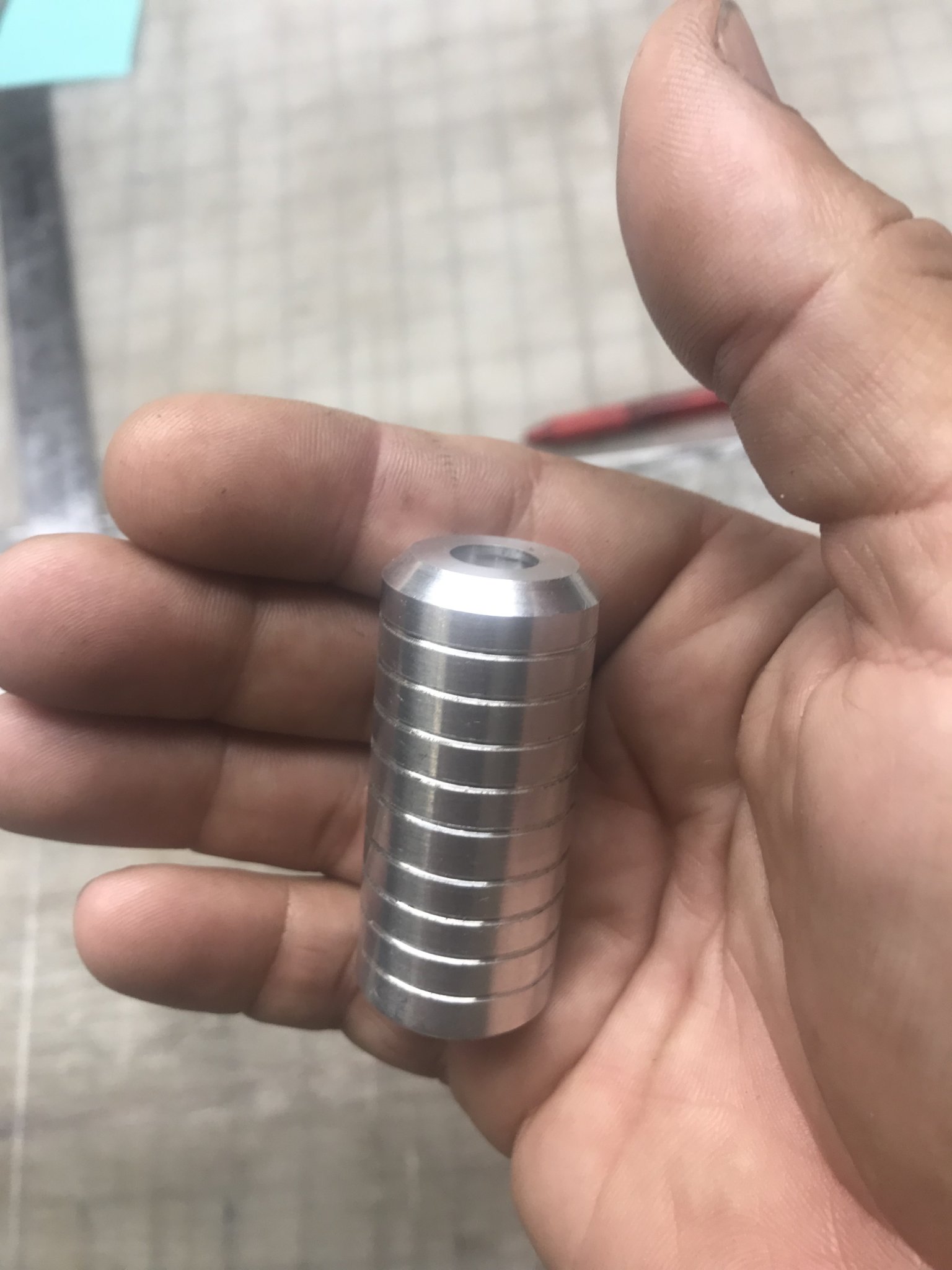

Put the washer on two wood blocks of with enough room to get fingers on nut and push down on back of bolt assembly.
Or buy (from ARC)or make a tool like this one I made as it makes it a lot easier.

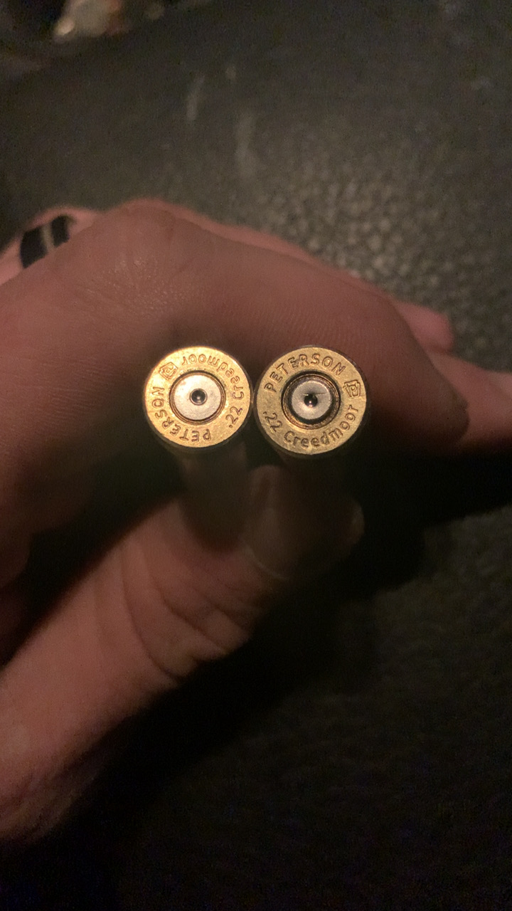

Was anyone able to fix this issue? I have the 22 pound spring already a tt diamond trigger and I’m getting about 50/50 fires with factory ammo in a 22 creed and I can’t even shoot factory 6.5 cm
Left round fired
Right did not
That right round would’ve fired out of anything else just not these stupid nucleus actions
Left round fired
Right did not
Yes. Take your bolt apart. Use brake cleaner and spray down everything on the inside. The firing pin, firing pin spring, inside bolt body, all of it.
Reassemble with a VERY LIGHT layer of oil.
This seemed to work for me. More often than not, I would run it dry, which isn't the right way to do it, but it worked.
