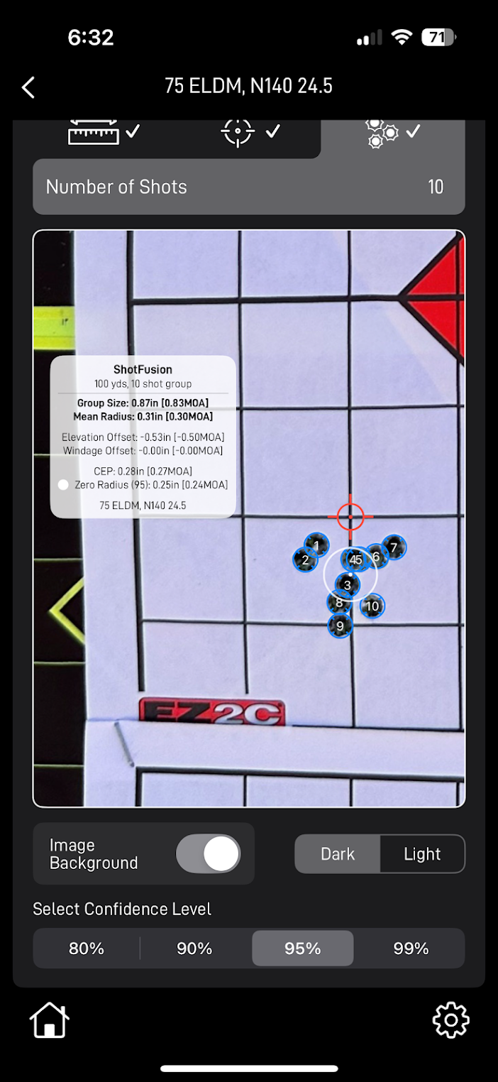

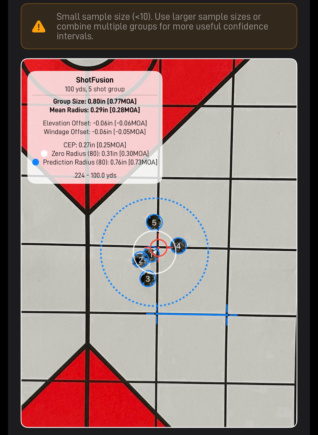

I've been working on an app (as a passion project that has consumed much of my last year haha) that does a bunch of statistical calculations with group and velocity data, and one of the outputs is the uncertainty in true zero based on the analyzed group. i.e. how far from the center of the group the actual population mean is likely to fall, at some confidence level. I figured the people here might find it interesting. To be clear, my intention is not to preach about sample sizes or what people should be doing, but to share what I think are interesting findings.
A "typical" .77 MOA 5-shot group has a 95% zero uncertainty radius of .54 MOA - i.e. the true zero is likely somewhere within .54 MOA of the group center. With a 10 shot, 0.83 MOA group (similar precision as the 5-shot group), the zero uncertainty radius shrinks down to 0.24 MOA. The white circle in the screenshot below represents the zero uncertainty region.

Joking aside though, I've started using 10 shot groups to zero for that extra bit of confidence. If you wanted to be really certain about your zero (maybe for ELR shooting), it may actually make sense to do 20 shots. For my application (mostly ringing steel to 600 yds), a ~0.2 MOA 95% confidence is more than enough.
