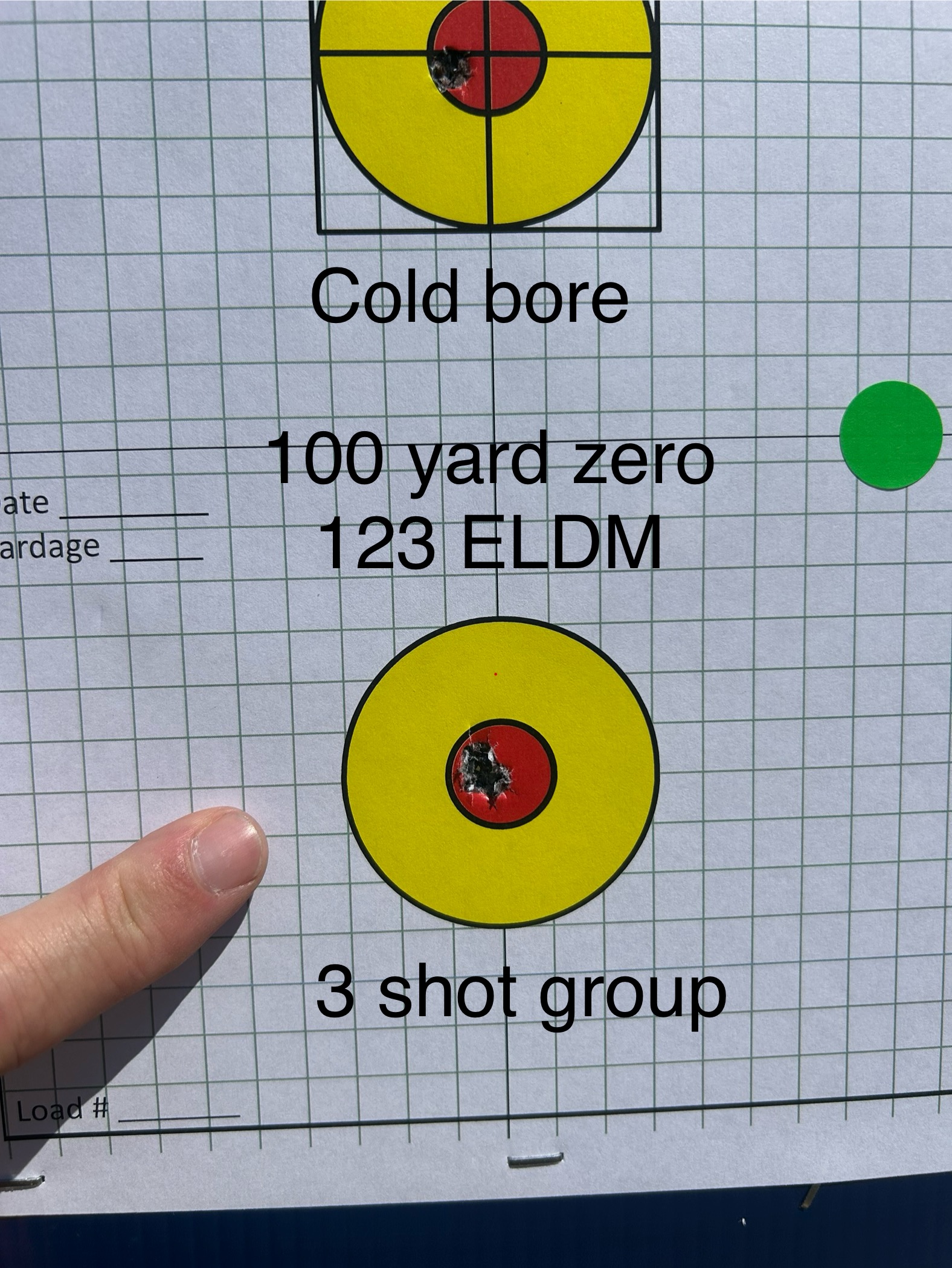

I shot two 5rd groups before the last match I shot. One prone, one off a barricade. The day prior. Didn't change anything, didn't check zero the morning of the match, won the match. Make your app, doubt anyone but the uninformed will care.

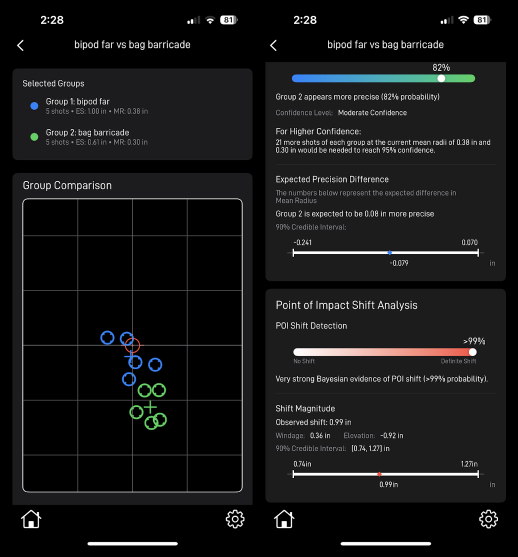

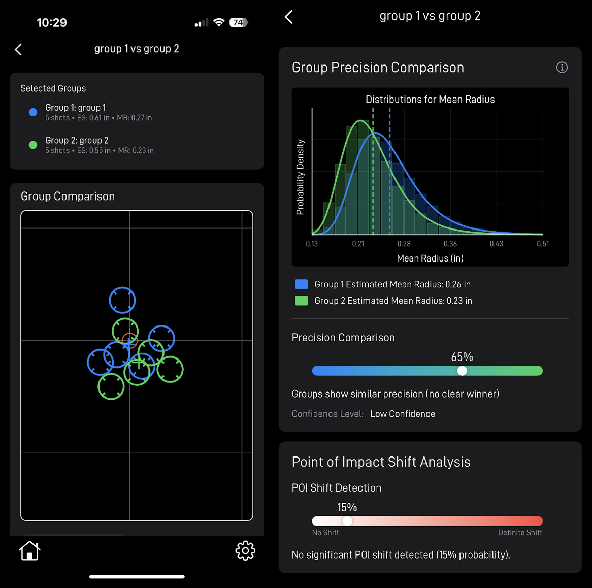

Here is an example of two 5 shot groups to further illustrate this. My app can also compare groups, and one of the results is it tells you the likelihood of there being a real difference in POI between the groups being compared. These two groups (blue and green) are similar in precision, and the centers are .22" apart. But the analysis shows that this apparent shift is very likely just due to random variation. This is another example of the kind of real utility statistics can have - if I shot that green group after zeroing to the blue group, instead of adjusting my elevation up a tenth, I'd make a combined 10-shot group out of it and zero to that.

Ledzep's chart shows us that even with a pretty precise rifle and load setup, there's a decent chance the center of any given 5-round group will be off by 1/4 MOA or more from the true zero, and my app says the same thing. This is 200 year old settled math, and not a topic worth arguing about.
Of course using your zeroing technique won't stop you from winning a match, in the end it's a relatively small variable in the grand scheme of things. I'm sure you have a very precise rifle and the shooting skills to go with it. But all else being equal, having a better, lower uncertainty zero is still undeniably a real advantage.
And here is the stats guy mindset again. You think you're onto something meaningful by identifying .22" or 1/4moa center to center differences. With a scope that can only resolve .36" differences. While overlaying positional influences to further murky the waters. This is the stats guy disconnecting from reality and finding statistical significance that isn't meaningful or significant in the reality of application. I'm not disagreeing that your app and a larger shot group could help refine a true POI. What I'm disagreeing with is that it's meaningful and where a shooters focus needs to be. With the limitation of time, money, and focus....is nancing about over .2" POI uncertainty the best place to prioritize? To me.... this is where I see newer shooters make very common mistakes. Misappropriating importance on things that don't actually contribute meaningfully. A shooter is far better off focusing on how he drives the gun than wringing their hands over one click this way or that way.

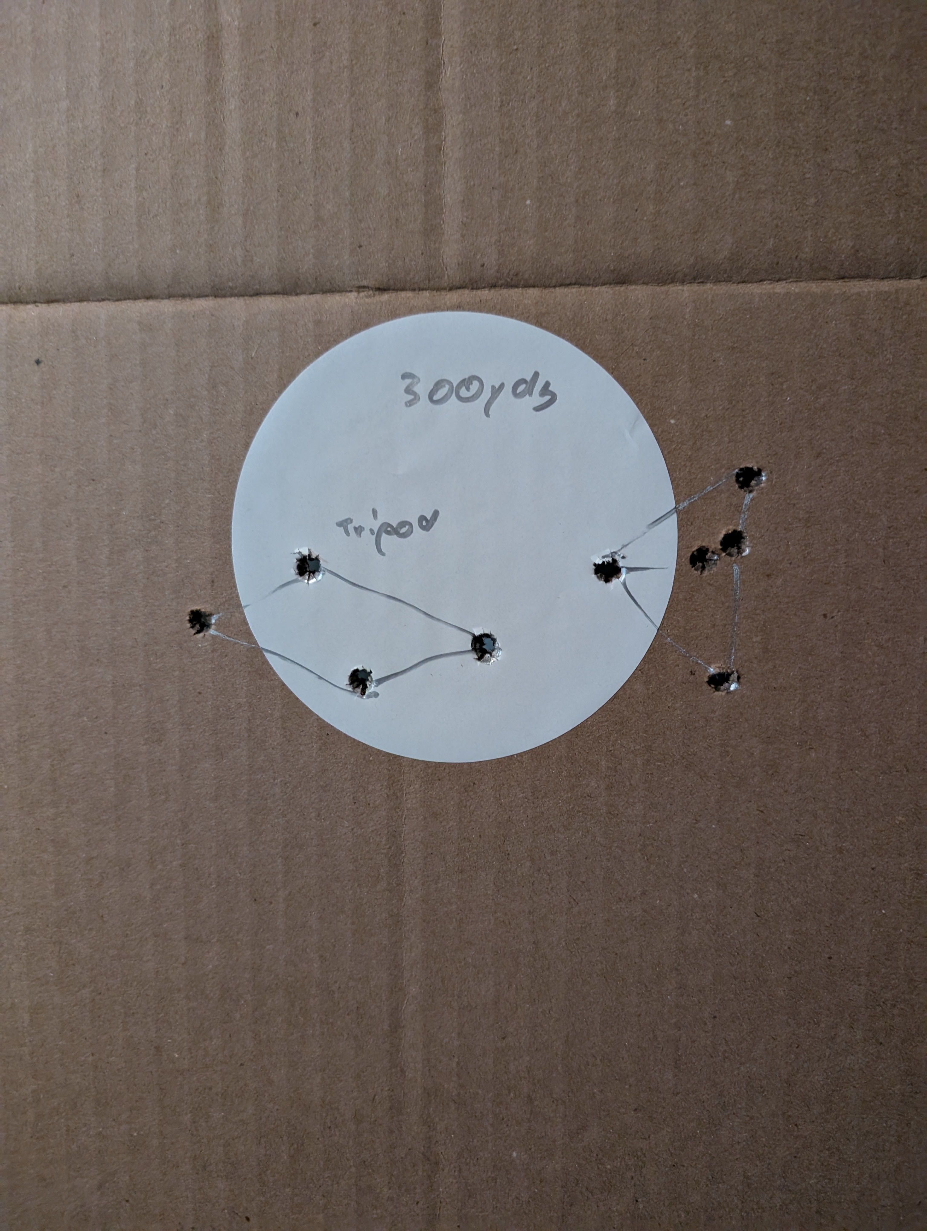

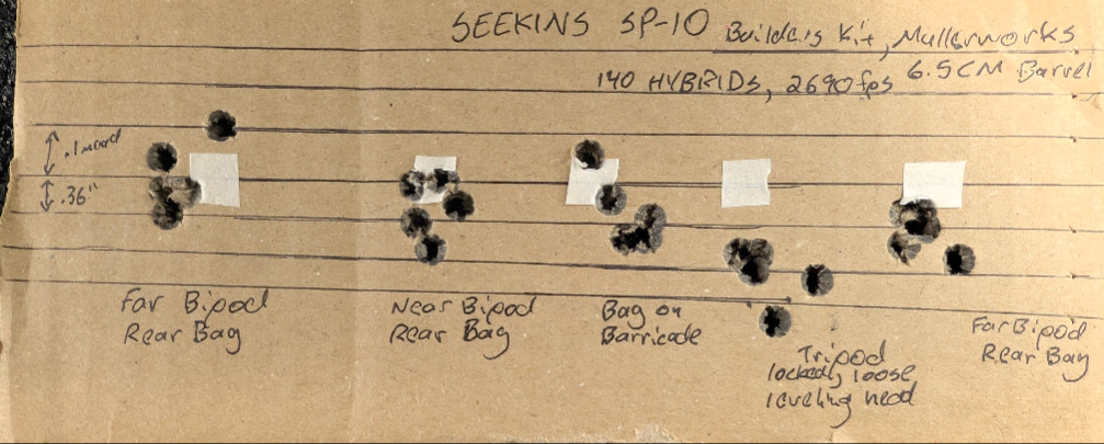

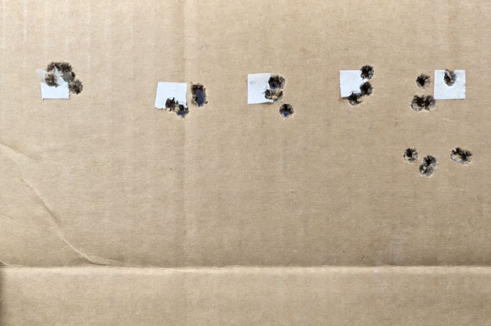

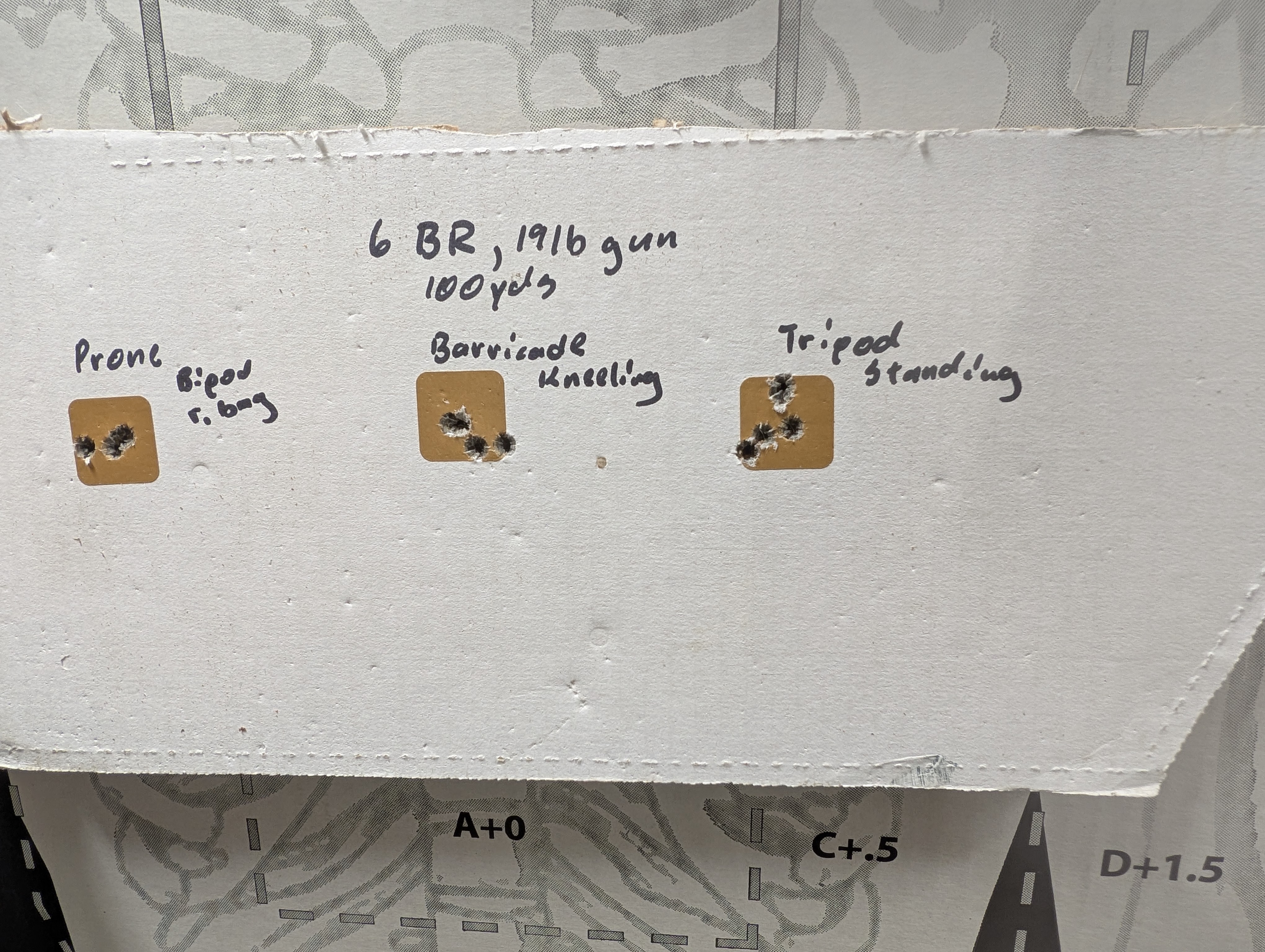

It sounds like you're new to the concept of positional testing. It is more prevalent in precision ARs due to barrel nut deflection. I'm this case, in addition to raw shooters positional influence, you also have to contend with mechanical impacts to your POI due to different positions.
Are all of these POI shifts due to random variation of a larger aggregate shot group?

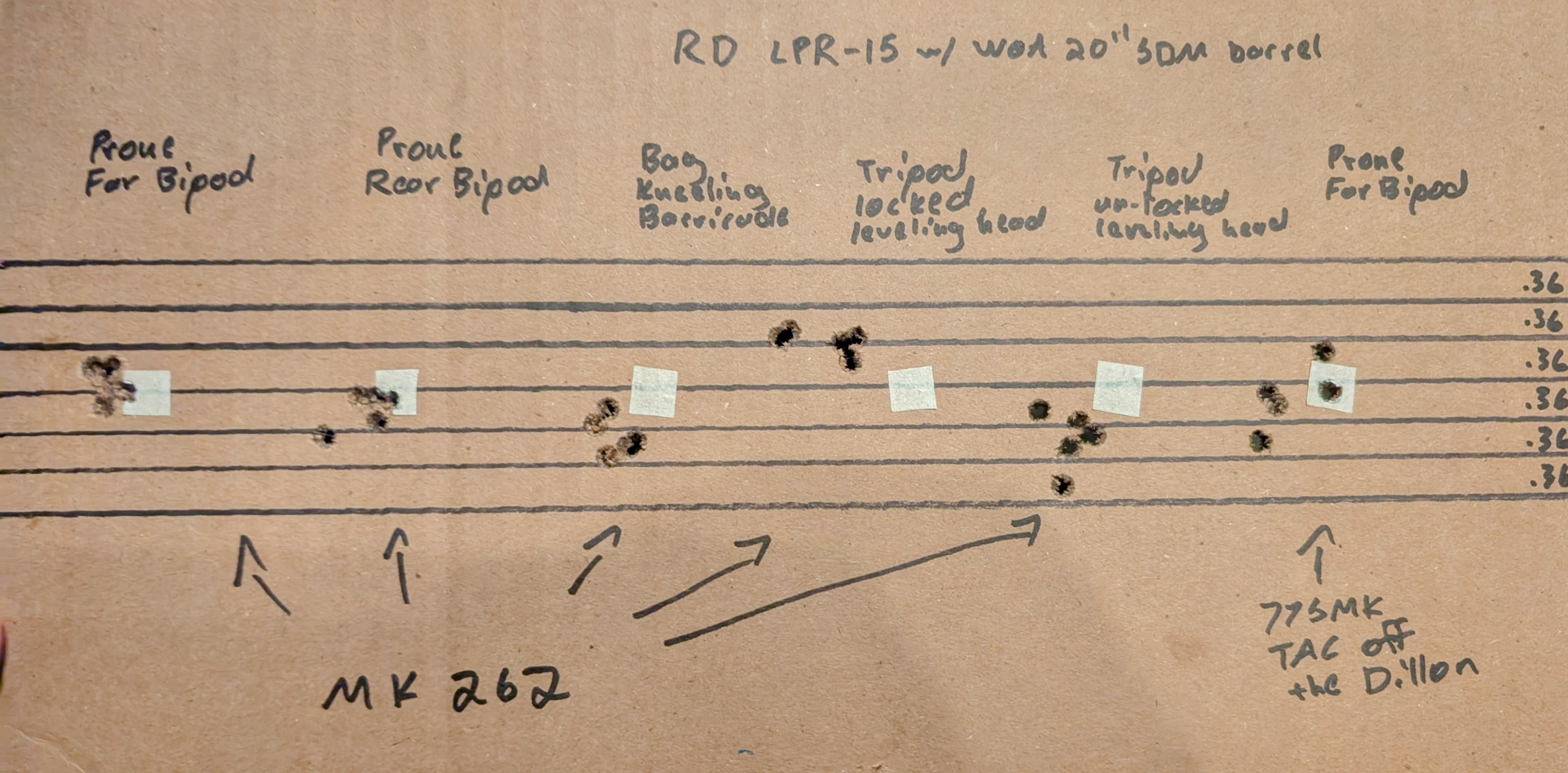

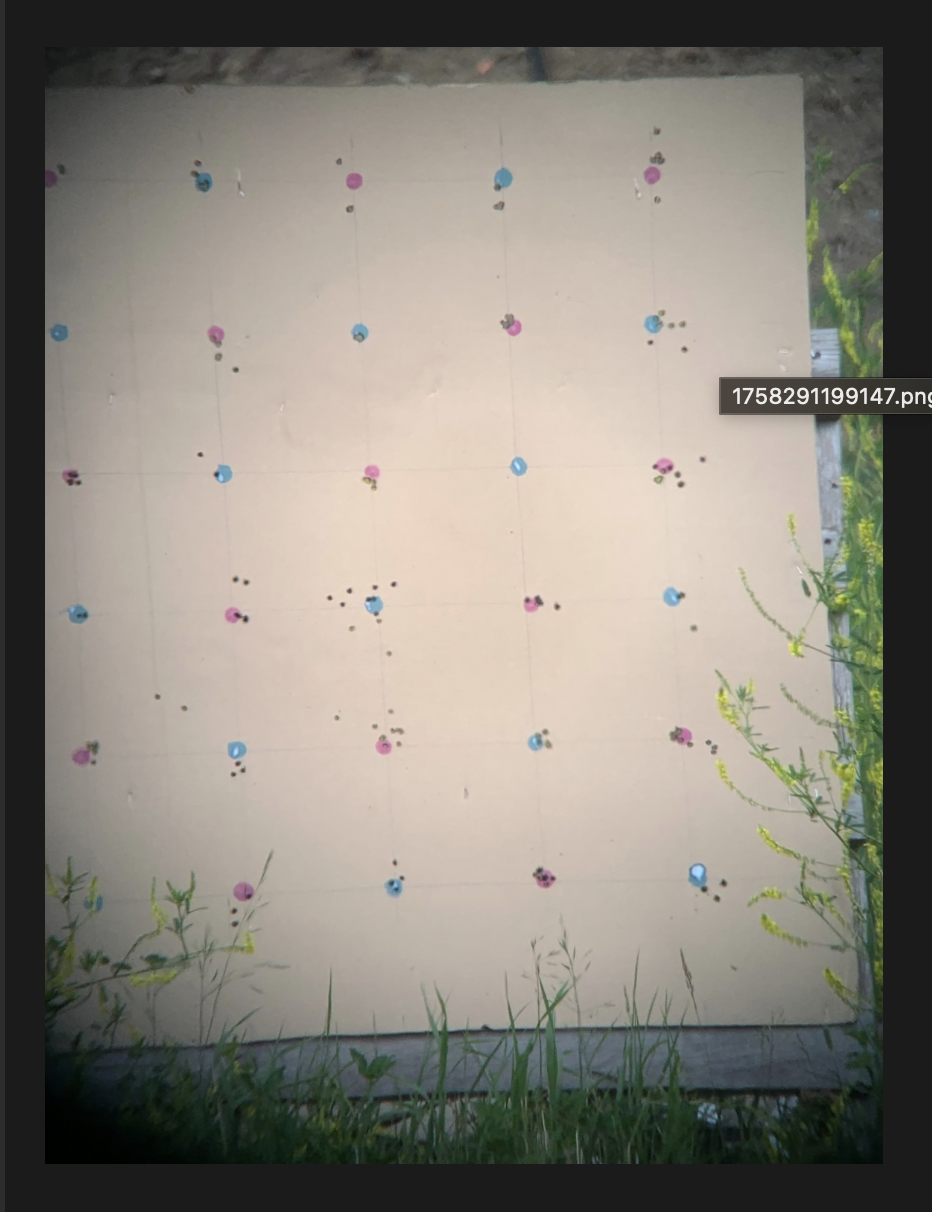

And here's a positional test with a bolt gun. I shot this to contrast the trend seen with gas guns. Similarities? Differences?
And here's the RD LPR-15 (second photo above) shooting a 6x5 in the prone. No positional. Contrast this with the positional test.
Question 1: What do you think is the exact POI uncertainty in the above two photos? The 6BR and the prone 6x5.
Question 2: Is that amount of uncertainty impactful? If so, explain how?
Question 3: Based on the observed POI differences in the positional tests, what's more impactful? POI uncertainty due to too few shots in a group? Or POI shifts from positional influence?
