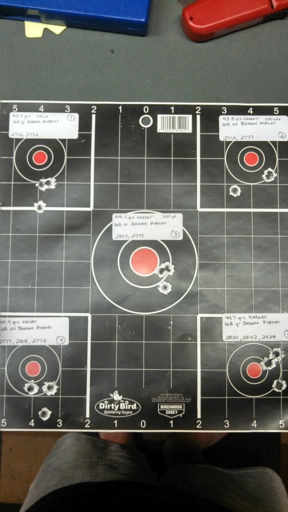

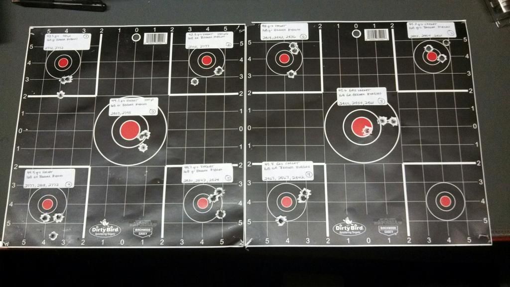

Well after spending a bunch of time doing this I'm not sure I know anything more. Perhaps some of you will shed some light on my results. Sorry for the crappy pics.
If there's a flyer in the 43.8 group, then it's at the bottom of a node around 44-ish. See how 43.8. 44.1, and 44.4 are all at about the same POI?
And again you see it at 45.3-45.6. Either the 45.0 or the 45.8 have a flyer in them. If you throw out the flyers in those 2 groups, see how 45-45.8 have very similar POI?
So 44.1 44.2 would be my ocw? I was excited about the first two shots in the 45.8 gr grouping and I may have pulled the last one there but I really don't want to load that heavy. The little bit of extra fps I don't think is worth the higher pressure and we did start to see some pressure signs. I'm sure hoping I can get the accuracy to tighten up these were seated about .002 in the lands so I guess I'll mess with that next.
