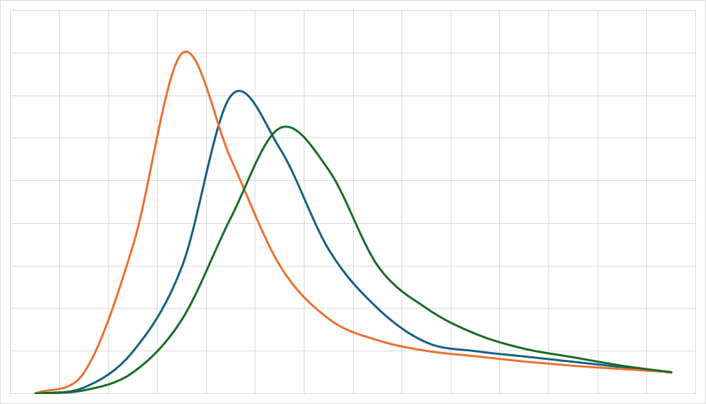

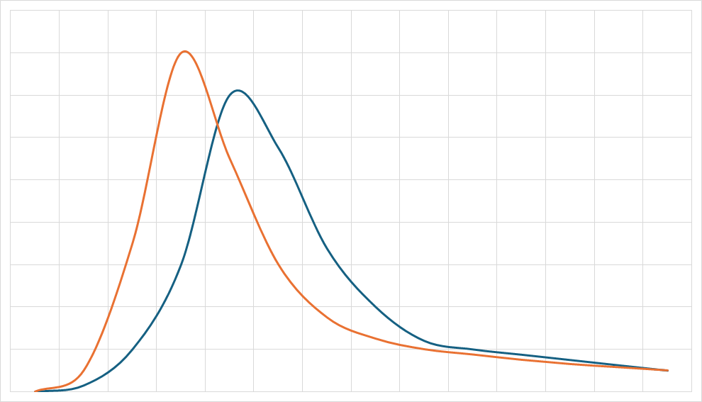

Let's talk the primer difference thing.
- It is quite possible that the Rem 9.5s are just that crappy compared to CCIs, though I doubt that's the case - those numbers are atrocious.
- More likely, the Rems are indeed "hotter" than the others you've tried, which means they are igniting the powder more quickly, which will force everything to peak pressure sooner, which increases burn rate of the powder, which in turn drives up pressure more, etc.
- It is likely the reason your numbers went to hell. Your velocity changed just a little bit, but, more importantly, the new primers drove your peak pressure to hit significantly earlier. This changes how your bullet accelerates (quicker), how it engages the lands (sooner and harder), and the pressure behind it as it does so.
I would bet that if you did some load development (gasp!) with perhaps a slower-burning powder and those hotter Rem 9.5 primers, maybe even some seating depth change, you'd find a load that works pretty well.

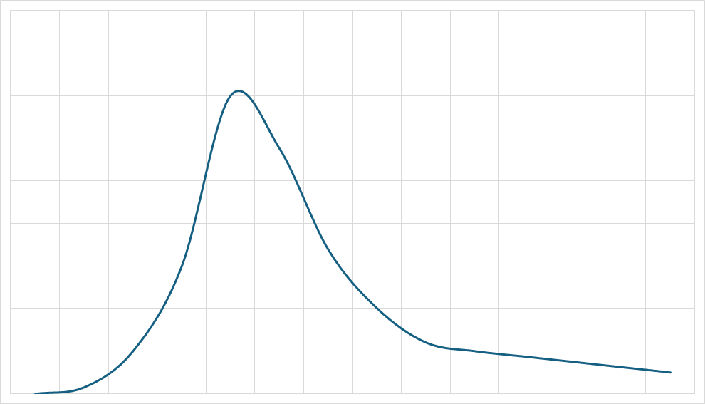

I'm now in the camp that there aren't velocity nodes perse, but rather pressure profiles that work (or don't) for a given bullet/neck tension/seating depth. Change the pressure profile and you get different results. This explains why you can get great results, as an example, with something like H1000 in a 300 PRC, but change to RL33 charged to attain the same velocity, and results go to crap.

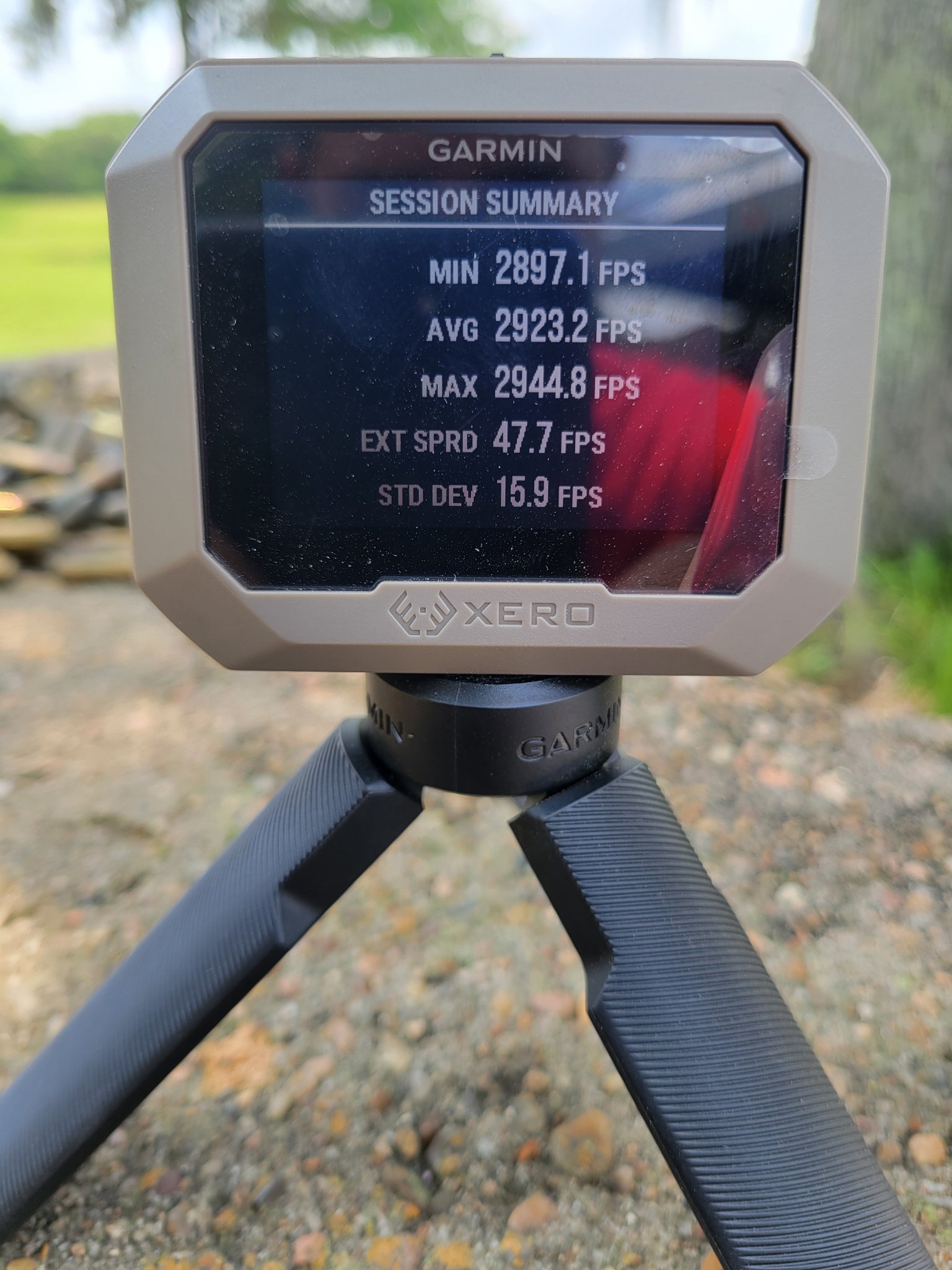

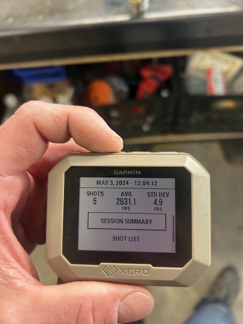

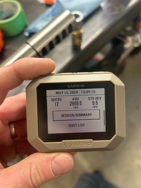

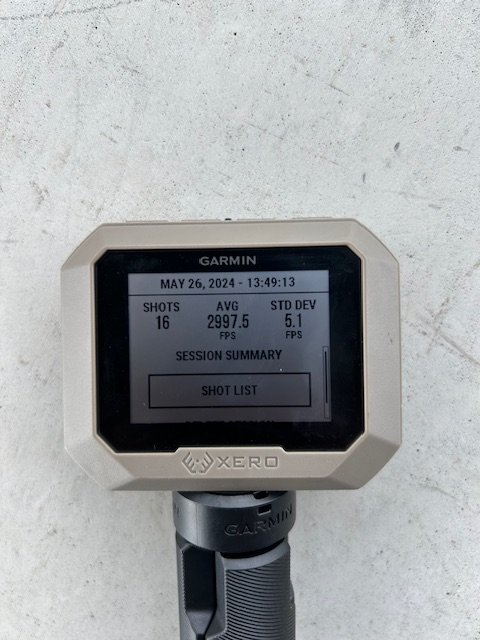

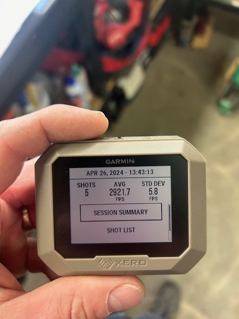

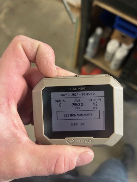

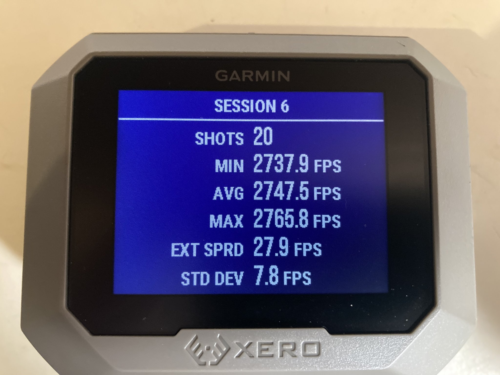

Got out the other day with the Garmin. Man that thing is sweet.so you guys with a random powder charge - let's see some chronos.

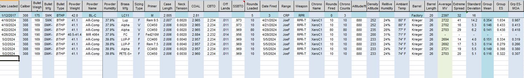

your 17-shot group is almost twice the SD of mine (5-shot groups don't count). I don't see an argument for load development to be harmful or not helpful when this is the proof that surfaces. I never claimed you couldn't get good SD from picking a load, but you guys made it seem like doing a ladder test is crazy, and yet here I am an SD half of yours.Got out the other day with the Garmin. Man that thing is sweet.
The first 2 are from the same rifle, Powder charge was basically just a number I picked.
The next 2 are from 2 different rifles, shooting the exact same load and seating depth, that load came from another guy, it shoots well in every 300 NM I know off.
View attachment 8419388View attachment 8419390View attachment 8419391View attachment 8419392
You posted one SD of like 9 and the other of 4, so which is it?your 17-shot group is almost twice the SD of mine (5-shot groups don't count). I don't see an argument for load development to be harmful or not helpful when this is the proof that surfaces. I never claimed you couldn't get good SD from picking a load, but you guys made it seem like doing a ladder test is crazy, and yet here I am an SD half of yours.
I do not use a mandrel, anneal, or any other weird stuff to claim the process is better.
22 shots at 7.8 and 14 shots at 4.7. Both groups are substantially better than your arbitrary loads - so no, I 'm not very convinced this is a better method.You posted one SD of like 9 and the other of 4, so which is it?
I could possibly improve it and actually do have more testing planned, that was just an arbitrary load to shoot a couple and get a medium zero on that rifle.
So you don't know if you have a 4.7 or 7.8 SD? There is always variations depending on the sample.22 shots at 7.8 and 14 shots at 4.7. Both groups are substantially better than your arbitrary loads - so no, I 'm not very convinced this is a better method.
also lol this took you a month and multiple range trips to conjure up a couple 5 shot tests??? (4/26,5/3 & 5/15 trips) I just post whatever happened last time I went to the range - you really thought you were gonna show up and get me with some cherry-picked groups after a month of shooting...... and this is what you come with!
How would you improve your arbitrary load?
my head is spinning trying to track all these excuses.So you don't know if you have a 4.7 or 7.8 SD? There is always variations depending on the sample.
Those may 3rd Chrono readings were actually at a match. April 26 was when I lent it to buddy, and May 15 was yesterday, one range trip.
Those 17 rounds are also a brand new barrel, like those were the first 17 shots down it, likely will settle in a bit.
I am planning to try a couple grains each direction to see if the ES/SD are any better but the load shoots well enough that I have another match in a couple weeks and I'd take that load.

there is a direct, reciprocal relationship between instantaneous burn rate in the case and the pressure in the case.

Same load, with a few more rounds down the barrel. Picked up a bit of speed.your 17-shot group is almost twice the SD of mine (5-shot groups don't count). I don't see an argument for load development to be harmful or not helpful when this is the proof that surfaces. I never claimed you couldn't get good SD from picking a load, but you guys made it seem like doing a ladder test is crazy, and yet here I am an SD half of yours.
