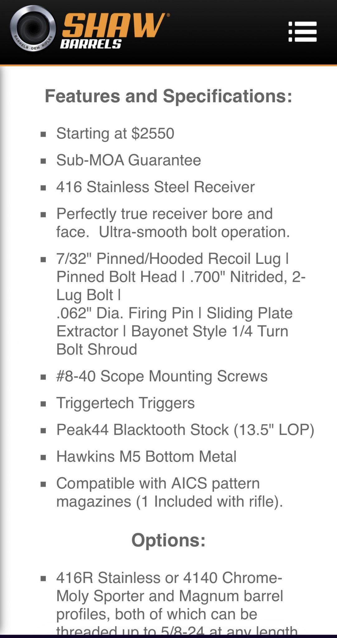

Wait just a second here. I went and looked at what a Shaw barrel is. (To see if it was something legit like Blake barrels). It is not. Are you talking all this shooting: tikka, savage, Ruger, sig, or factory 700 action(trued or not)???
Shaw makes custom actions, custom rifles, and custom barrels. It’s not just stock barrels for stock guns. Probably should dig deeper before assuming

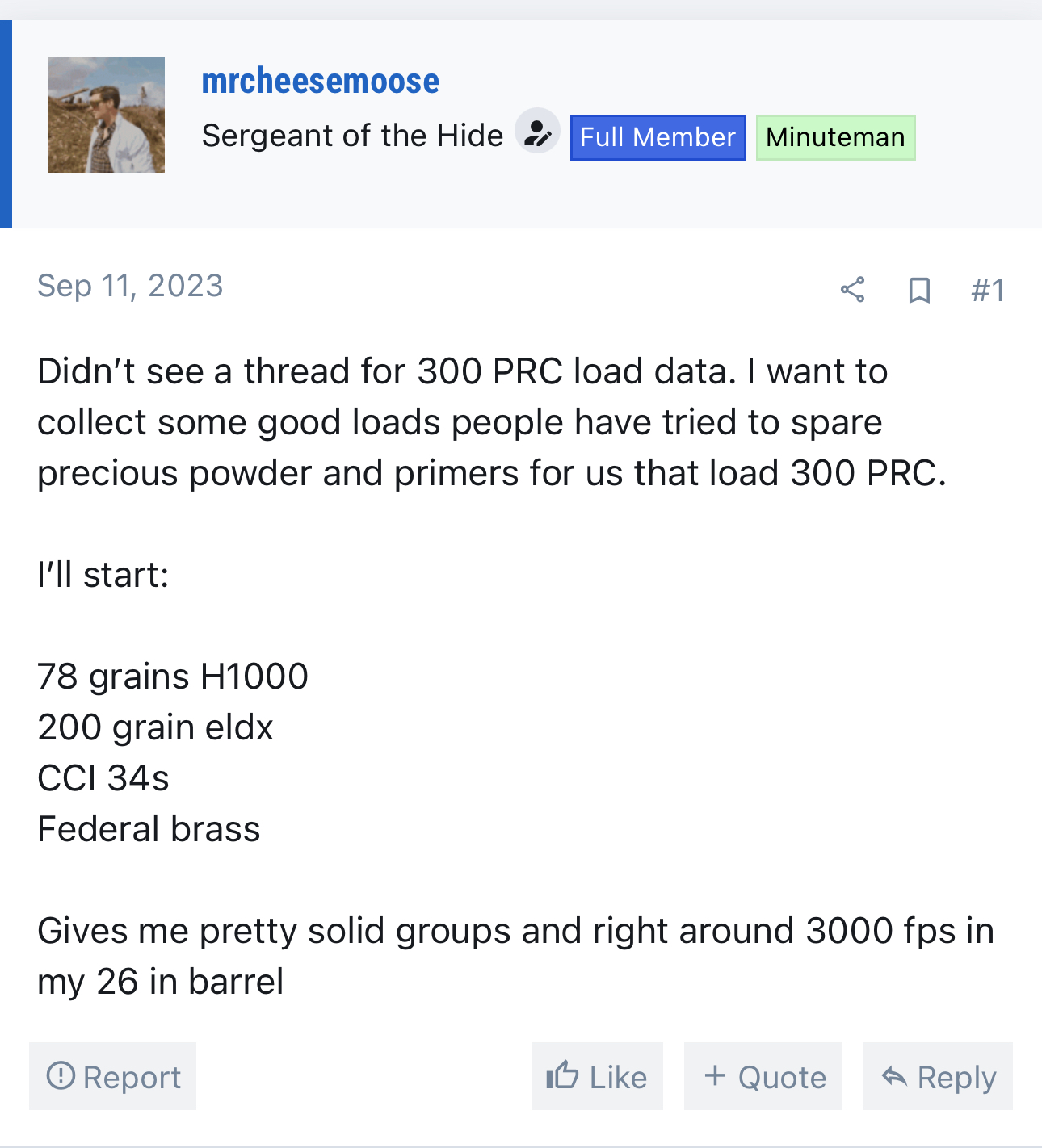

You got on here to brag about a load using federal brass. Yeah. I’ve read enough to invalidate anything you ever saw for eternity…..
Your friend with the crimp die wants to hangout.
I tried using multiple types of brass with this load, lapua, star line, federal, etc. 30 shot aggregates, and guess what, no change it accuracy with a change in brass. So why would I waste my money buying expansive brass? Heck I could probably put the brass doesn’t even matter for that load.

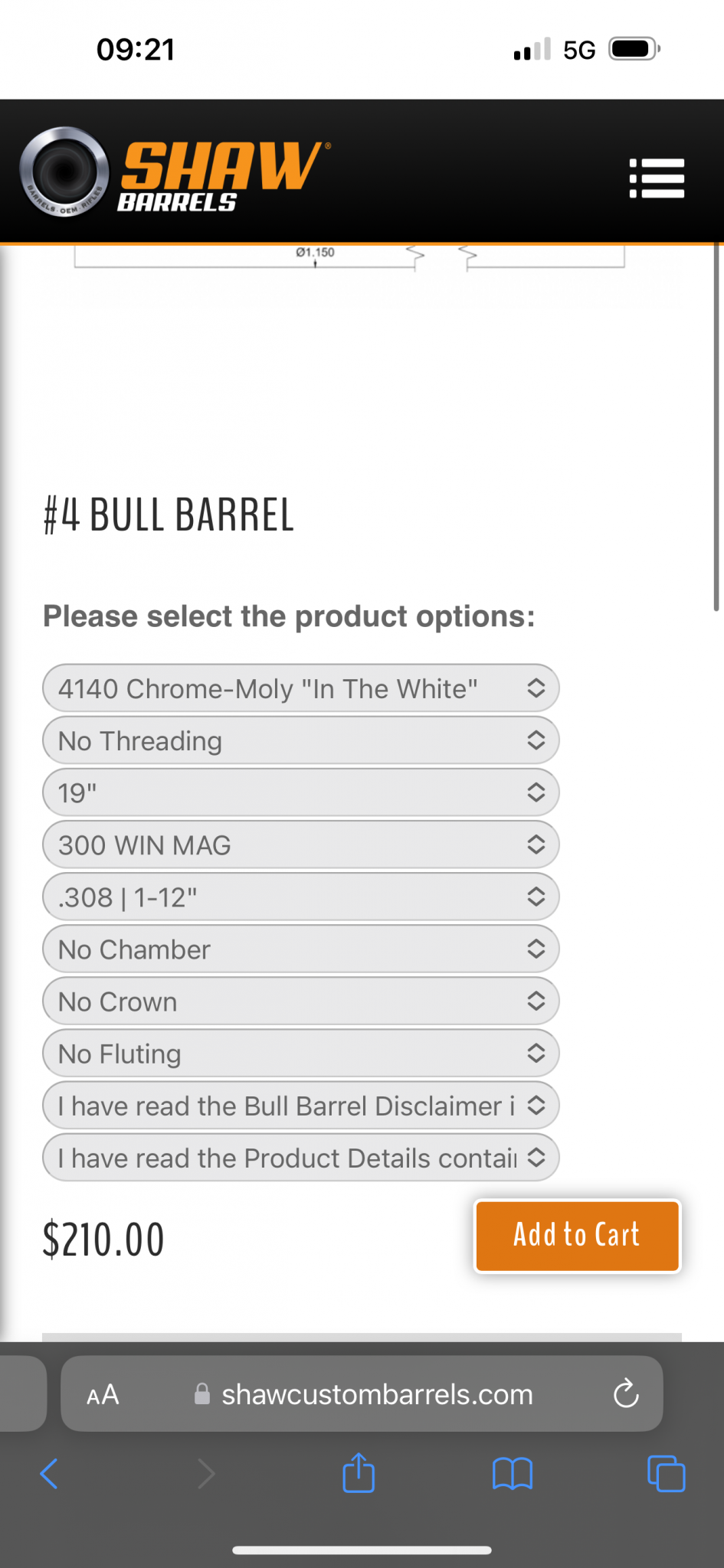

So I am right - it is a factory action. From the website - $210 blanks.

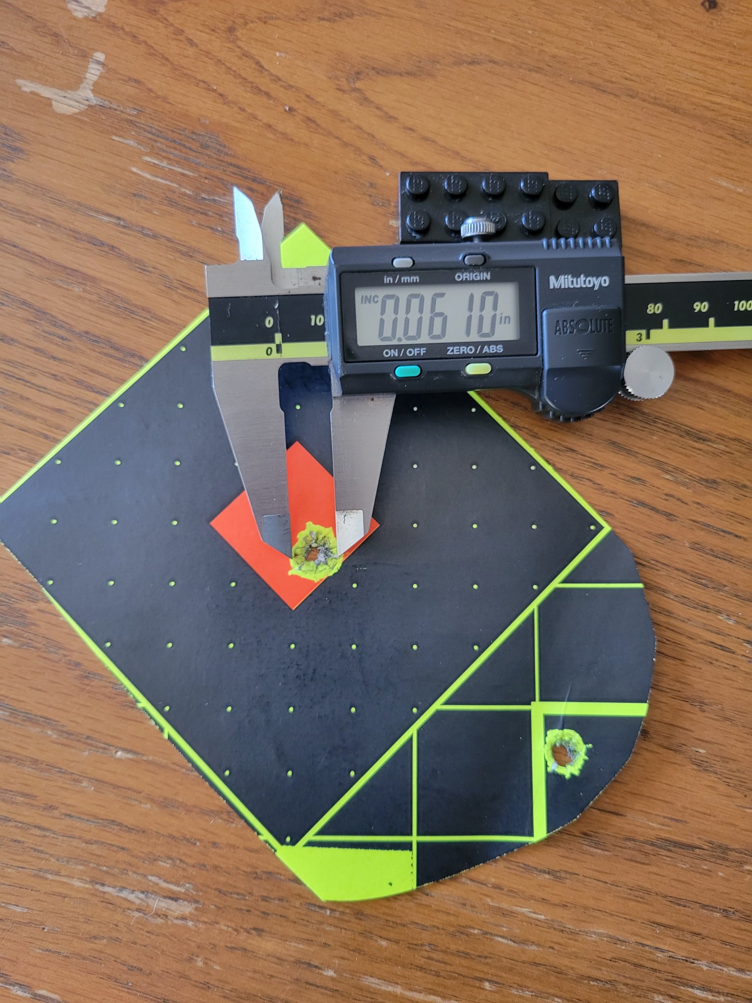

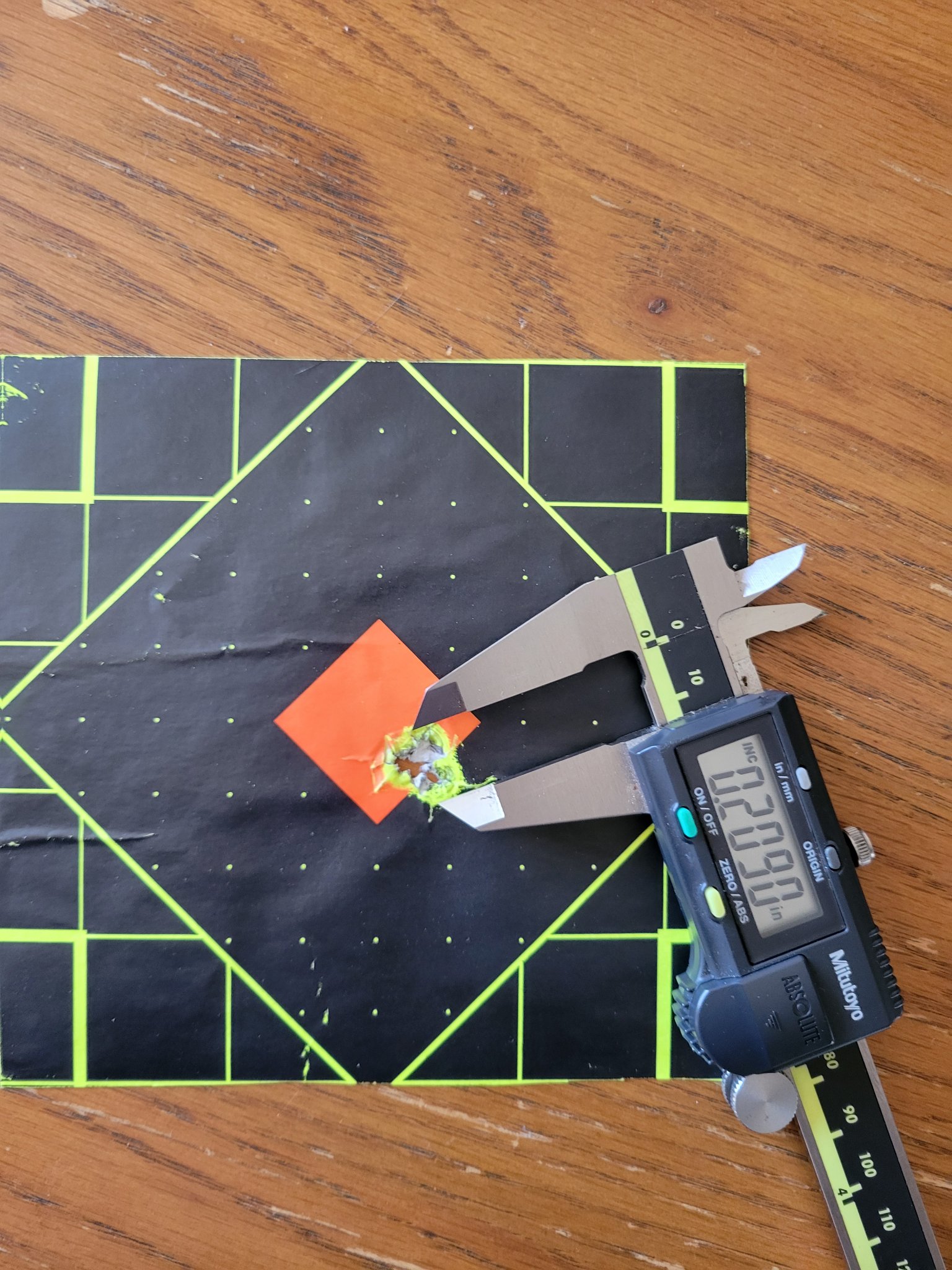

These two groups are a year apart. The first group only has four in the bull. First one was a sighter. Evedently federal knows how to load without load development. Calipers zeroed on a 308 bullet.

These two groups are a year apart. The first group only has four in the bull. First one was a sighter. Evedently federal knows how to load without load development. Calipers zeroed on a 308 bullet. View attachment 8406948View attachment 8406950

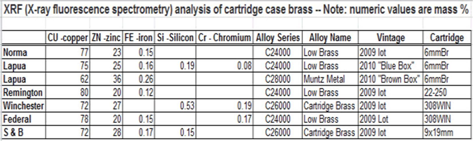

I've have lots of Federal brass that I've used (and still use on occasion) and they've performed well for me also. The facts are that the Federal brass is relatively soft and doesn't stand up to high pressure loads for very long where primer pockets get too loose. There's been many reports for them only lasting only 4 or 5 reloads. I've not had that experience as I've always got over 10 firings on them and my current batch has been fired 10 times and I run moderate loads and occasionally pushing max pressures. My Federal brass is not as uniform as some others, like Lapua, Peterson or Alpha brass, but with a little work they can be.
Here's an X-ray fluorescense spectrometry analysis that compares some cases, including Federal's:

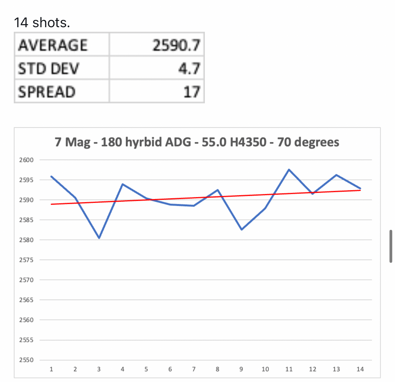

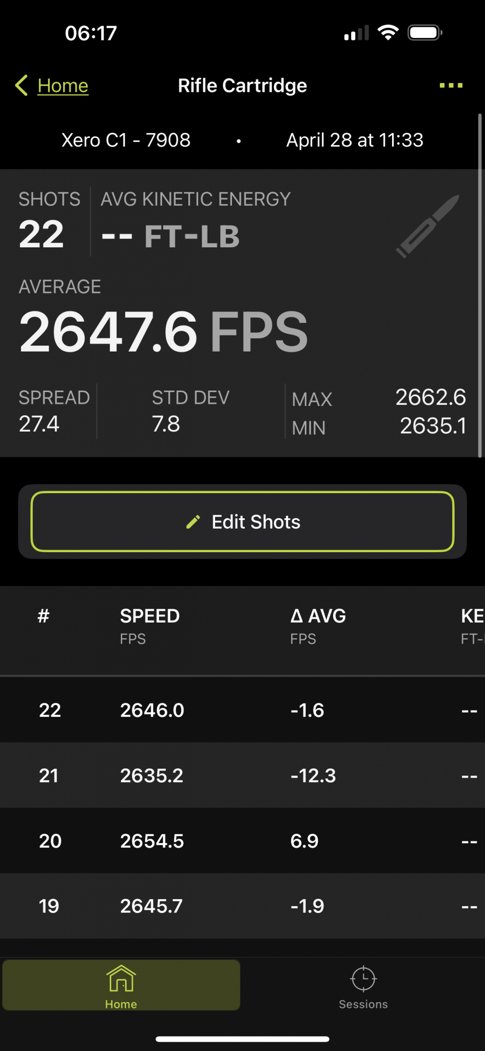

No you do not get a flat sloping velocity curve - that right there tells me you have never done one. If it’s so out there and doesn’t work how am I shooting such quality sds?

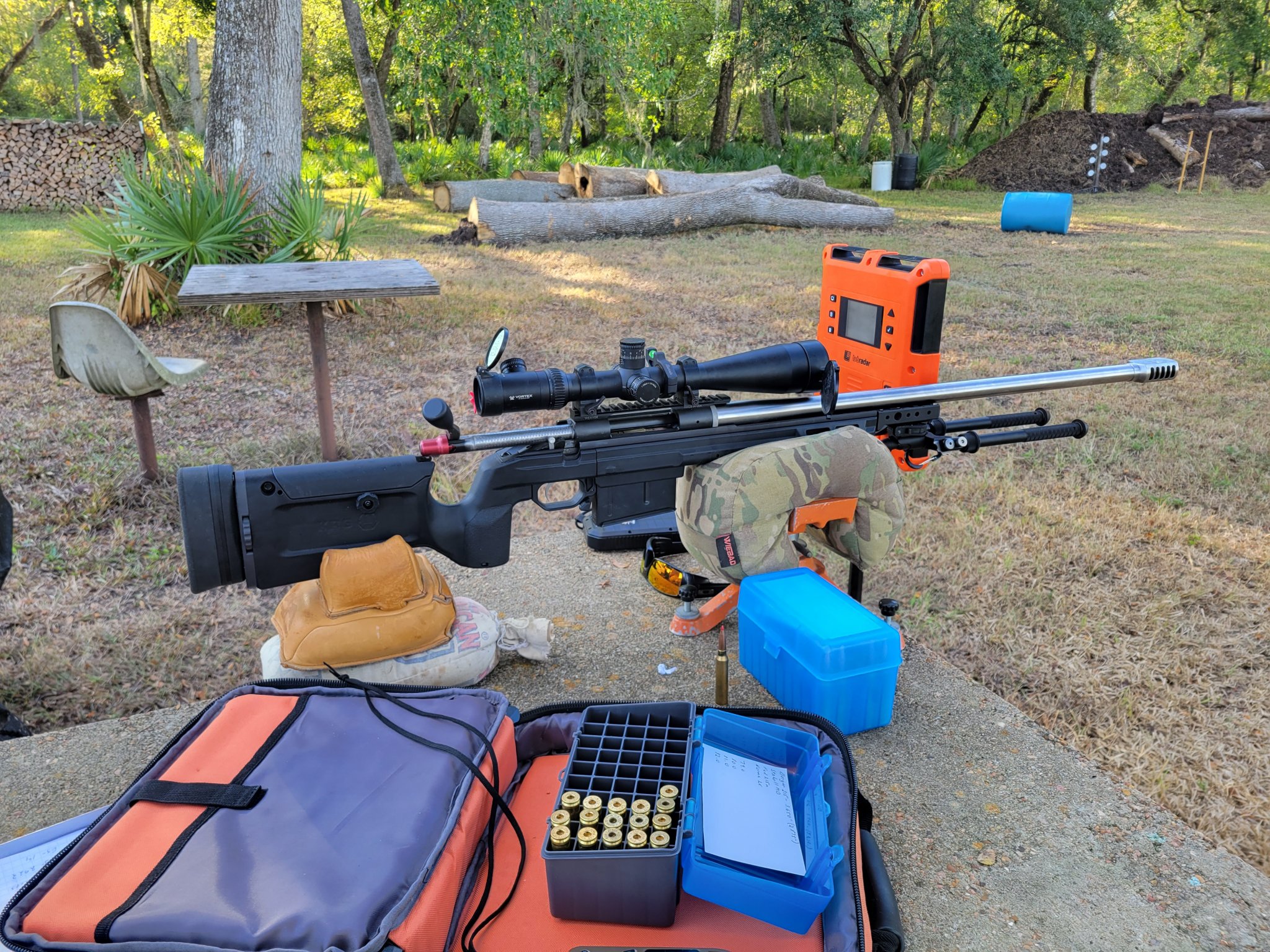

You’re gonna post some proof of how this is working better than my method right?? I have proof of it working…
Here’s more proof……
Reactions: Taylorbok
Here’s more proof……
Great, you shot 14 shots of a single charge over the chrono. Very nice.
How does any of that disprove what I said?
You’re saying you can’t do load development the exact way I’m doing it. My groups with low sd suggest it is working much better than you suggest it can. If what you’re doing is so much better let’s see a much better sd/ es????
To me - it looks like my method is better than others because it results in better groups than others. You want to throw shade at me? How about a single ounce of proof what you do is better than what I do? I provided multiple chronos including the one from yesterday.
People are always talking on here about how what they do is better but whenever I provide proof they suddenly disappear and don’t provide any proof to back what they are saying.
Before I found this place, federal and remington were my preferred choices. Always got decent results. If I could get down to 1/2" at a hundred I was happy. I rarely shot across a chronograph in those days though.
When I got back into a 300winmag again about ten years ago I bought 200 pieces of federal. Still have some of it. I did weight sort it. I've got a bad habit of leaning on my winmag pretty hard and it's held up well. Mostly shooting Norma in the winmag these days.
For 308 I've got a pile of federal from all the gmm I've shot. And a few pieces of lapua because some ammo I bought was loaded in lapua brass. I will say, it is nice to work with.

@Maurygold you said you shoot a 300winmag, I've got Norma brass, H1k, Fed. 215m's and 215 hybrids, give me a known good one. Trued 700 with a 26" bartlein heavy Palma. Throated to run a 215 right at the neck shoulder junction. I'd have to double check max oal but going off memory I think it was 3.715"ish.

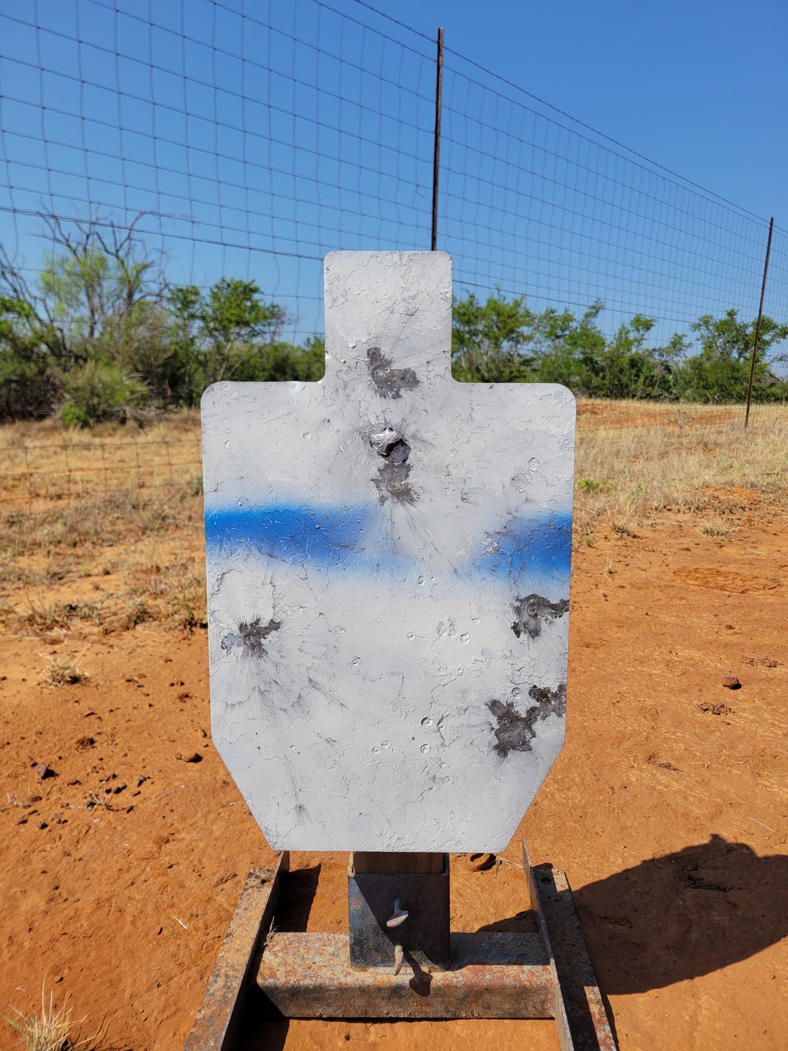

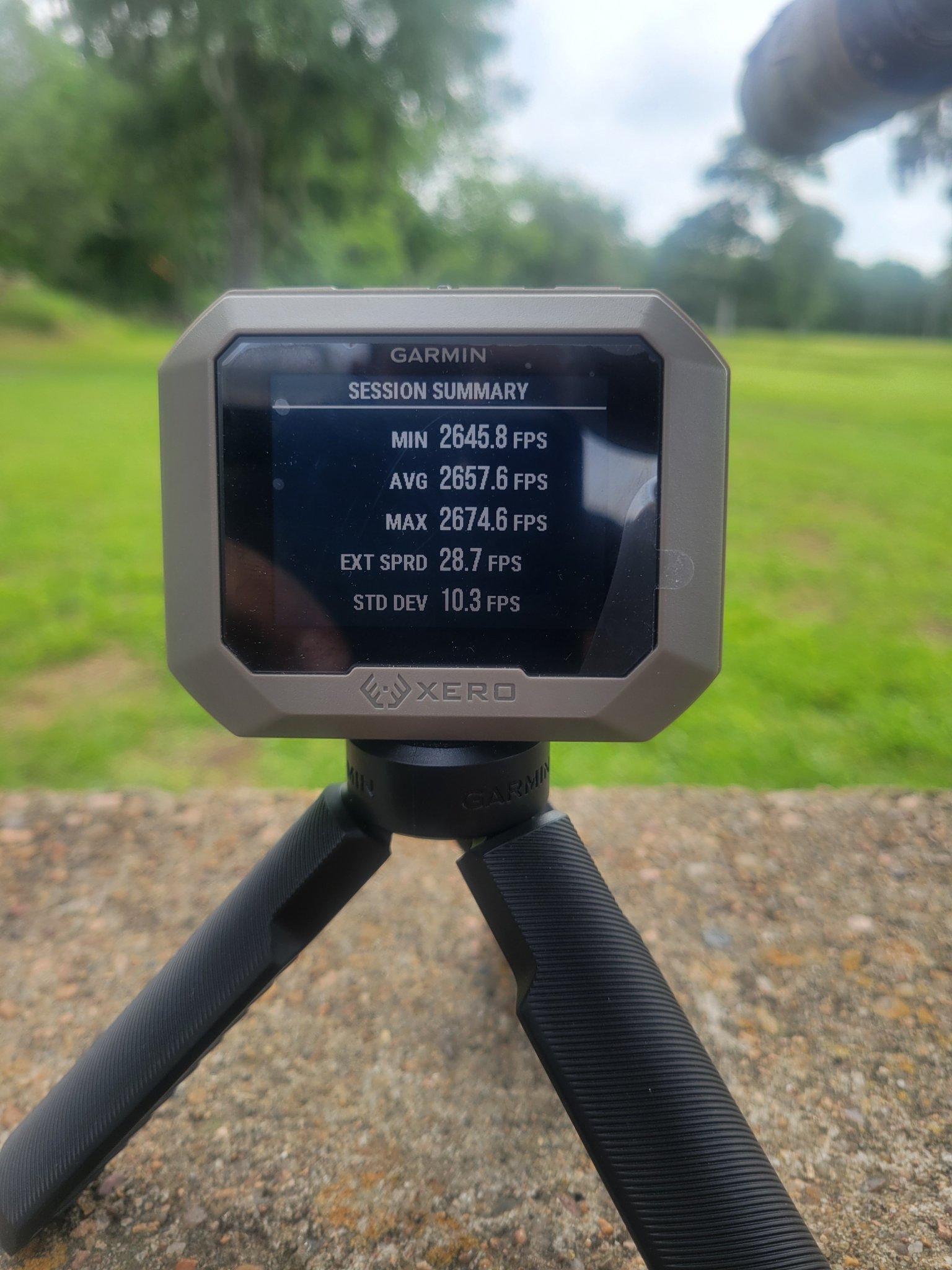

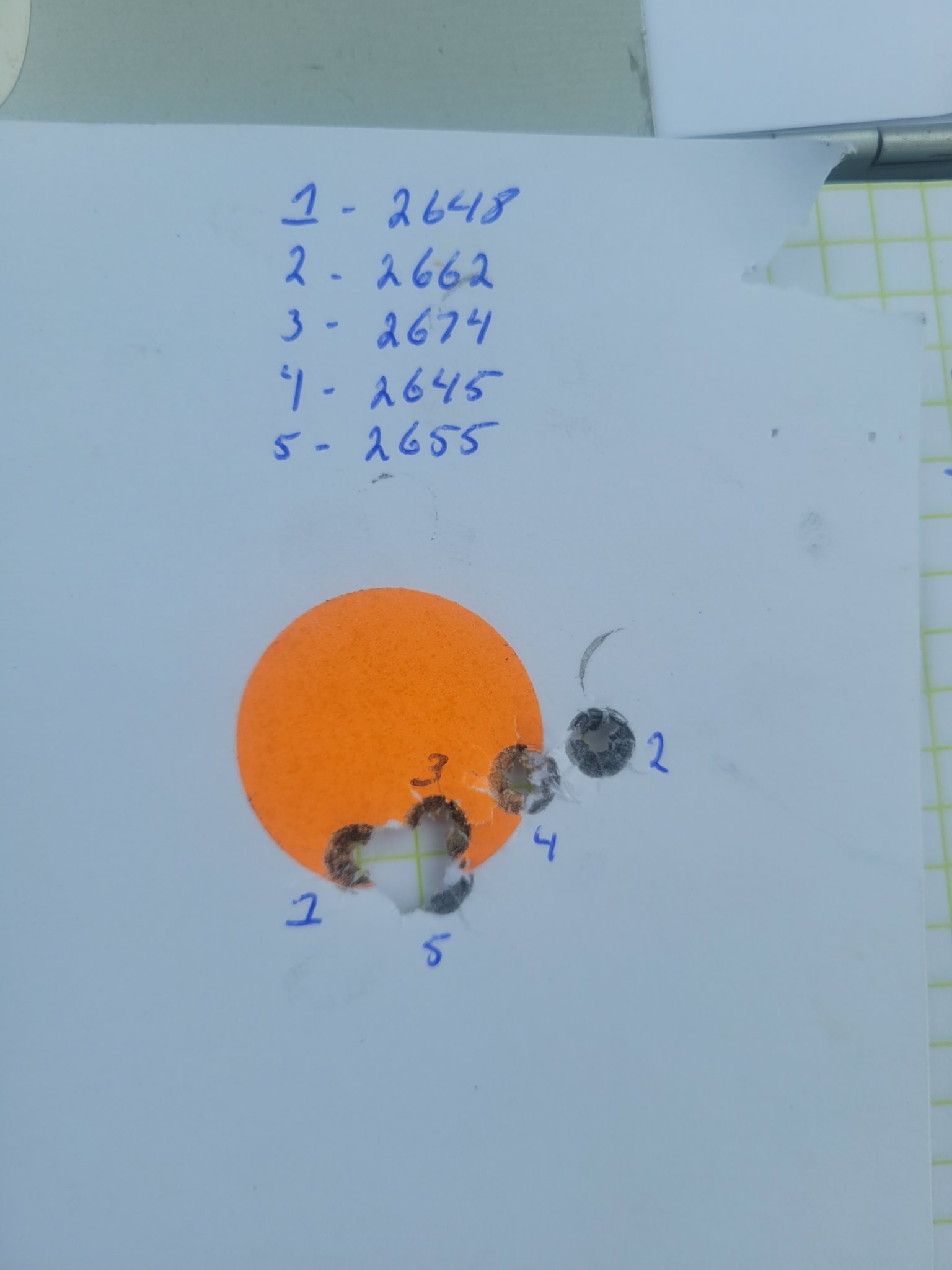

Pictures so you don't think I'm bull💩ing you.
Apparently my wife shoots it better than I do. Low right group is her first ever attempt at 1,000 (1,060 technically) with this rifle. 215 hybrids, and that mediocre magpro. 12x20 target.
