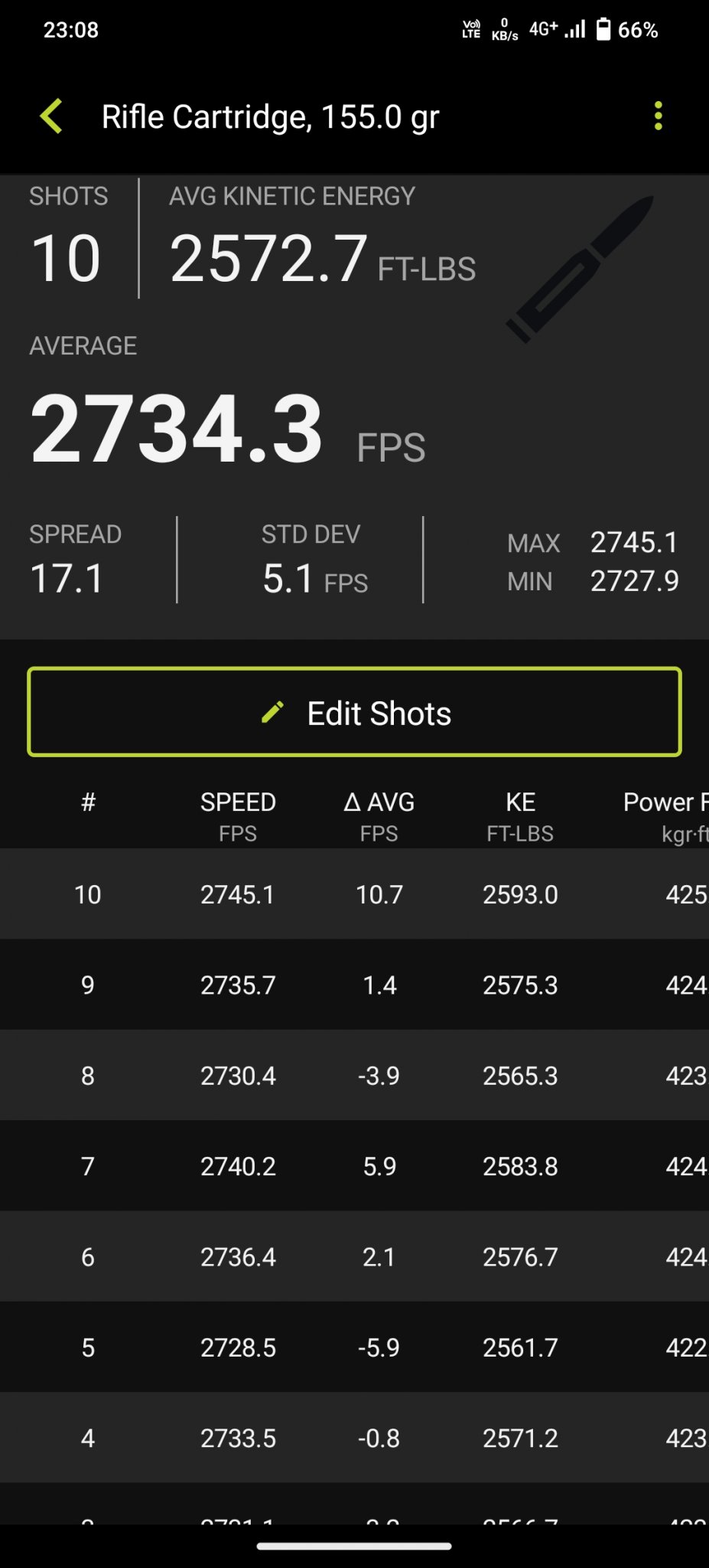

Does anybody have a "known good" load for a 155 in a 308 ?

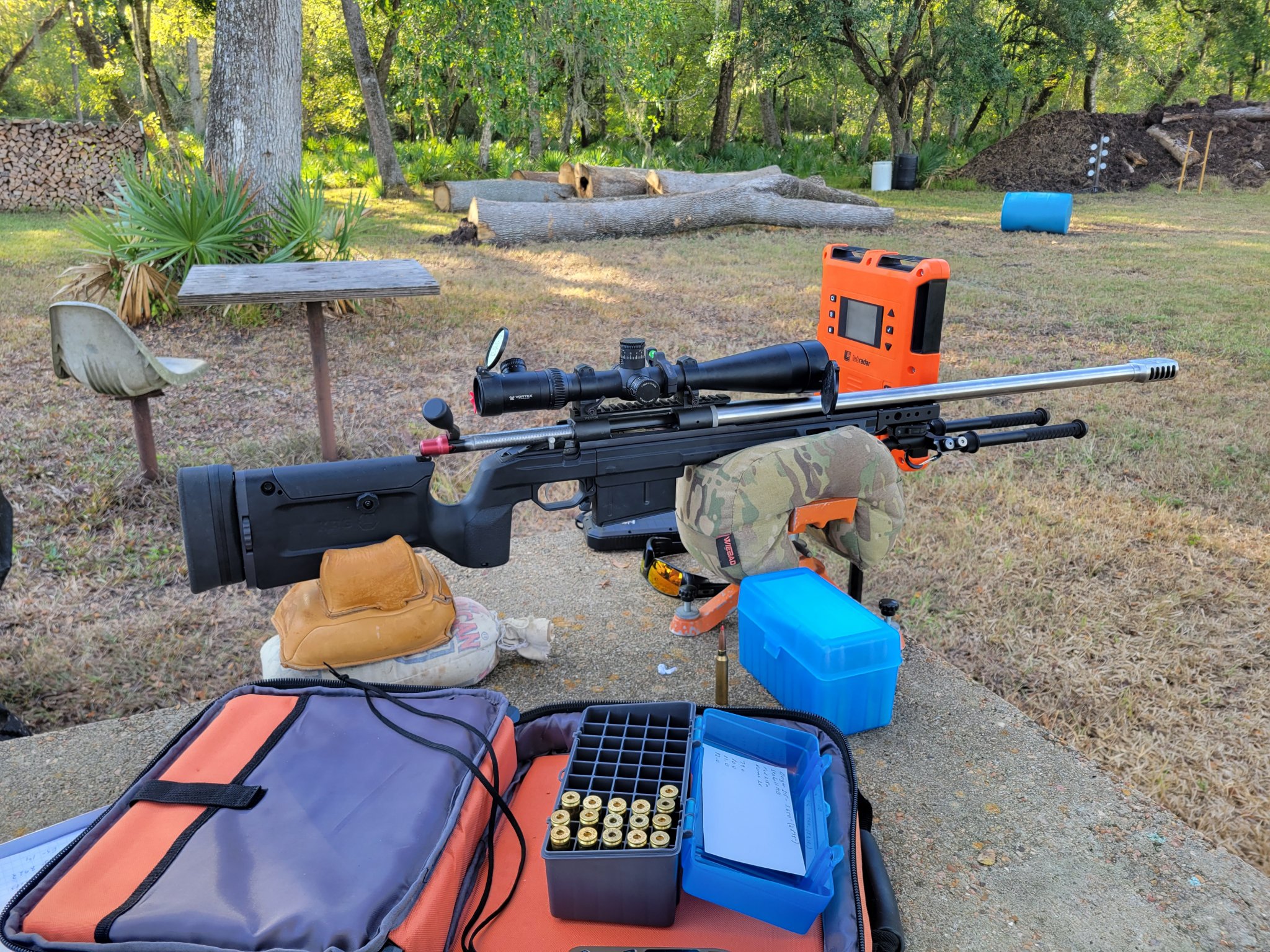

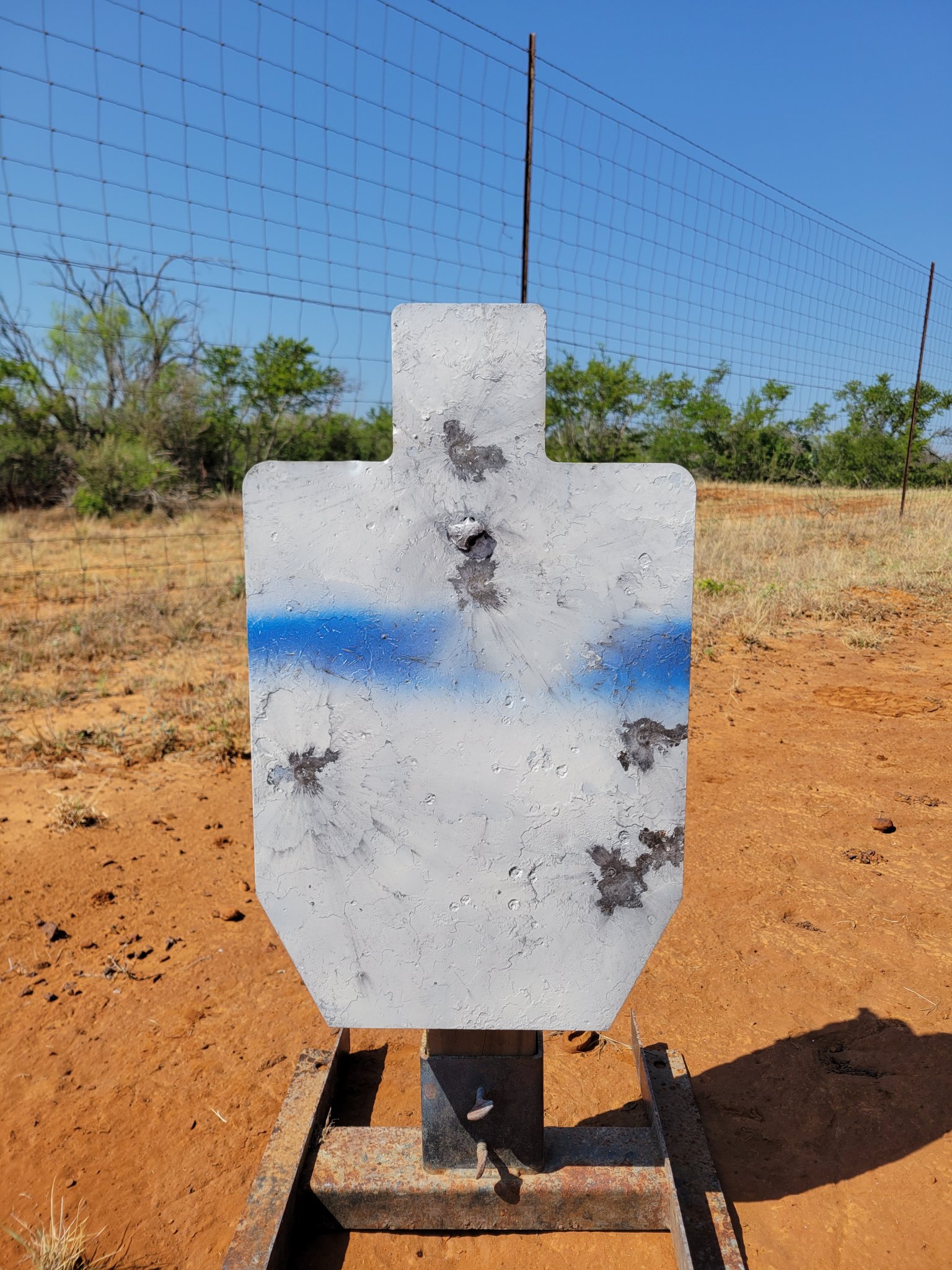

Pictures so you don't think I'm bull💩ing you.
Apparently my wife shoots it better than I do. Low right group is her first ever attempt at 1,000 (1,060 technically) with this rifle. 215 hybrids, and that mediocre magpro. 12x20 target.

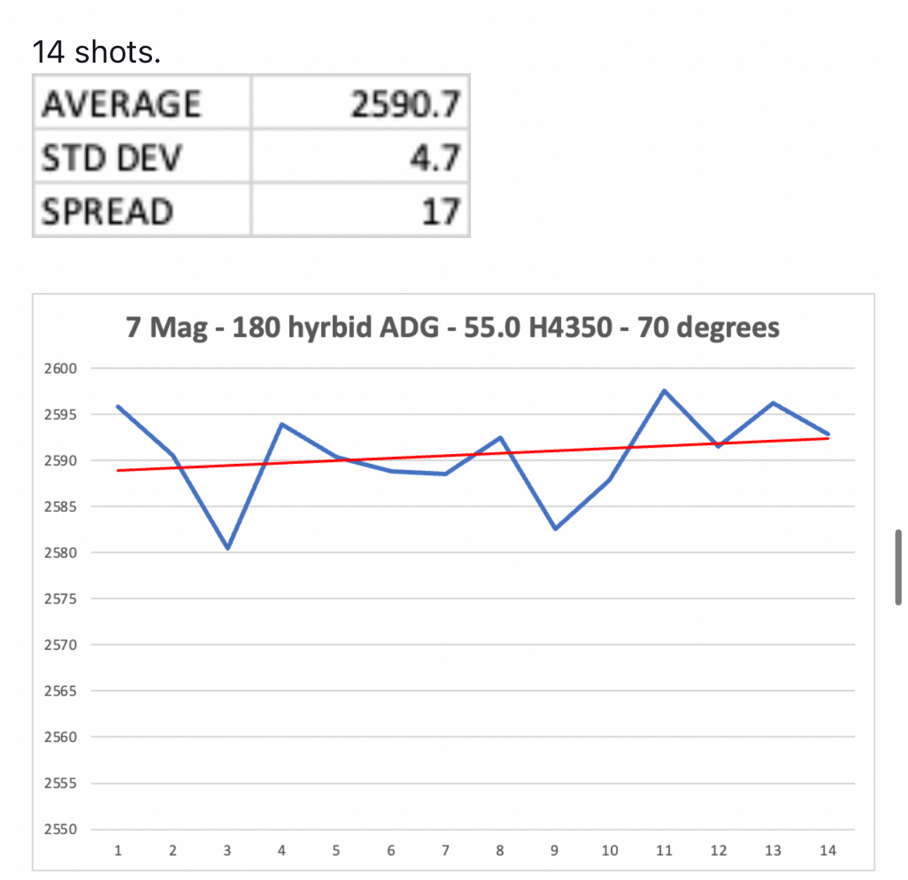

The graphs you've posted only prove your gun and ammo are shooting at a consistent velocity (proof of a well built rifle, good components, and a solid ammo production method). It does not prove that your chrono ladder method selected the single best charge weight and that all others would show a larger spread in velocity.

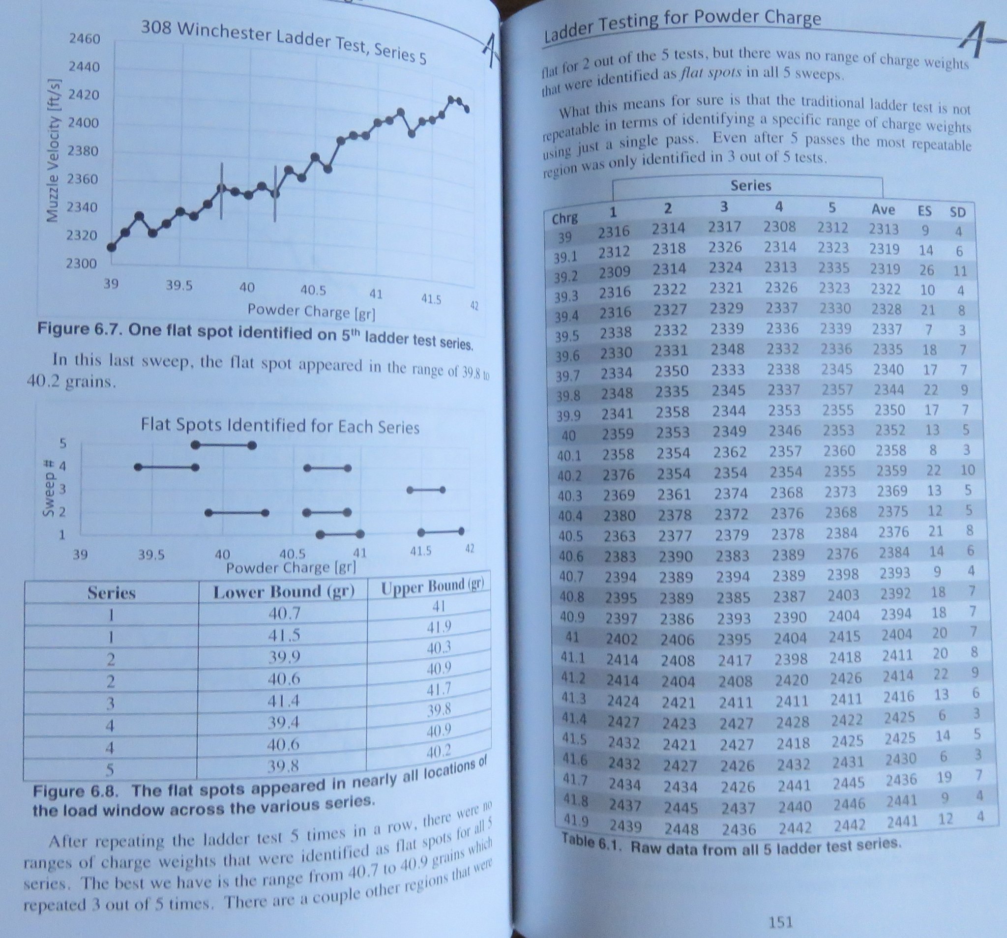

View attachment 8407140I think this concept was also mentioned in a hornady podcast as well.
More samples, straighter line. I think there was a caveat about once you’re pushing past max pressures you may see some flattening but I have neither the pressure test equipment nor the stones to go load 80k psi loads for funsies.

you shouldn't look at groups too closely or develop a load w/ less than 100 rounds down tube. That could clean up to be a great load.
I recently had to load for a brand new to me cartridge. Had 3-4 days over a couple weeks to make it happen. 33XC using F215M, Peterson brass, A-tips, Bartlein. I have my reloading process in general pretty dialed at this point. Had 3 powders to work with. I ran ballistics on speed, and with my goals/barrel length, came to a velocity range I would feel good with (~3050 fps).
Single rounds of 10 different charges of H50BMG from 2778 - 2990. N568 from 2835 - 3054. N570 from 2839 - 3046. Did this to check velo and pressure. So now I know what charge weights I should be working with.
These are not big sample sizes, I know, but I feel it got me what I needed. 5 shots of 2 different charges for each powder. the SD for H50BMG were 7.0 and 5.6. N568 were 4.4 and 2.9. N570 were 5.3 and 4.3.
From there I decided N570 was going to burn the barrel out too quick. H50BMG was a little too much case fill I thought. N568 was a nice all around compromise.
Ended up with a load of N568 at 3065 fps that put up a 20 shot SD of 5.2, and lots of 1/2" 5 shot groups at 100y.
Never touched seating depth at 20 thou off.
6 different charge weights, 3 different powders, all shooting mid-single digit SD. I get it's a little different on the big magnums, but still...

@MaurygoId, alright, I got out a few minutes ago with your reccomended 78gr of h1000 in Norma brass lit by a 215m. 020" off the lands overall length was 3.718", 2.935" base to ogive.
When I prepped cases last night every piece of brass came out of the die at .305" inside the neck. I think it has a .311" bushing in it. At .305-.3055" I didn't even bother with running a mandrel through them. I tend to like a hair more neck tension myself. But, for the sake of trying it, I'm about to run three pieces through the mandrel and see what effect it has. After running a mandrel through them they're at .306-.3065"
So far this is where we're at. 78 was a little warm. Left some pretty good ejector marks so I backed off to 77. Sd came down and it tightened up a bit. Almost loaded and shot it again but sd was high anyway so I abandoned ship. Pretty sure I blew #2 as my rifle twisted in my hand when the shot broke. Poor form on my part. #3 went through #1.
On to 76.5, group had a nice shape to it the way it worked out, but I think there's more to be had. Going to see what that ec tuner is all about. But that's a topic for a different thread.
clockwise from the bottom, 78, 77, 76.5, three shots each.
