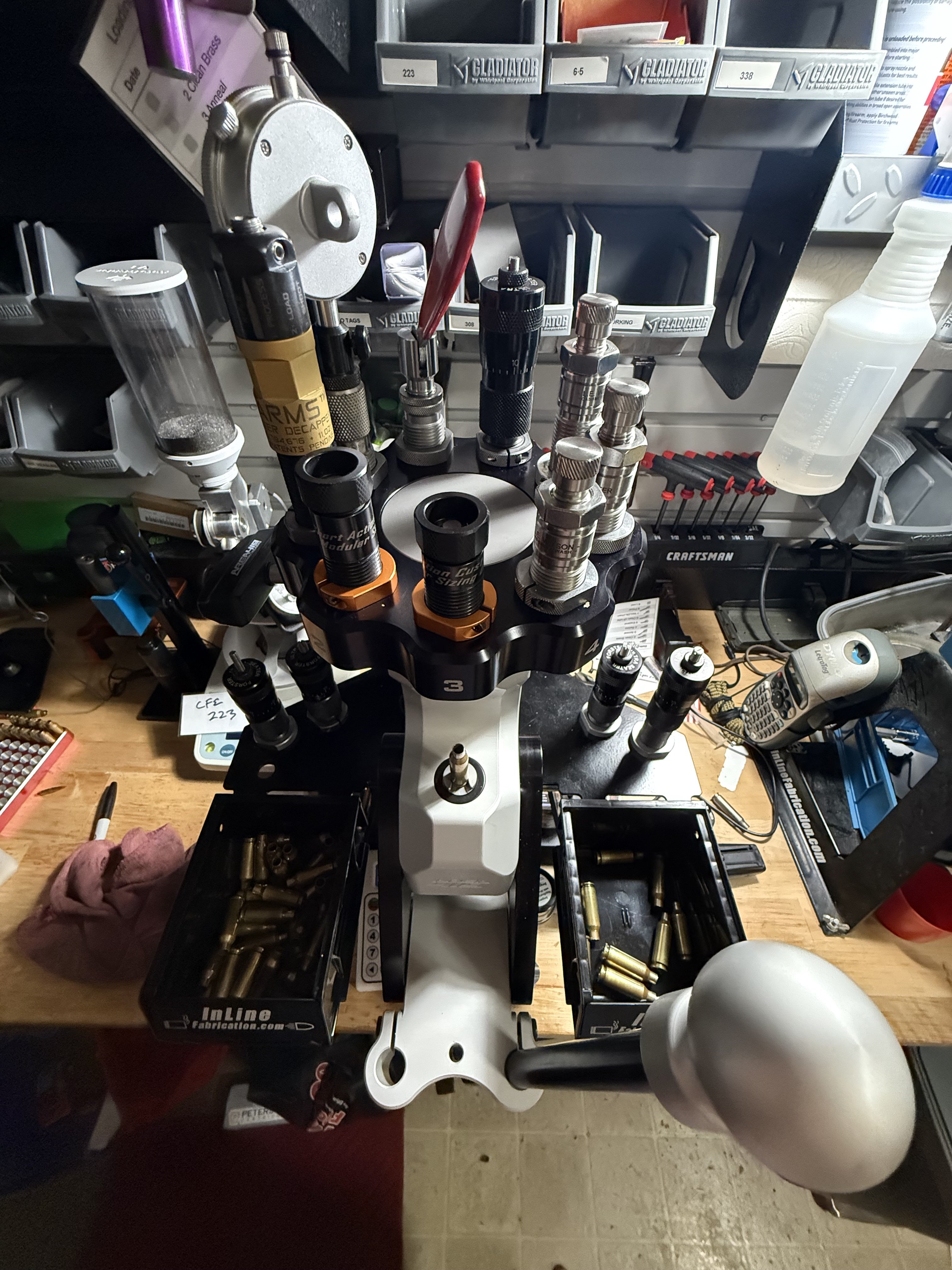

    My Inline Fabrication articulating arm mount with double bins came today. Had one of these on my 550c setup and used it every loading session.. put your ready to load brass in this bin and bullets in the other to grab and put in shelholder, then drop loaded round in the lower bin.. or put your lubed brass up top when sizing and drop sized brass down below. Love the Inline articulating arm!

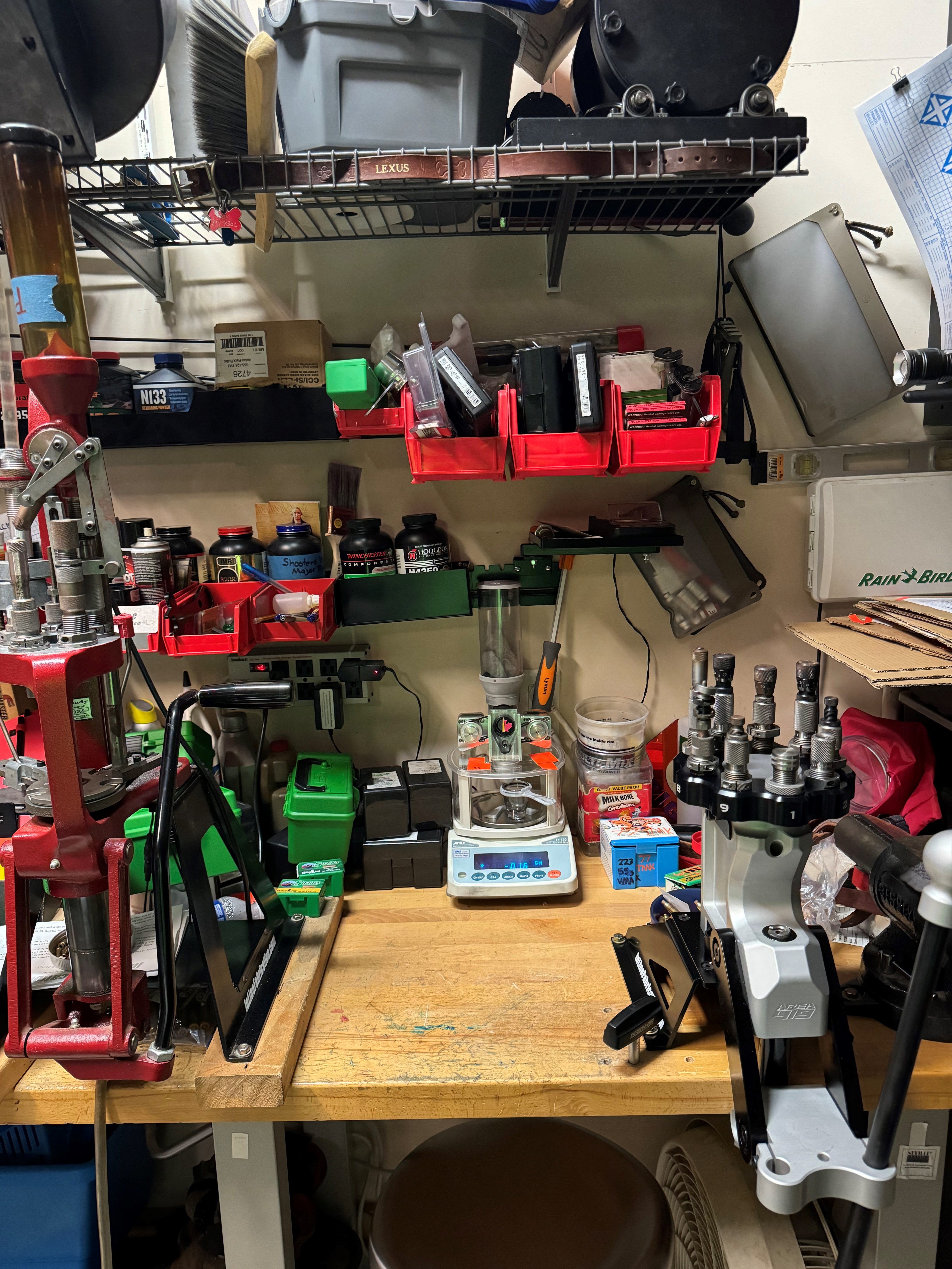

    Got mine on an inlinefab mount. I'd have more accessories for it, but my bench is too small... LOL.

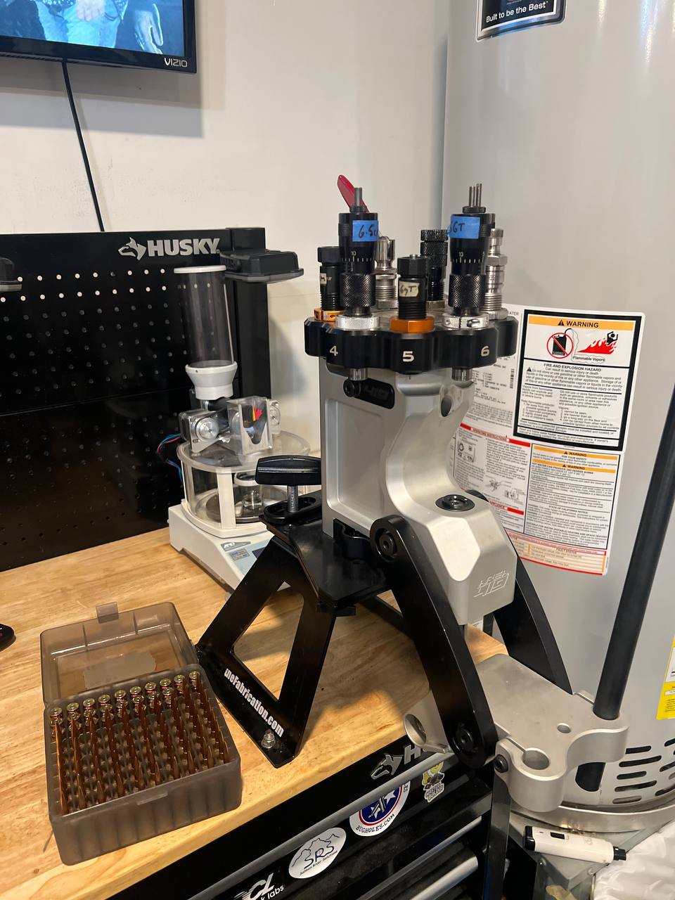

    I like my Zero a lot.
