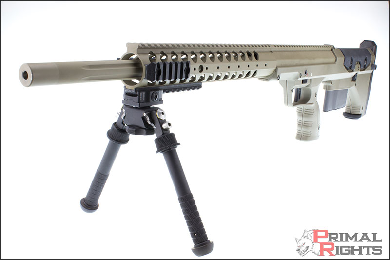

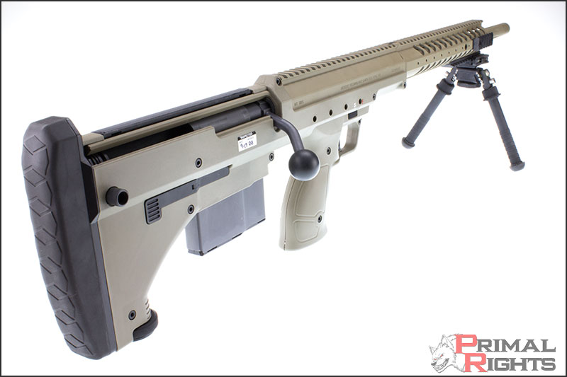

Available for immediate delivery: $5500
SRS-A1 FDE/FDE w/monopod
26" TS Customs 6.5CM conversion, Cerakote FDE, Straight flutes, Threaded 5/8x24 w/ Stealth thread protector
Includes bolt spacer and one magazine
Accessories in stock and ready to go with it:
Seekonk 70in/lb torque wrench
SRS bore guide
Atlas Bipod
TAB Gear sling in FDE w/ HD Recessed-button sling swivels
Extra SRS magazines
Desert Tech Scope Bases
Optics
SRS Soft Cases in FDE
... and much more!
Free TAB Gear Rear bag and Free shipping with order.
Package discounts available for Hide members!
