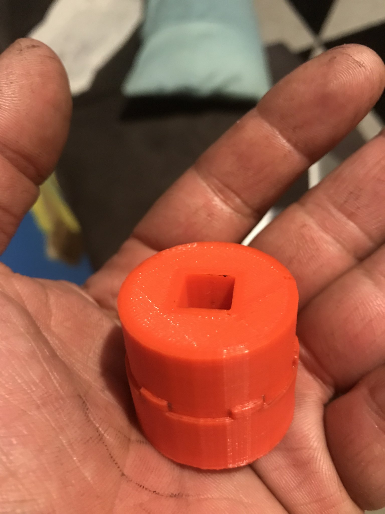

Had a few people ask for the .stl file I made up for the 3d printed hand guard tool so ive put it up for you all to use, ive now seen the OEM tool and my rendition looks nothing like the original tool so there is no way breaching any intellectual property or anything like that. It is plastic after all so I dont expect a printed tool do last all that long and im sure it could be designed better but it works and will probably last a few uses before I see the 3/8" drive failing. I printed mine with .2mm layer hight, 2mm wall thickness, 30% infill and 2mm bottom and top layers in PLA plastic. Maybe if it was solid with no infill and from ABS plastic it might last longer? I have done this to help out the DTA owners of the hide so please dont distribute the file (or sell it, need I point that out...) Anyways enjoy and I hope it can help someone out.
I now know the original is obviously made of metal, is a 1/2" drive and maybe 1/2" thick, my plastic one was meant to snugly insert into the nut and grip.
  • DTAtoolSRSA1.zip
Reactions: Imho
This STL file opened up as almost a partial shell for me, any chance it got corrupted or you could email it to me?
Hi Tyler, I will look into it when I get home from work, it’s the same file I fed into cura so it should have worked unless something went wrong when I uploaded it. Pm me with your email and I will send you the file and see if that helps. Can I ask what program your using to open it with. I made the file on sketch up and tho I can design and print stuff I’m far from an expert at it so it might be something I did during the creation of the model. Thanks for the feedback tho

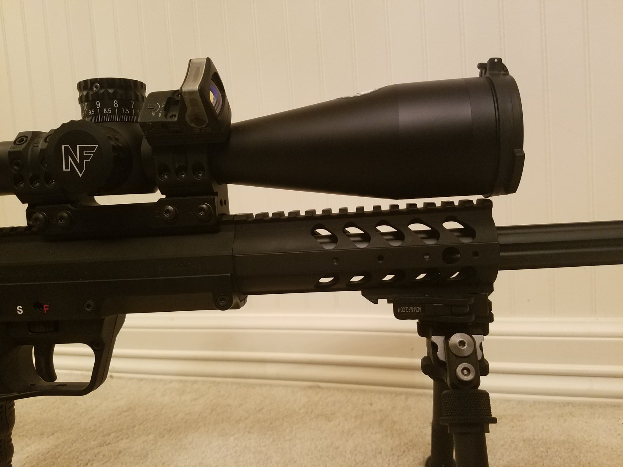

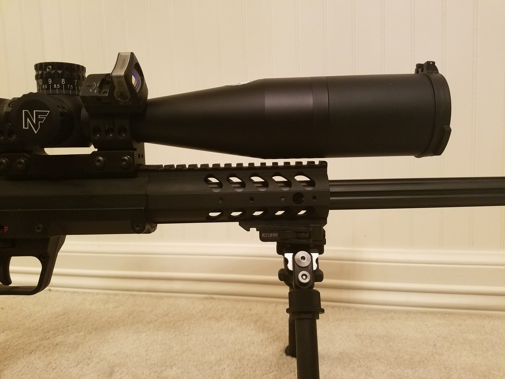

Will a Sphur 4602 mount clear a 56 mm objective with room to add caps of some sort or is there a better height than 1.5"?
Twitch, for me the 1.5" is the sweet spot for scope mount height for cheek weld on the srs. I have a Nightforce ATACR 5-25x56 mounted in a Spuhr SP-4902 (1.5", 30 MOA) and I have about 0.145" clearance between the top of the picatinny rail and the OD of the objective. I have the covert rail so screwing on the NF caps is fine with the sunshade and it takes a bit of finesse to get it on without the sunshade. If you have the longer SRS A1 rail, you will probably need something similar to the two piece nightforce caps with the removable tenebraex threaded insert.
