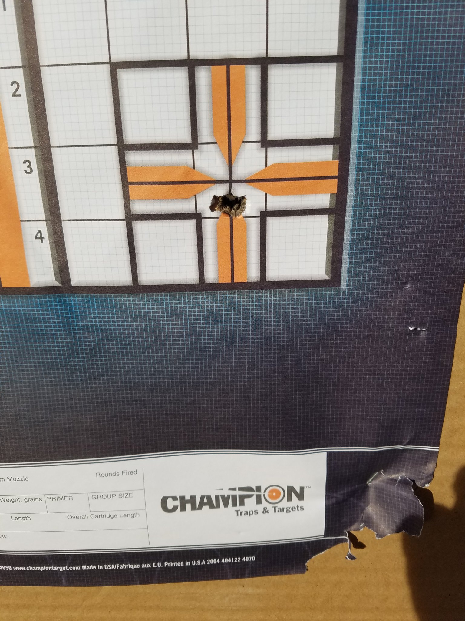

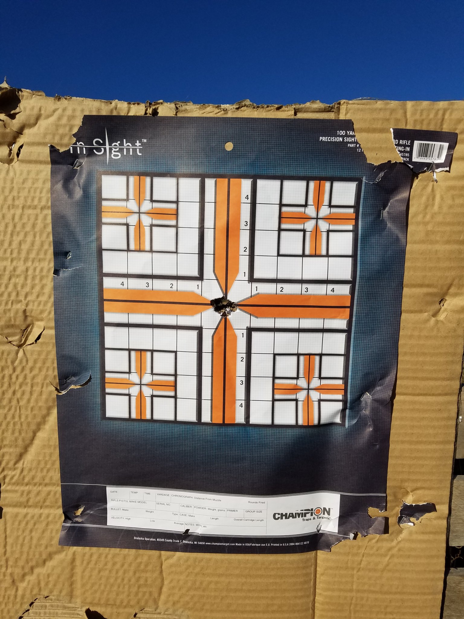

Another awesome shooting barrel from ES Tactical http://www.es-tactical.com/shop/Desert-Tech/ES-Tactical-SRS-Barrels--Conversion-Kits.htm. This was during load development at 200 yards using the 285gr ELDm. About shit myself when I saw this group develope. I know I know it’s only four shots but I only loaded up four shots for each of the different seating depths. I’m learning the 338 Lapua Magnum is a finicky cartridge that is not easy to load for along with being very expensive. It’s a 32” barrel and I believe I am getting about 2900fps. My magnetospeed dies half way through the charge range. I didn’t know this but they have a 2 year warranty thank god.
Very impressive! I struggle to get groups like that at 100 yards with much smaller cartridges than a 338 LM.
Very nice shooting and congrats on a great barrel.

Thanks man. I have had some good groups before but never this good. Absolutely my best group ever. I just hope the finicky 338LM will keep shooting like this or close. I believe a big part that helps me shoot this 338 is how heavy the barrel is. A good length of the barrel is 1.25” diameter and ends at 1.100” at the muzzle and is 32” long. The rifle weighs 24lbs so not something I plan on hiking with. The fat bastard break helps a ton as well. I have shot 100 rounds in one day and zero pain or soreness and I’m not a big guy either.

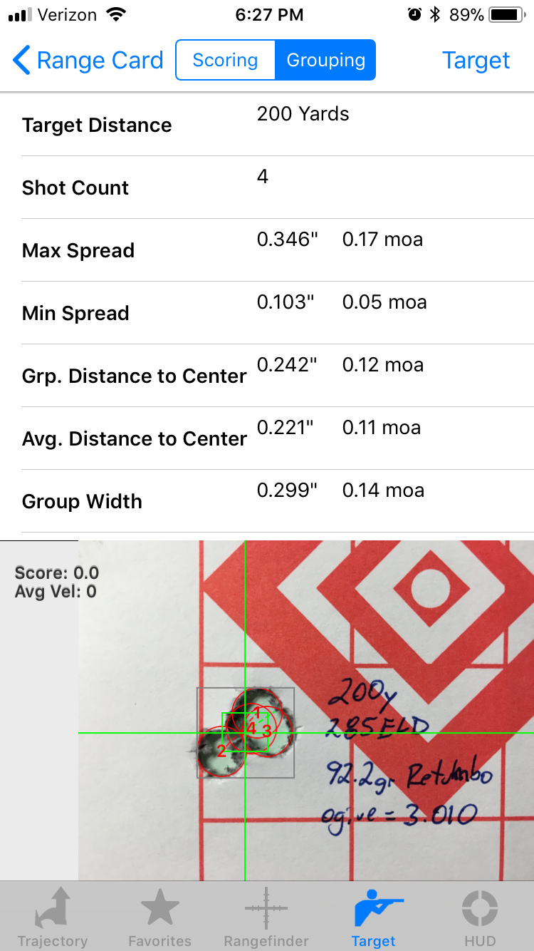

During barrel break in last weekend I loaded up some cheaper 230gr ELD with H1000 and saw 3200fps for 97.0gr. Not sure if Retumbo would run faster velocities with a longer barrel?
I do plan on trying the 285gr and 300gr bullets after breakin.

So far I haven't had much of a chance to do anything with this barrel. The weather turned to crap and its been too cold to shoot. All I've done up to now is run the ammo I loaded for the factory barrel which was 250 gr Sierra Matchkings in Lapua cases with Fed LR Mag Match primers and 97gr of IMR5010. This was giving me 2920fps in the 26" factory barrel and .4" groups at 100. I didn't run the chrono with this load in the new barrel and probably won't since I ran out of the 5010 and won't get any more.
My thoughts with the new barrel were to work up loads for the 300gr bullets and some of the slower powders like WC868, WC872 etc. I wasn't that impressed with retumbo. H1000 was killing brass and primers with a lot less velocity than any of the others I tried so I didn't use much of that one.

Thanks for getting back to me on the long barrel. Interesting to hear your results with the H1000 and Retumbo. I tested H1000 and didn’t like what I was seeing. Retumbo has been much better so far. I’m hoping for low SDs with this load I have for the 285gr bullets and will confirm as soon as I get my warranty magnetospeed display this week. Going to test the 230gr bullets with Retumbo as well but the sample 5 shot load I quick put together looked promising so far. Of coarse with slower speeds than with H1000 but good group and decent SDs.
Please let me know what your results are when you do get some good weather.

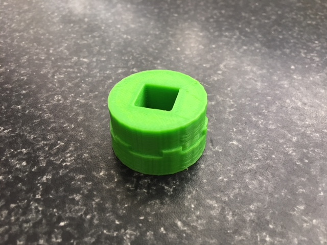

Reactions: KillerJoe and Imho

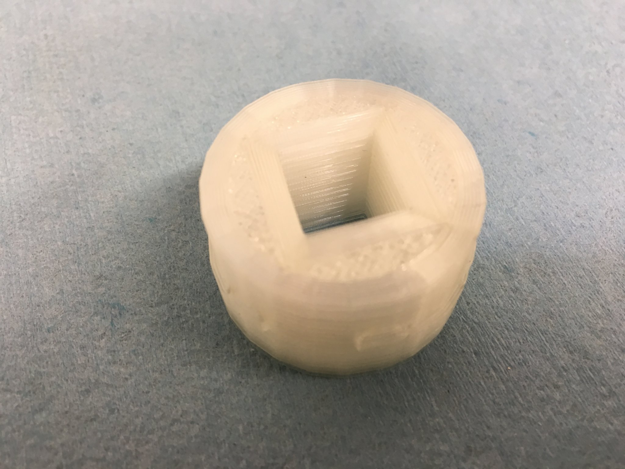

Awesome to see others enjoying my contribution! As a tool for a full time gunsmith I think it wouldn't last long but to keep in your range bag and get you out of a bind in the field it should work well! I did find another member close to me willing to help me out but for reasons I wont go in to (snowflake on FB had me blocked after he lost his anti gun argument with me) I had to improvise so I put my 3D printer to work.
Reactions: Juggerxxx and Imho

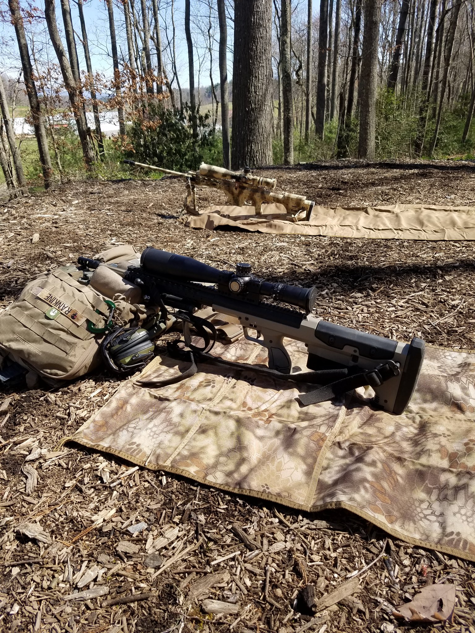

Sounds good, hard to find any load data. I have the gen 2 version in the pic is a 26 inch 6.5 creed. I have the 22 inch .308 as well as well as a 300 win mag. Have not shit the 300 yet. Still working on loads but will have info soon. Also for people that have dead air suppressors they are releasing 3/4 inch muzzle breaks to fit dt barrels. Been waiting,using a reducer now.

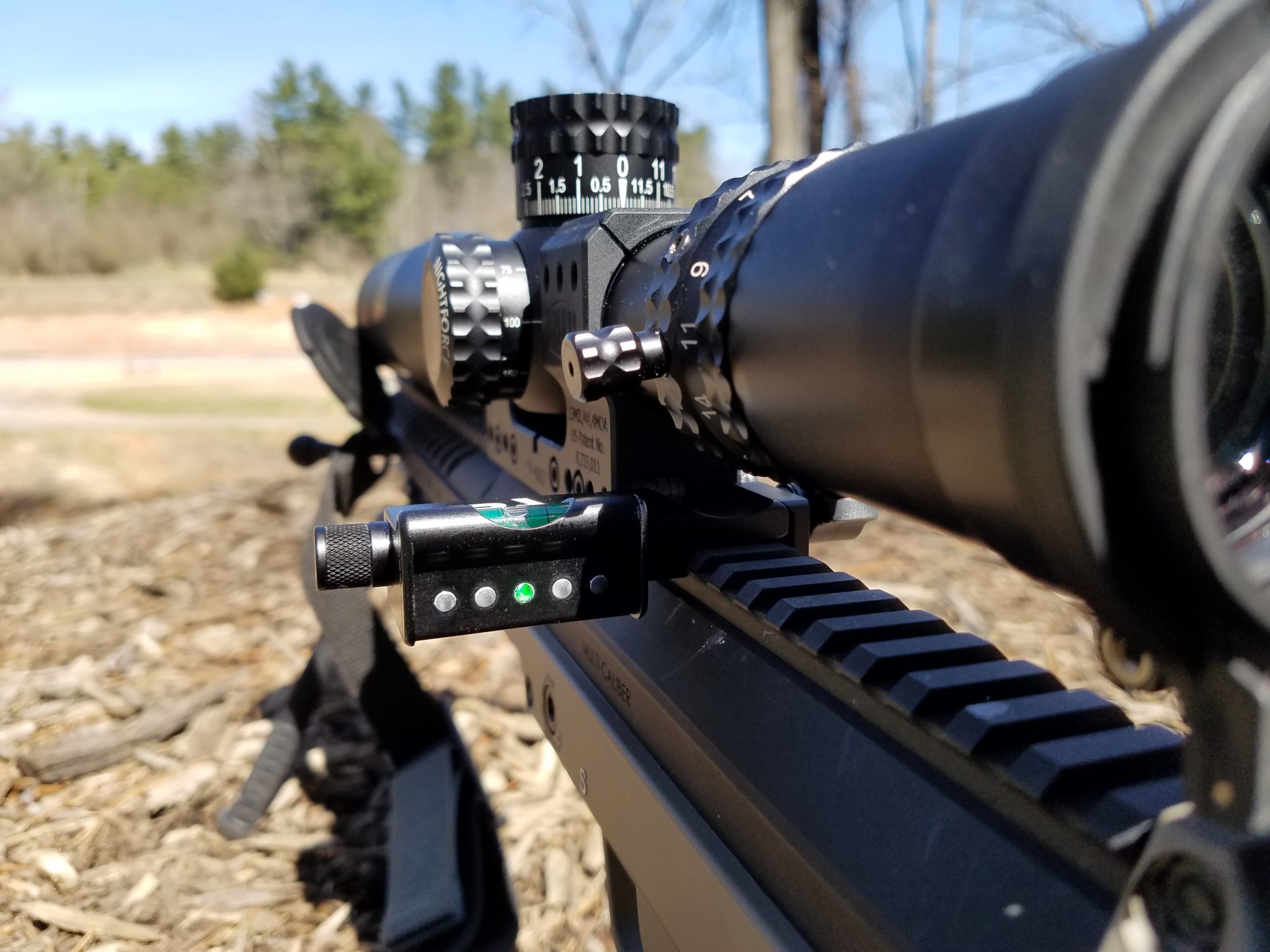

Finally got the optic on and fired 9 rounds on the 338. Easily sub moa with my last 3 shots. First time with a 338. I'm very impressed with the recoil and sound, thought it would be a lot worse over a 308. Mag load and hand load worked great. Will be turning the digital level vertical once I get the Spuhr rail attachment.

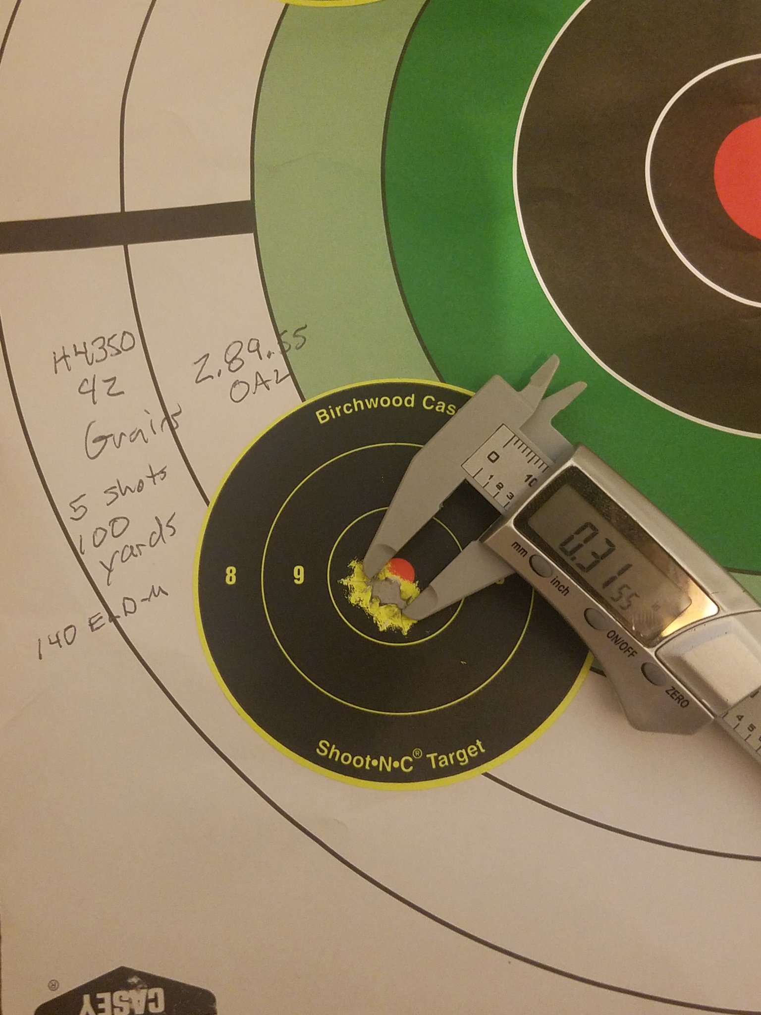

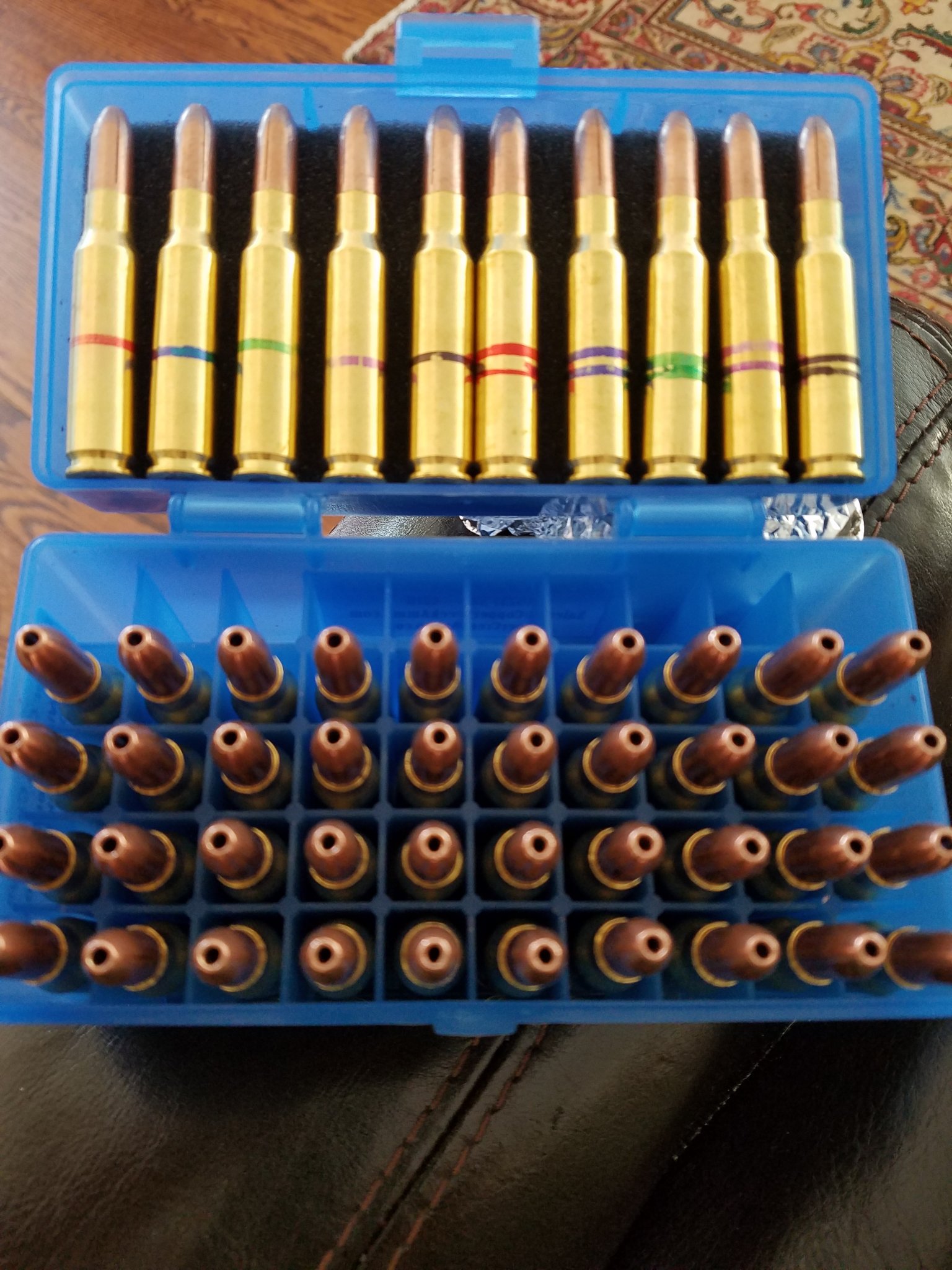

I'm developing an expanding 200gr. Maker REX Subsonic load for the DTS 16" .308 barrel with Josh at copper creek. I have 10 trial loads in hand, 5 of each and I plan on shooting over my magneto speed for Velocity and SD. Ill also post bullseye cam photos with spread evaluation at 100 yards.
Let me know if anyone is interested in my results.
