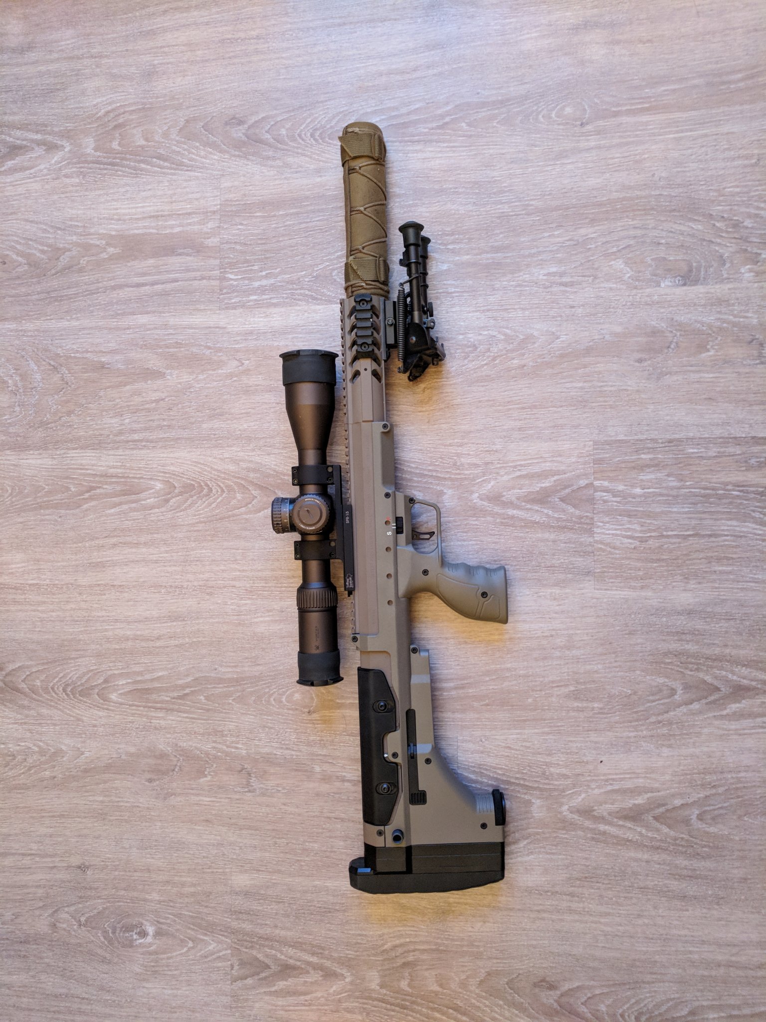

Just ordered the srs covert lefty in fde, should be here in a few days. Getting the barrel and what not done from SAC. I have vortex razor gen ii 3-18x50mm on a larue mount. Would that mount suffice or should I get the one from desert tech? I'd rather not spend more than I already have lol. Btw anyone in Maryland on the Eastern shore know a good range to go to? Thanks
Welcome! Hopefully you enjoy it as much as the rest of us have. My original Covert setup was also topped with a gen2 razor. Great scope for the money. You’ll be a few barrels in before you even realize it haha
