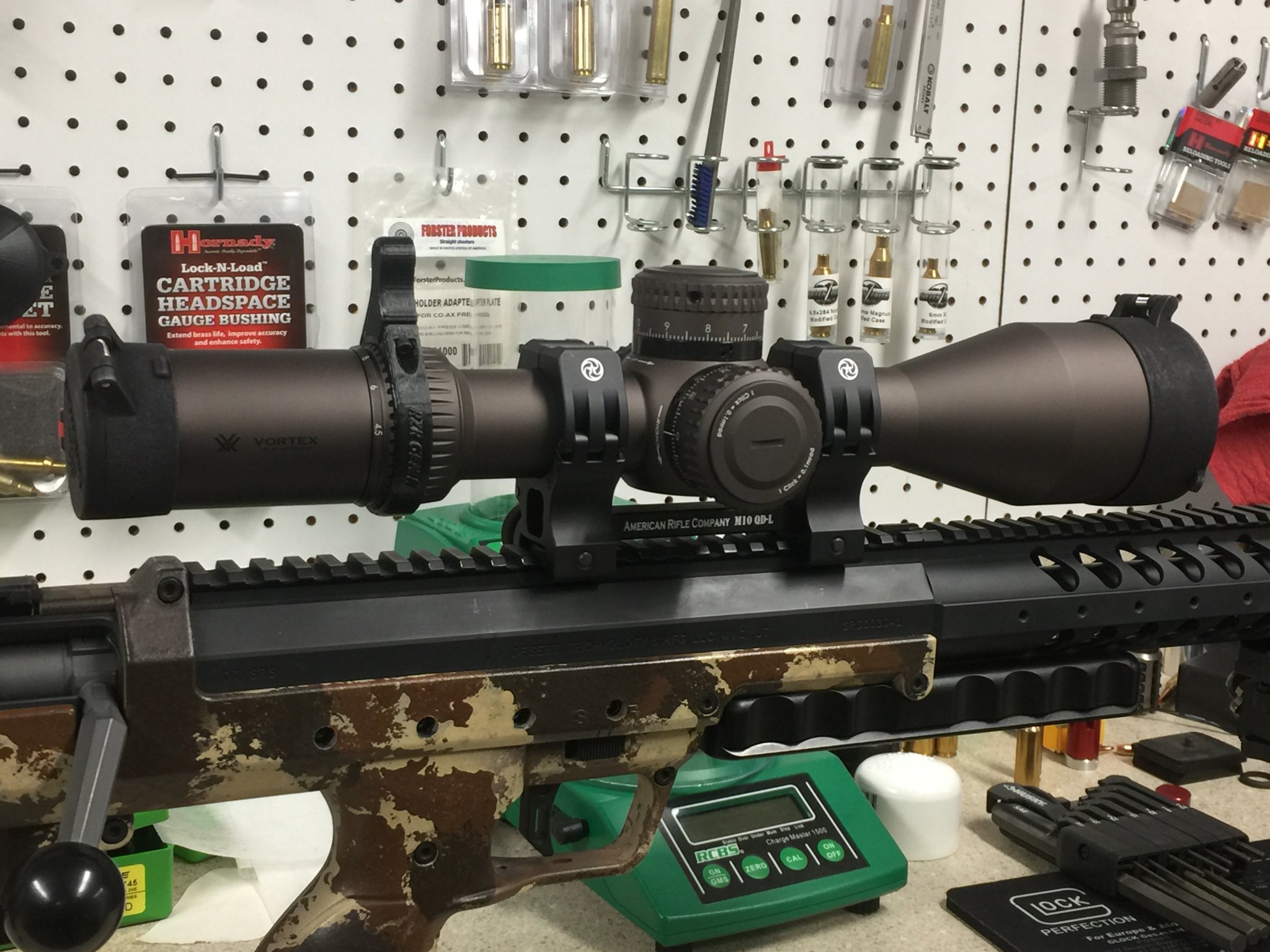

I'm using the American Rifle Company M10 mount on my SRS A1. I have a Spuhr mount on a different rifle and it is very nice, goes without saying. I have a bit of a "man crush" on Ted at American Rifle Company since starting to use his products. I have multiple sets of M10 rings, a couple mounts, Nucleus action, etc.....I just really like his design philosophy. The reason I like the M10 mount and rings is the way the "clam shell" design retains the scope body.

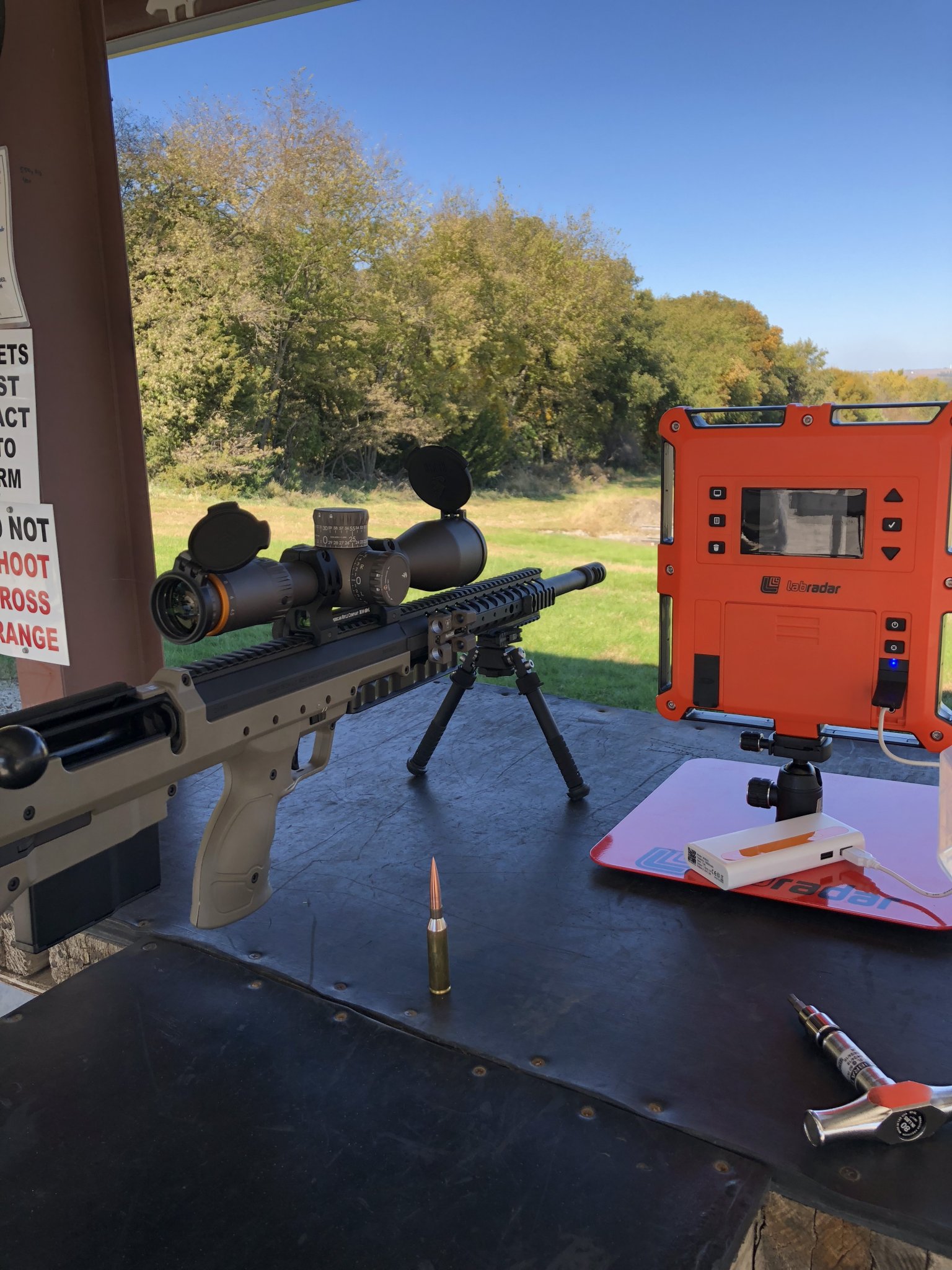

Third time out to the range with my DTA. Tried out some 215 and 230 Berger ABM ammo I picked up, rifle shoots like a laser! Hitting 5-6 inch plates @ 1000 with ease! Wanted to see what your guys thoughts were on the new .300 PRC, do you think this will catch on with DTA owners? I am interested in it because it affords me the ability to find good factory ammo with high BC .30 caliber bullets and avoid the costs of the .300 Norma and other ELR cartridges. Further information as well I do not have the time to reload nor do I want to spend the amounts of money to buy .300 Norma ammo or .338 Lapua/Norma ammo.
Picture was taken at the 600 yard portion of the range.

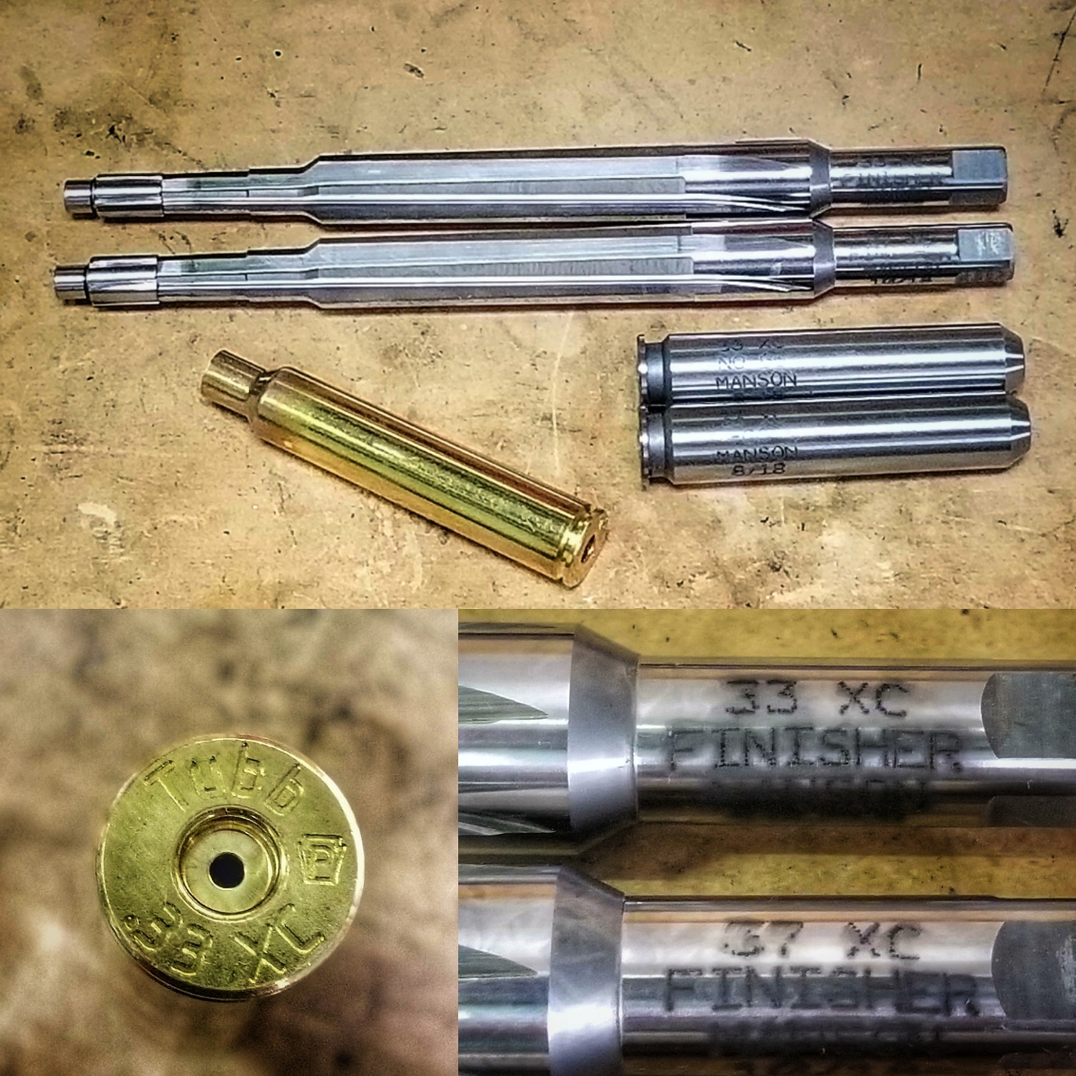

We got a few new reamers in. Looking forward to spinning up a few new SRS barrels!

Pic is a 338 lapua (empty)- 33XC Warner 256gr Flatline – 33XC head – 37XC Warner 361gr Flatline – 375 Cheytac (empty)
Note - the XC case length VS. the 375 Cheytac
