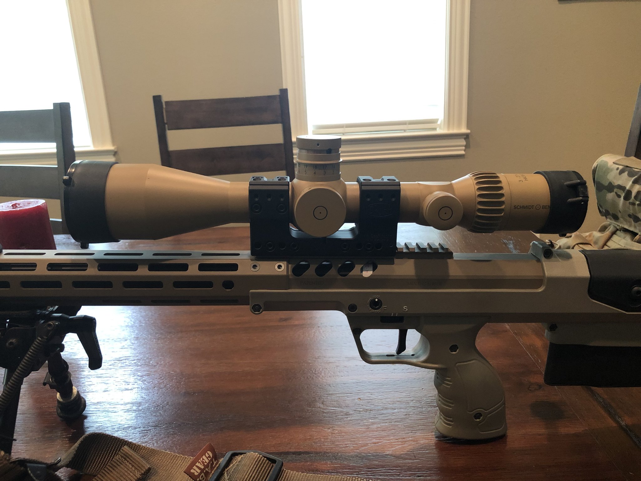

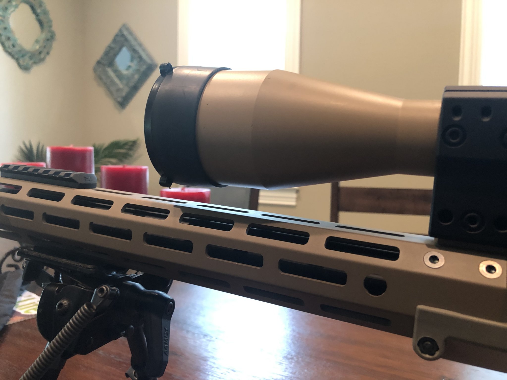

I have an A2 with a Spuhr 30moa and S&B 3-27 mounted up. You’ll be fine, but you may want a bit more cant unless your shooting off the reticle.
Reactions: M289
Alright, might you have a photo of your setup? I'd love to see an SRS A2 with S&B 3-27 as that is what I am looking at myself :D
Spuhr has 6MIL, 9MIL, 13MIL and 18MIL mounts. With the last one being a bit taller than the rest, 44mm versus theregular 38mm/1,5".
I wonder how much elevation you had left after zeroing your scope with the 9MIL/30MOA mount.
30moa with 1.5 height. Works well. DT didn’t do ya any favors by cutting the pic rail so short though. Almost need a cantilevered mount.
I have over 25 mils of elevation adjustment in this mount.
Not sure the spacing would be right, it’s not a big deal but would have been better if they had left it a slot or two longer.

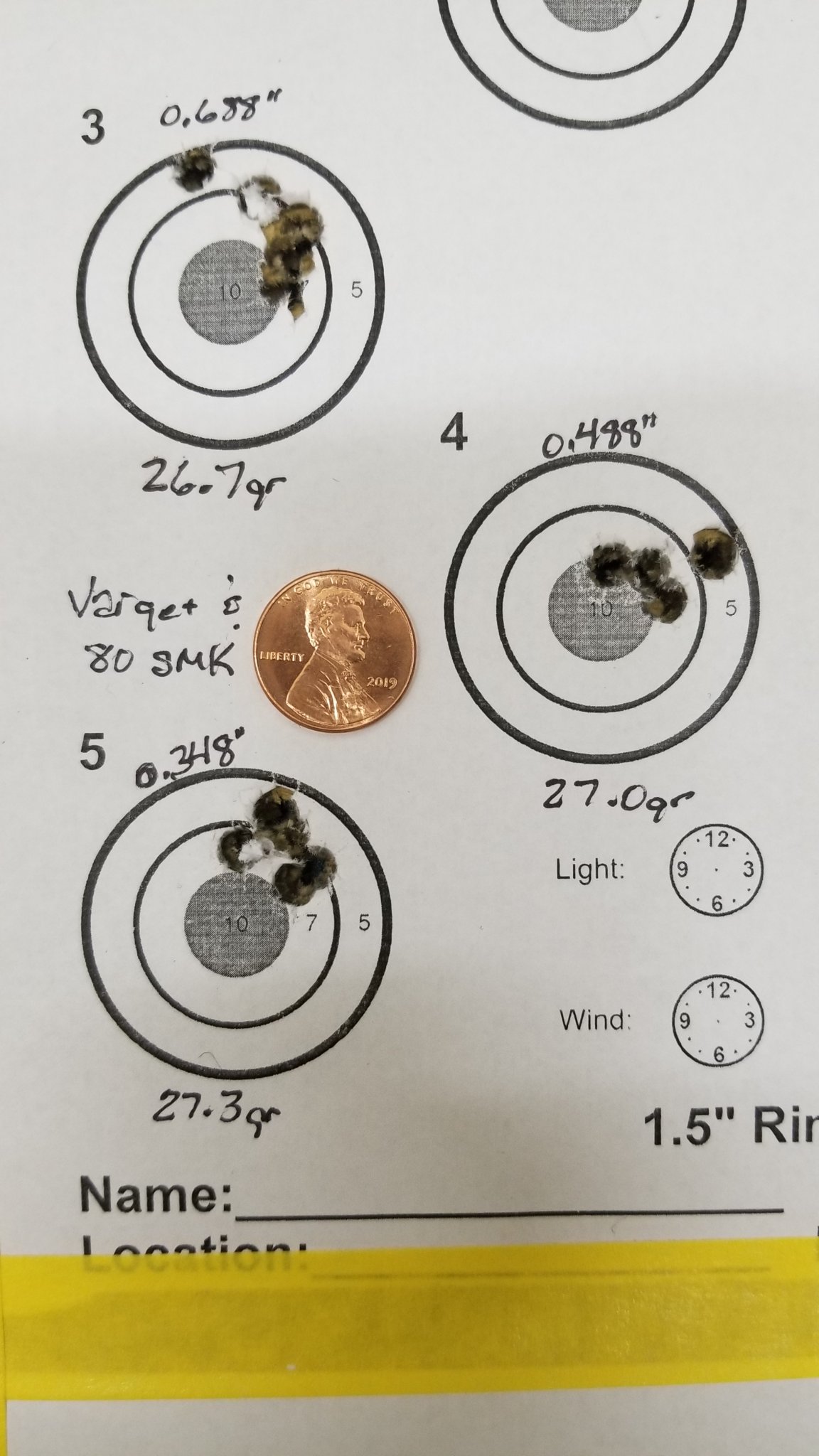

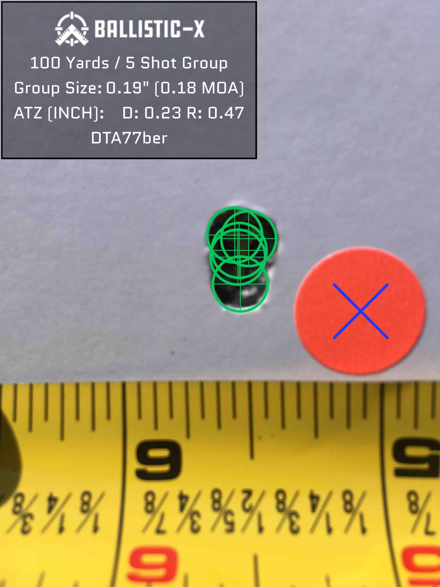

223 SAC running 24.4 Varget 80.5 Berger seating 010 off the lands. 2856 fps. The target is of group at 200 yards. I have more than 600 rounds in little over a month and like others this thins is great. If you want one don't wait wished I had done it sooner. I have had more fun with this coming from a .308 155. Thanks Mark I will be getting more items from you in the near future.

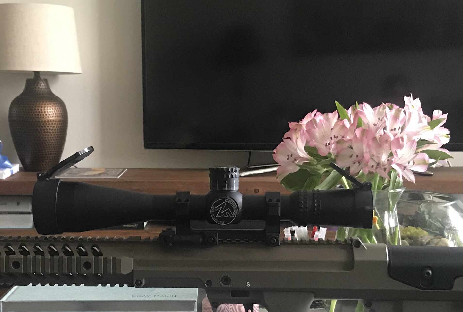

One more question I have for you gents is what the minimum scope height you are using. I have a vortex razor gen 2 a 3-18 by 50mm objective. Thanks
1.4" will give you enough clearance for a 50mm objective + cap on a flattop. No lower than that. 1.5 would be good... it all depends on how much bell clearance you are looking for... but 1.4 is as low as it goes. Mount is a 20moa

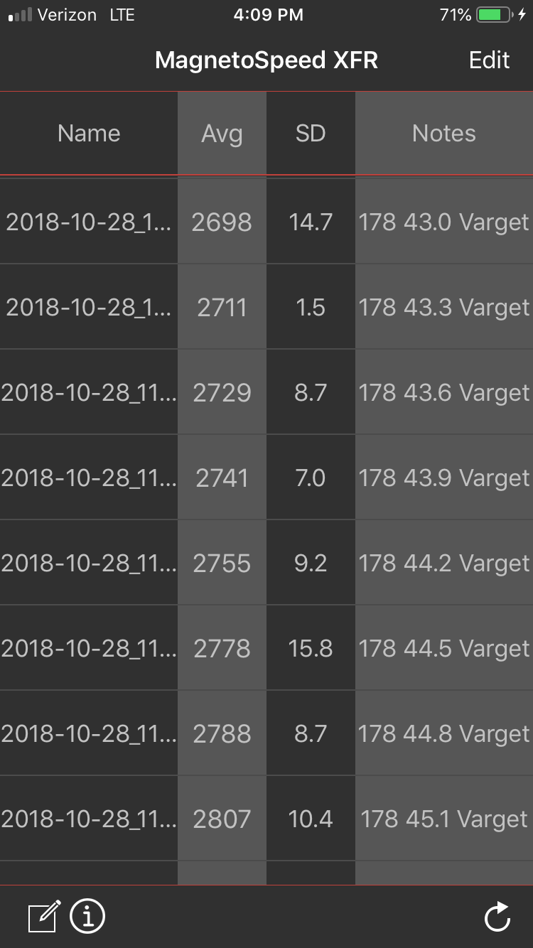

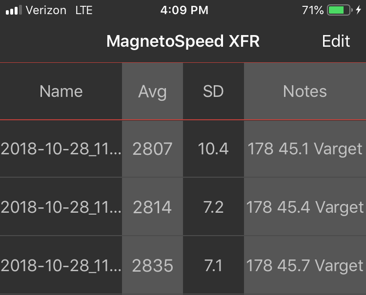

Well my weekend has started looking for some load data for my DTA in 308 shooting the 178ELD. I have lapua brass varget and 210m primers. Just need to go to the store to pick a box of ELDs.
Reactions: Farmerbrown32
Here is my data from the 178gr ELDx
-Lapua brass
-Varget
-cci200 primes
-28” barrel ( but just shipped it today to have chopped down to 25”)
-0.002” neck tension
I ended up settling on 44.0gr, COAL=2.870 or BTO=2.205” or 0.040” jump. I did not see any signs of pressure.
