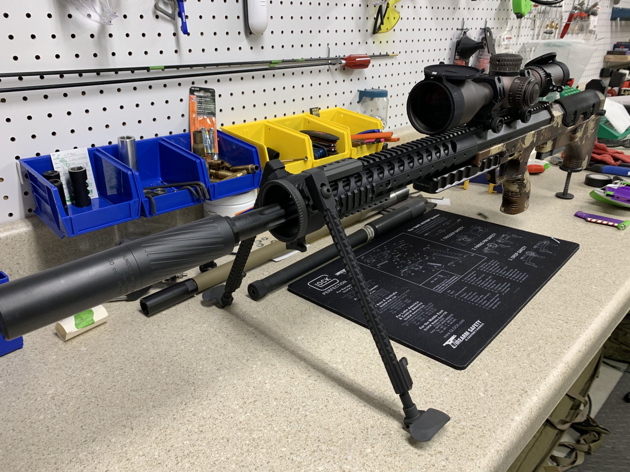

Aluminum model, standard offset.
Yes I know the pic rail mount usually goes on the bottom but the top pic rail is aluminum, bottom is plastic.

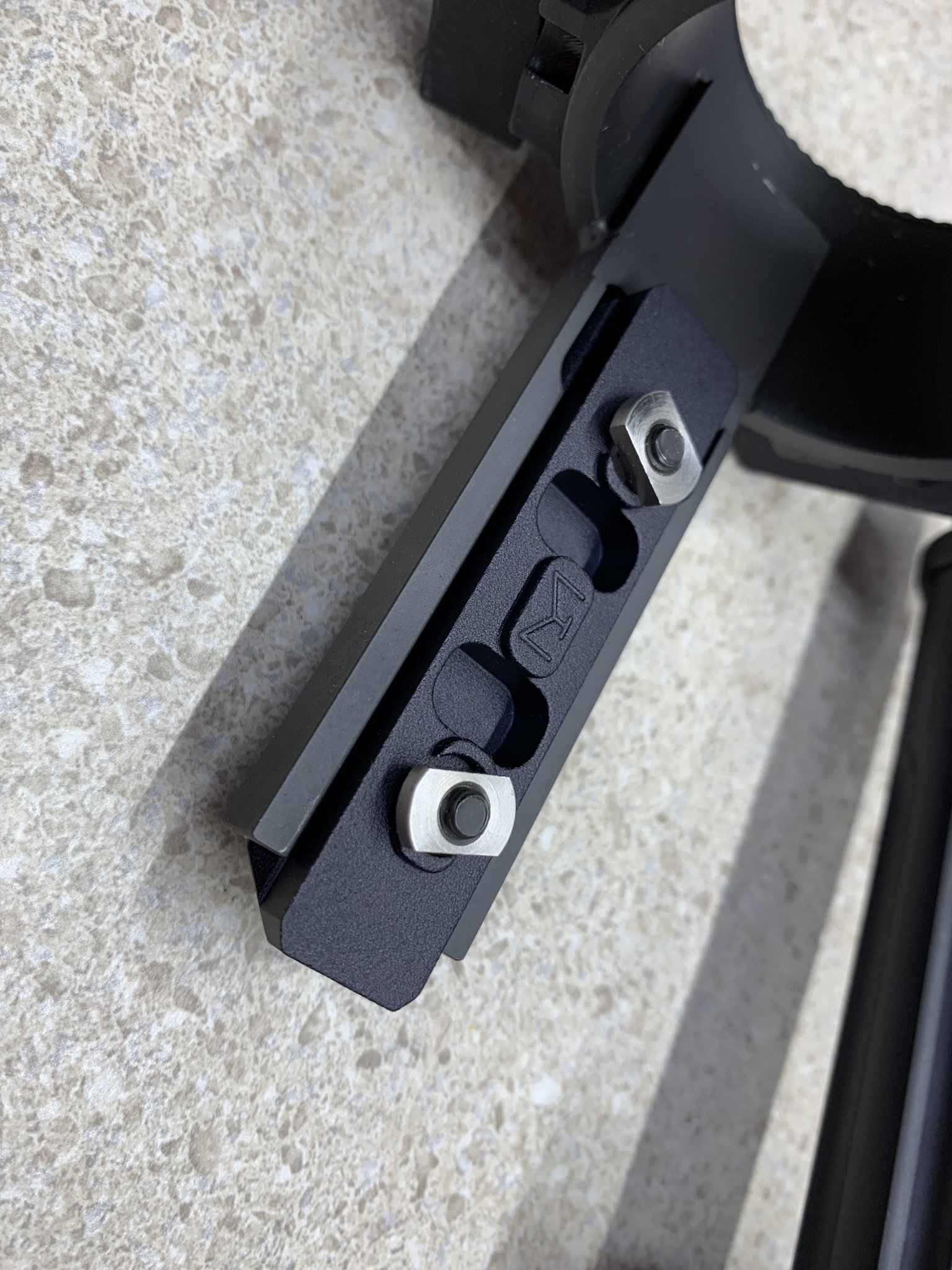

Pumped to try the Elite Iron out.
You nailed it. I've made up a couple aluminum rails for friends who broke their plastic ones with normal use. Hanging the rifle from the bipod makes more sense too. Gravity helps that way instead of needing to be fought.

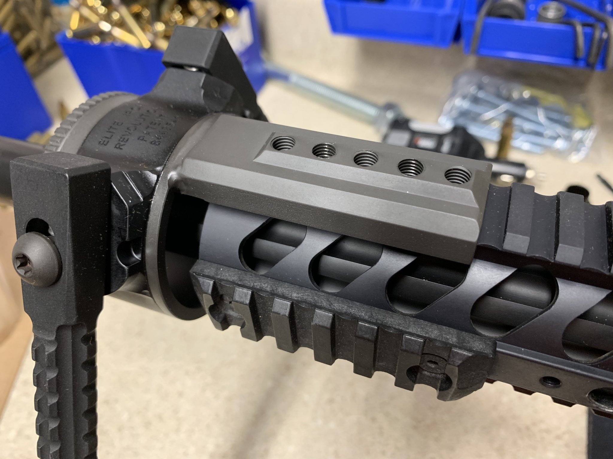

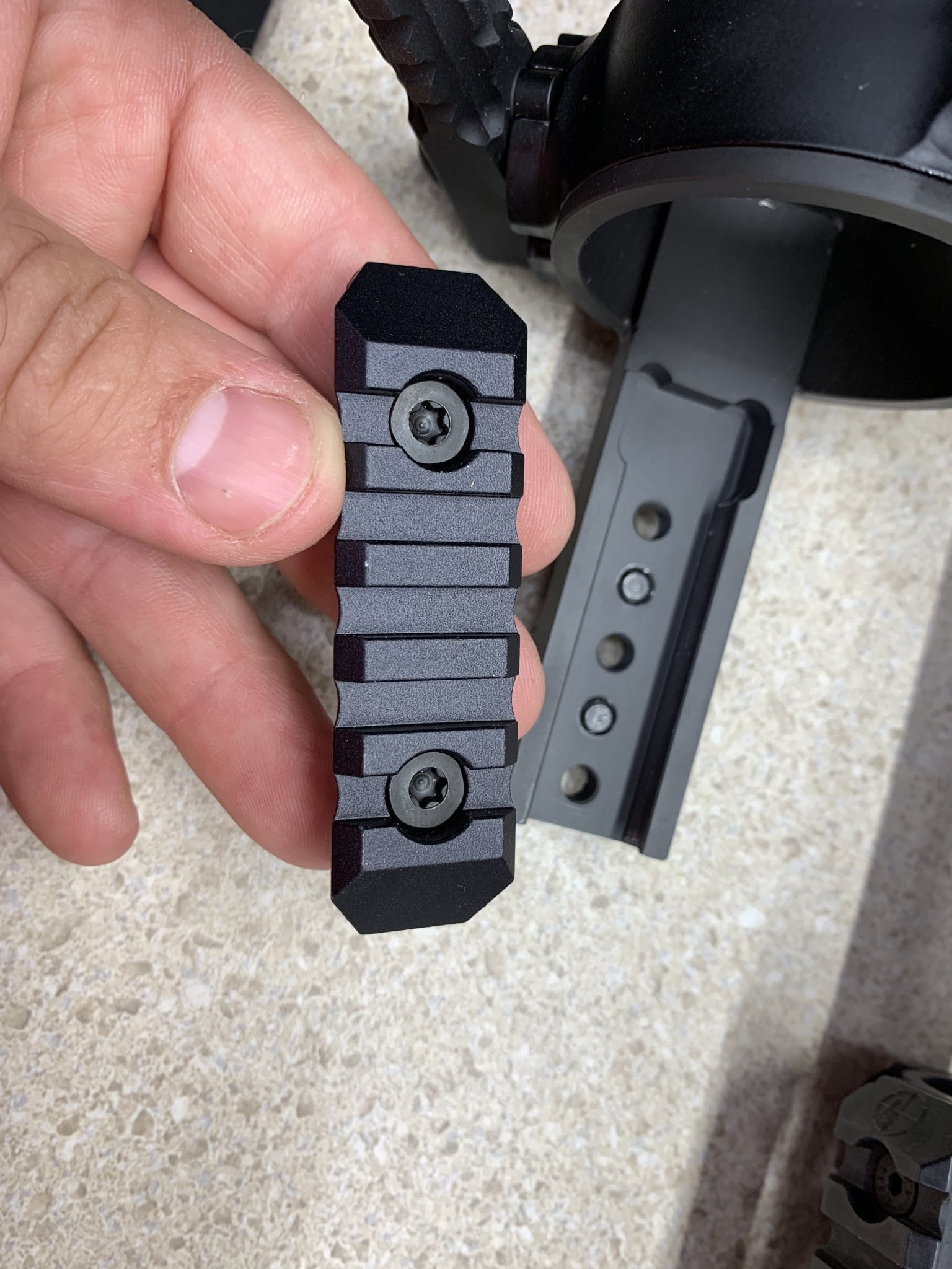

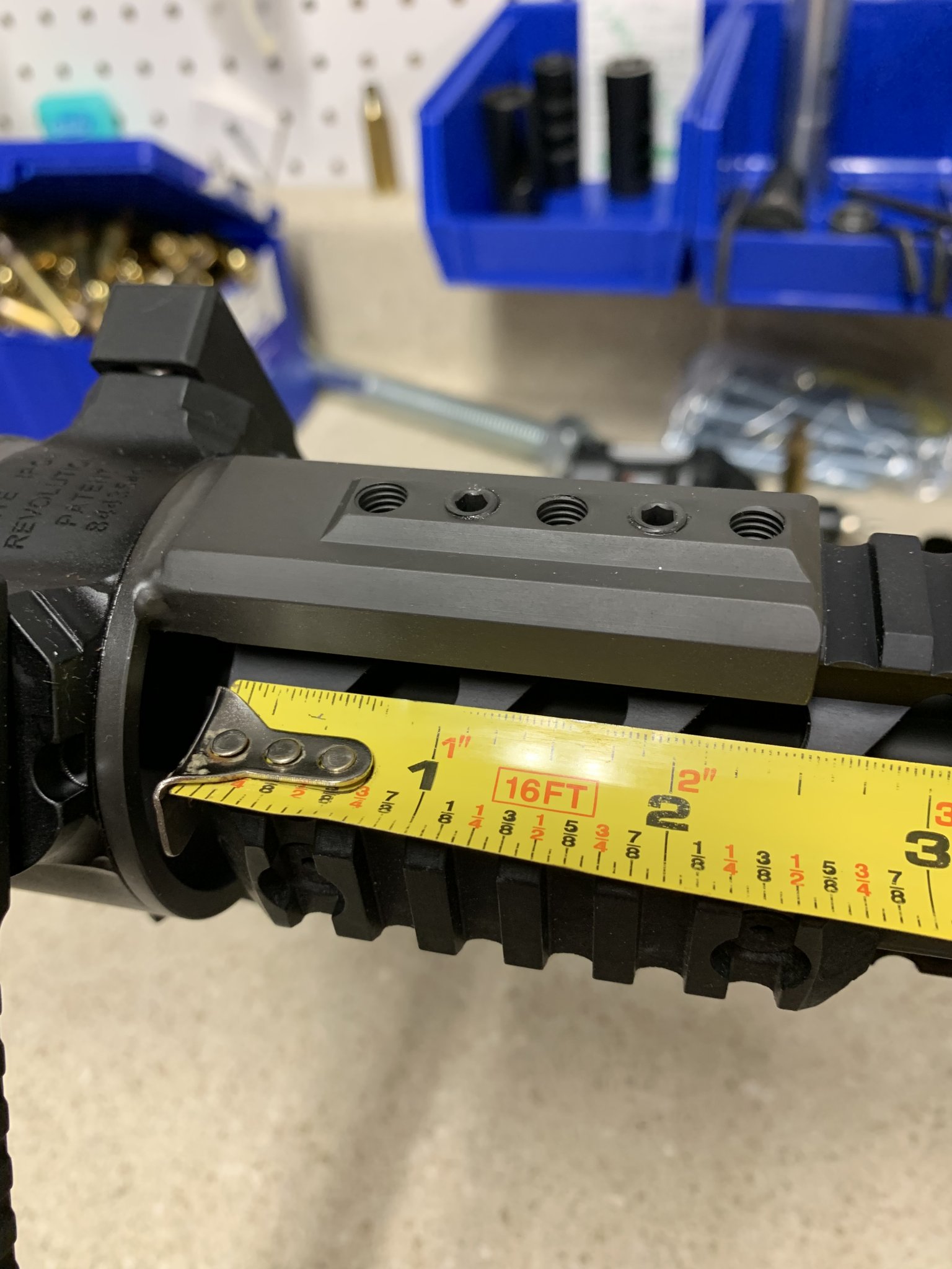

One more thing; the Elite Iron consumes 5 pic rail slots, or 2-1/2”, so you don’t really need one much longer than that for an A2 rail. Also the set screws don’t need to be torqued down, only tight enough to make sure the bipod doesn’t slide off the end of the pic rail.
Here it is attached to the Seekins 5 slot pic rail, the shortest they have. The Seekins 5 slot pic rail fits the Elite Iron Revolution perfectly.

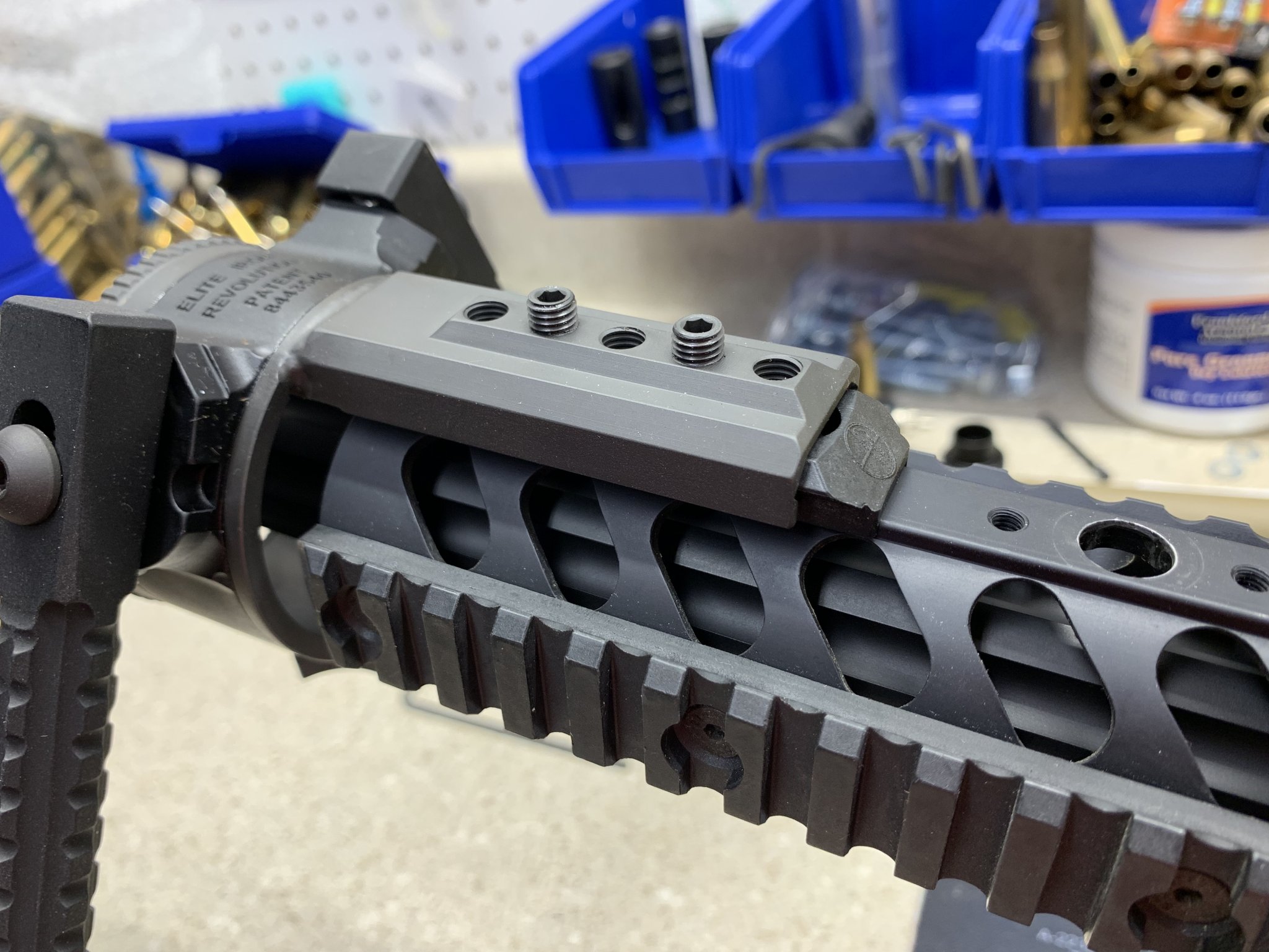

Here’s the Elite Iron attached to the shorter Desert Tech polymer pic rail:
Here’s the top of the SRS Handguard- the aluminum part.
2-1/2” is all it takes up.
Set screws removed. Still holding up the rifle.

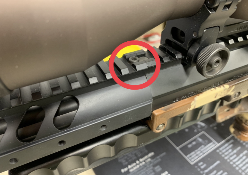

Anyone else with an A2 discovered that you can't remove the barrel with a top picatinny rail installed? The clamping area of the barrel hits the T-nuts that hold the rail on, because the top of the handguard is closer to the barrel than the other surfaces. This is an issue with the covert anyways. Maybe with the full length handguard and a short rail mounted toward the front, you might be able to get the barrel by the t-nuts.
Curious if anyone else has run into this. I've been thinking about picking up an a2 chassis and I would need a pic section to mount a clip on. I guess it's not the end of the world but can anyone verify if barrels can be swapped with a rail section at 12 o'clock toward the end of the rail?

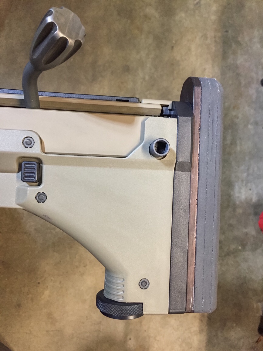

I have a different butt pad that I got for mine. Really adjustable. It uses the same t-torque wrench for changing barrels to lock the adjustment. Can’t remember we’re i got it from. I wanted to say sac, but I think it was from another guy that made a limited run of them on here. It’s somewhere in this thread.
Yeah, that dude used to be at SAC, but is no longer there. I don’t think he’s making those pads anymore.
