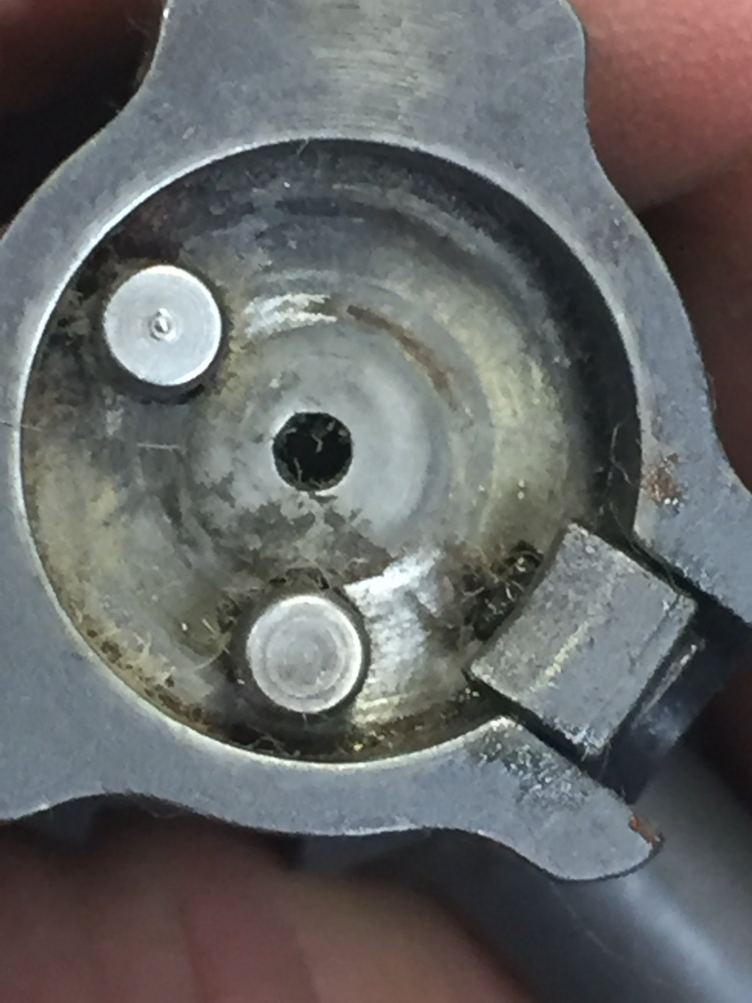

I’m wondering if it’s a common issue with DTA mag bolts to gouge case heads on 300 mag Brass. Due to it having 2 plungers. Wondering if any one polish the plungers to smooth it out. Not worried but like to if you have the same issue.
what are we talking ? like a plunger swipe? or actual scratches on the case head

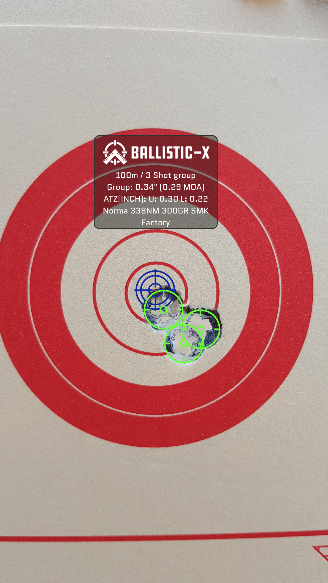

Went out to the range on Monday -
Had some fun with the 338Norma
Such a pleasant and accurate round to shoot .
This group was shot with Factory Norma 300SMK
I have the same question so please post a photo so we can see.
I had to polish the feed ramp lips on all my magazines to stop them from scratching the brass.
That’s makes sense. Very odd it was left there after machining but makes sense.

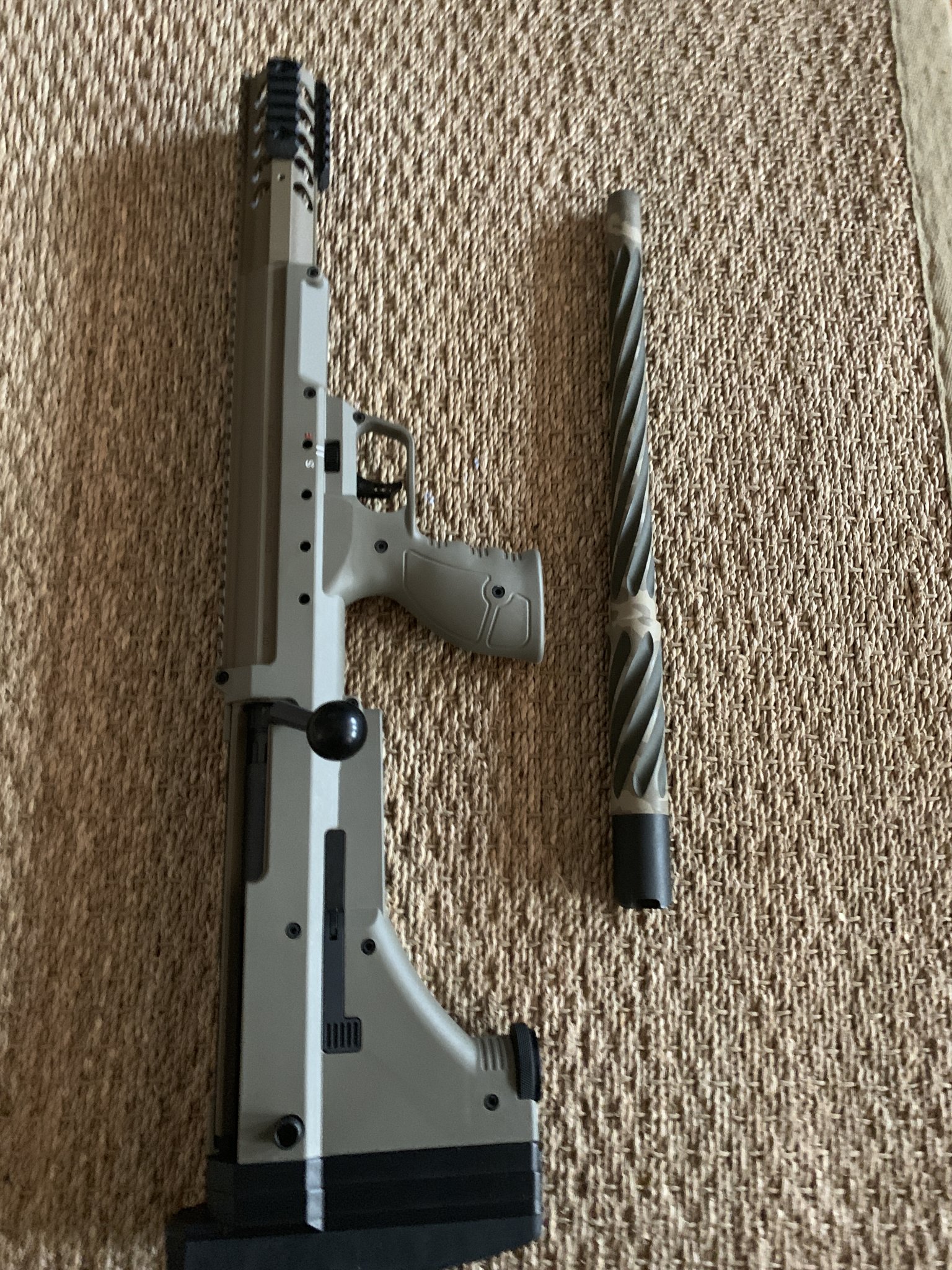

Those of you with a .223 conversion- are you utilizing a dedicated bolt, or changing heads out each time you shoot between .223 and .308 or Mag setup?
I see that now. Makes me feel a little better. I was worried they released a double stack magazine or a new clamping system, or something else really cool that would be incompatible with the A2.
For myself I went ahead with a dedicated bolt for this setup, so I'm not having to change out heads at the range or wherever. I just simply swap a barrel &bolt and I'm good to go.
Reactions: 65x55guy
I ,sorry to say, am changing the heads out.
Whatever works best for you or the other guys.
Both ways work just fine, it’s all about personal preference.
I’m one of those guys that prefer to have a complete bolt ready. But I know I’m weird like that ?

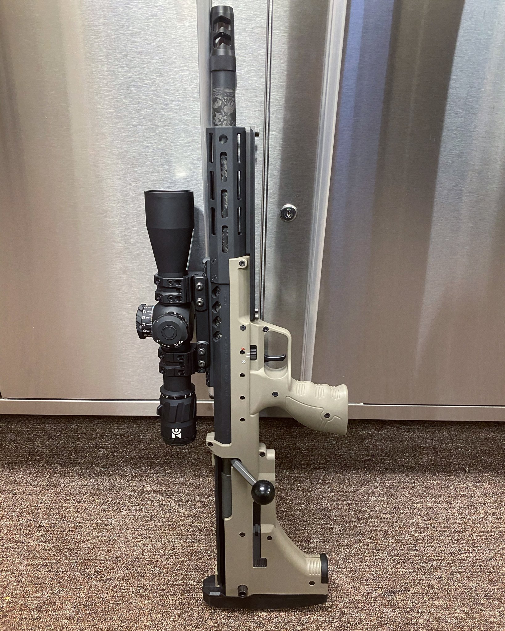

OK, As I prepare to buy the SRS A2... Spurh Mounts. I've loved them since I saw them. I'd like to run a 56mm objective. Any particular ring height from Spuhr I should use? I'll be shooting within a mile at most, I don't know if I'd benefit from the 30 mil of elevation.
You need to pick something like the 4602 which has 1.5” height, and 20 MOA. Any less and it’ll be hard to get a good sight picture. The DT’s were designed around 1.5” high mount.
Personally I like the ARC M10 mounts better than Spuhr. You can find the ARC mounts for sale here on the PX around $250 or so.
ive got a 4802 mount on my a1 ,
13mil/44moa
28.5 mils available from 100 yard zero Gen2 Razor 4.5-27x56
on my a1 rail i cant fit a front flip cap but on your a2 that wont be an issue
