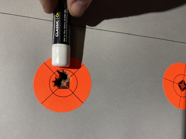

b04c9e22-f542-4078-9363-403733277e9d-jpeg.7244338
3shot group at 100 with 22.5 ts customs fluted truck axle
168smk
Would have gone for 5 but ran out...

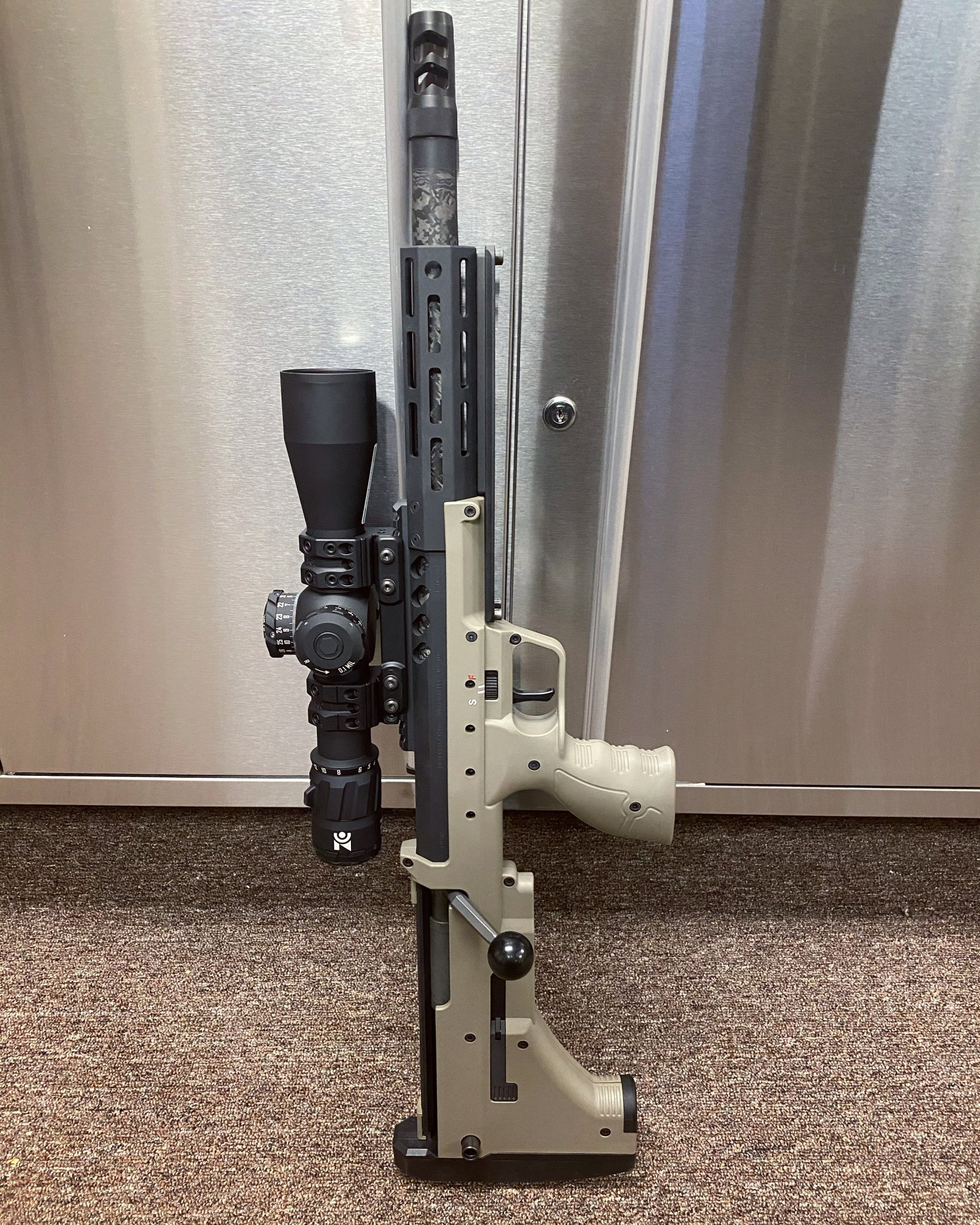

Well, that's that. My order is locked in. I went with SAC.
SRS A2 covert FDE/FDE, monopod
300NM conversion, Proof 18" barrel, spiral fluted shank, .230 freebore
223 conversion, complete bolt, super lite contour 18" barrel, 6.5 twist, spiral fluted shank, straight flutes on barrel, long range chamber
Dt srs covert case with straps
Needless to say I am stoked!
