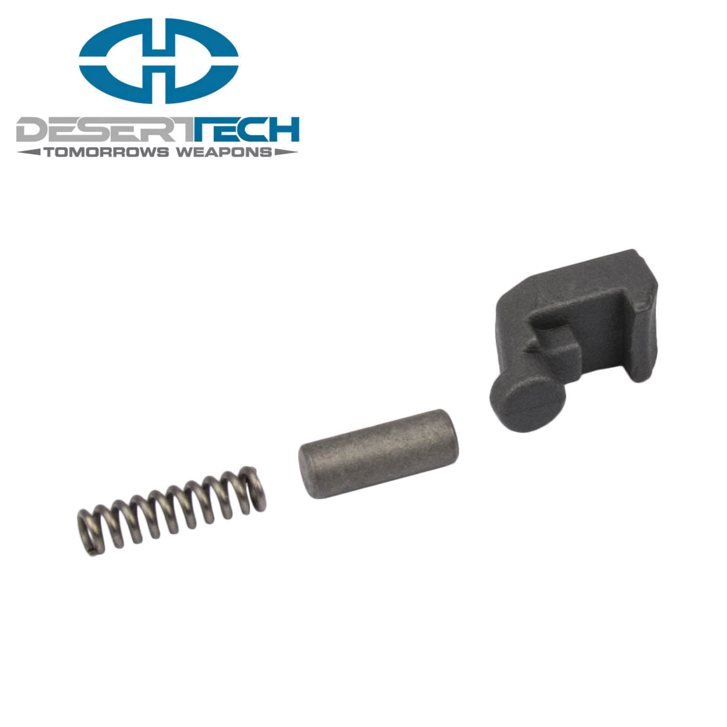

I’m looking for spare parts for the bolts. Extractor and springs and firing pins. I call DTA and they said they are having issues getting any extra parts to sell. Wondering if anyone can make a few Extactors. I had Interesting issue happen this weekend. I reload and had a primer that was right side up. I pulled the trigger and primer went off. I go to cycle the bolt and the case stayed in the camber. I looked and the extractor has pop off. I was thinking I’m screwed. But I found the extractor down my Magazine. All I had to do pop the extractor back in place and was go to go. But was thinking that this is a weak spot of the System. It’s set up like a Glock extractor set up. This should have a roll pin set up.
If you know someone that will make a few extractors. I would buy them.
Reactions: deersniper
Have you checked midwestgunworks?
Reactions: Puget Shooter
