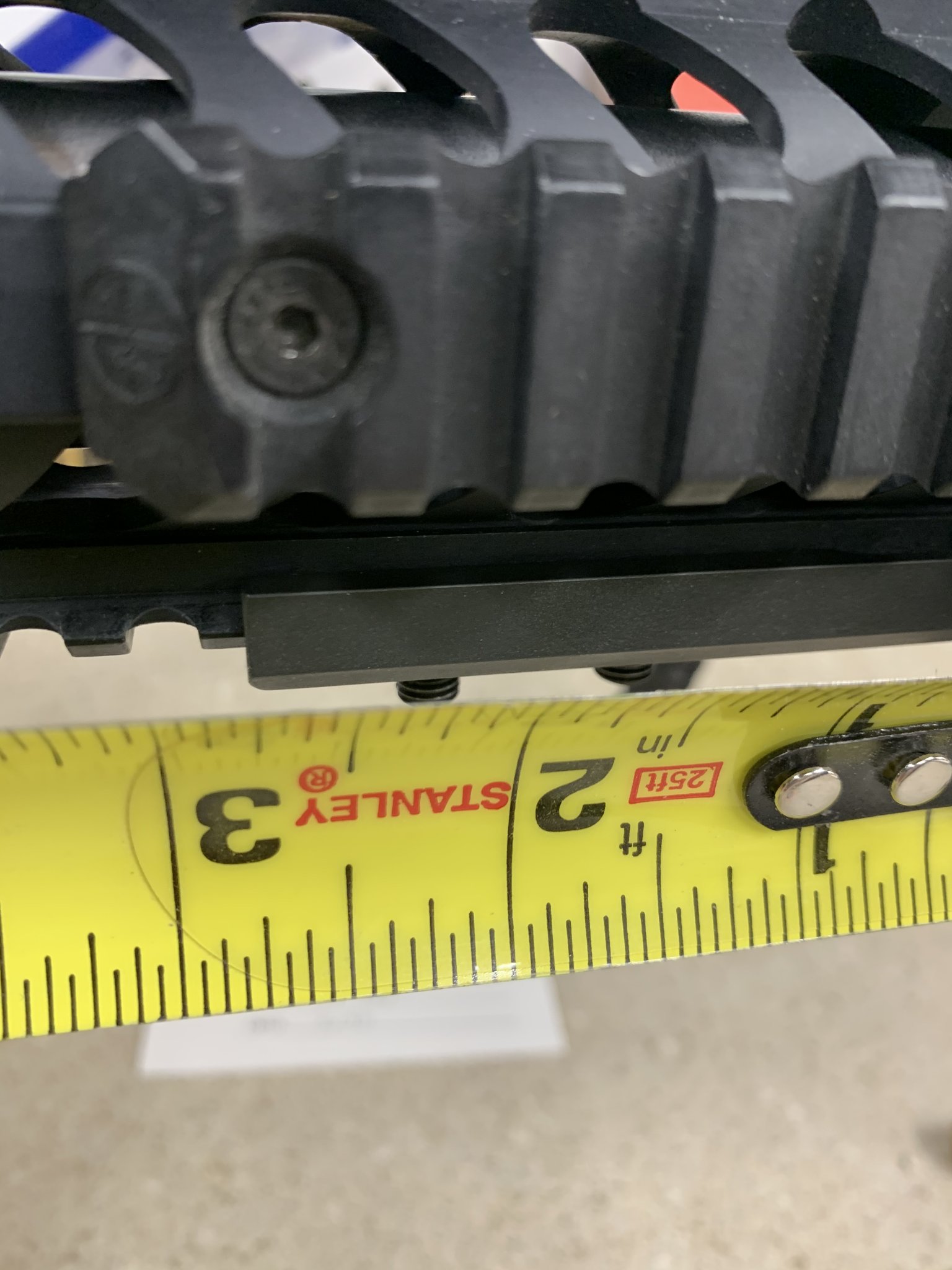

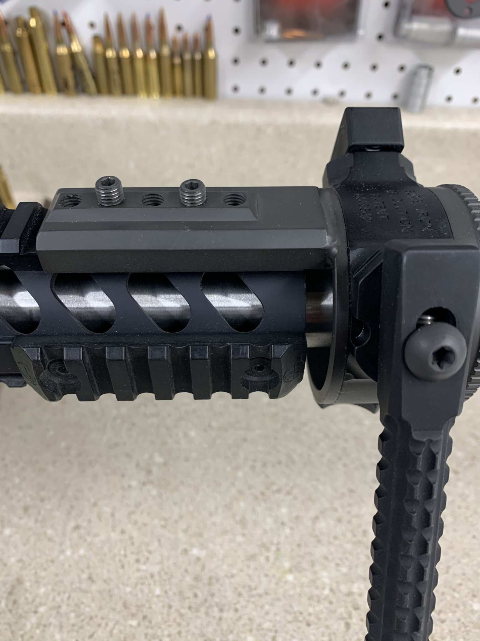

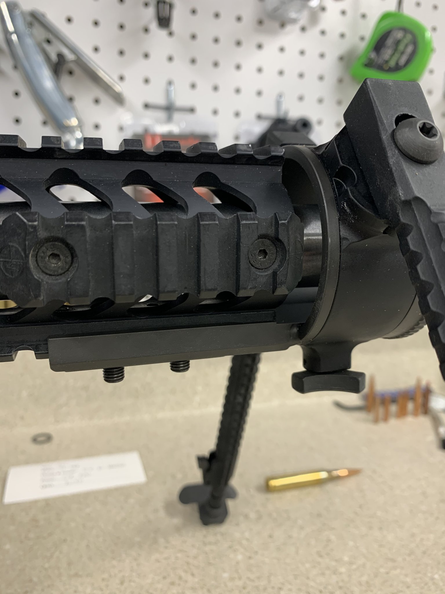

I will say the Elite Iron non-pan model doesn’t give you much ability to move to the left or right when you’re behind the gun. That’s a good thing for target shooting at the range, probably not so good for movers or game.
You will also notice I have mine “upside down”. On the A1 and A2 the top rail is metal, bottom rail is plastic. I prefer to keep the bipod on a metal clamping surface so I run it upside down.
@pinhead do you see any advantage in getting the extended pic rail mount vs the standard length.
Not really. I guess it would let you run the bipod further away from the handguard if you wanted, or would give you more pic rail to Mount to. But the 6 slots that it slides over, or about 2-3/4” it takes up now is pretty secure.
just keep in mind if you tighten down the two set screws it will mar up the pic rail a little bit.
Here is the bipod with the attachment on the top of the SRS rail.
Here is the bipod attached to the bottom of the pic rail, which is traditionally how these are attached.

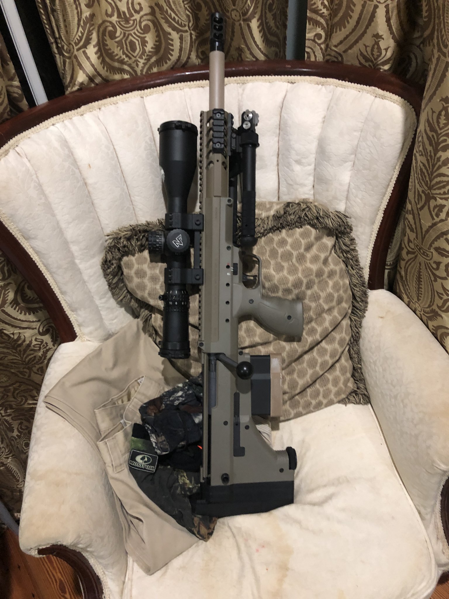

Spuhr and Ultra Short finally arrived and mounted!!
now just waiting on my 6.5 barrel from Es-Tactical!
Currently has DT factory 16” 308 barrel, BiLock flashhider from GLS Suppressors that works with my Gemtech Quicksand.
*** update***
just spoke with Erik on the phone. Barrel should be enroute by next week!!!

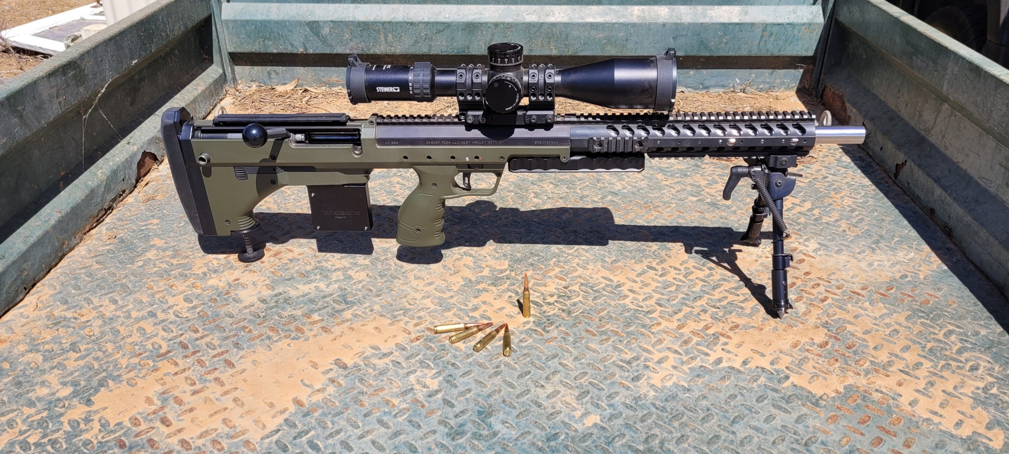

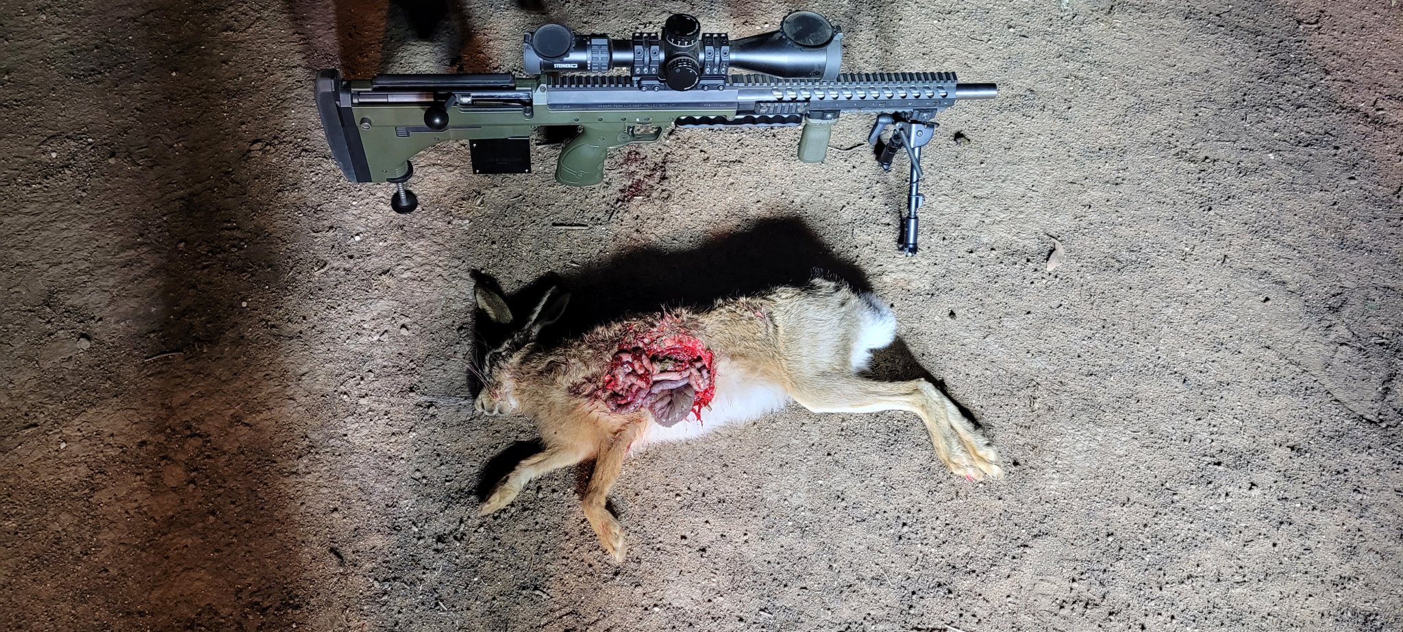

Took my 223 out for a few days varmint hunting, man I love it . So mild to shoot , accurate as and love the manoeuvrable of the SRS in vehicles .
Quick 5shots to confirm zero with 80gr Amaxs
