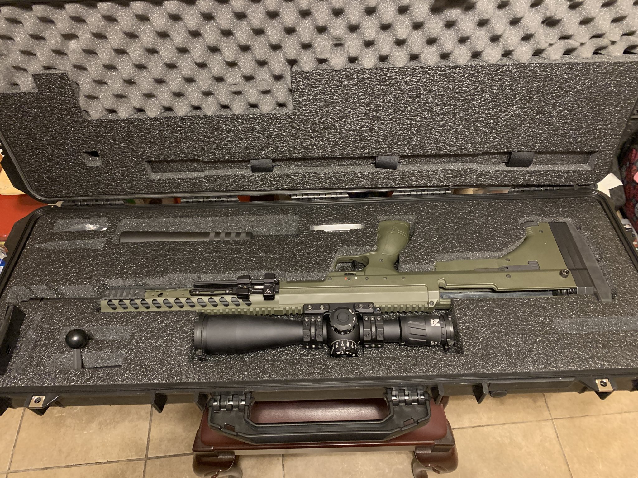

What is everyone using for a case or bag?

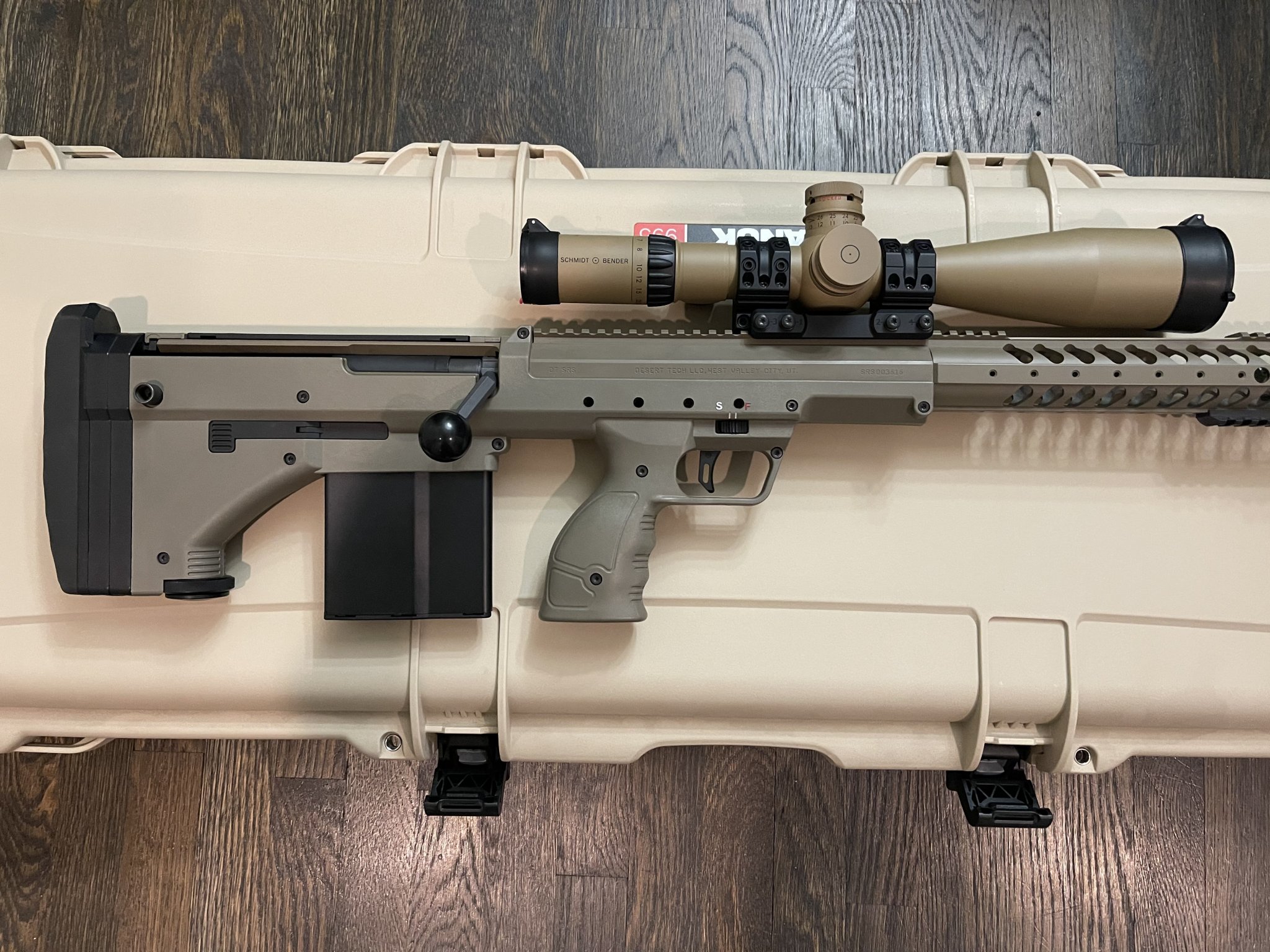

I have The Case club pre-cut. I wished it had a little more space I have the elite iron Bipod and it wont fit.
I have the case club set up too. I have data books, ammo, tools etc that always travel with me so I don’t mind it not holding everything. I also purchased a very cheap double sided soft case to run to my range so I didn’t have to lug the heavier case.
Reactions: joemusso
Running a Triad Tactical - padded case .
Fits the DT excellent and holds 3 conversions in the front pocket .
I have Velcroed it in and it works great
Heavy as fuck with 3 barrels but functional

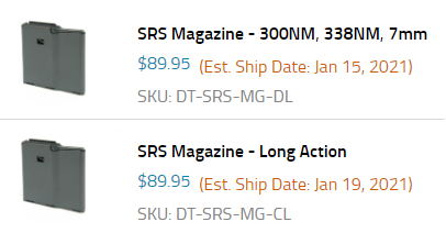

That's just it, I posted what appears to be two different items:
item=2490 -- "SRS Magazine - 300NM, 338NM, 7mm" -- "Compatible with Magnum calibers: 300 Norma Mag, .338 Norma Mag, 7mm"
item=2191 -- "SRS Magazine - Long Action" -- "Compatible with Magnum calibers: .338 LM, 300 WM, 300 Win Hunt, 7mm WSM, 300 RUM & .338 Norma Mag"
They both say they're compatible with 338 Norma Mag.
I figured someone at DT is just bad at the interwebs, but when I add them to cart, they have different SKUs:
Are they really the same thing? I sent DT an email, but who knows if I'll ever hear back from them.

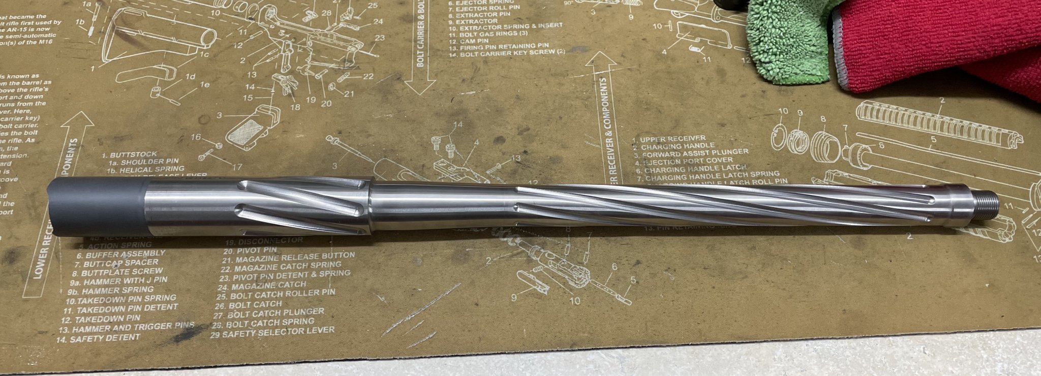

ES-Tactical barrel arrived (18”, 6.5 creedmoor, medium Palma with some fluting).... first two, 5 round groups down the barrel, the one high round in the second group was a called shot by me. Without the called shot, both groups were sub 1/2 moa (I did fire another round to make sure I got a 5 round group) with the called shot it was .74 moa. As always the rifle shoots better than I can!
Ammo were some 140gr Berger hand loads I developed for a Tikka I used to own. Got 2625 ft/sec average with them. This barrel seems to like them as well.

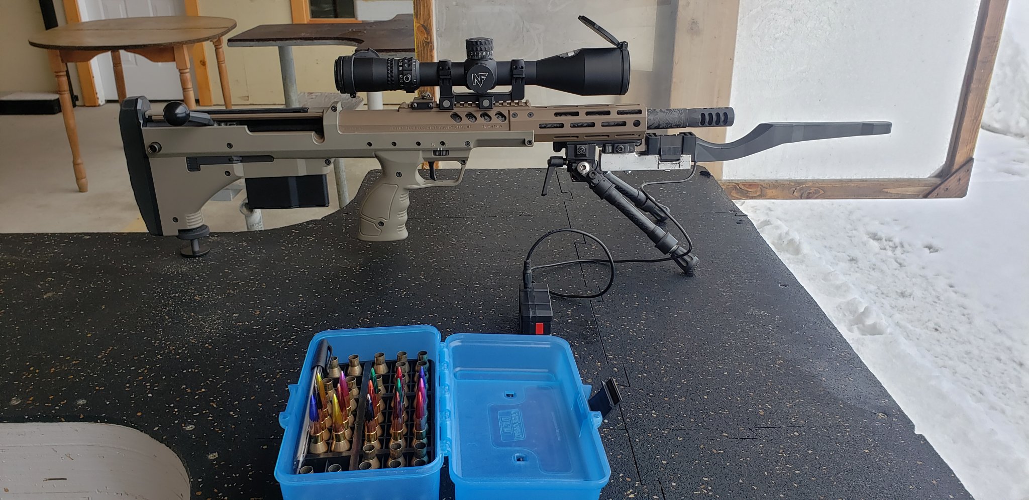

Ran a ladder test with H1000 and 230 Atips in the 300NM. Went from 80gr to 85.6gr in .4gr increments. Velocity went from 2550fps to 2745fps. There was a faint ejector mark at 85.6 but felt nothing on bolt lift or extraction. I don't think I will run any higher than that. Lapua brass can take alot of pressure before you feel anything on the bolt.
Potential sweet spots at 82.4gr, 2625fps ---
83.8gr, 2680fps --- 85gr, 2725fps.
I need to run it through again and see what shakes out.

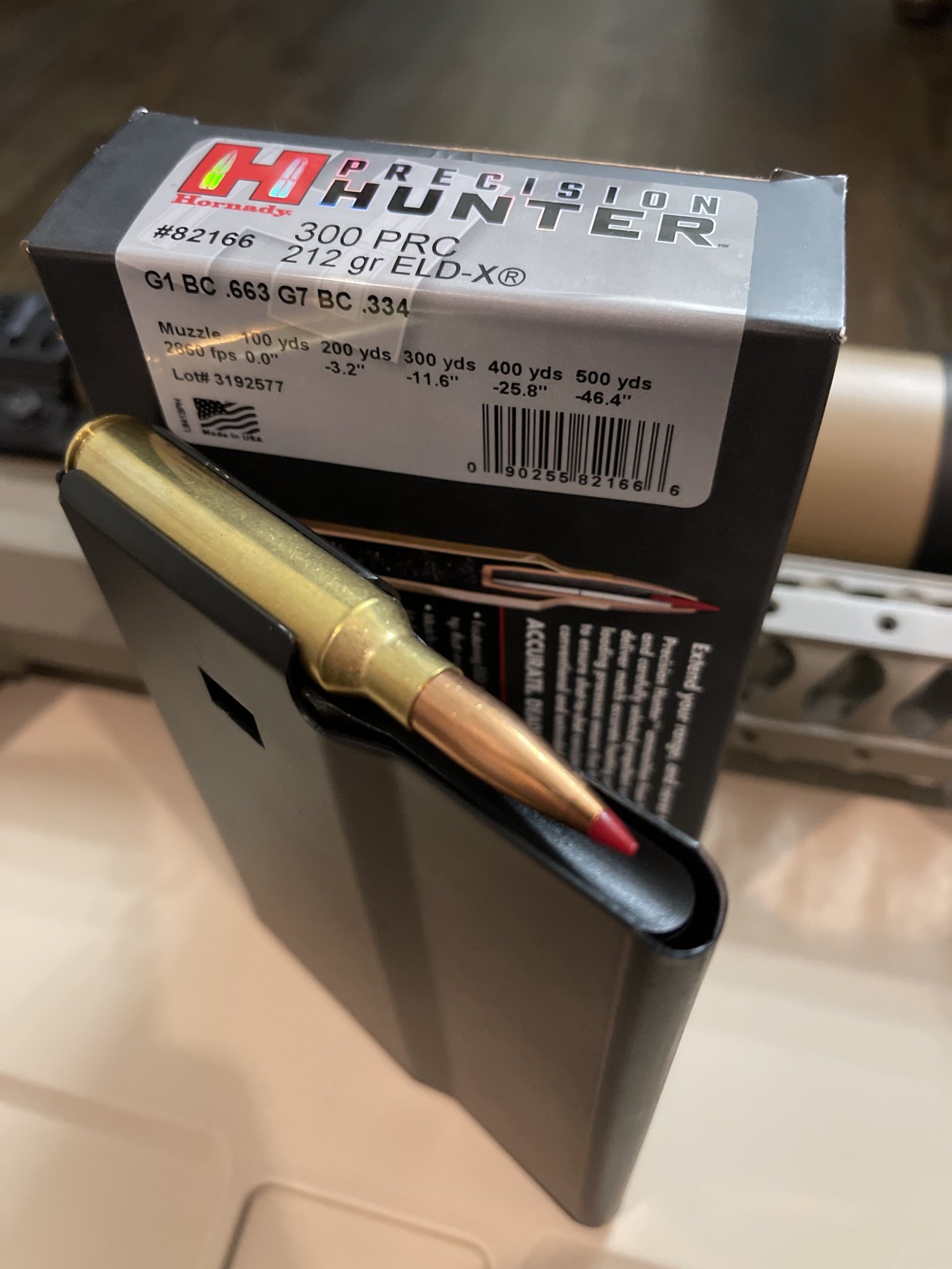

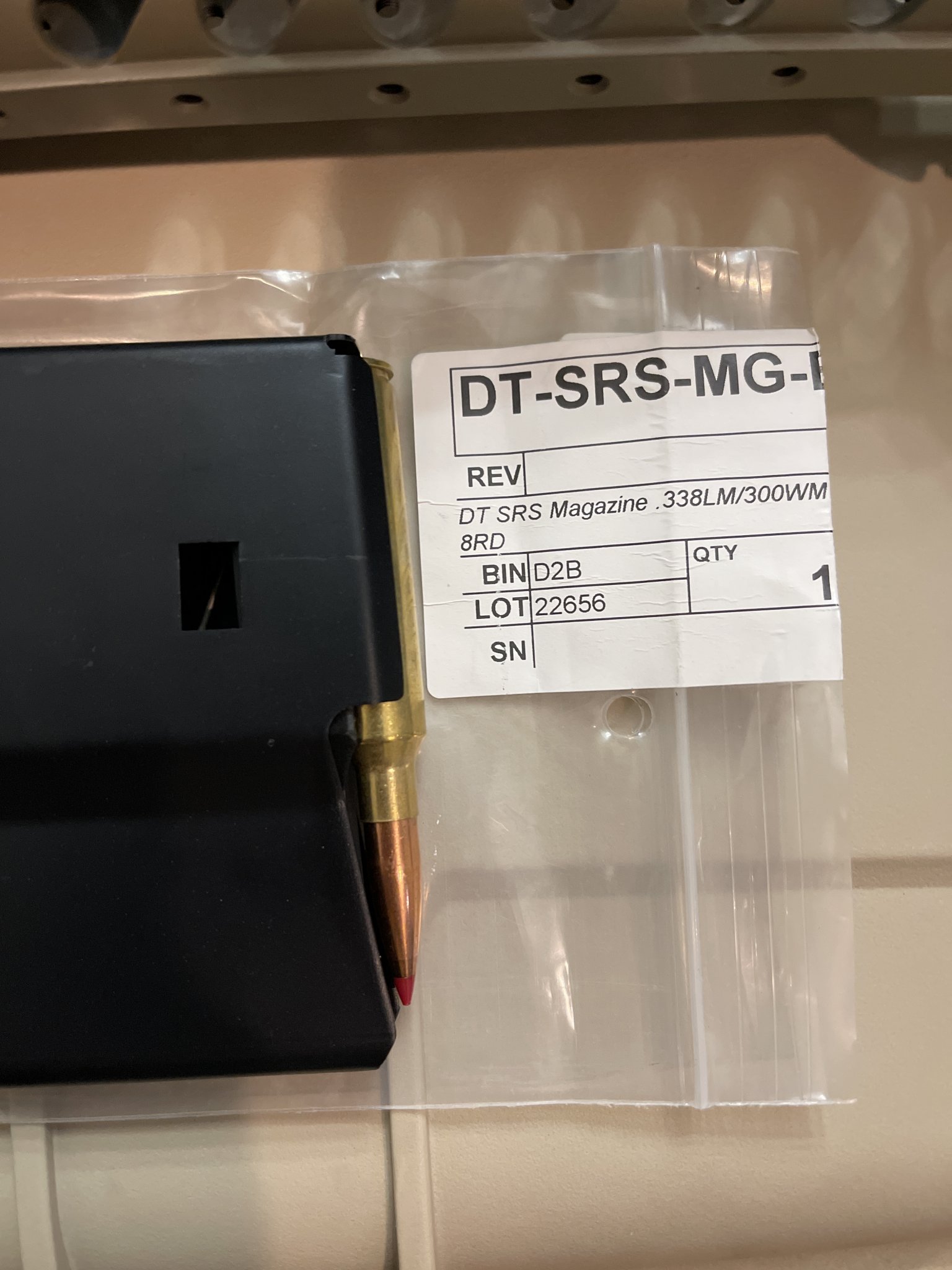

How long are they? Any chance you could get a picture of it in the chassis?
Will it work for 300 PRC?
Here you go. This is with a .300 PRC round inserted, and it came in the typical DT packaging. The one pictured came from Oakland Tactical along with 2 more, and appear to be a DT factory magnum 8 round mag. It’s a great deal, $50.00 less than retail. I personally think they simply priced it wrong by mistake.
