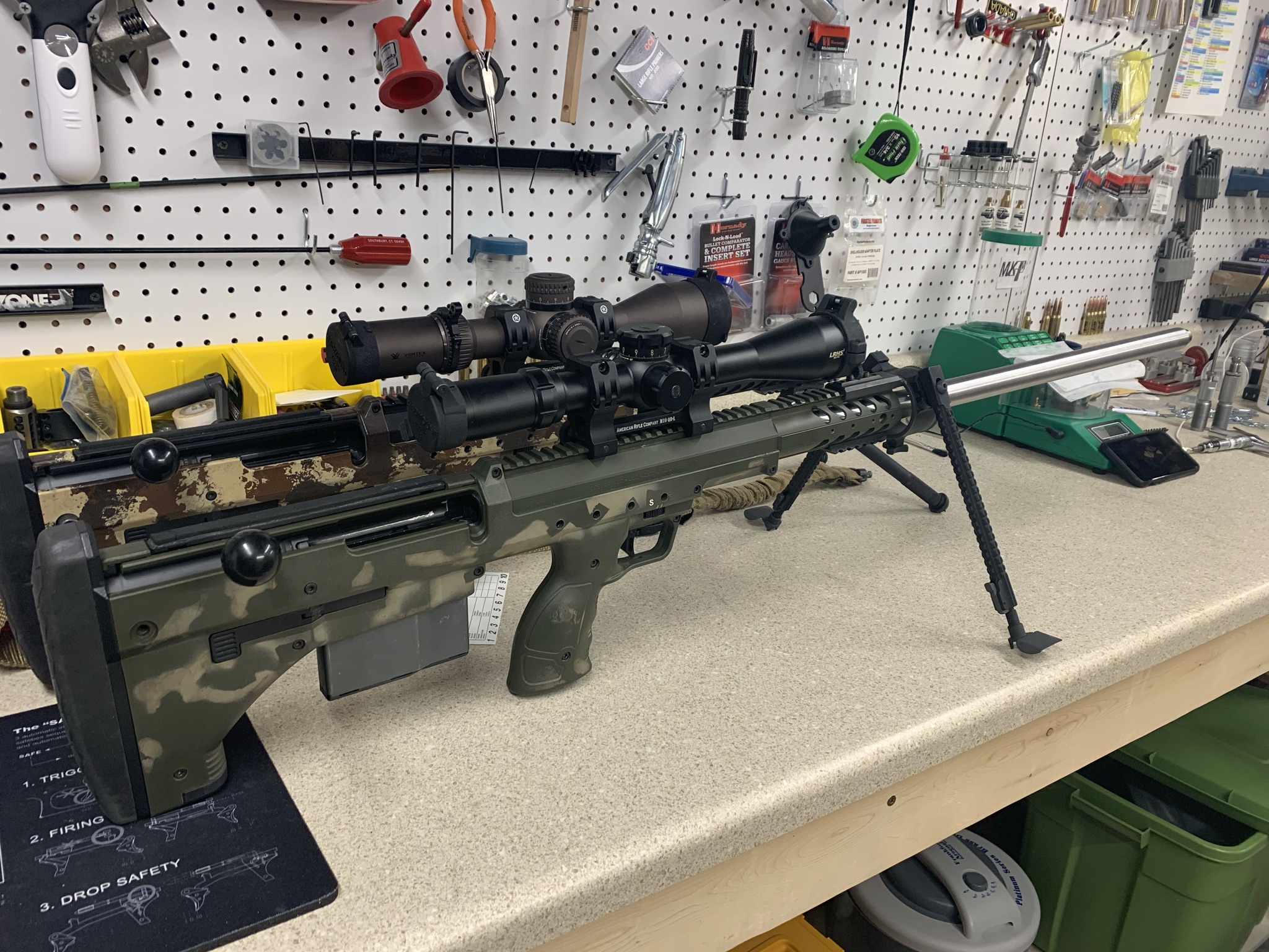

I will say the Elite Iron non-pan model doesn’t give you much ability to move to the left or right when you’re behind the gun. That’s a good thing for target shooting at the range, probably not so good for movers or game.
You will also notice I have mine “upside down”. On the A1 and A2 the top rail is metal, bottom rail is plastic. I prefer to keep the bipod on a metal clamping surface so I run it upside down.
