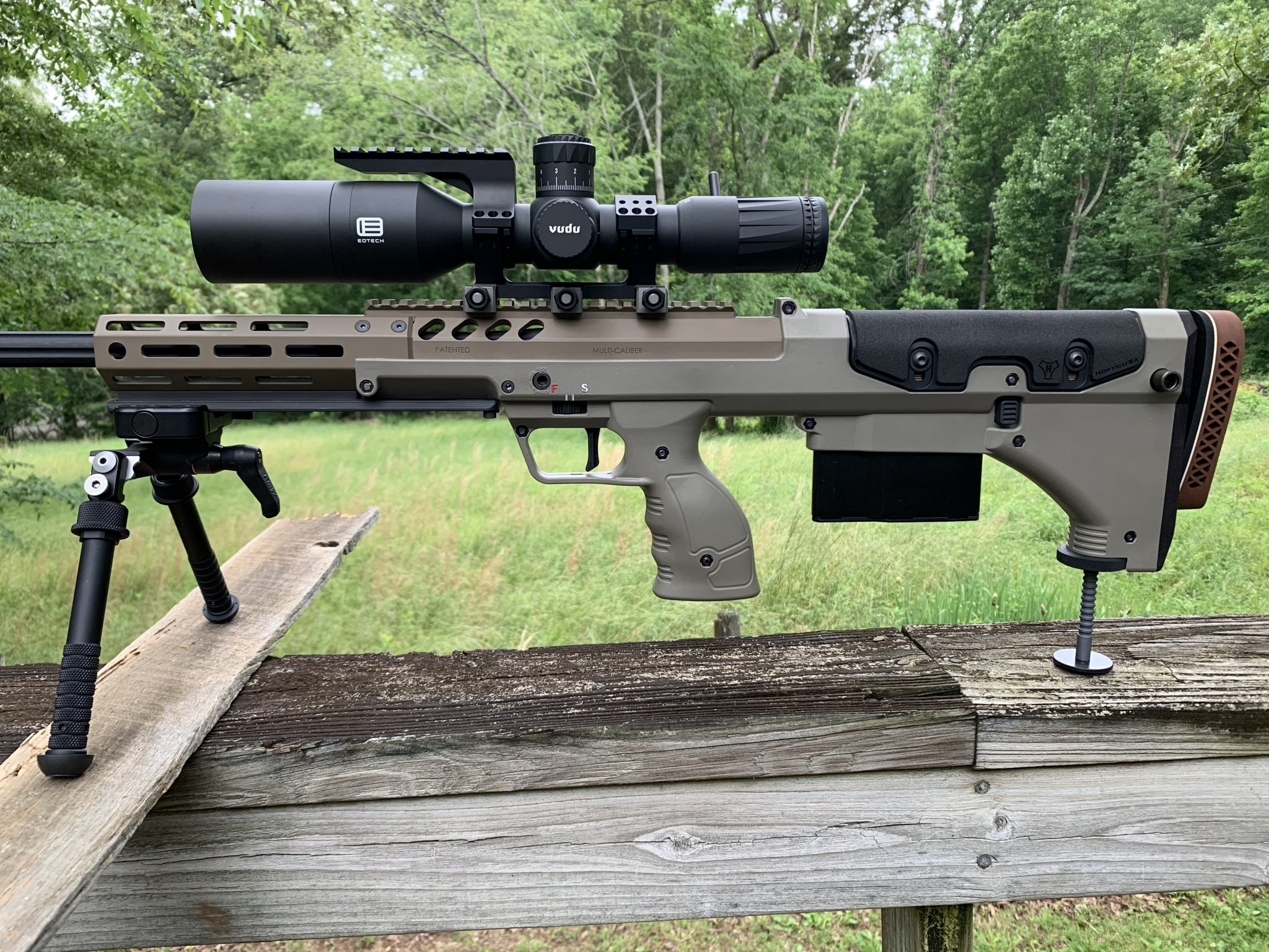

Used my old monopod, 10-32 screw and a spare MPA bag rider I wasn't using. Works decent.

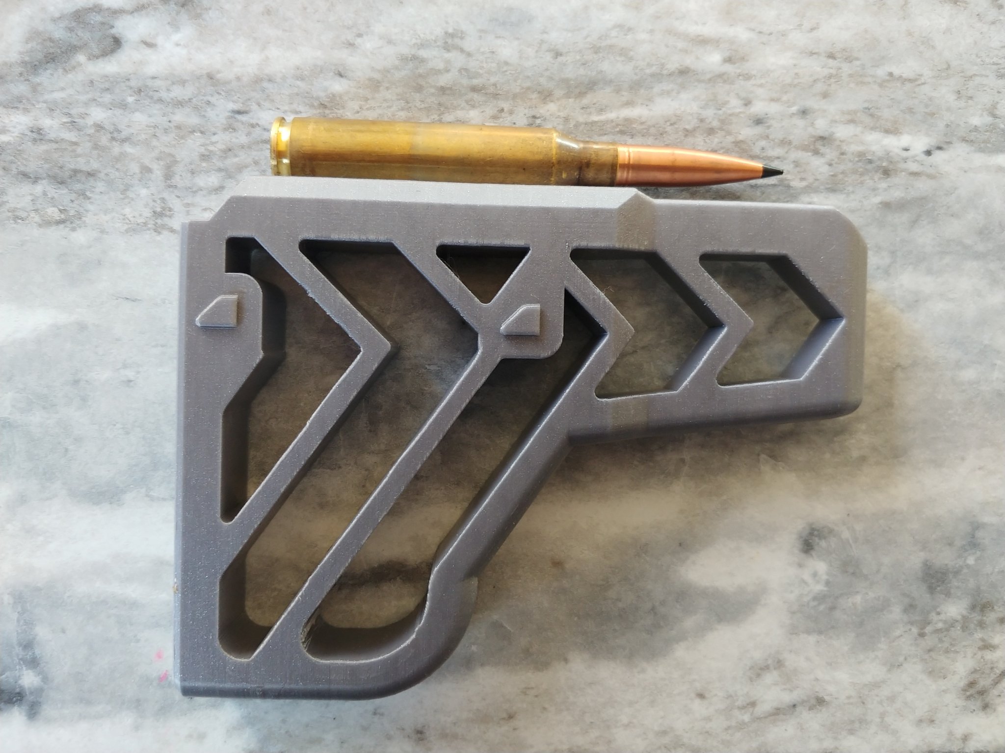

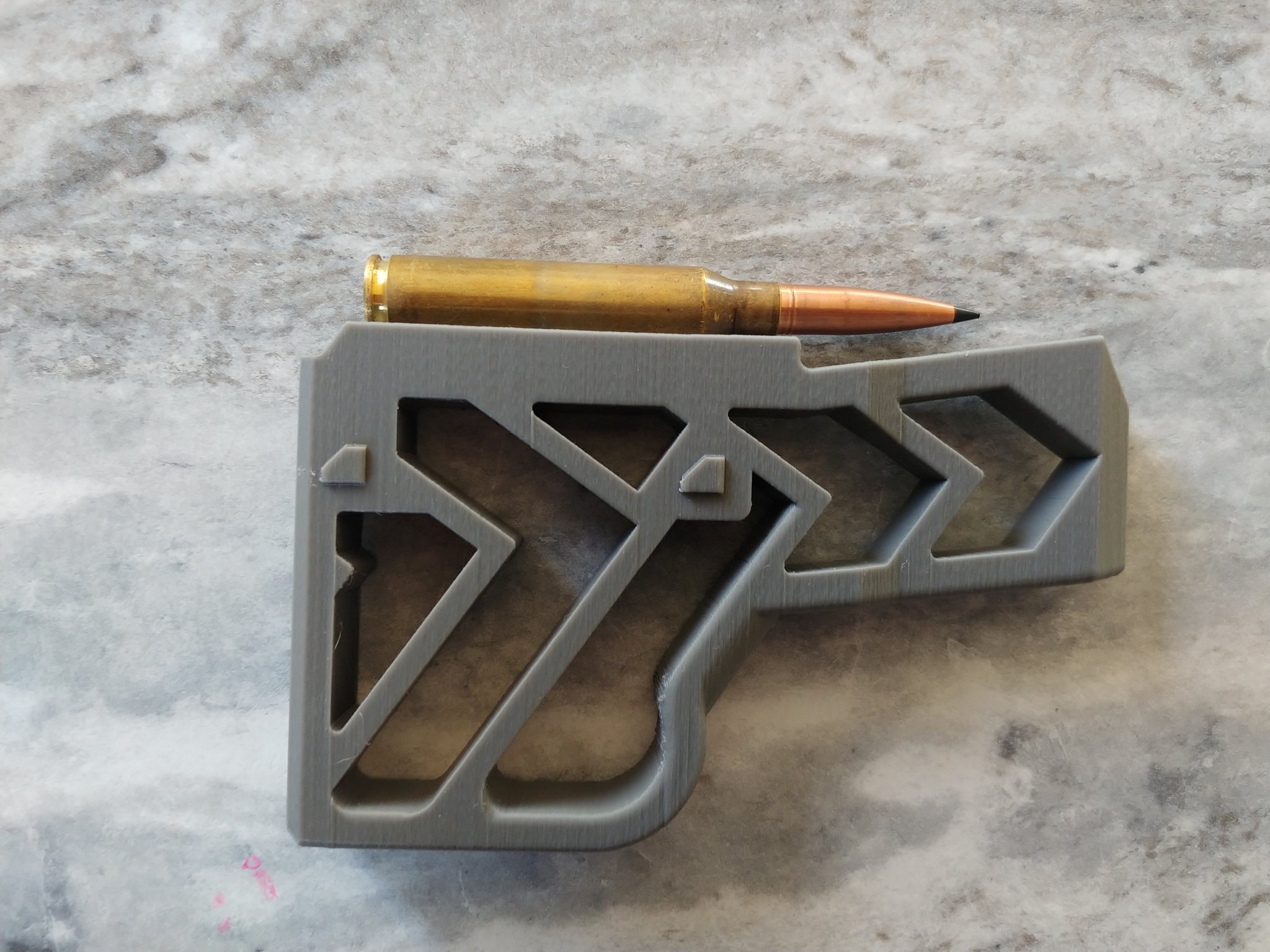

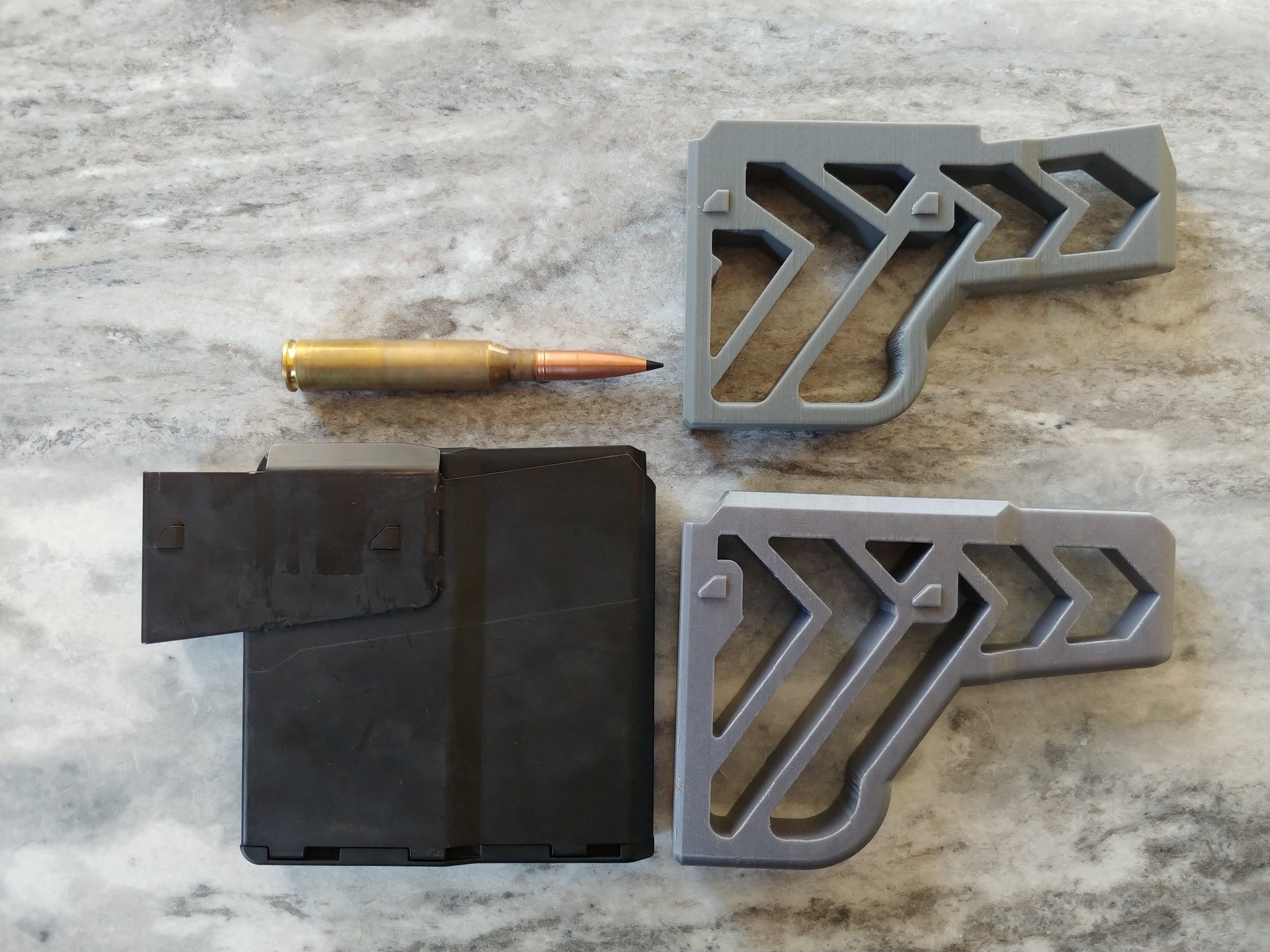

Kirt McKenna over on Facebook under desert tech rifle shooters has a pretty cool mag sled that he's come up with. He has a couple different sizes. Standard and HTI. The HTI fits awesome in my rifle, it fits 375ct all the way up to 50bmg same sled. I just thought I'd help the guy get his product in the hands of shooters. Awesome guy to deal with.
Hope this helps someone out.
Xdeano
Been doing some testing on his HTI sleds. Both sleds work well for the 375ct, the flat top works better for the larger rounds 416B and 50cal.
The ergonomics give you a bunch more room for your hand/ wrist behind the grip. They lock in very nice and have no wiggle. It's a really good fit. Hope this helps someone.

I’ve explained how I did mine with an older picatinny Gen ii a couple of pages back.
I used a area419 weighted and I put a steel insert inside the hand guard and with some 10-32 screws made some magic happen.

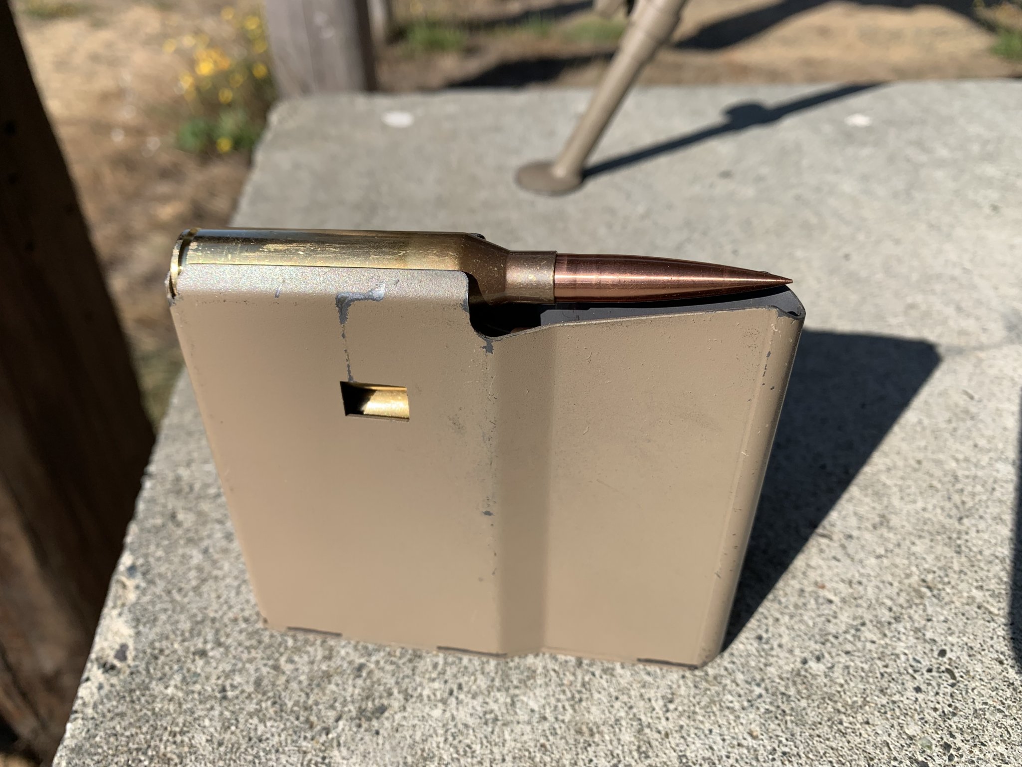

As much as I think the magazines are the weakest link in the SRS system, this morning I really appreciated being able to magazine feed such a long 3.910” COAL.
Magazines are really the only thing that I wish could be changed. I do love the extra length available for seating the bullets long, but I do wish there was a way to make it a double stack so the mags wouldn't be so tall
Agreed, though I remember Nick saying back at the start that he designed the magazines single stack so it would capture the shoulder, preventing the cartridges to moving too far forward during recoil. Historically, making a successful proprietary magazine for a new firearm has often required orders of magnitude more effort than originally expected.
