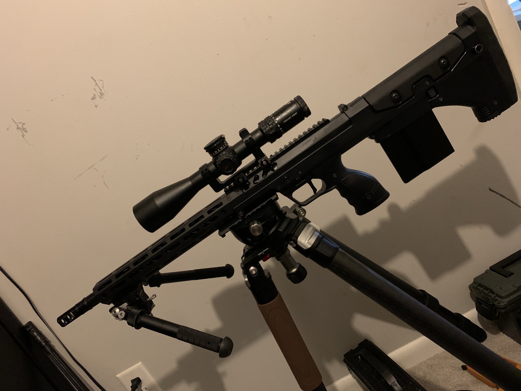

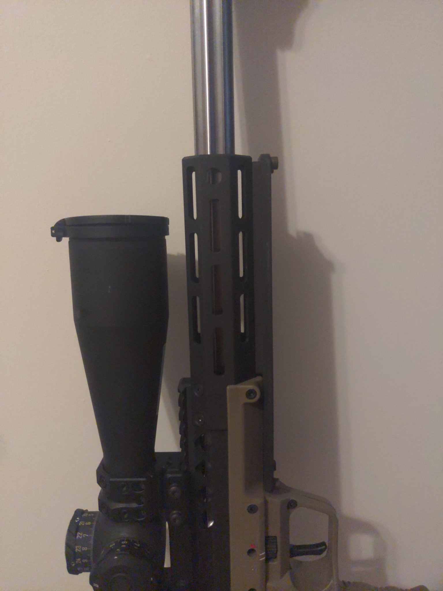

as for the sawtooth rail, it goes pretty far back and I’ve been pretty happy with it. Here’s a picture on a leveling head. I can see how the older A1 style mount could get you farther forward but the upside of this one is that it sits nice and low
Reactions: Edgecrusher
They do look great, and I plan on ordering one soon, I just wish the rail extended all the way back like the A2 rails do. I get why they don't though, it would make the rail quite thick and bulky for the rest of the length along the forearm.
I would rather have a step at the back and the rail go all the way to the rear for tripod use. I’m sure that would be a bit more expensive and the 2 people that use a DTA for prs would be all “but now I can’t slide my bipod all the way back real quick like “
