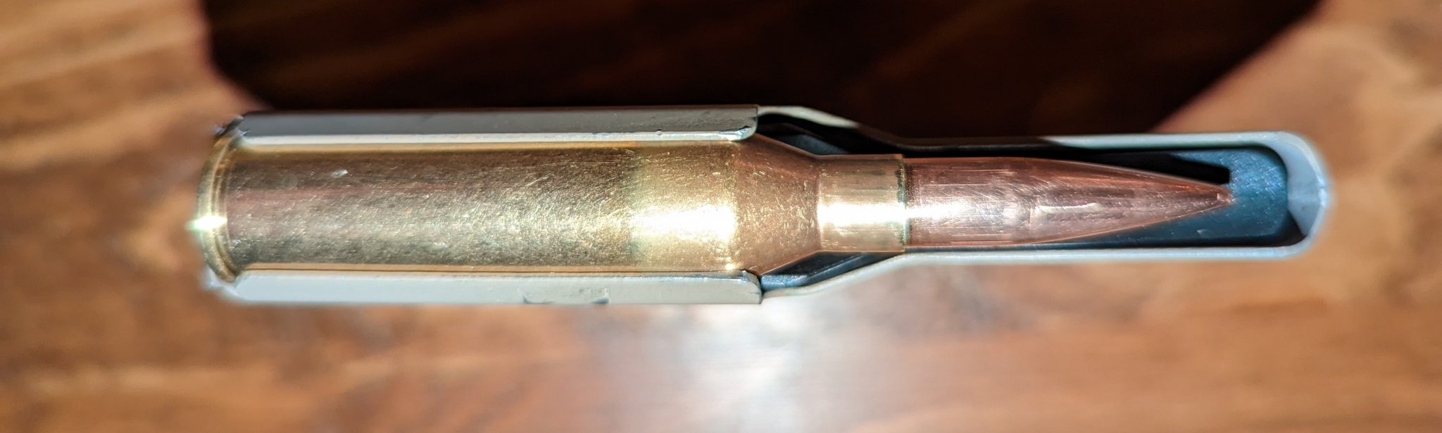

I haven't used the Norma specific mag, but this is one of my 300 NM reloads (230gr Berger OTM, 3.600" length) in the long action mag. Feeds just fine for me, but your mileage may vary depending on bullet, cartridge length, etc.

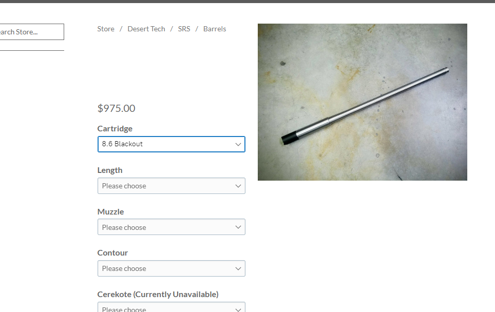

I haven't seen or heard anything yet, but it's totally doable. I would guess it's just a matter of component availability at this point (reamers, fast blanks, etc).
Looks like Eric is offering them...
Reactions: M77

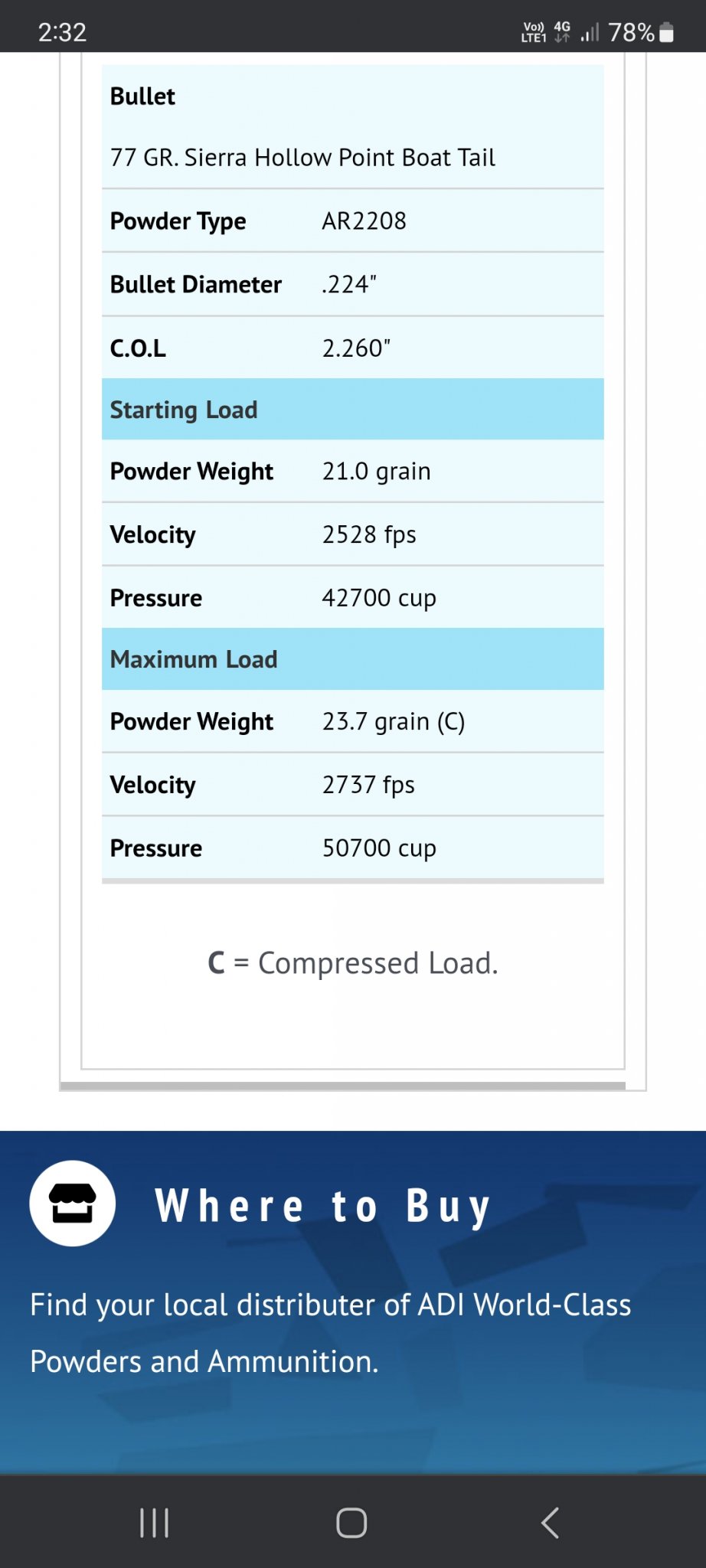

Guys I need a VARGET load for a SAC 223 conversion 22.5" 1;1.77 twist. I had a superb load: 25.5 grains of RL15 loaded to 2.50" COAL (mag length) in hornady (high capacity thin walled) brass, about 100.7% case capacity according to QL, with a 75 ELD-M. 3000+ fps (got hotter with temp, one of the downfalls of RL15, but it's a 223 so who cares). This load got me consistent hits on an 18" plate at 1150 yards. But yesterday, I made a huge boo boo and poured 1/2 pound of Accurate 2015 into a jug of 8# of RL15 thus ruining about $300 of unobtanium powder; my final and only jug. Time to go to VARGET, ordered 16# from PV where remarkably its in stock. I'm thinking 25 grains compressed load (103% or thereabouts). Thoughts? Experience?
