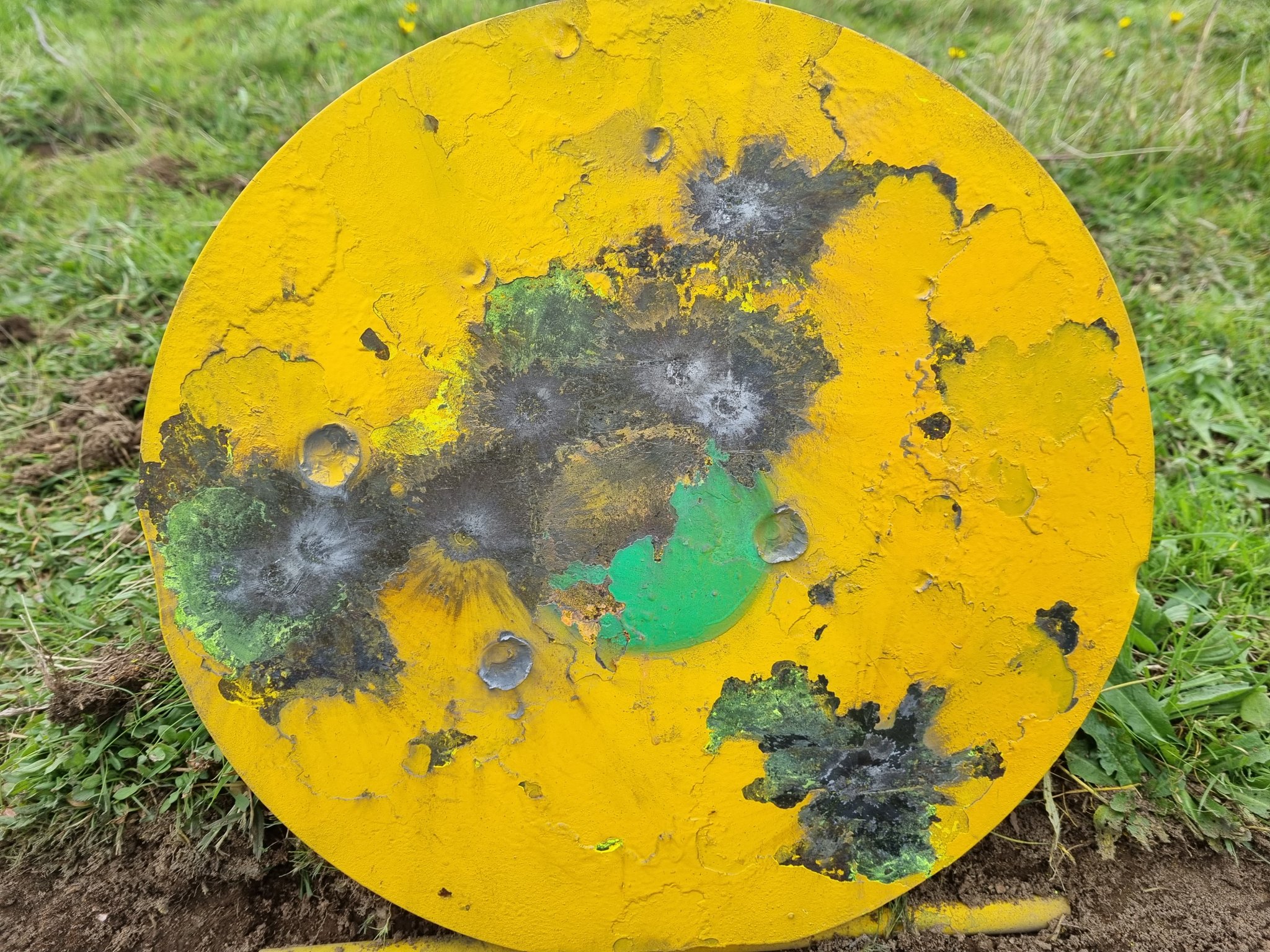

My HTI up to this point has been flawless...But just recentley when i switched to my 50BMG conversion i have had issues. 100yd groups are still tiny 3 shot clover leafs...BUT... i first noticed it at 1000yds....one shot would be good, the next 10ft vertical...then another 10ft lower...horizontal dispersion is non existent , just vertical.
Today we shot at 2000yds... i had to give up...one shot on the the next high , next low... and so on...
Up till now this load has been flawless..

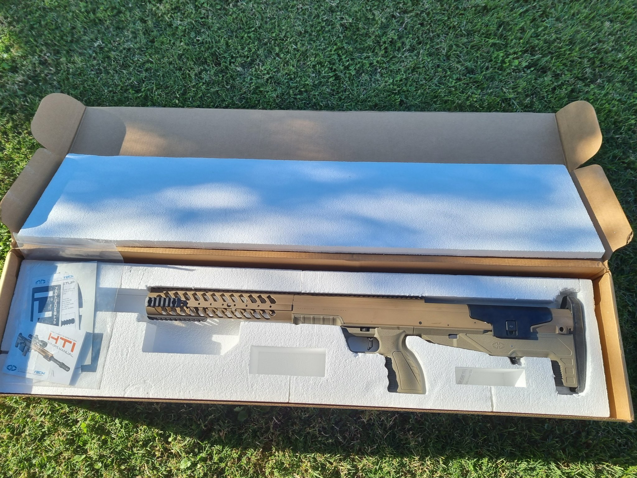

My Therory
Some....maybe only a couple of chassis have a slightly out of spec ( oversize) barrel clamping hole.
When you clamp the barrel it basically causes the hole to form an oval....this would account for vertical dispersion but no horizontal.

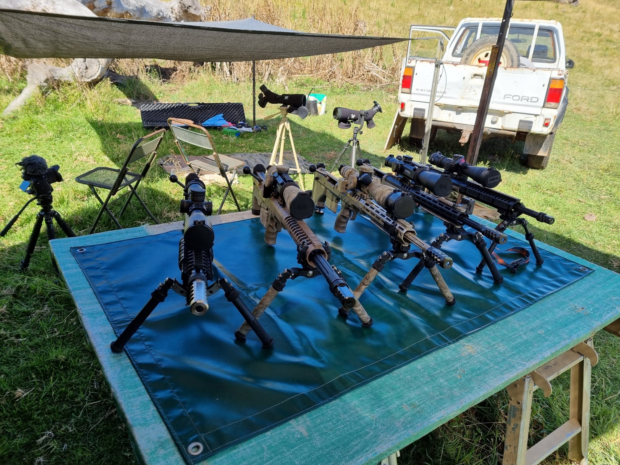

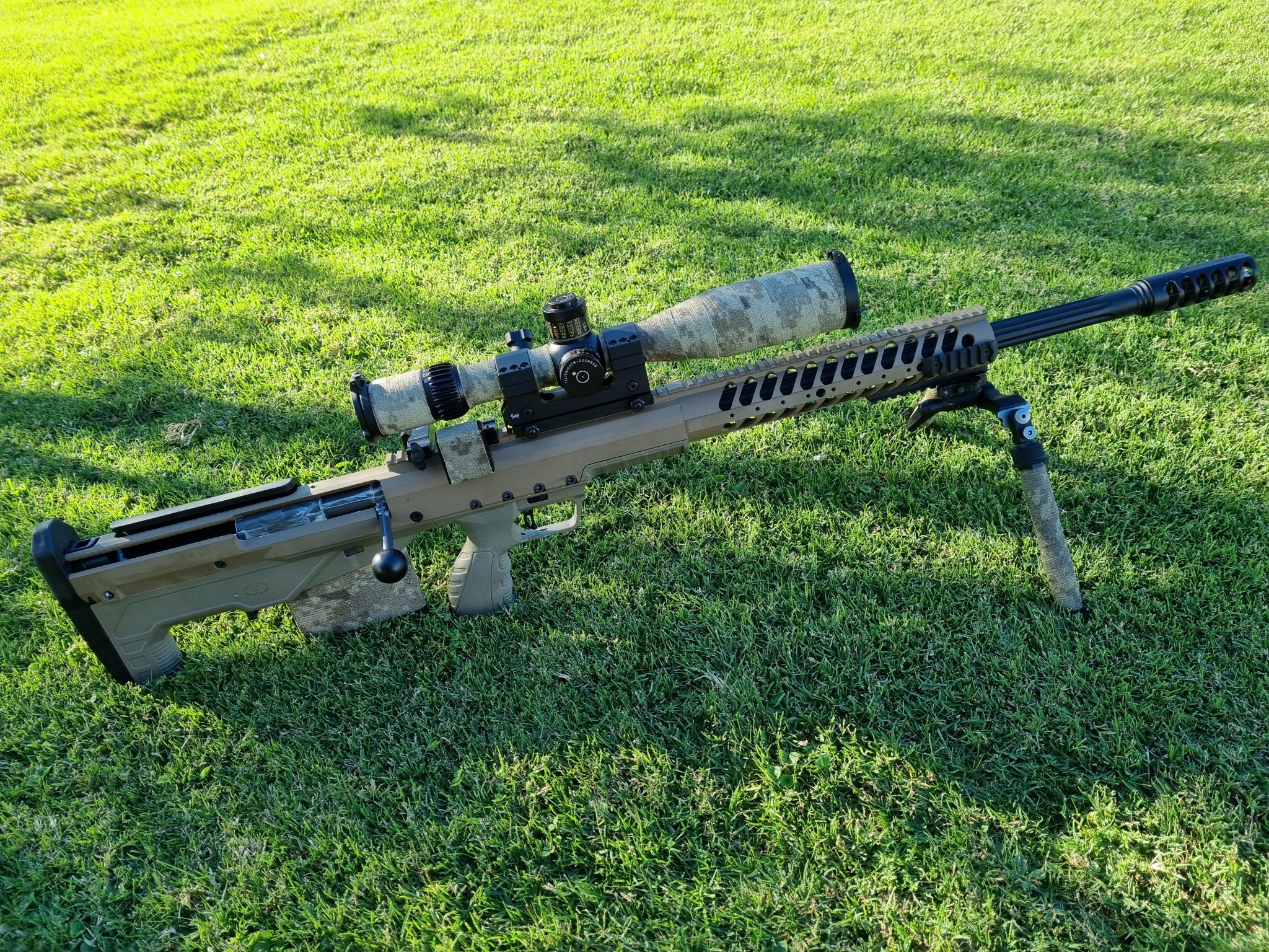

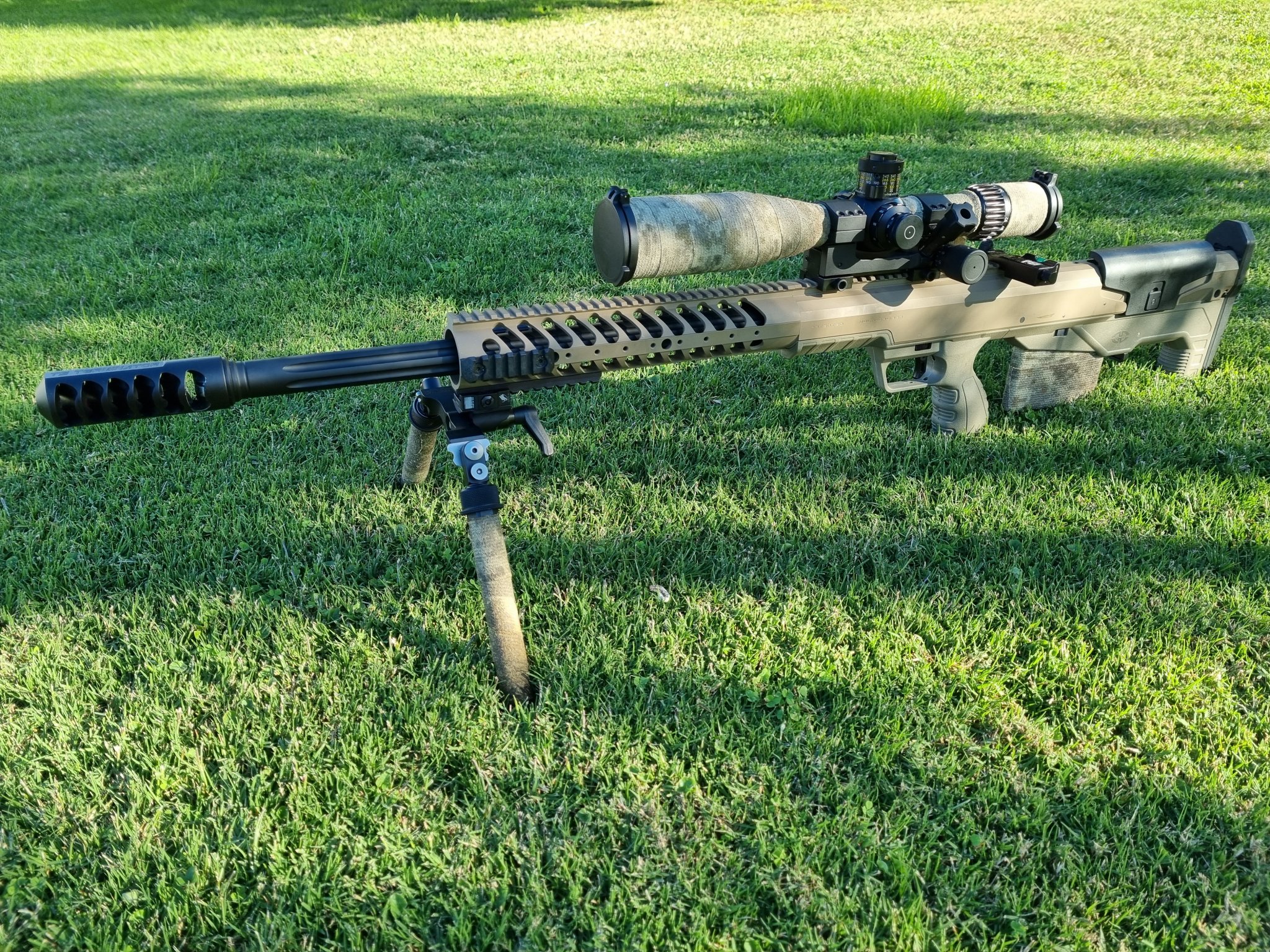

My best mate who is a DT nut as well has basically the same DT gear as me.
His HTI has a VERY firm fit on the barrel clamping area....whereas mine Literly falls in and out.
We put both my 375 and 50bmg conv in his chassis and they shoot fantastic as always.....so it is 100% an issue with the chassis.

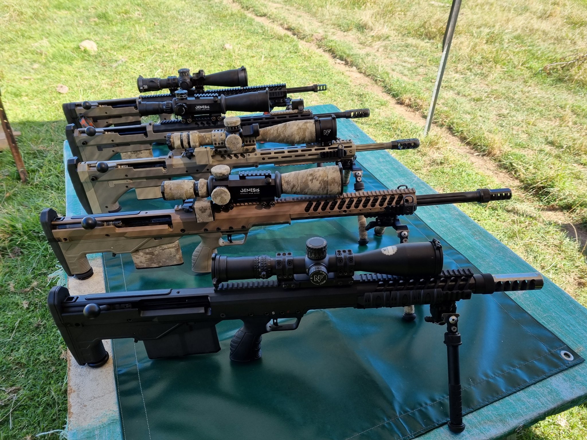

Finally got a chance to wring out all of my barrels at once and get my scope zero offsets. I started with my Steiner M7 at mechanical zero. Let's see who guesses which one I picked to be my index barrel (the one that I actually dialed the scope to zero on after getting offsets from the mechanical zero). Barrel remove/reinstall doesn't seem to be affecting them enough to detect except the .338LM which varies around .1-.2 in any direction. It's the only factory barrel but I suspect that the variance is actually me anticipating recoil like a little bitch because that factory DT brake is about as effective as the Biden administration is uncorruptable.
.223rem: U3.2, L1.3
6XC: U1.7, L1.2
.308Win: U1.5, L.4
.338WM: U2.3, L1
.338LM: U2 +/- .2, L.5 +/- .2
Everything consistently impacting right from ~ .5mil to ~1.5mil is interesting.
My personal bet is wooferocau will be the first to reply with a correct guess. It just seems to me like he probably has the most free time.
Reactions: DoctorBen
See. There's a joke of a sort that is used in my office. People will pantomime wearing a ball cap slightly off center and say, "You know I'm right. I'm always right." and when they do this they're saying that they're 100% certain that they're right and for everyone else to just shut it. The reason they do this is because it's something I say in just about every single meeting I have when I make an assertion that X is the case. I'm famous for that in part because of the regularity and in part because it seems so self-evidently true. I cheat though. I got hired for what they thought I could do which had to do with fixing today's problems and they were completely unaware that predicting the future 3-5 years out and fixing those problems is the stock in trade of people that do the exact thing that I do for a living.
You can see where this reputation might have come from and, more importantly, why.
.223rem: U3.2, L1.3
6XC: U1.7, L1.2
.308Win: U1.5, L.4
.338WM: U2.3, L1
Nice Setup. I'm guessing the .223.
I second ya on the .338LM brake. I need to update mine. It's brisk enough that I feel bad for other shooters on the line within about 20 feet in any direction. Granted... the moose and elk didn't exactly go too far.

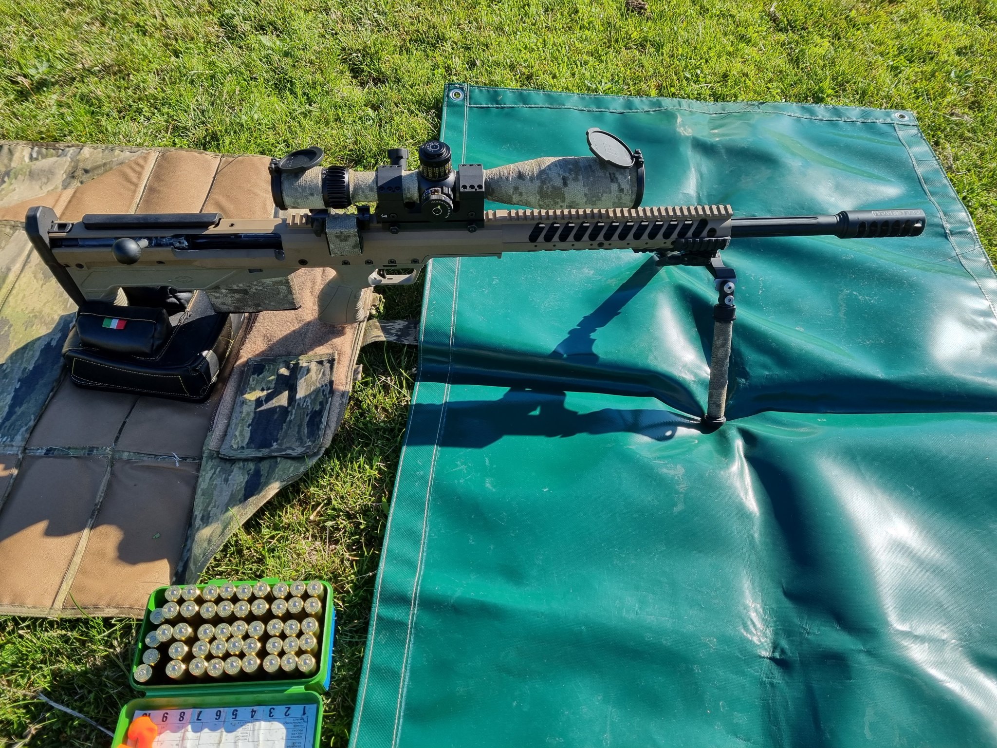

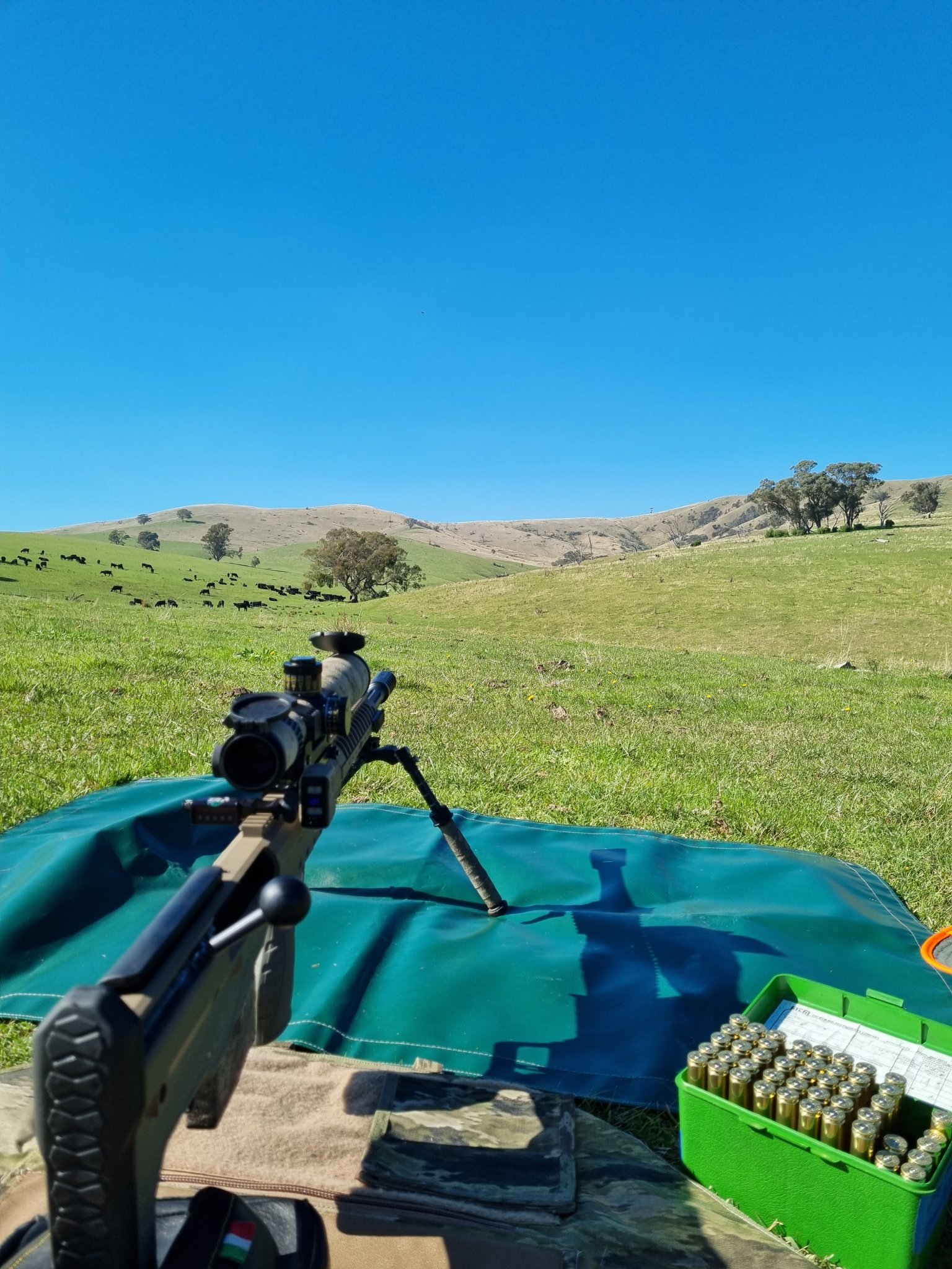

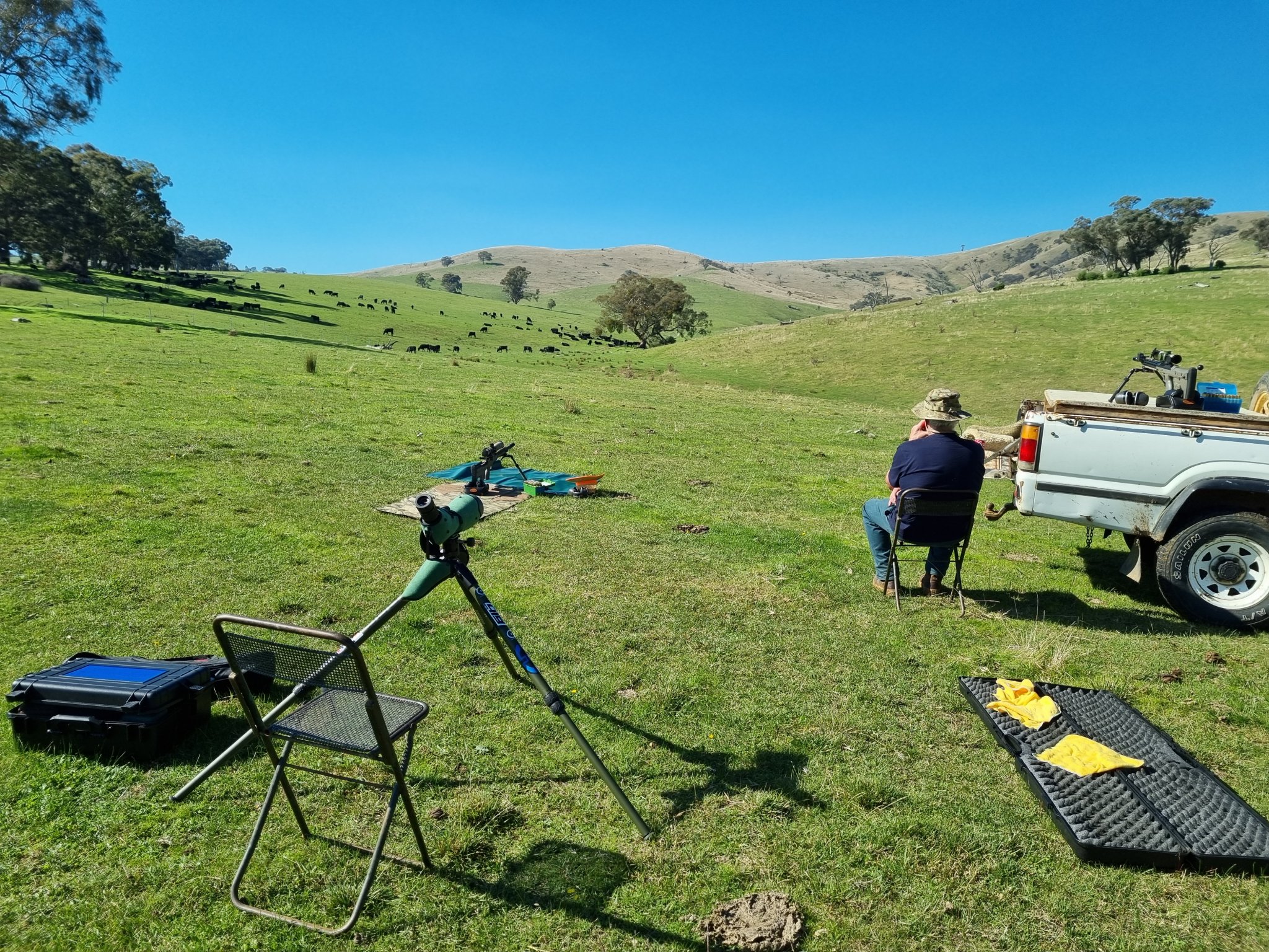

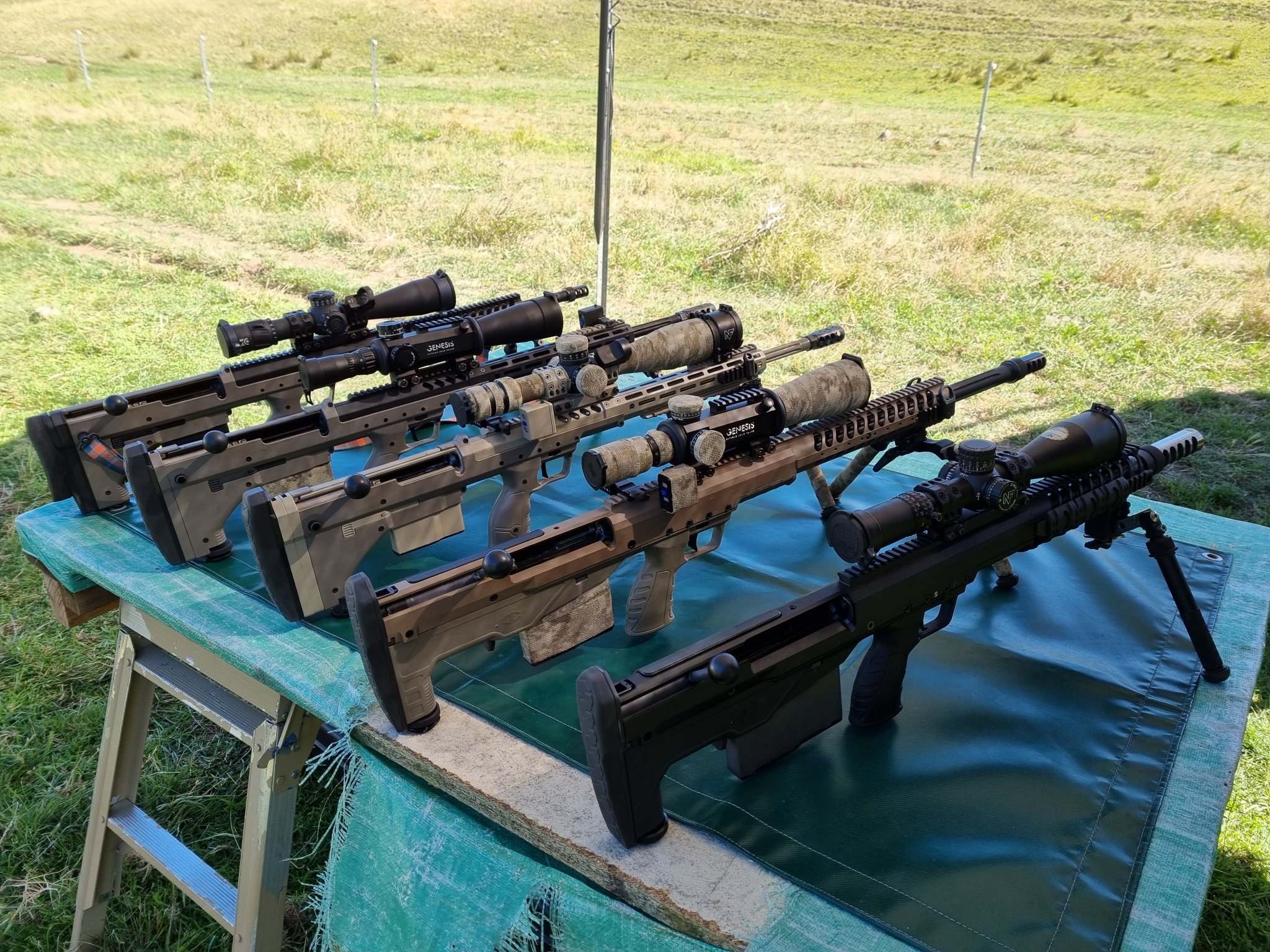

Very good results today.

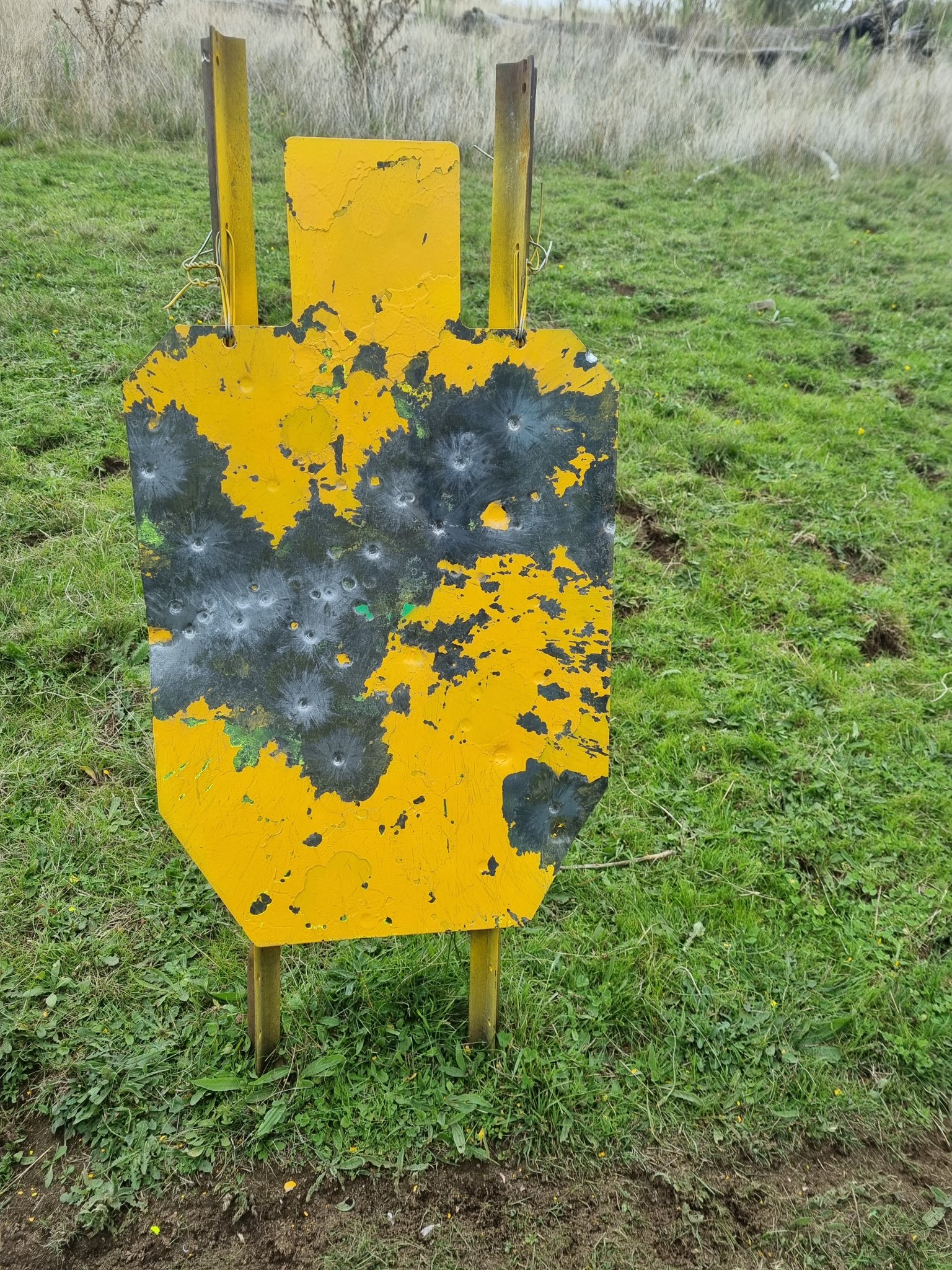

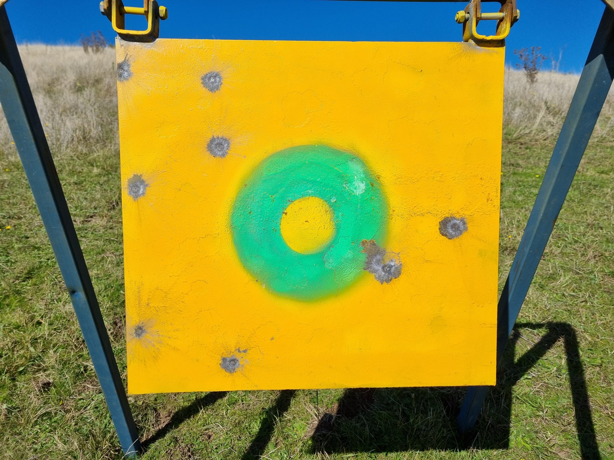

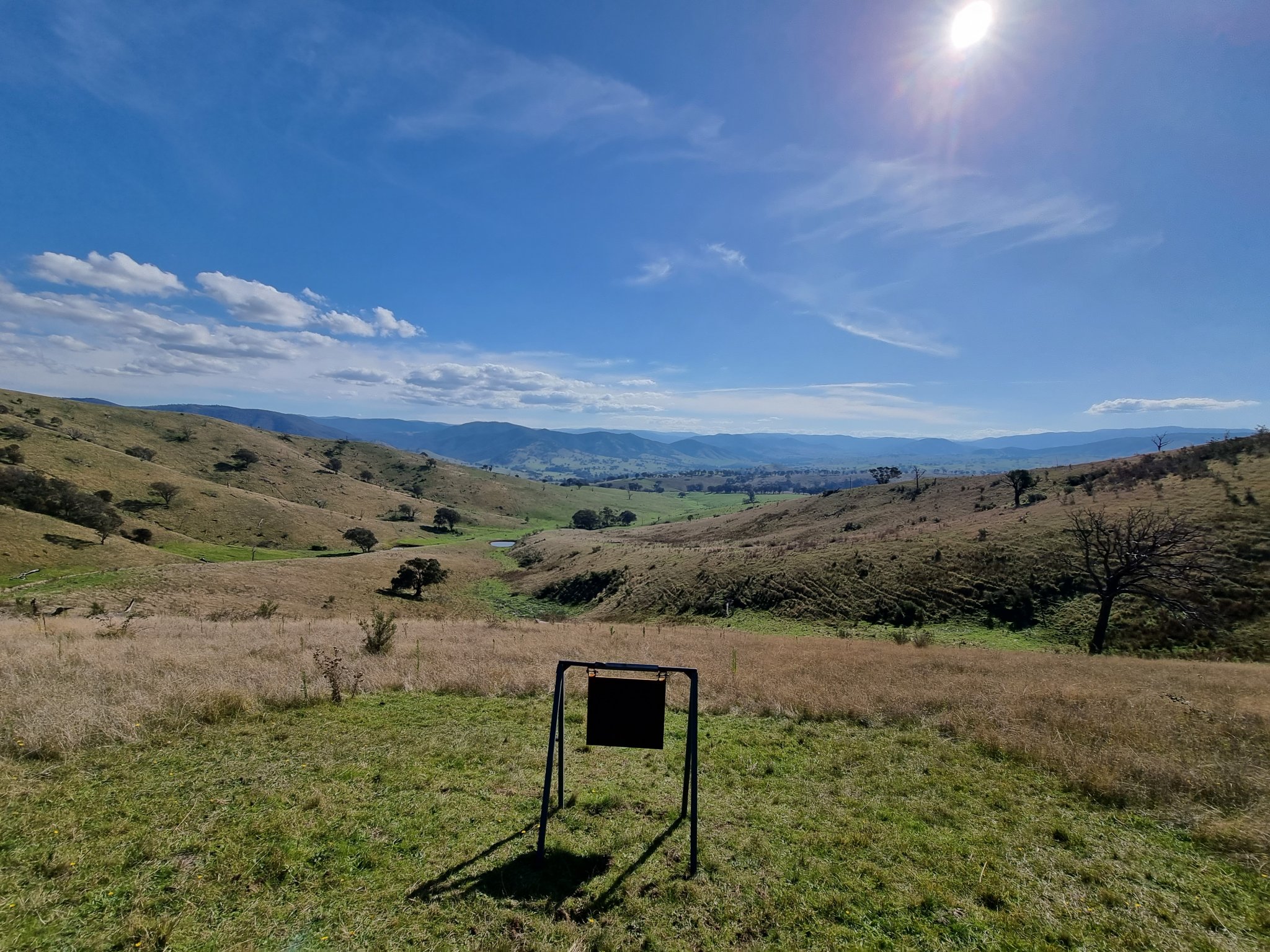

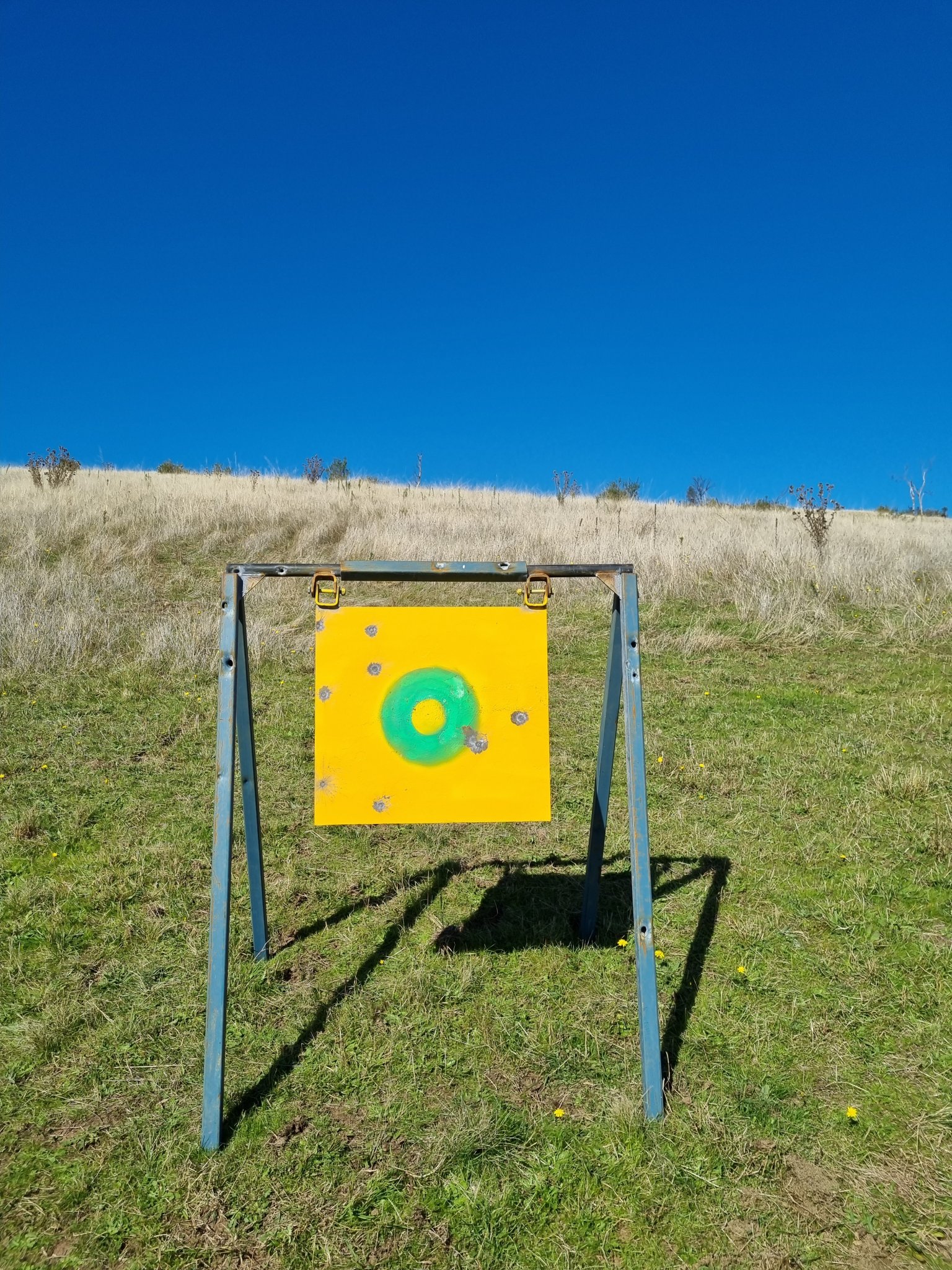

Sighted in the HTI ....100mtrs are now back to basically one ragged hole 3 shot groups..
2500mtrs......
Plate is 20" x20"
Wind gusting right...left..
12 shots fired ....9 hits...
The 3 misses were off left edge...very very close
No more problems with vertical dispersion...
With my old chassis I could not hit a 12" plate at 1000 the vertical was that bad.
Very Very happy with the outcome..
