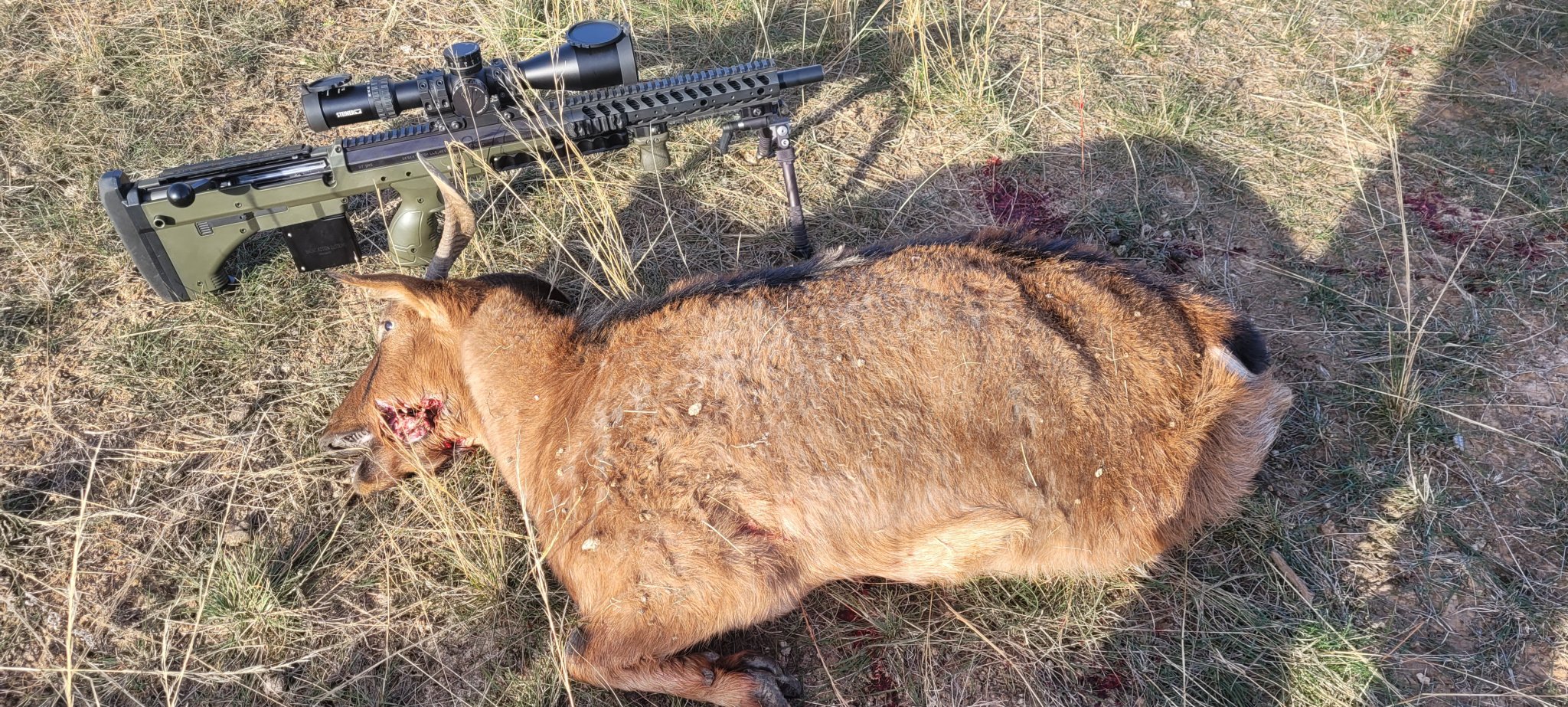

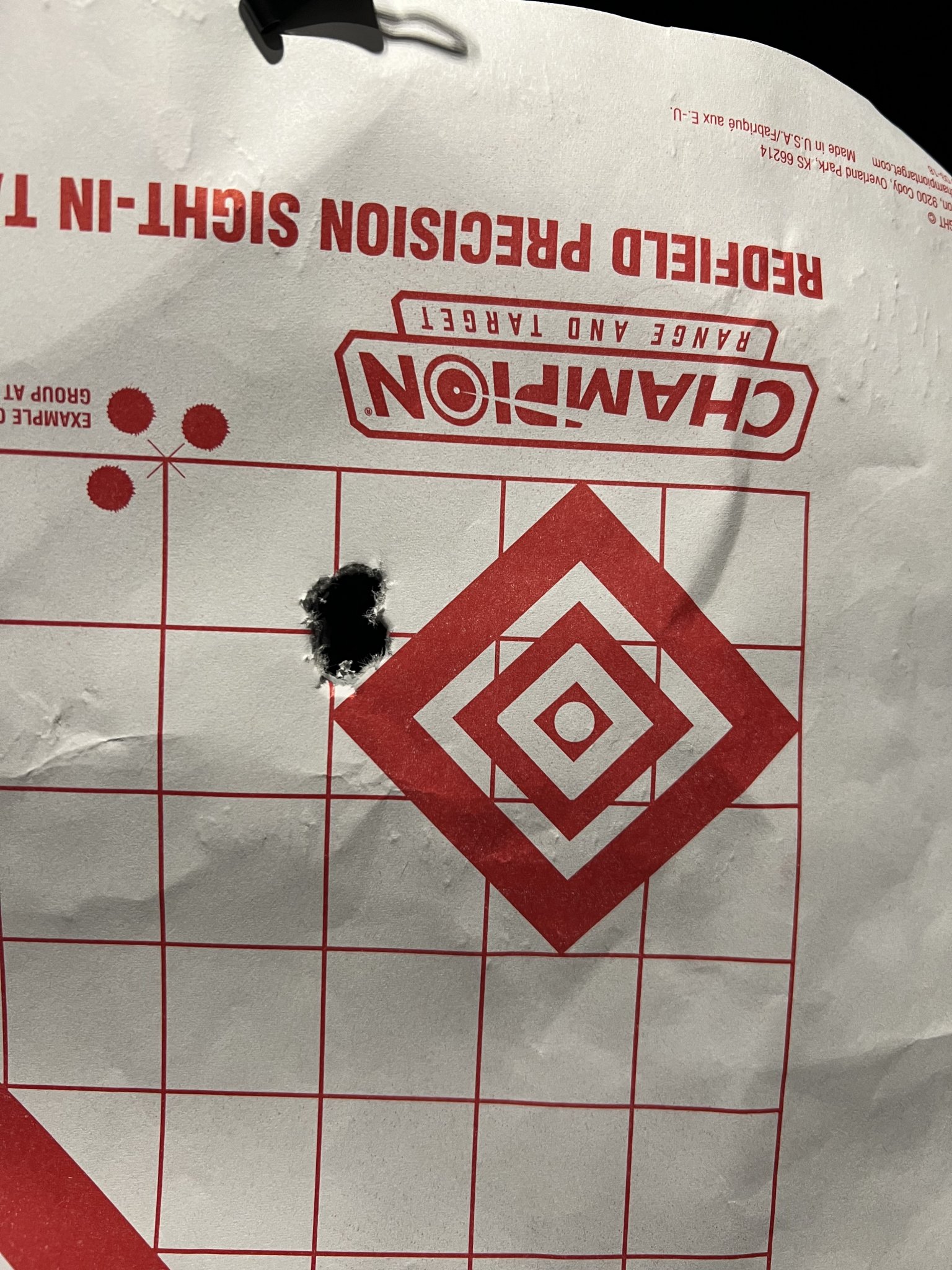

Was asked to take care of a mob of goats, displaced 12/14 with the SRS A1 in 223. 80gr elds work great

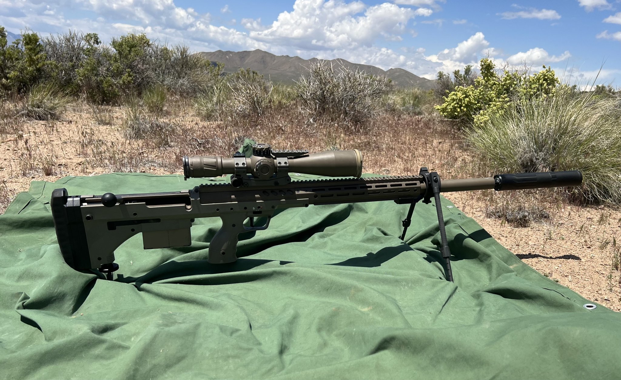

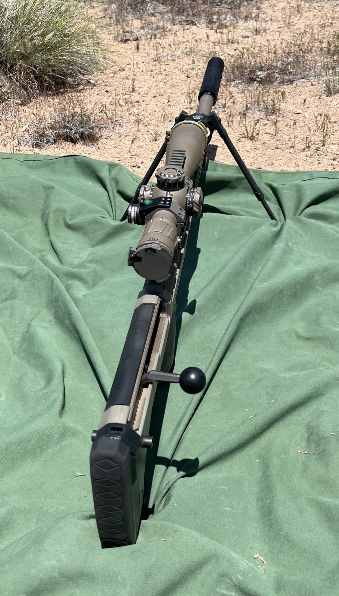

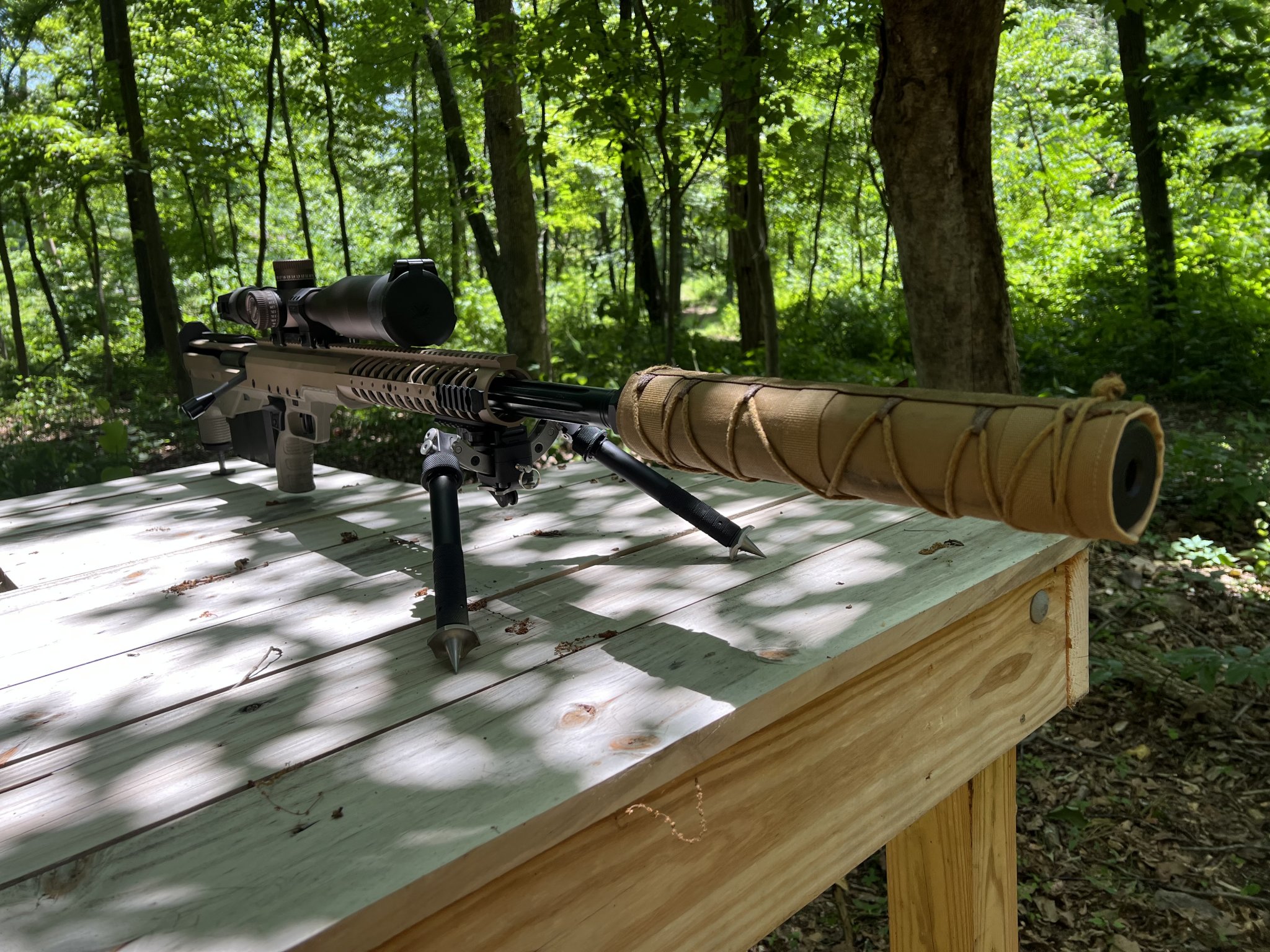

Do it! Was just shooting mine today. Finally got to take this mongo thick SAC .300NM to a mile.
The integrated ARCA rail is really nice and once it gets dark we’ll see how the canted top rail works with clip-ons.

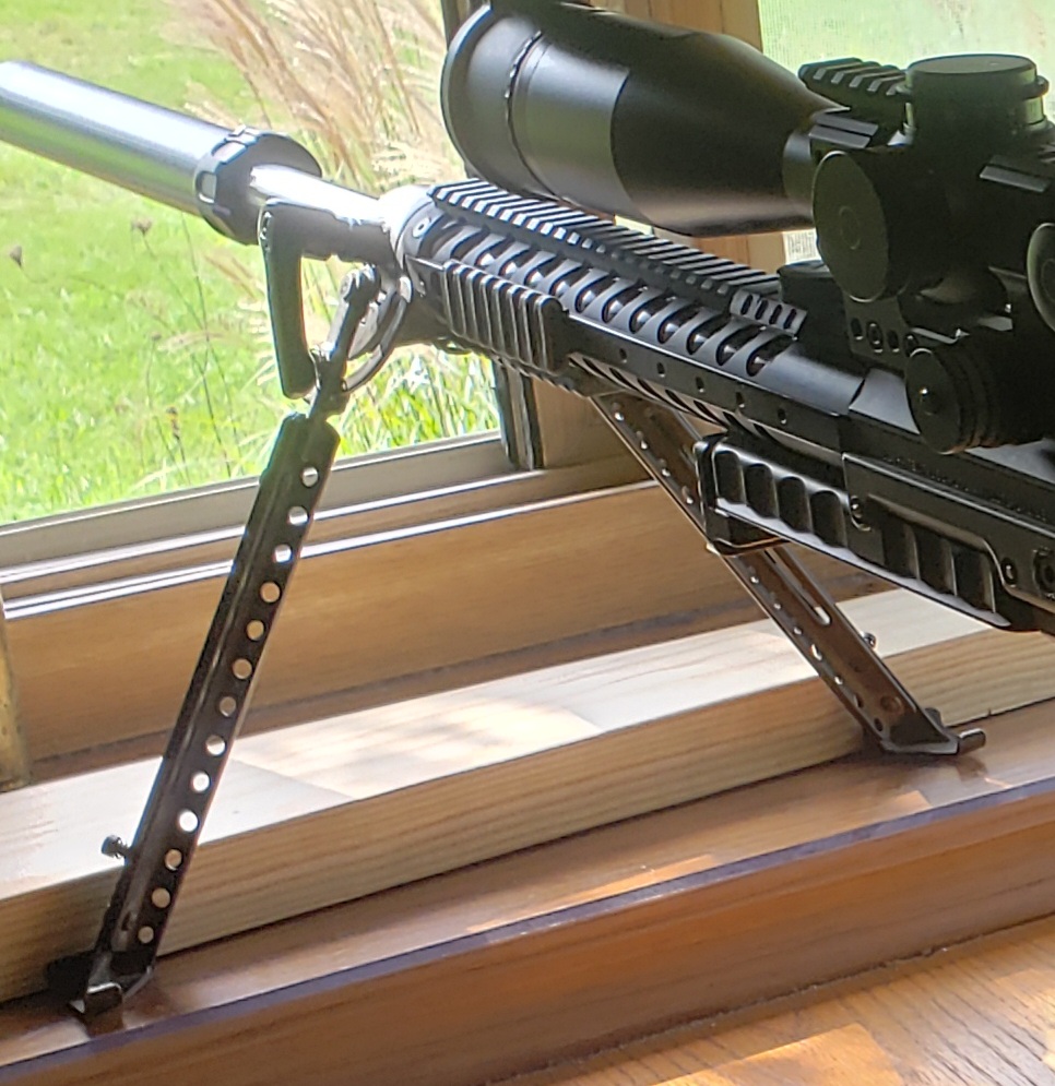

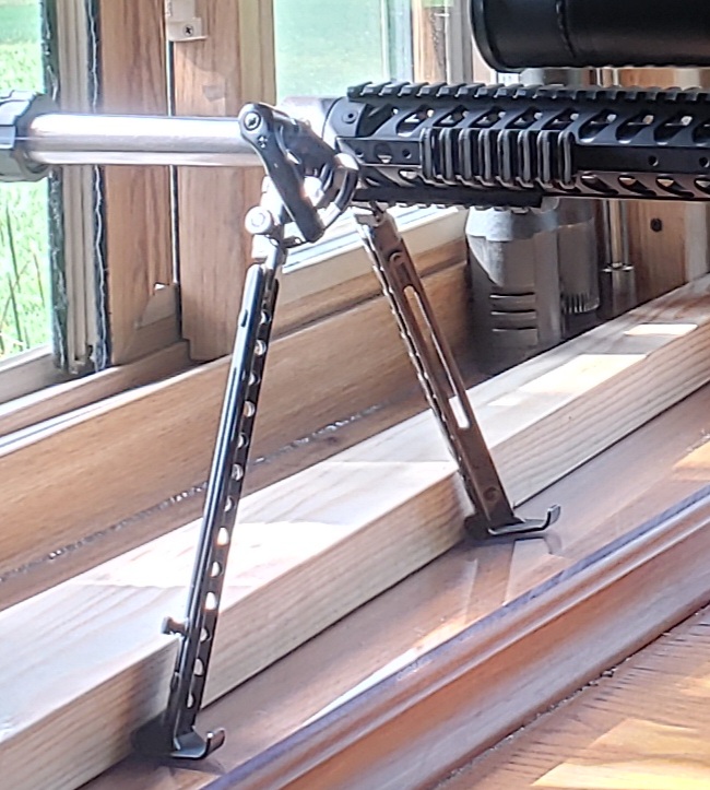

On the Revolution Bipod, I really wish I’d gotten one earlier. I’ve been a big fan of over-bore bipods for ages, especially for larger rifles. Over the years I’ve had to rely on various custom made rigs, and when I added the M2 I dabbled with a UTG over-bore bipod because it was an affordable experiment. But since biting the bullet on the Revolution I’m now kicking myself. Yeah, it’s expensive, but so are barrels and optics. It’s a fine piece of engineering, super stable, and quite versatile in its mounting options. In fact, I’m having them make me an extended mount so I can slide it out further when needed so it doesn’t get in the way of the notoriously bulky PVS-27.

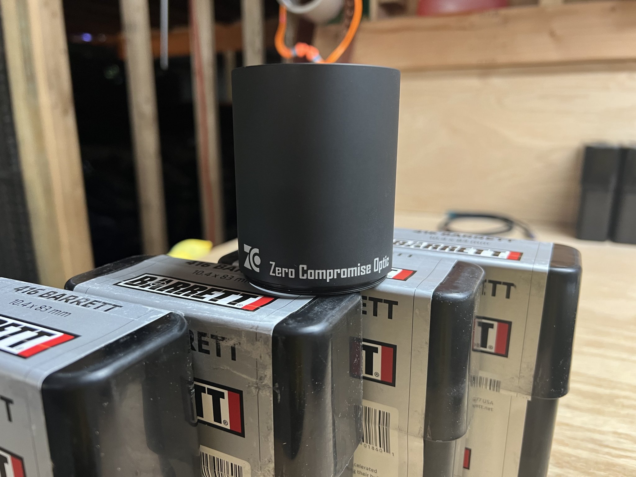

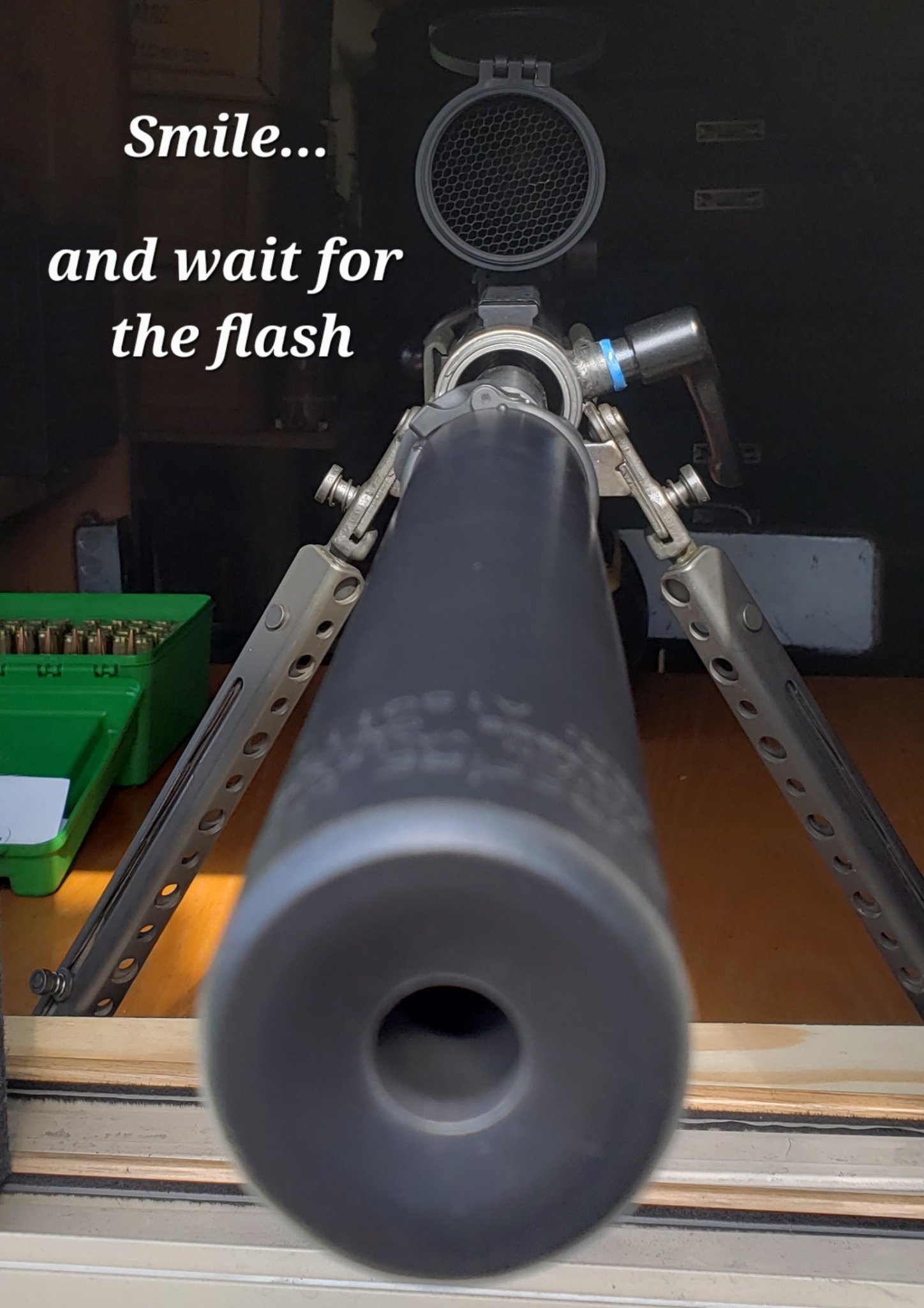

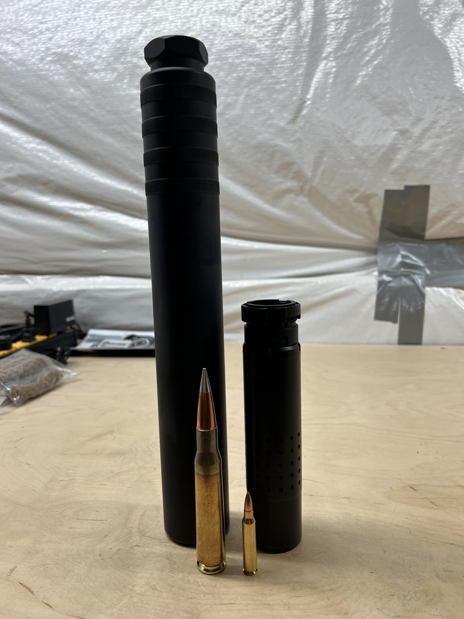

I was a diehard Atlas guy, wouldn't even consider anything else until i saw a EI in person and was shown its capabilities.. That's all I buy now... You can see here the 50 started off with an Atlas.. Even have one of EI's cans..

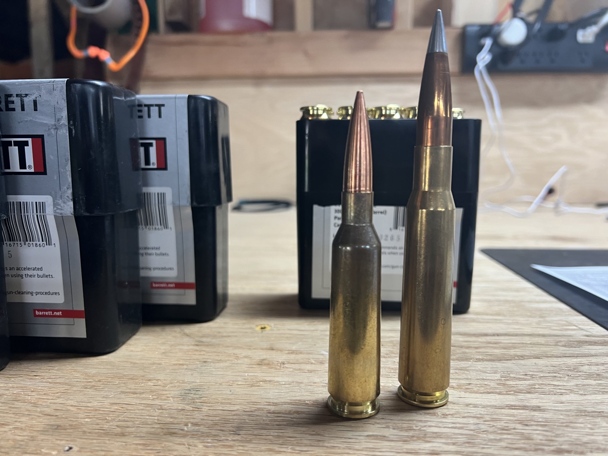

223 next to 50 BMG and the corresponding cans..
