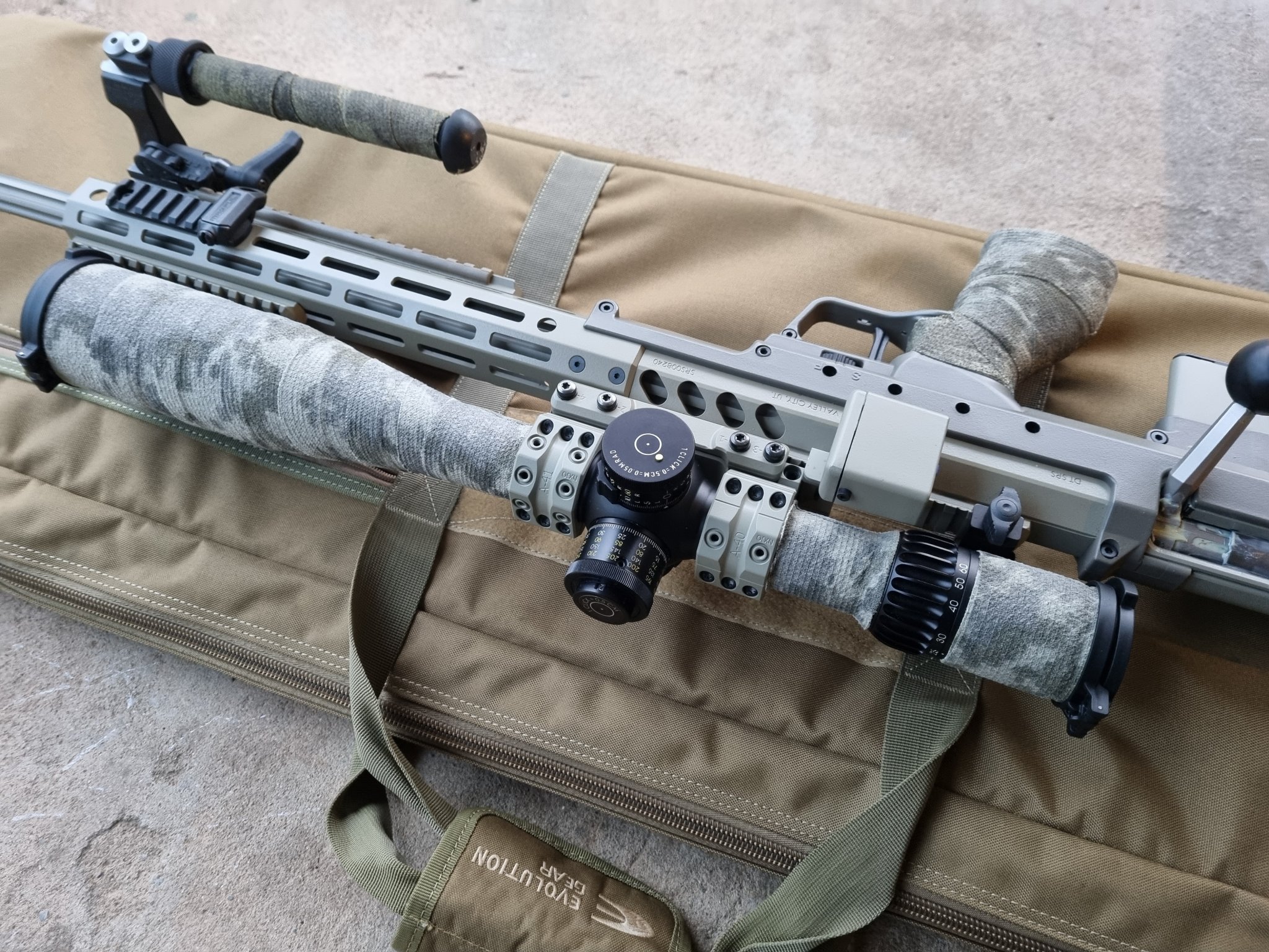

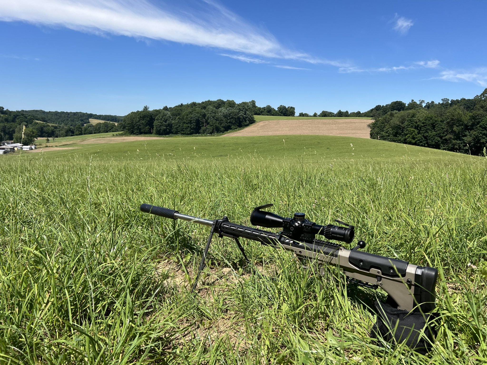

Now that's quite an optic!
How do you like it?

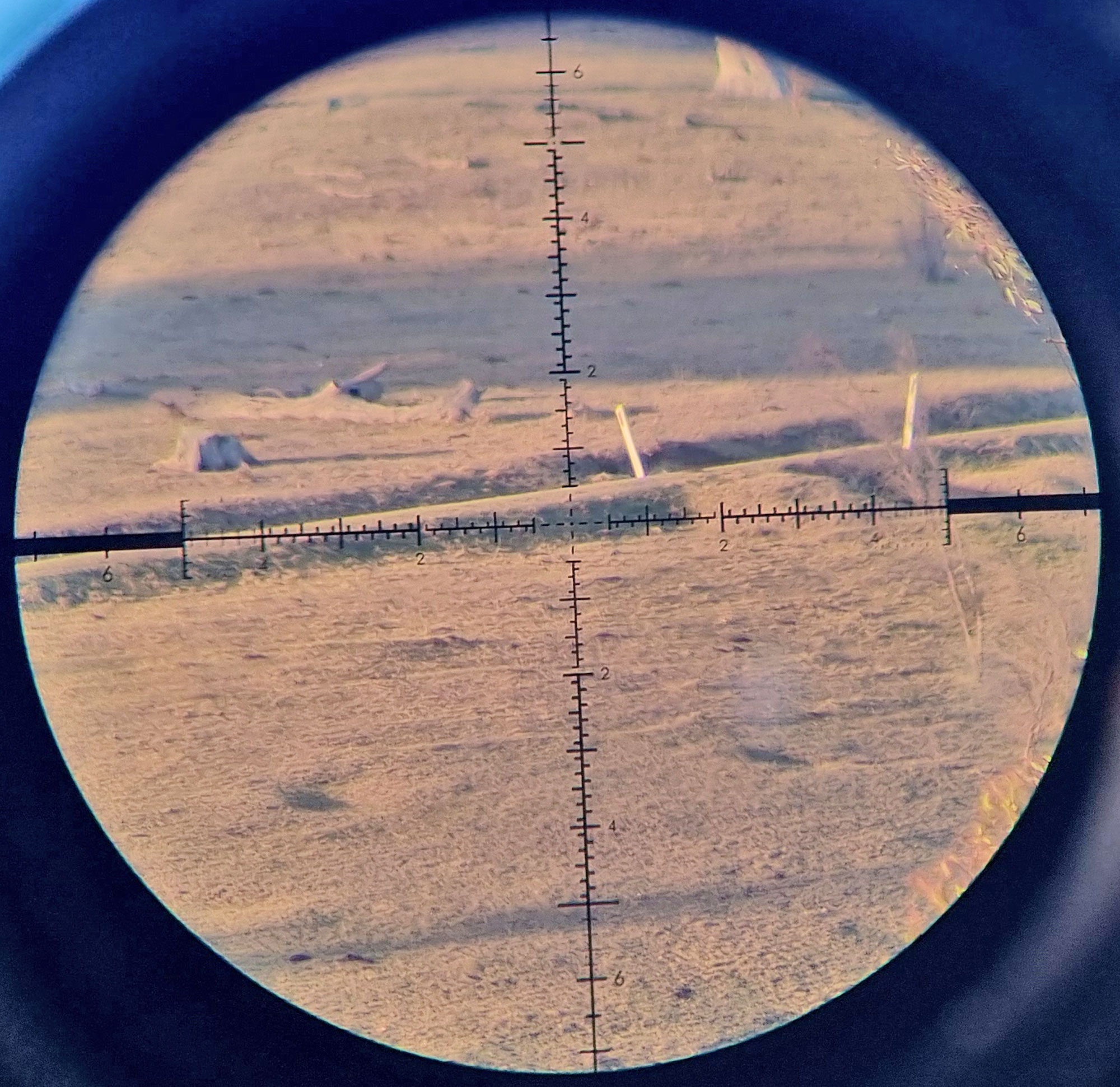

What reticle do you have?
Is the box mounted on the side of the scope an electronic level?
Absolutely love it... its a 6-36 on steroids...slightly sharper than the 6-36 with more contrast
40-50x is crazy sharp !! I love using high power at ELR...so this scope really suits my taste.
M1FL reticle..
Box is a...........Rianov CSI Digital Cant and Slope (Cosine) Indicator
