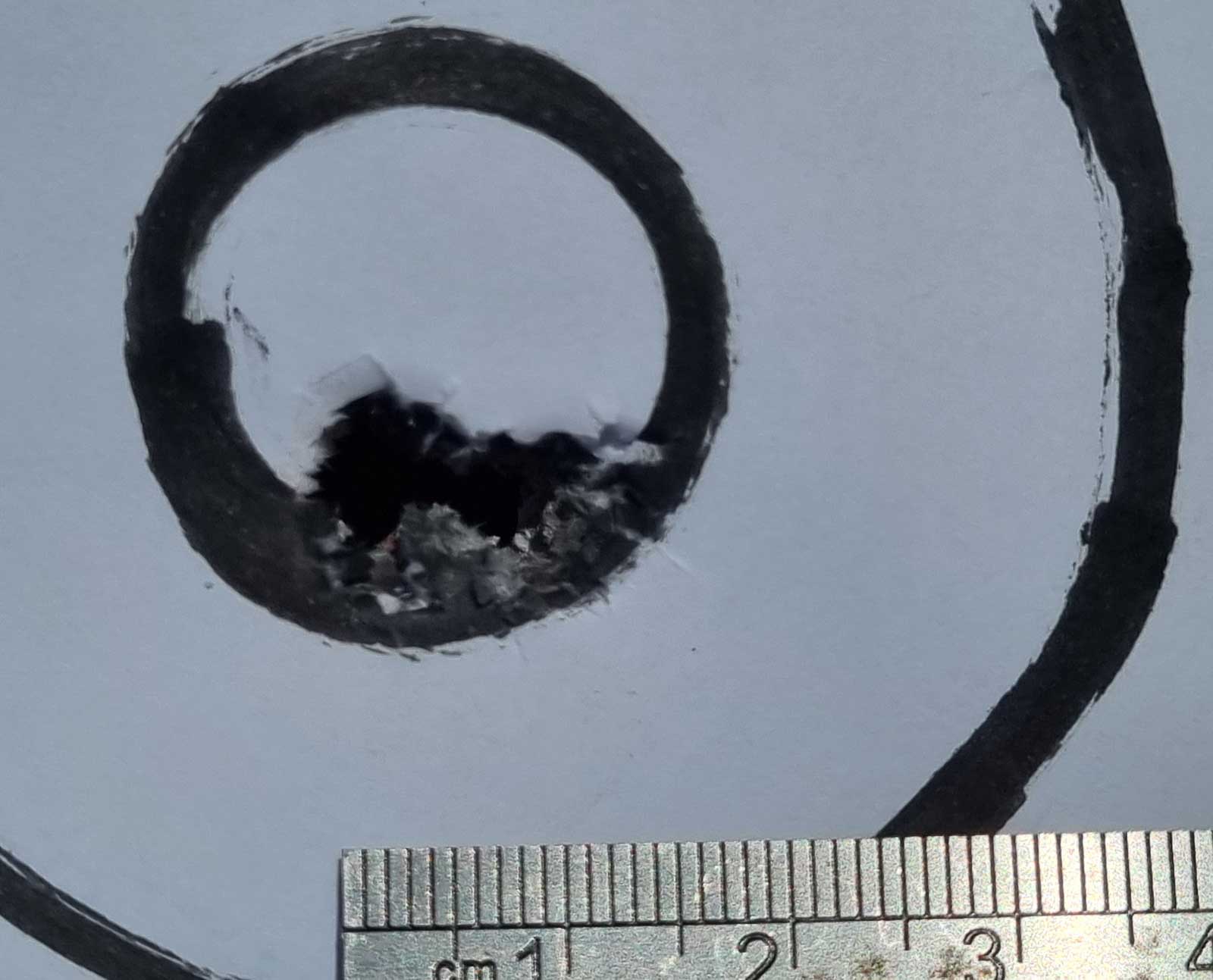

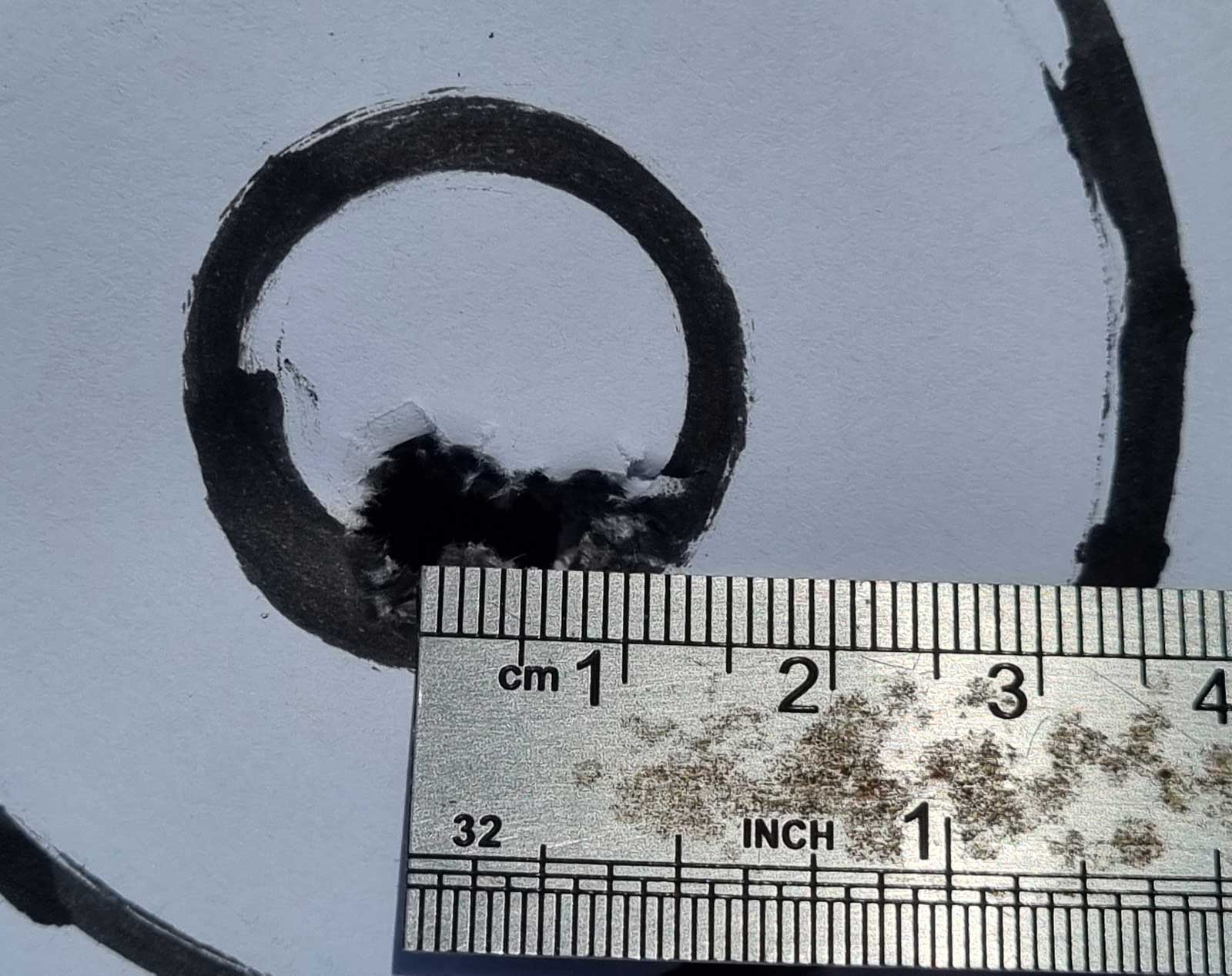

Speaking of 285 ELDM....
Re Zero,d the SRS 338 lap yesterday with S&B Ultra Short......5 shots 100yds 285 ELDM... :)

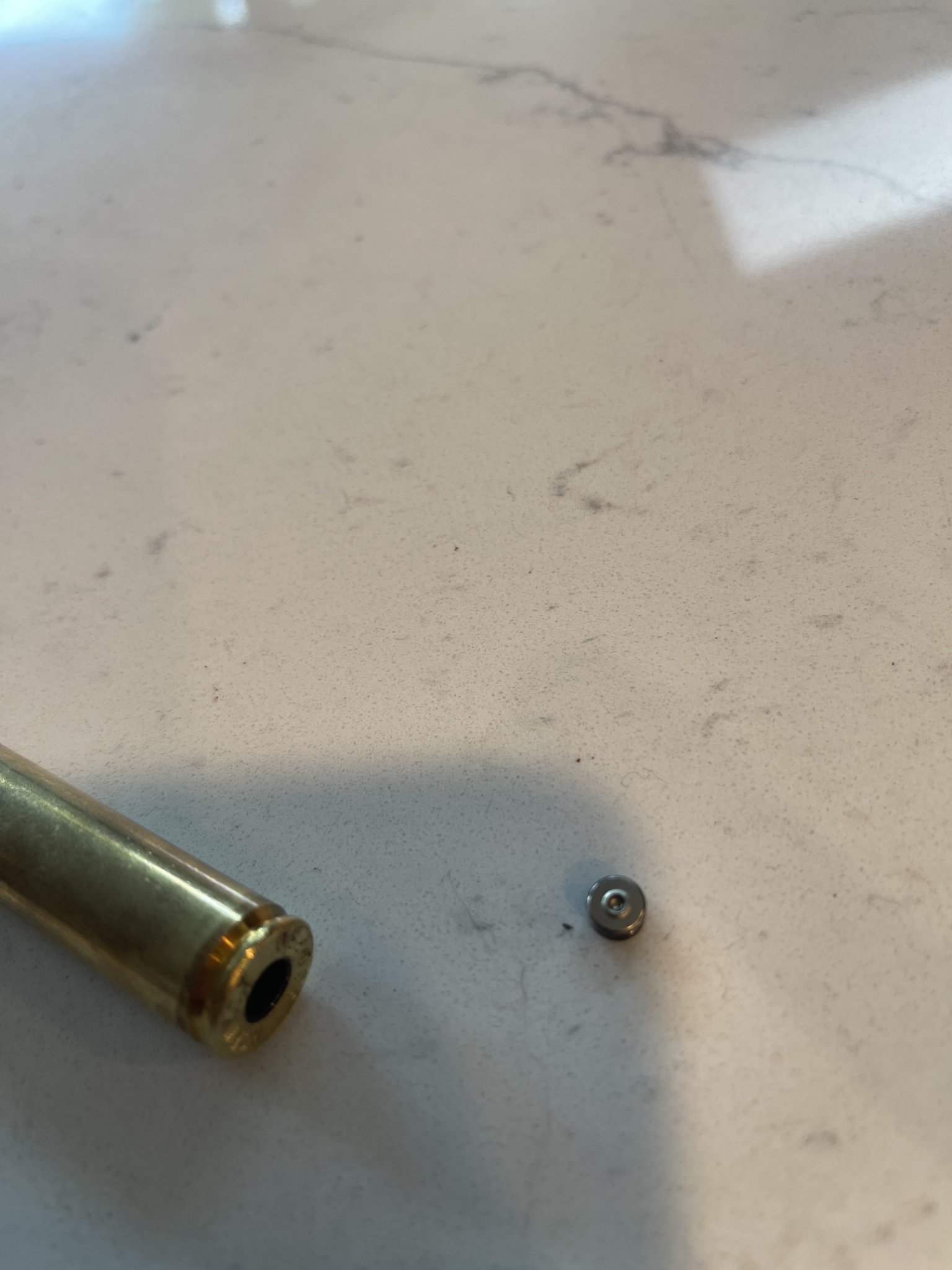

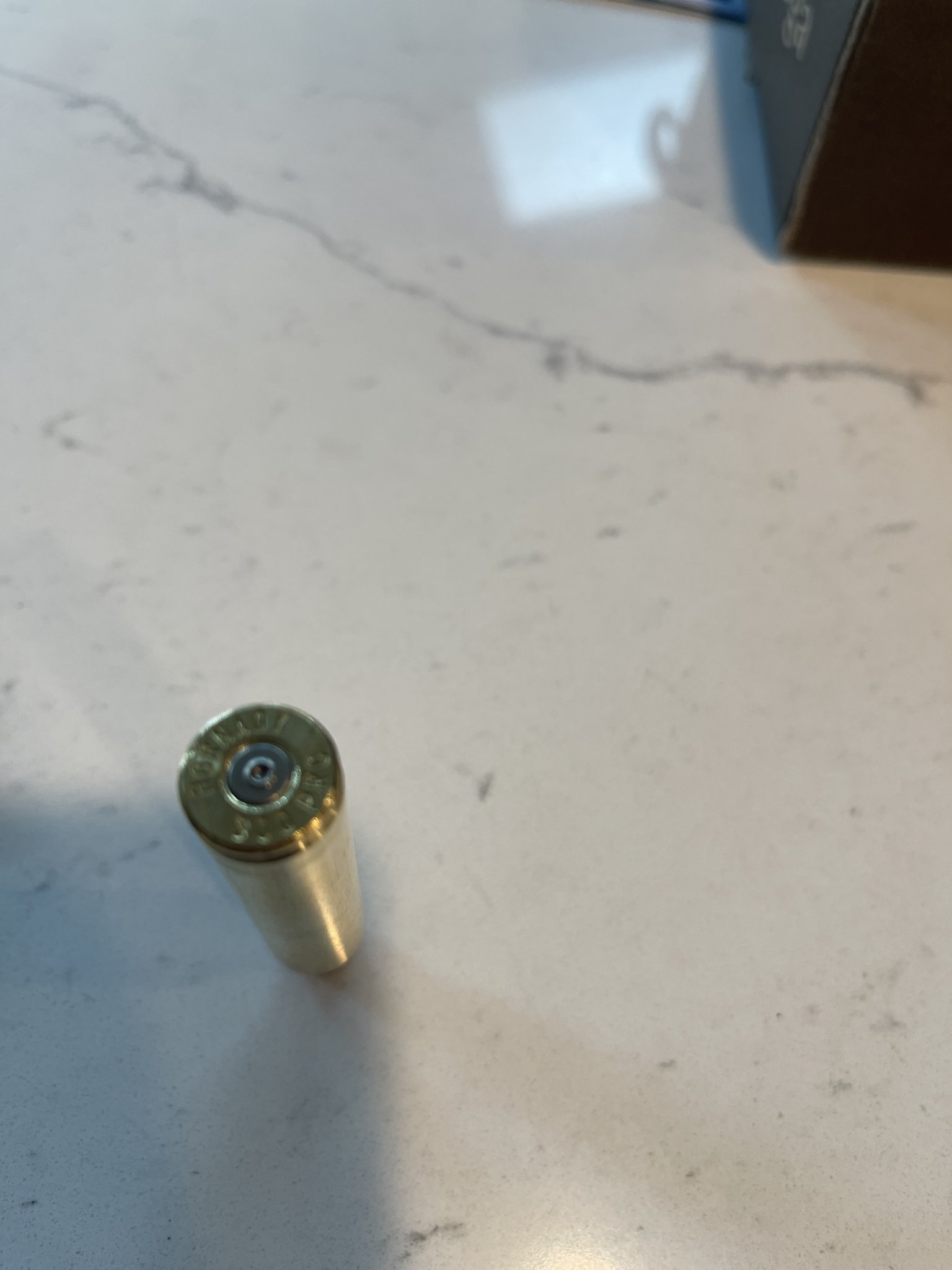

Hey guys, need some pro advice. I just got a new barrel for the SRS A1. Breaking it in and cleaning every round as usual.
Little hiccup. It’s blowing primers out with factory Hornady ammo. And I mean BLOWING them out.
Massive cratering and piercing. Some primers were stuck in the bolt, some would fly out when spent shell was ejected, I think 1 got obliterated.
I shot 1 round suppressed and it seemed fine. Started the cleaning process and didn’t want to fiddle with the suppressor every round, so I shot 5 unsupressed.
Those are the 5 that were blowing like crazy and had massive bolt lift etc.
Any ideas on this? Any insight you may have is much appreciated.
Ive never had a barrel do this before with factory ammo. Barrel was cut with a Manson reamer. I contacted the barrel maker and asked for more detailed specs. Waiting on a response. Here are 2 fired brass. I need some help trying to resolve this.
Thanks
Thanks
Are you leaving solvent in the chamber after you clean? It’s an easy thing to do and could be causing the pressure spikes, especially if the first round was good.
