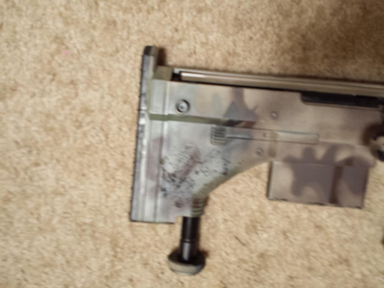

Hey guys, has anyone seen a monopod like this one before? all the one I've seen has a really thin rod. I'm in the process of buying a used DTA SRS Covert, just want to make sure it's a legit gen2 since the guy who's selling doesn't really know. He says he got the gun recently from a friend. I'm pretty sure that all converts are gen2, is that right? thanks for your help
Thanks Orkan, I don't have the rifle yet, just some pictures. I'm hoping to join the owner club soon. How do you guys like the Horus h37 reticle btw? anyone using it with the DTA SRS? From what I've been reading here on the hide it's either love it or hate it.

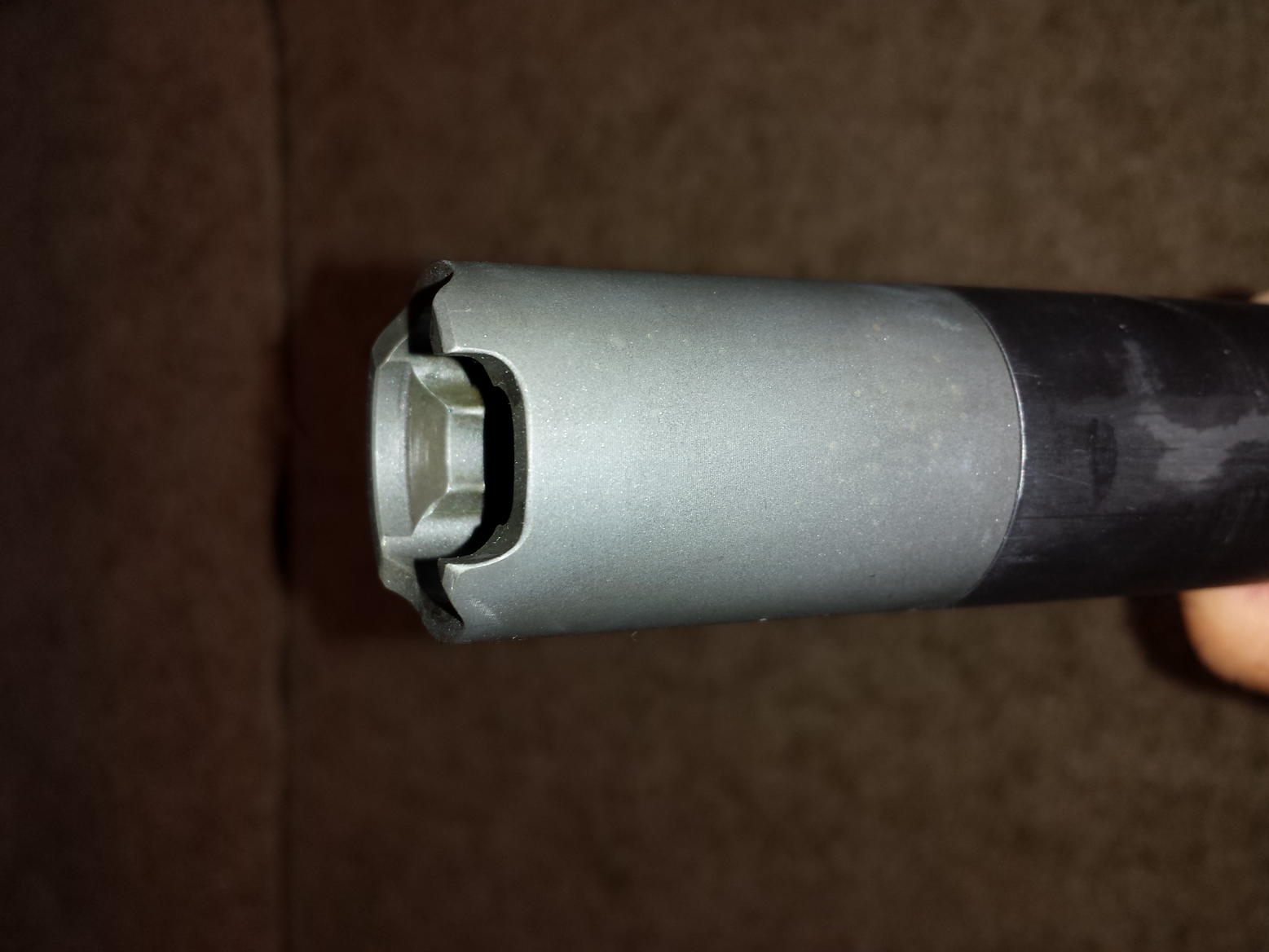

That's what I've being hearing about the horus, the scope is an amazing deal otherwise. I asked the guy to take a picture of the barrel extension and send it to me and it definitely looks like a gen2, can someone please do me a favor and confirm?

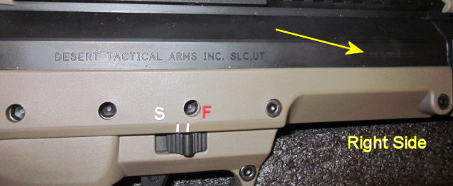

I've also asked the guy what the serial number is for the rifle, he said he's new to the rifle and he couldn't find it because the rifle was painted over with multicam, can someone let me know where the serial number is located so I can tell him to look for it? thanks guys for the help!
Serial number, at least on the gen 1's is right above the front edge of the skins just behind the handguard on the right side of the receiver. Above and forward of the trigger.....
Gen 1 extensions have a little tiny slot in the bottom of the rear end. It doesn't go all the way through. If you see one you'll realize its possible to tell a gen 1 from a 2 for at least a mile....obvious when you know but not when you don't.

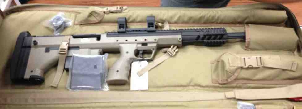

dude I would not be able to sleep I'd sit in the gun shop watching and saying "your going to be mine very soon just nine more days" Ugh dude that sucks, its like being a dog on a chain with someone holding a nice juicy steak just out of your reach.
After a while you kind of get used to it, as pointless as it is. CA shooters refer to it as "being in jail" actually and since you're 14, I'll fill you in on the why. It was instituted back decades ago as an attempt to hinder people from buying a gun with the intent of putting it to use against someone (there were cases of guys who bought a gun and then went home and shot their wife or went to work and shot their boss). That's why they consider it a "cooling off period", like that's going to prevent them from going another route. You can imagine my amazement when I moved to New Zealand and discovered that I could walk into a hunting shop, buy a rifle, ammo and suppressor, and take it home immediately after paying.
Nice to see an SRS in San Francisco :)
10 painful California days..
I surprised you have to wait 10 days from delivery to your dealer. I would have thought it would been a 10 day wait from original order date. Since you ordered this months ago, you already did your 10 day wait...
I am using reasonable logic though, not politician logic. I think you will be thrilled once you have it in hand.
