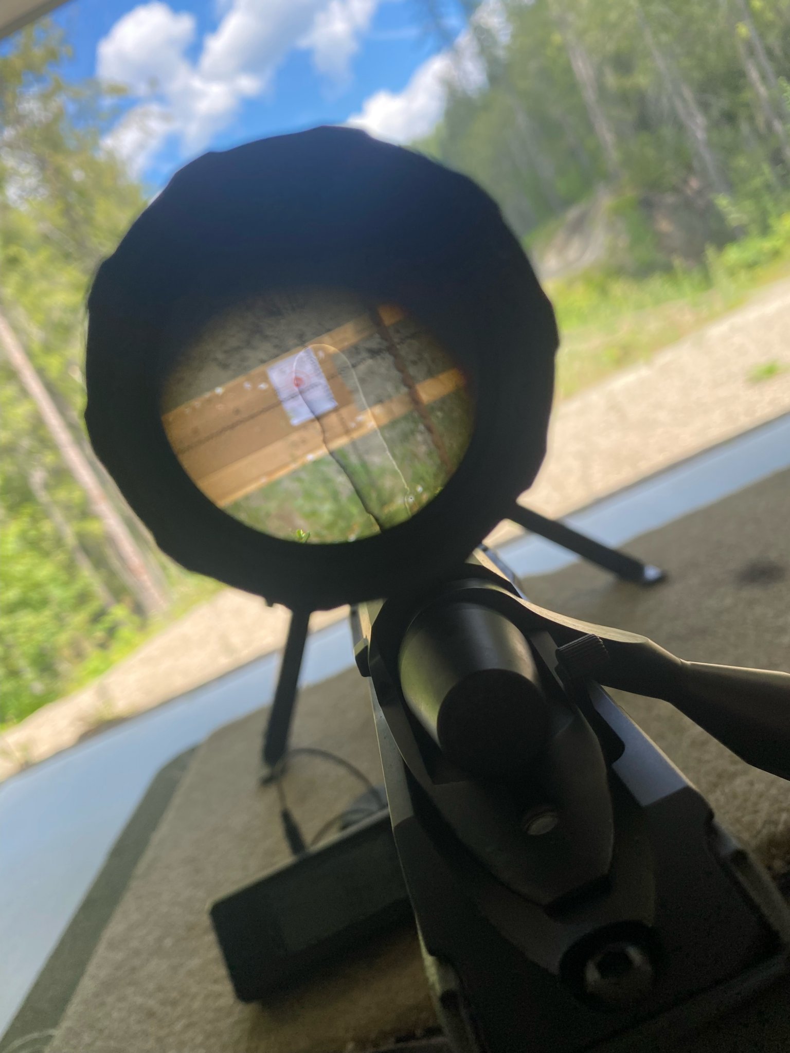

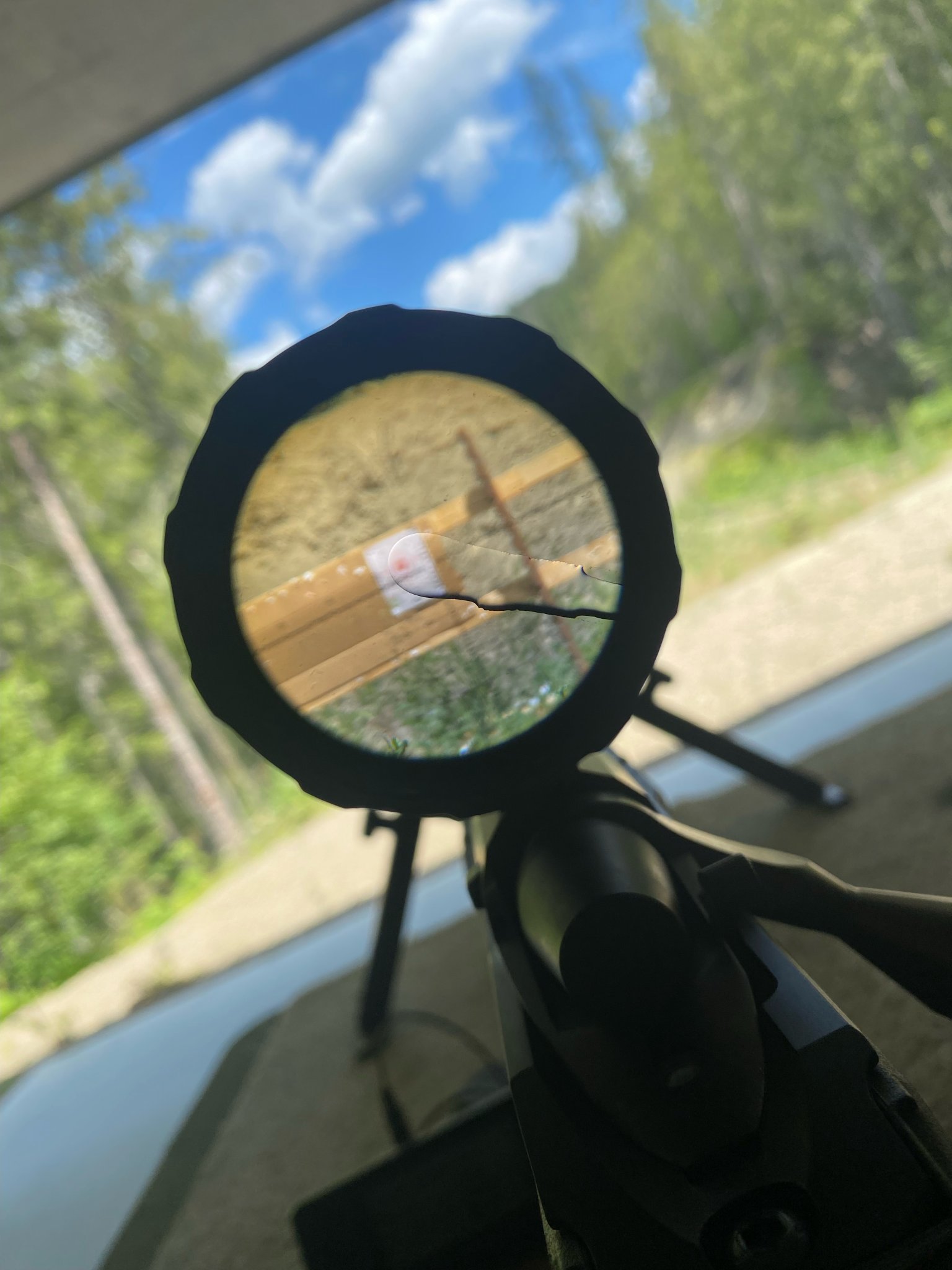

So I picked up a 5-27X a while back and it lived on my 22LR while I was building my Terminus Zeus QC 223.
Awesome scope, I have run it side by side with my 7-35X ATACR and while the glass is top notch on both the ZCO has the edge, my experience has been that in good conditions the glass difference is almost imperceivable but in trickier conditions the ZCO starts to show its class.
Unfortunately mine has developed a defect in the ocular lens (pretty sure as the defect rotates when I turn it). It looks kinda like a chunk has came out of the glass.
Anyways I have emailed [email protected] twice regarding this and not had a response. On ZCOs site there are instructions to send it in for warranty:

As I live in Canada I want to verify everything before sending (will probably cost a pretty penny to ship) but no replies to my emails.
Has anyone else send something in for repair? Or contacted ZCO regarding a warranty issue at the email address listed above? What was your experience?
  • Wow
Reactions: BCX
@Cardboard Assassin I checked that email account this morning, nothing from you in there. I haven't seen anything in spam either.
Being in Canada is a bit different but we'll work through that with you to get that taken care of. Sending you a PM.
Received - Will proceed as instructed - many thanks.
Yeah that's water in your scope from bad grease or something coming unsealed.
