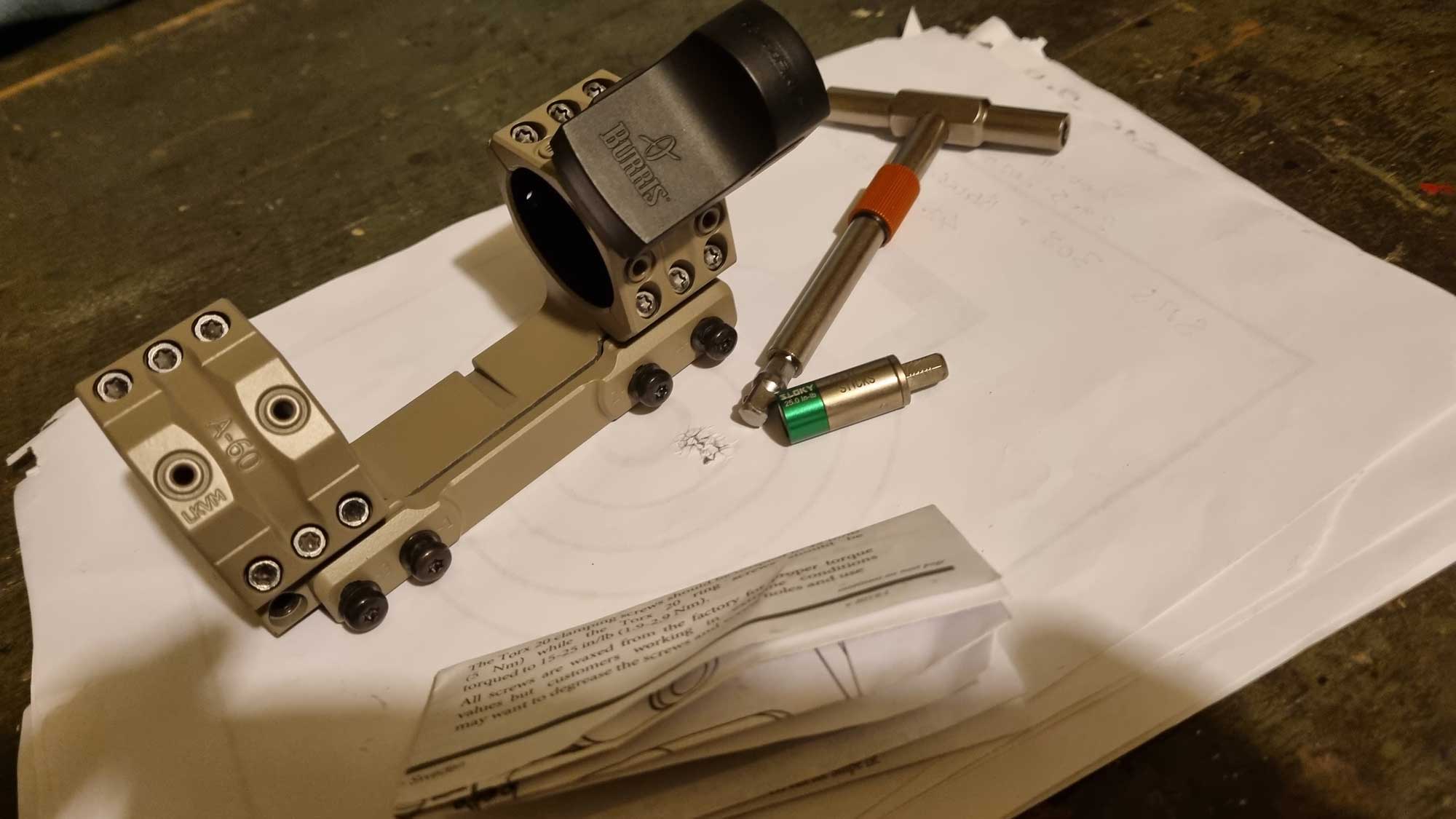

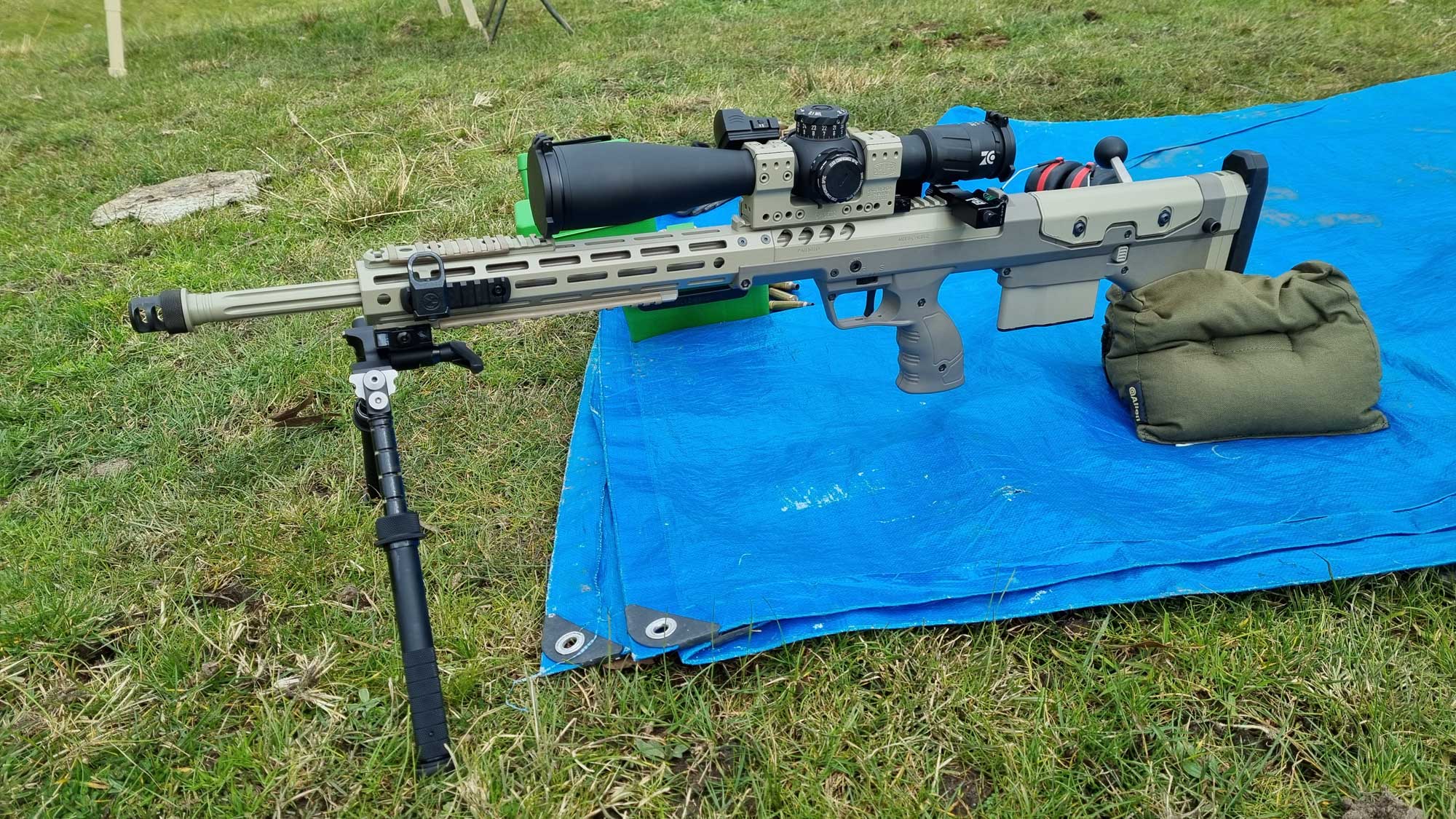

Scope ring screws were torqued according to Spuhr.s specs.

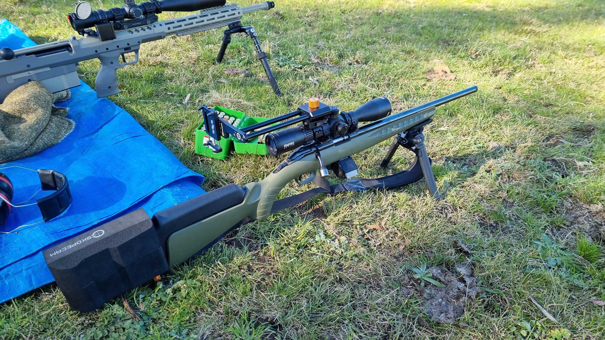

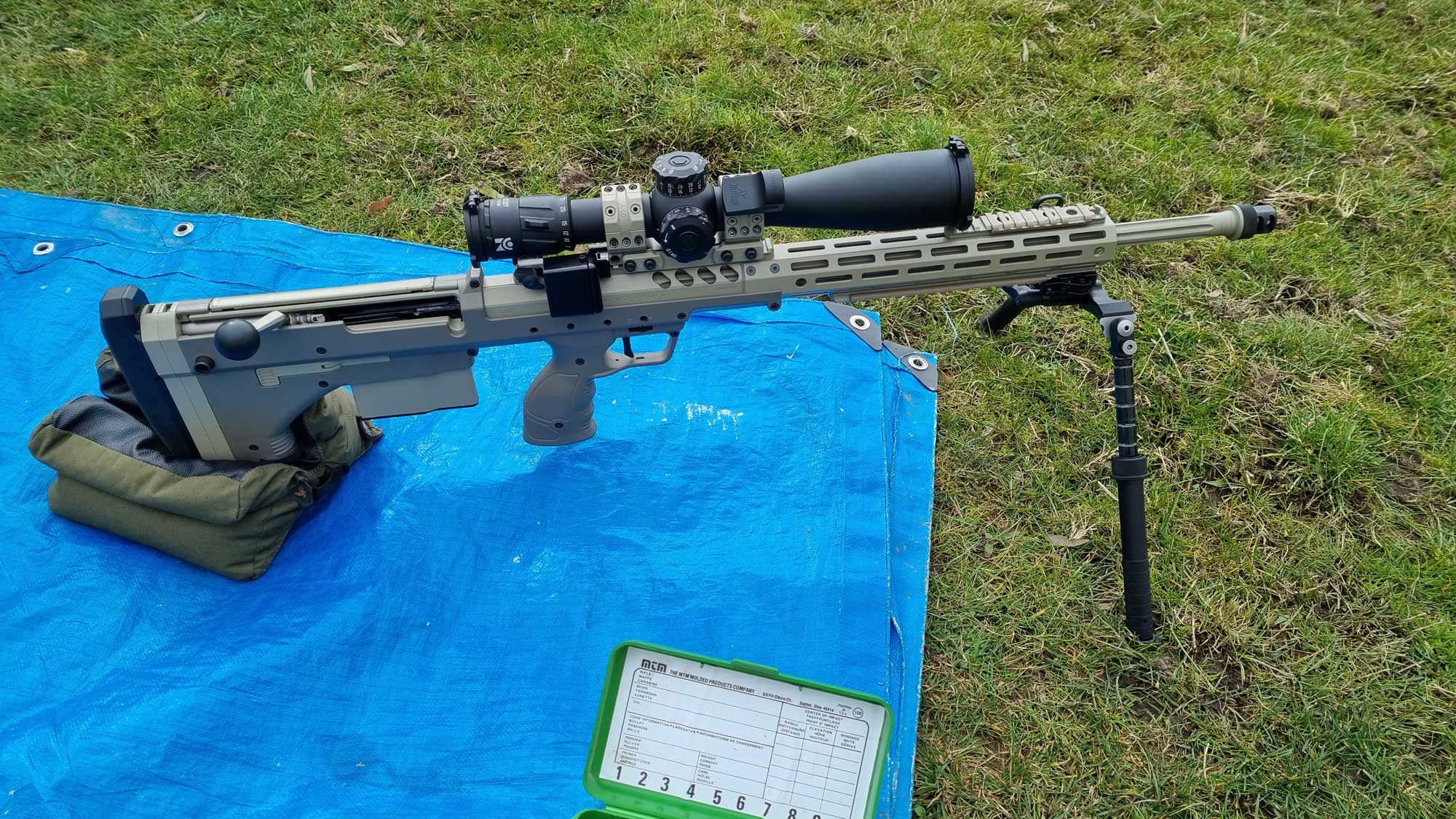

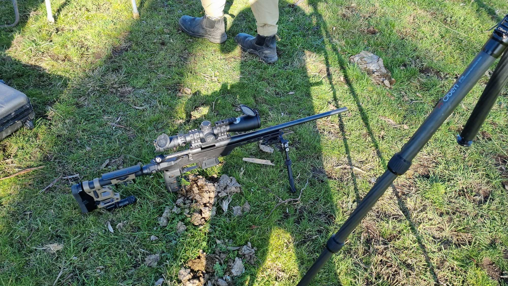

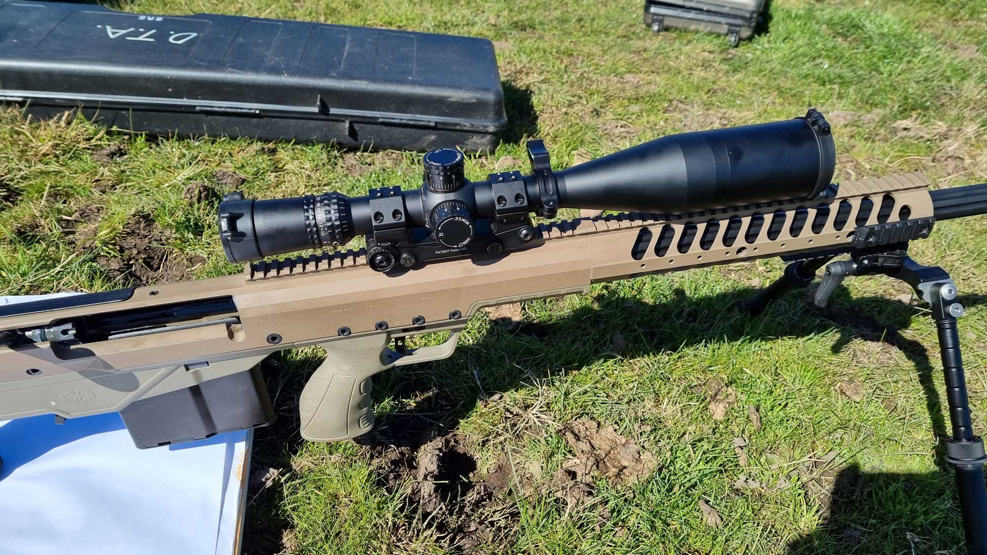

Previous day went from "one hole" groups ( SRS A2 300wm) to 2 moa!!! at 100yds
Towards the end focus would shift/jump after every shot.
Re Fitted my trusty old NF NXS and what do ya know...."one hole " groups again..
Returning the ZCO to my dealer and cancelling the 2 others i had on order..

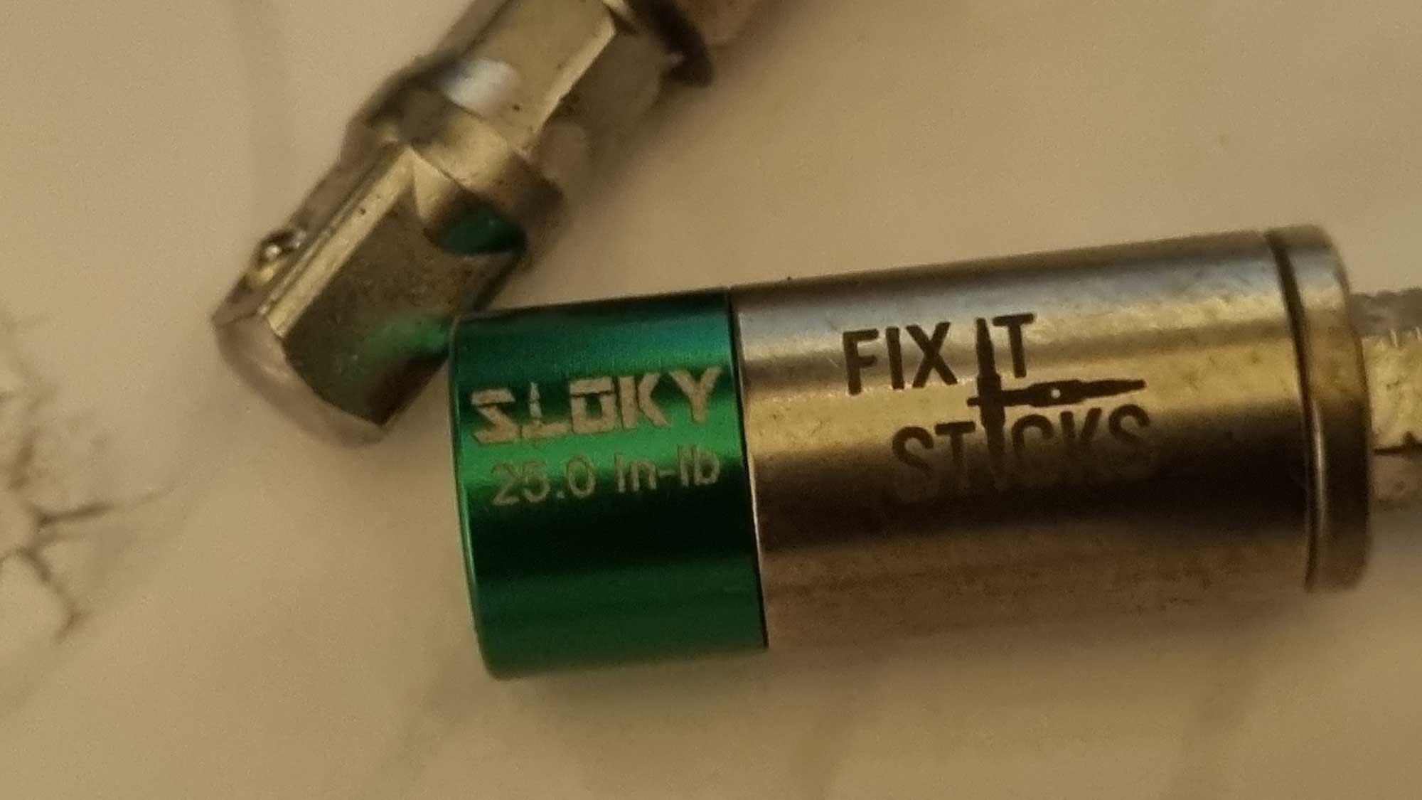

See my above post ...Screws were torqued to Sphurs specs ...25in/lb
15 is all I’ve ever used with Spuhr (still within spec), and never had one slip.
I’d be willing to bet the majority lean towards 15 vice 25.

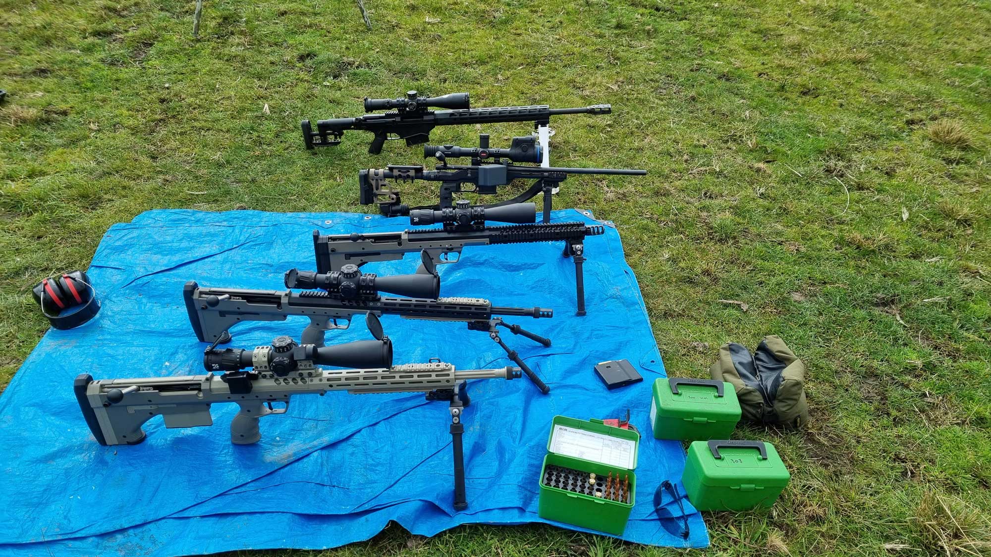

Righto..... The faulty ZCO 5-27 has gone back to my dealer. ..

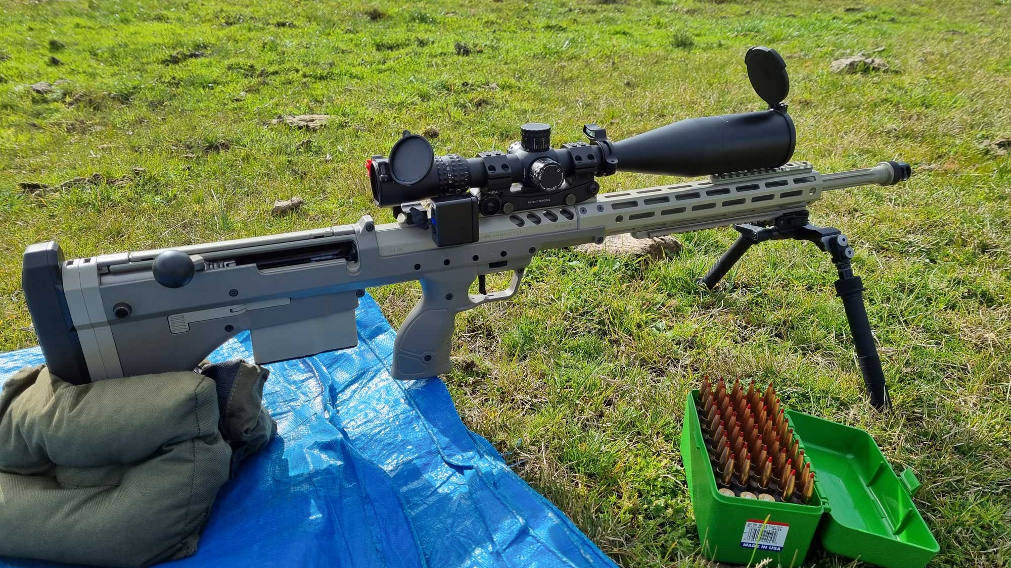

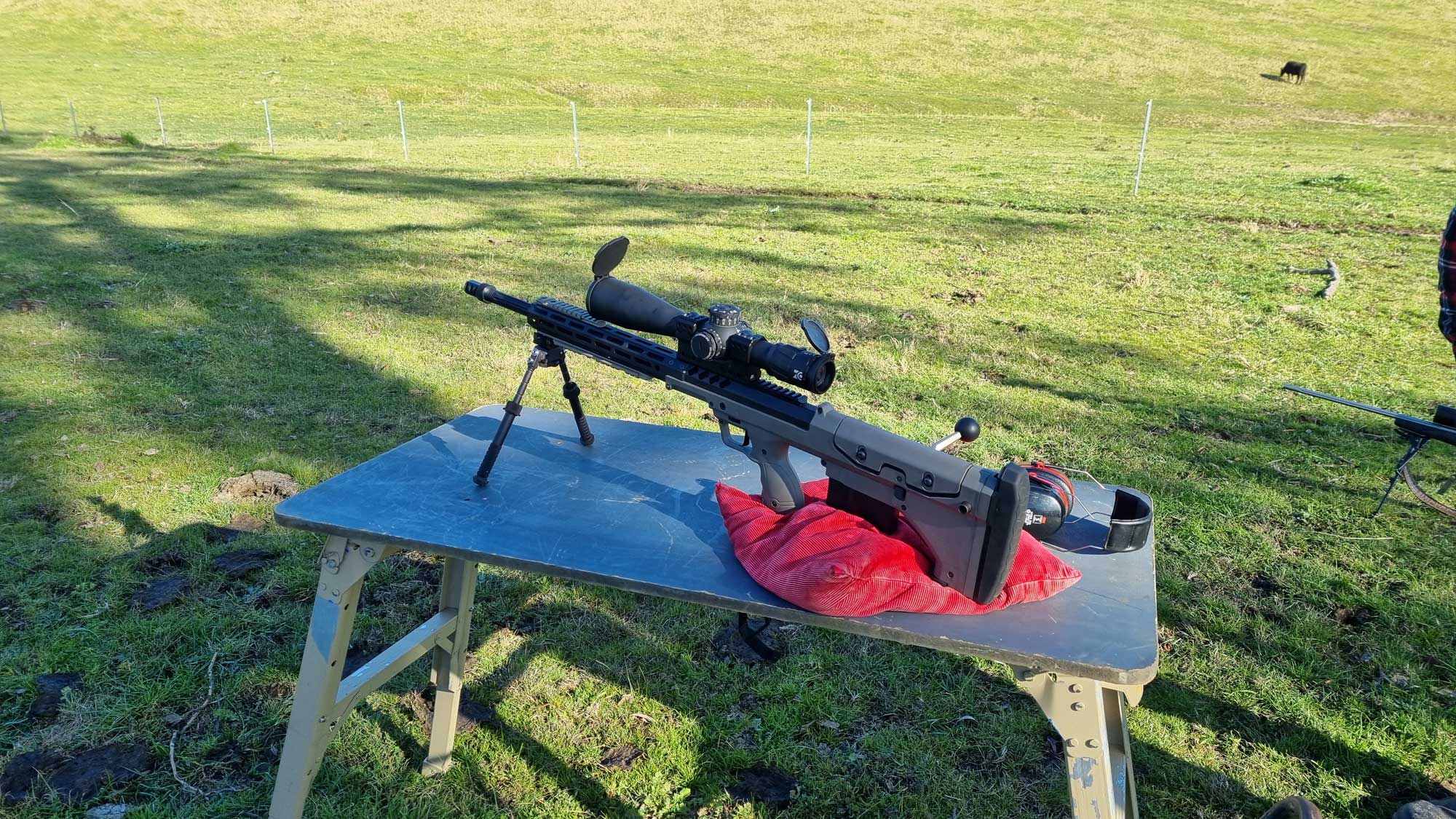

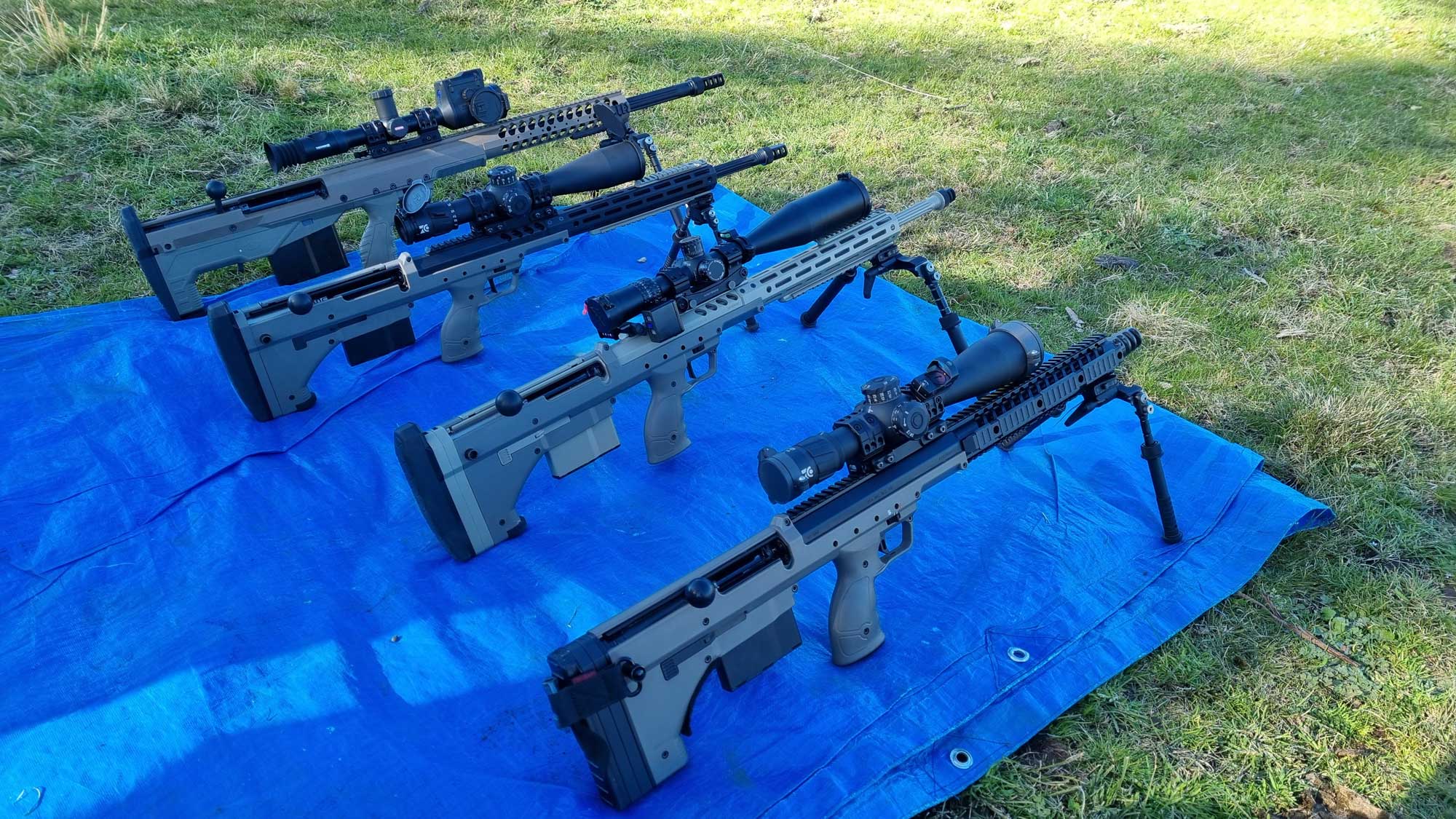

I purchased 2 more 5-27,s....one is going on the Desert Tech SRS and the other is going on the Desert Tech HTI 375ct..
Both will get a good evaluation this coming Saturday.. Lets see how they perform.

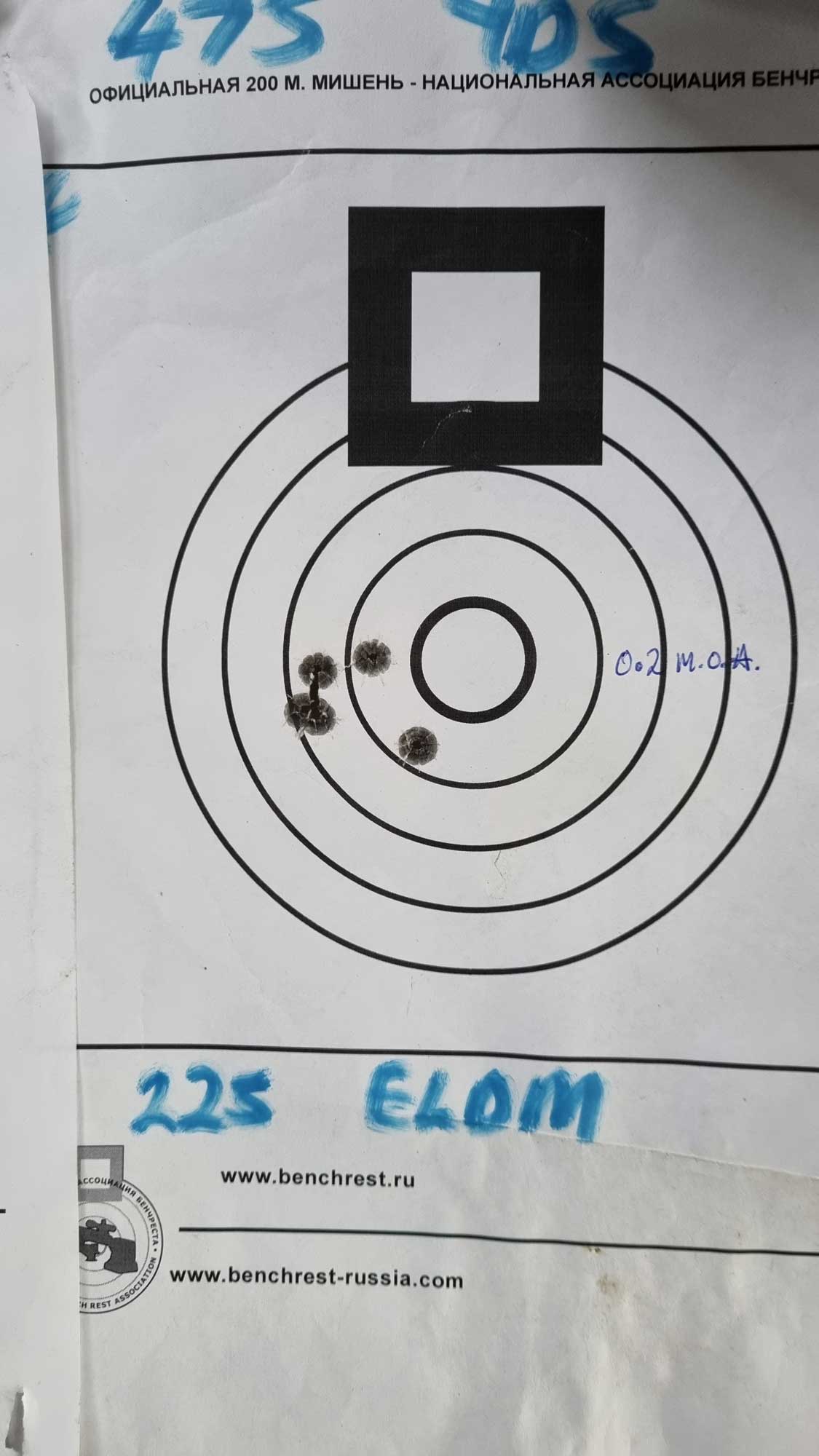

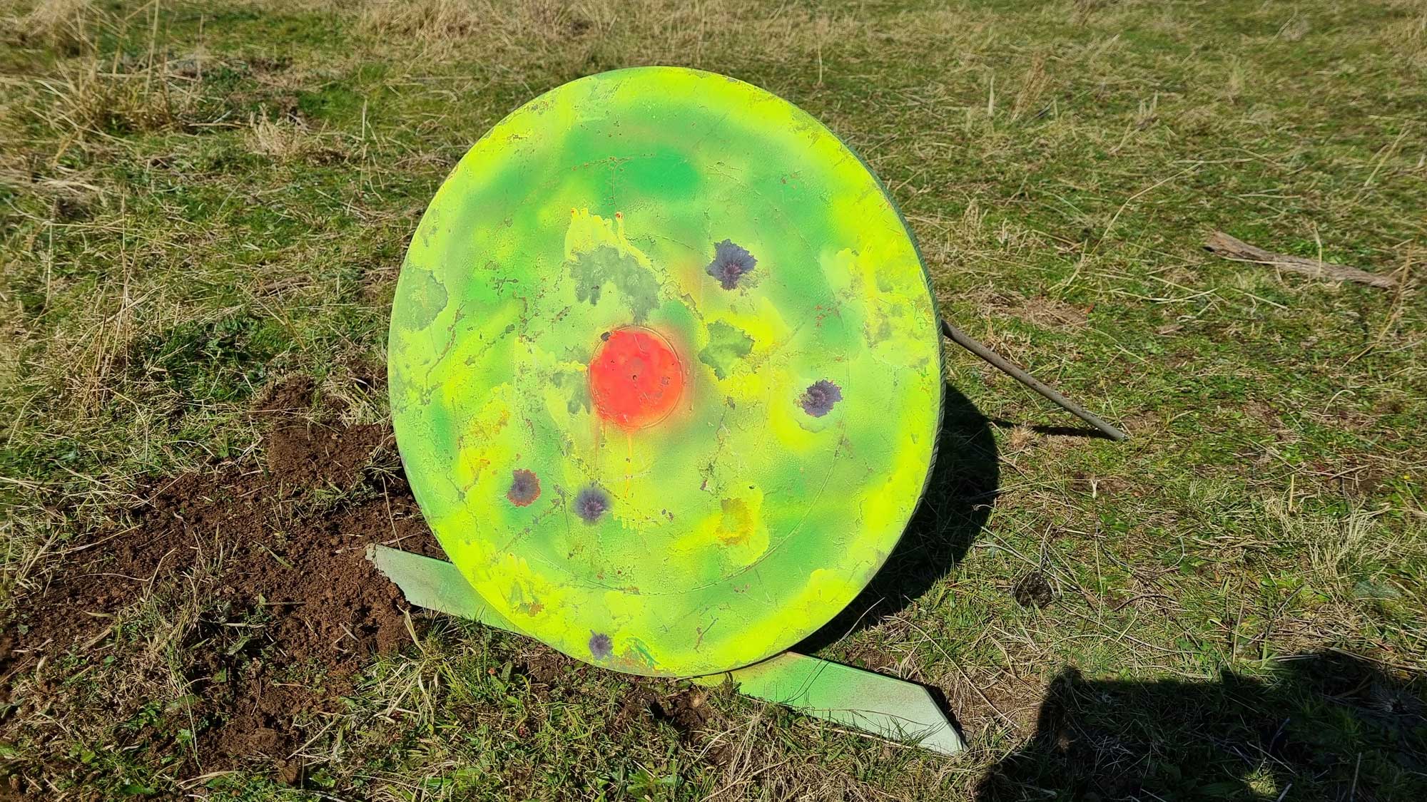

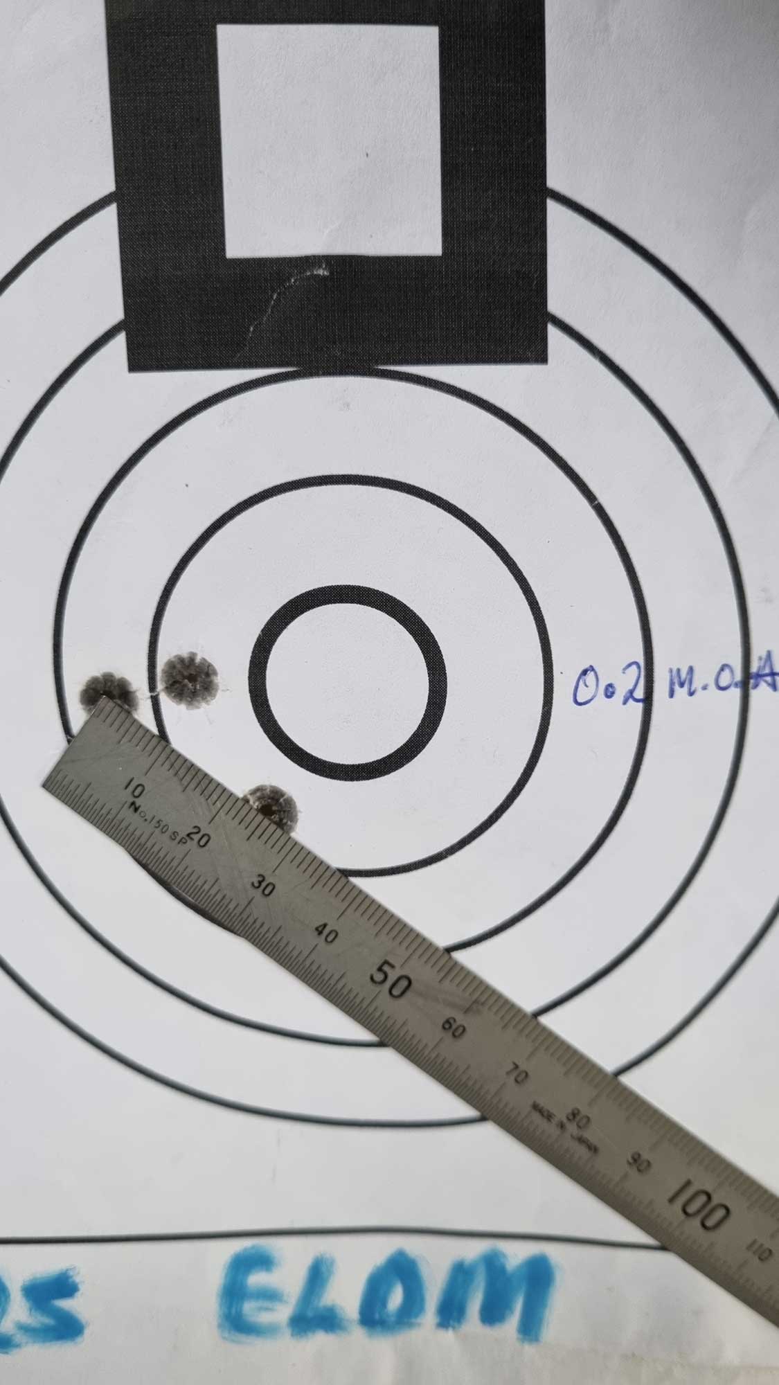

Just as a benchmark...this is the SRS 300wm with my OLD NF NXS..
Targets are 200 yds......475yds and the Orange plate is 12"Dia at 1500yds ( 5 shots)

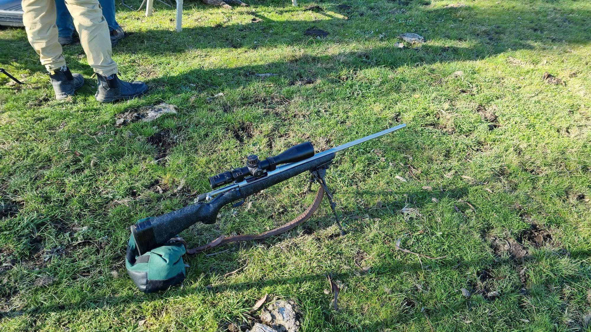

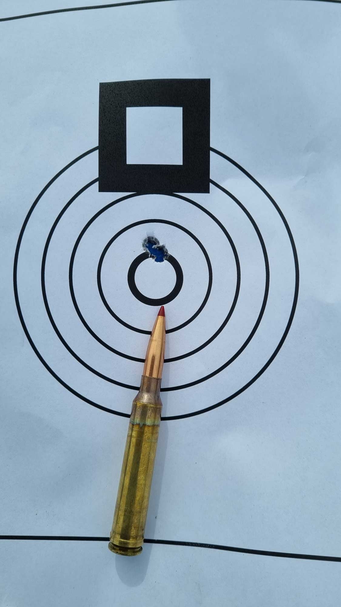

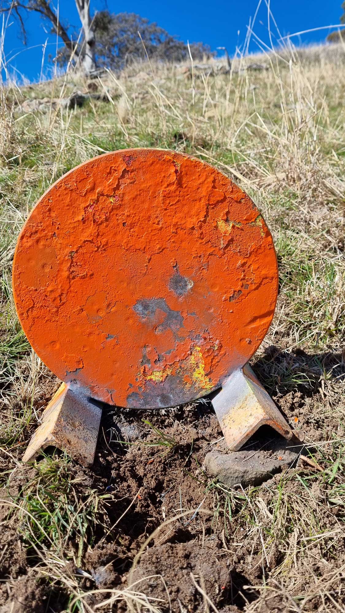

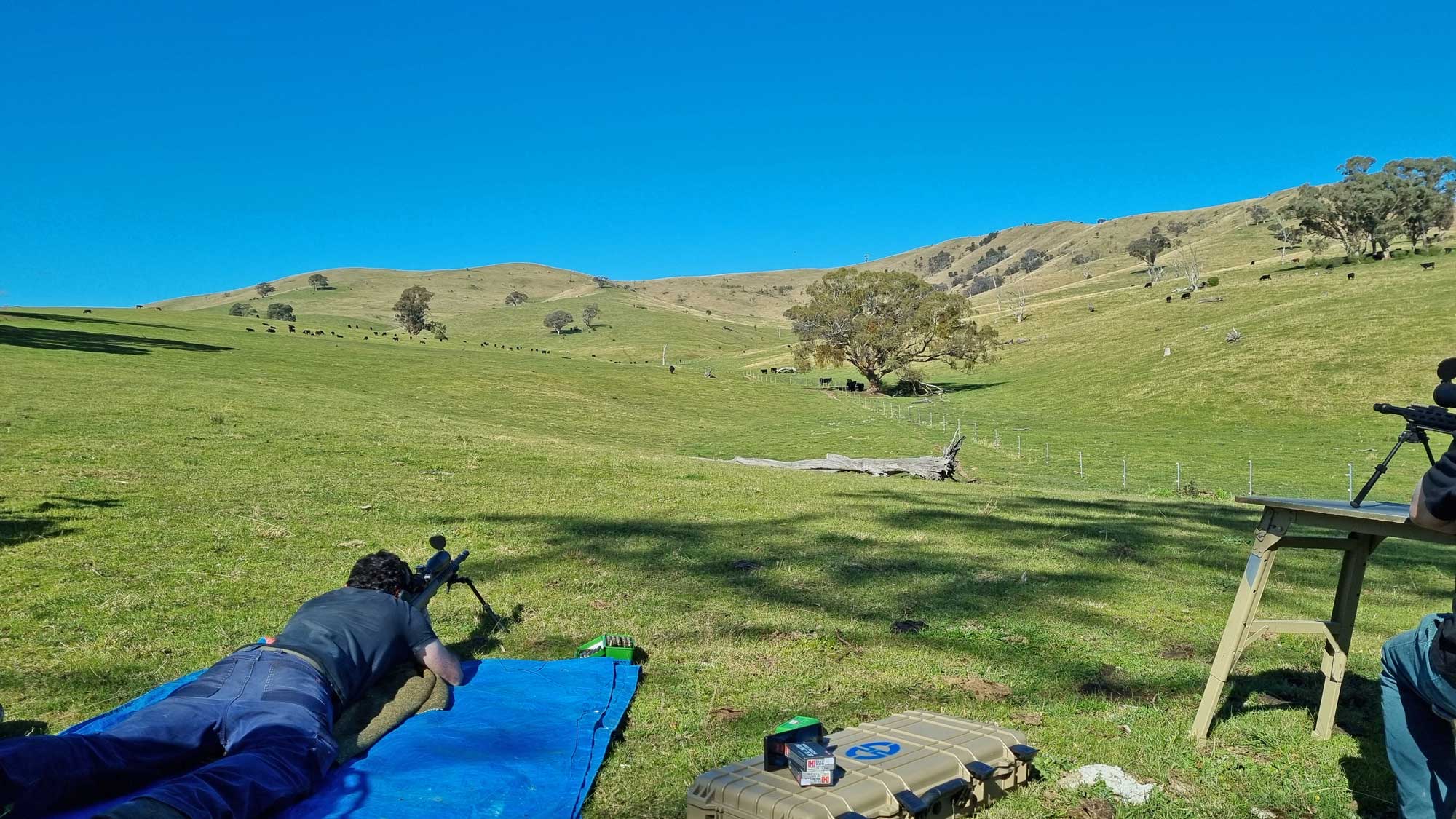

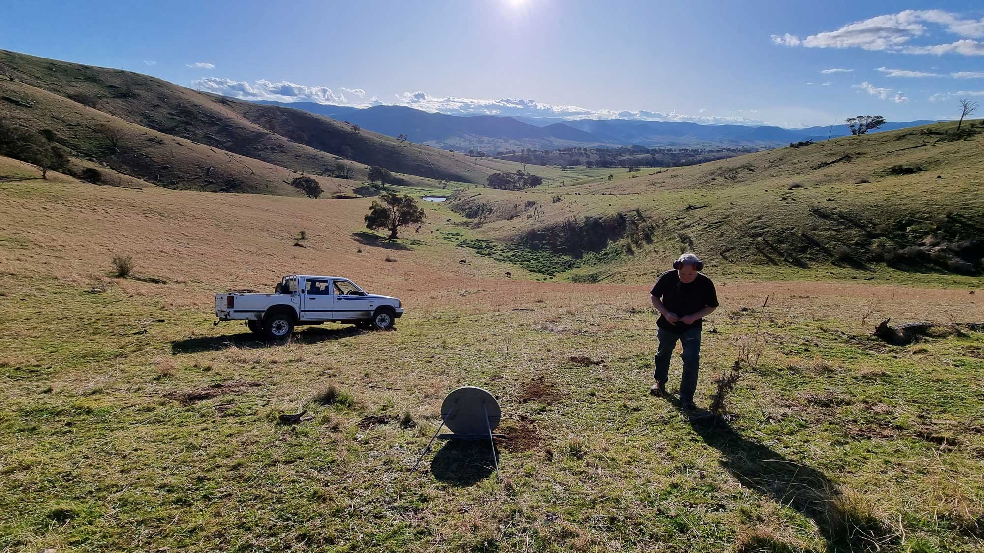

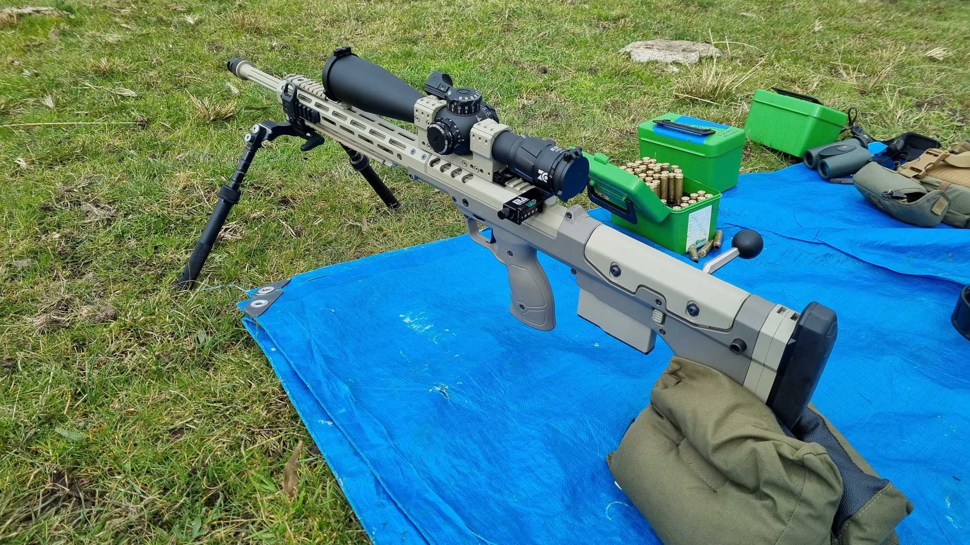

1940yds... HTI 375CT.. :)

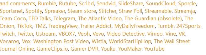

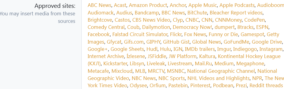

How ...can ..... i upload video,s here?
First, the video needs to be online on some selected sites:
and more
Personally, I use Youtube. Create a "channel", upload your vid, post the link here and the vid will be embedded.
As for how to post the link....look above at the banner above the text entry box. There will be this symbol
Click it and upload the link. Easy peasy
