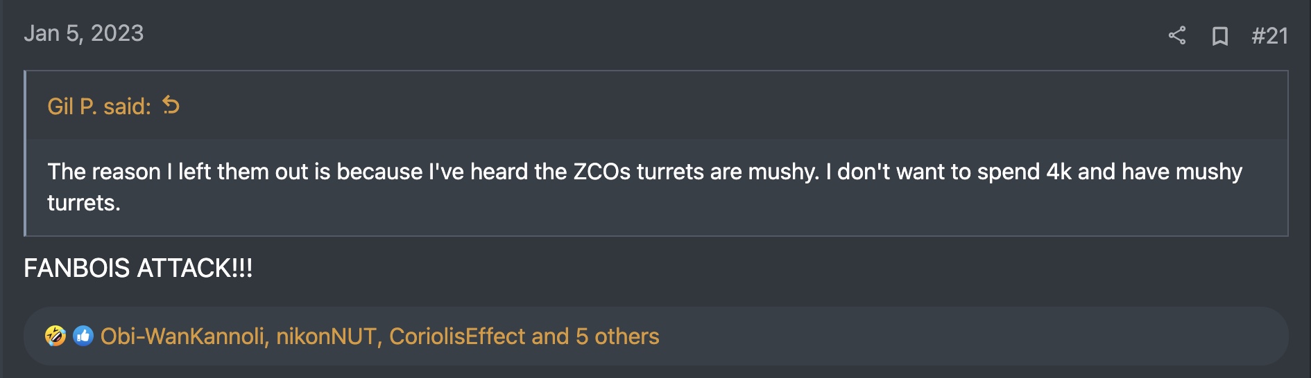

I found this on another thread: So tell me the ZCO trolls arent well known...
Isn't this the one that on the other thread we were calling
Compromised Zero Optics
Cant Hold Zero Optics
Changing Zero Optics
Chasing Zero Optics
Hahaha, I think that's some funny shit, and only just now did I edit after I realized that there are some disputes above here.
Which makes me feel obliged to weigh in: Zero compromise to me means zero. Not just a little bit, but, like.....zero.
So I'm not surprised when there is one little more than zero compromise with a guy's ($4000) scope, he's not happy.
That's why Can't Hold Zero Optics is funny, LOL!

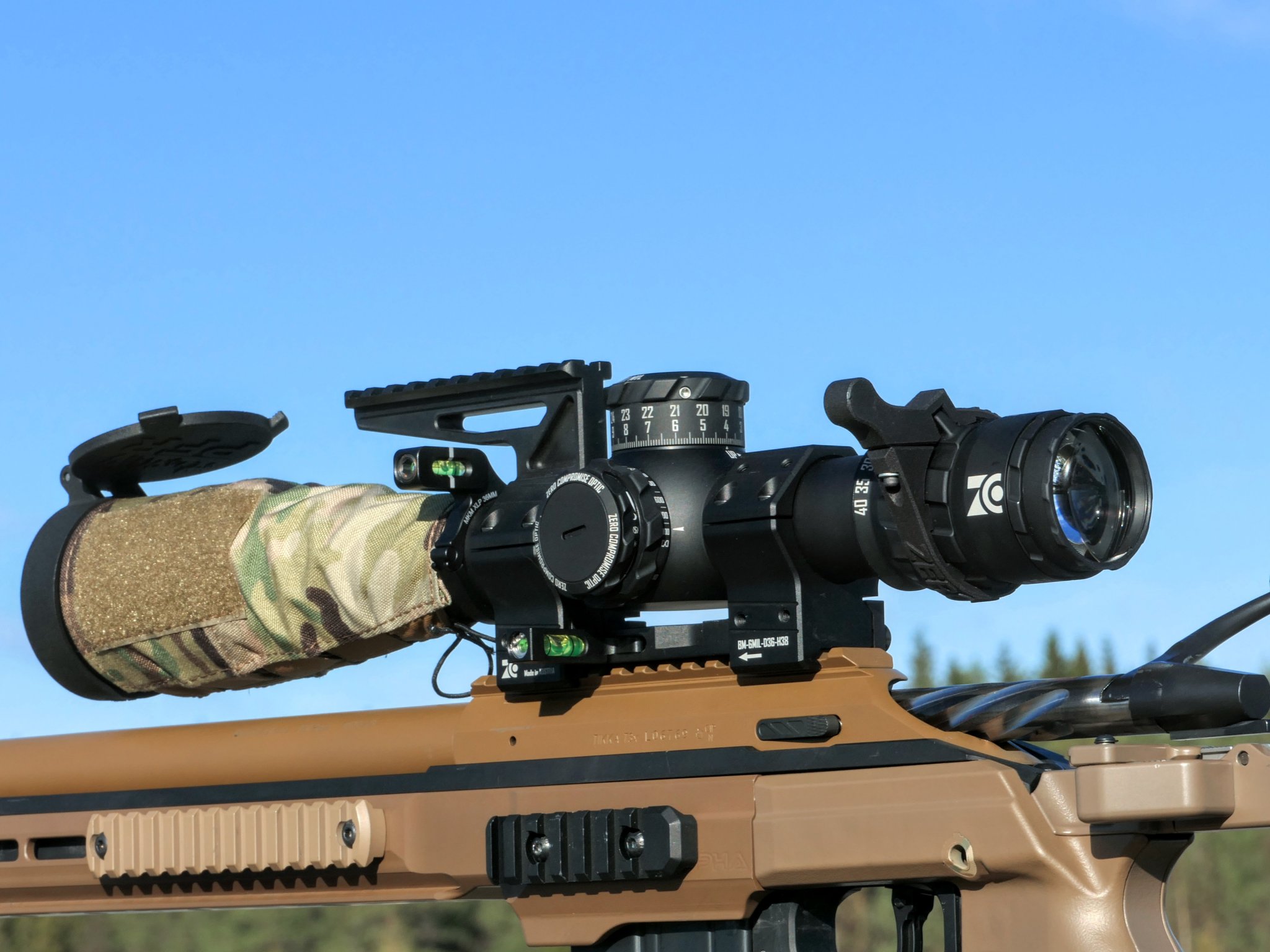

How about give a try to the ZCO Block mount?
Made in Austria, like the scope, with the specs of the scope.
That's what i bought from CSTac.. Will be here tomorrow with the scope... Thanks to CStac and Jeff at ZCO for the expedited shipping so i can have them both for the weekend..
I bet you are going to like it :)
It has lot of features.
Like integrated buble, heat mirage sling hook, and when you mount it, the key that makes the scope body in to the same level as the mount.
I did use 2,2Nm on torq when mounted the scope, it has not gone anywhere, even it can put to 2,4Nm, but much is too much, and you can damage the parallax, if it is too tight on the mount, unless it is a 50 cal rifle you are going to mount the scope.
Reactions: HTI-416

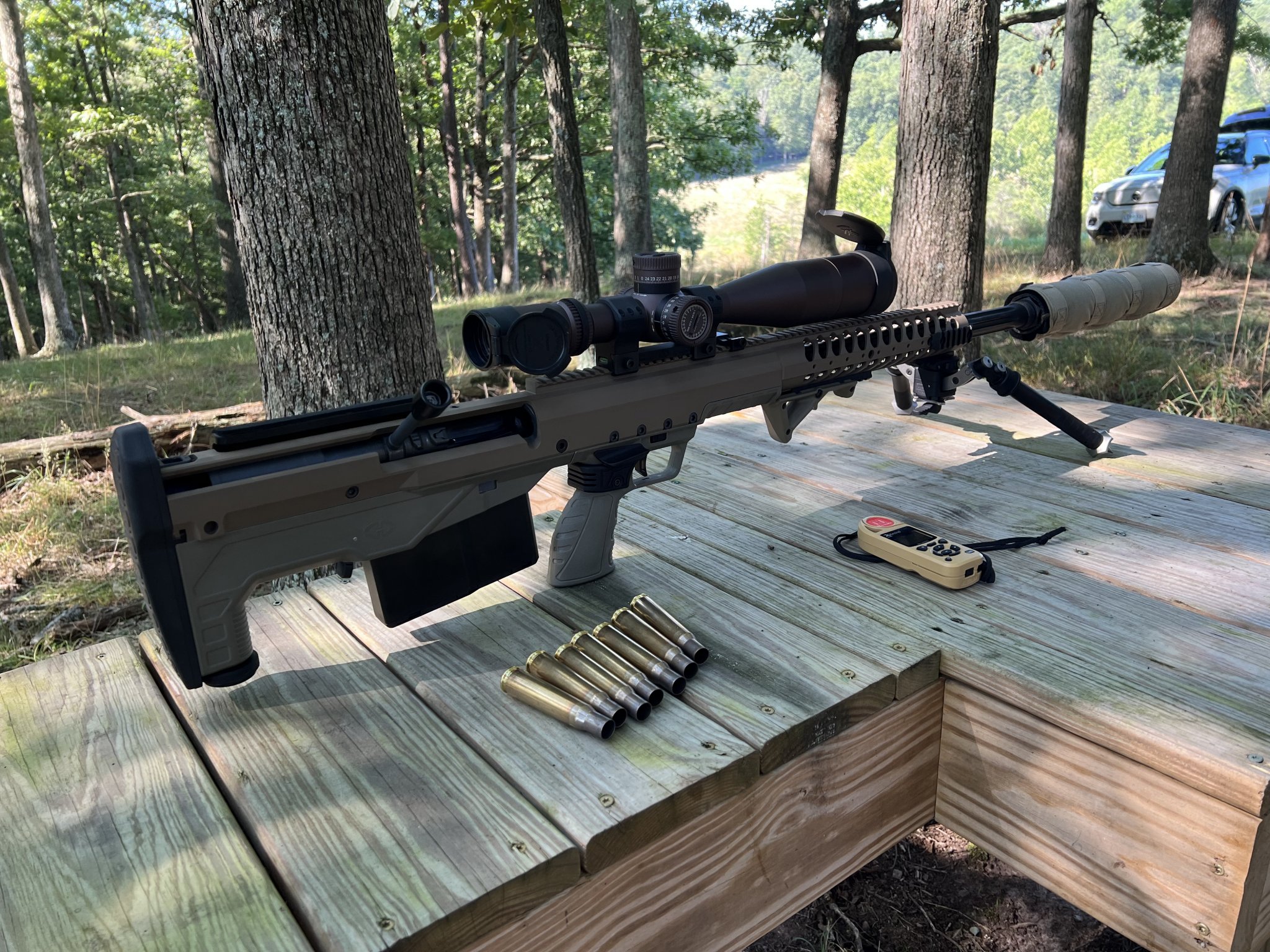

I have a 50 BMG, this is going on its little brother the .416... The recoil lifestyle is one i apparently like..
50 BMG with Razor G3
.416 with old scope...

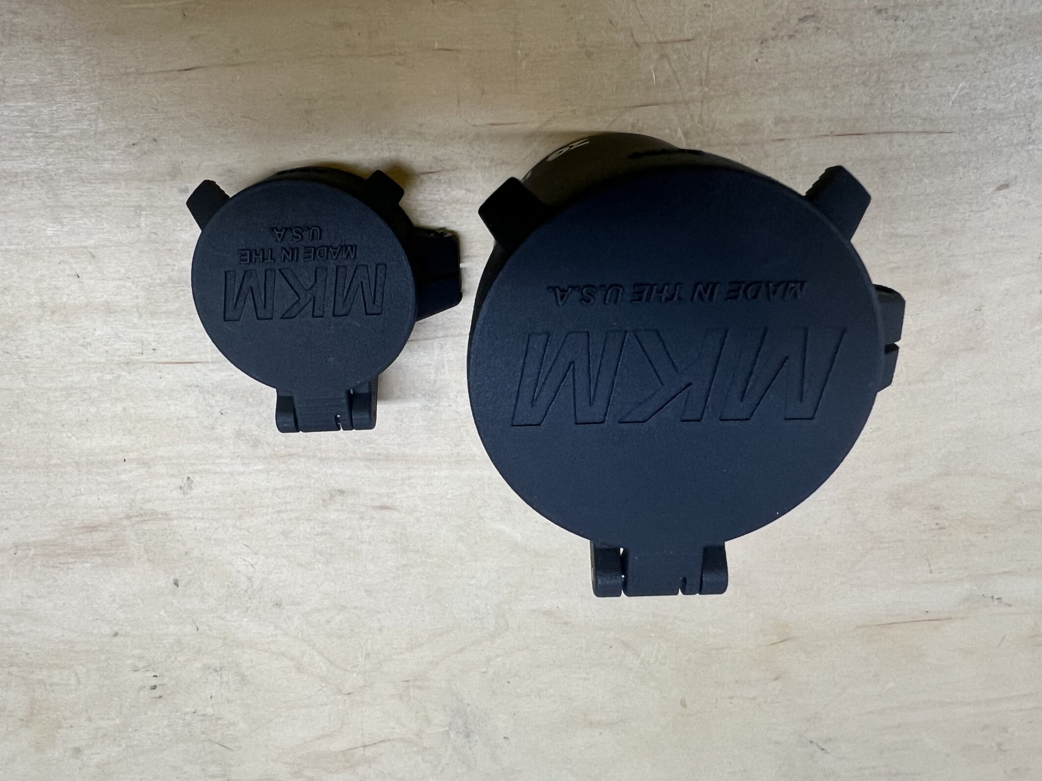

Anyone want a set of MKm caps for ZCO 840 and a ZCO sunshade let me know.. FREE!!! No warranty, there FREE!!! I'll pay snail mail shipping.. Shade slightly discolored from Scope Tape, it will probably clean right up with cleaner, but not sure..
