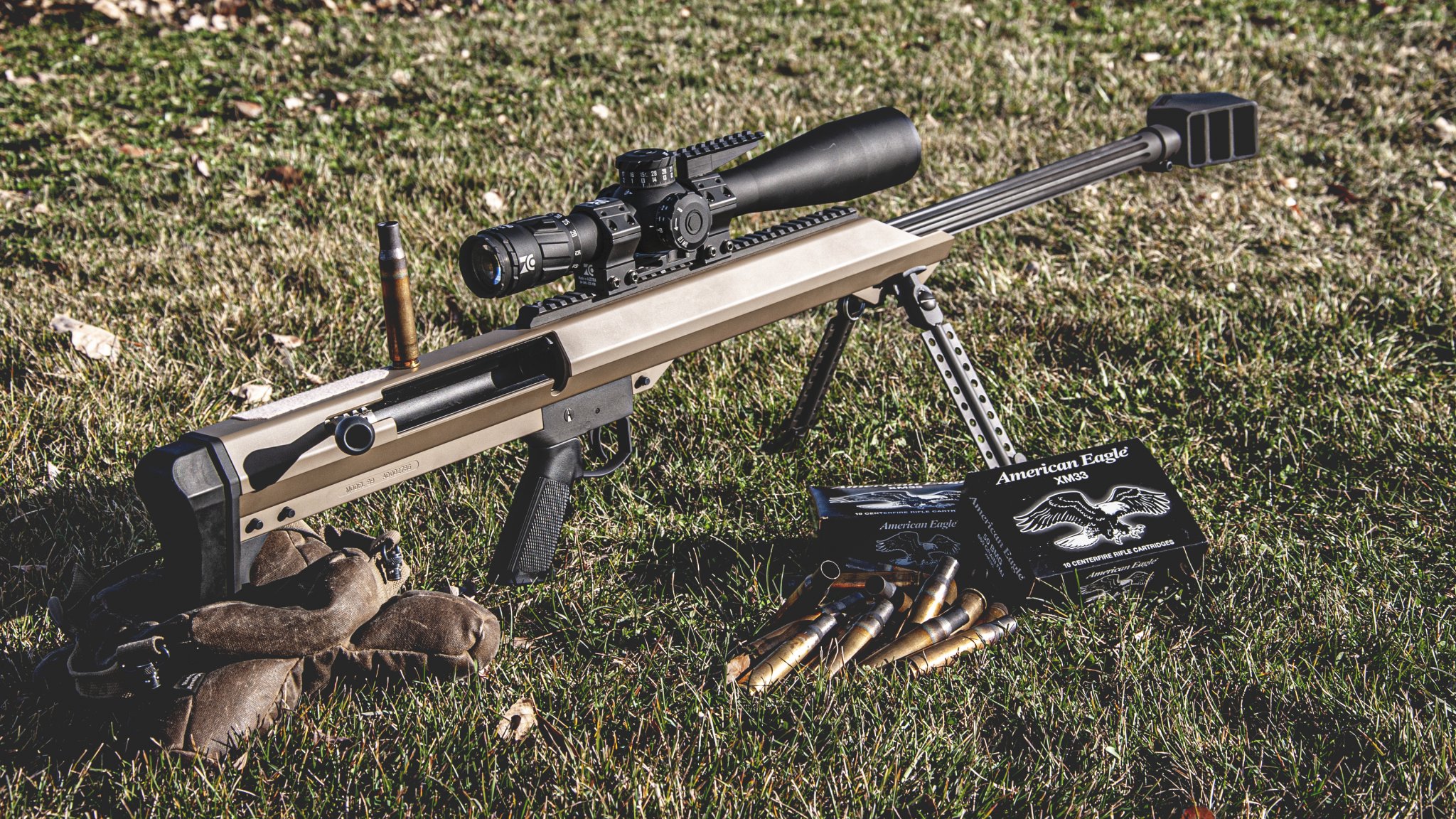

I believe this was with a 8-40 on a large magnum gun and, at least for the first scope, the member felt it wouldn’t hold zero and would wander shot to shot.
To the best of my recollection

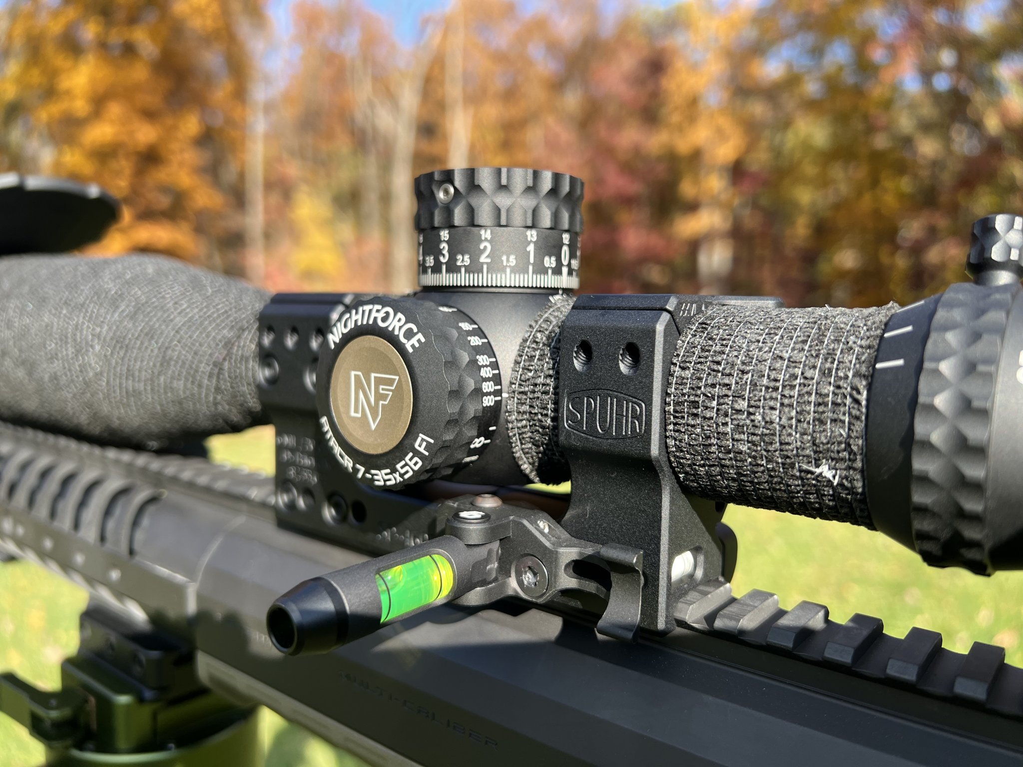

I ordered the ZCO mount as recommended for the replacement optic, followed the mounting instructions I received on the phone right down to 18 inch lbs and 20 inch lbs on the ring screws, even spacing with no metal to metal on the ZCO mount and there was no change to the results.. In fact the results were worse than the first scope..
NF instructions, 25 inch lbs on ring screws and 45 inch lbs on base screws / 10 rounds to zero..

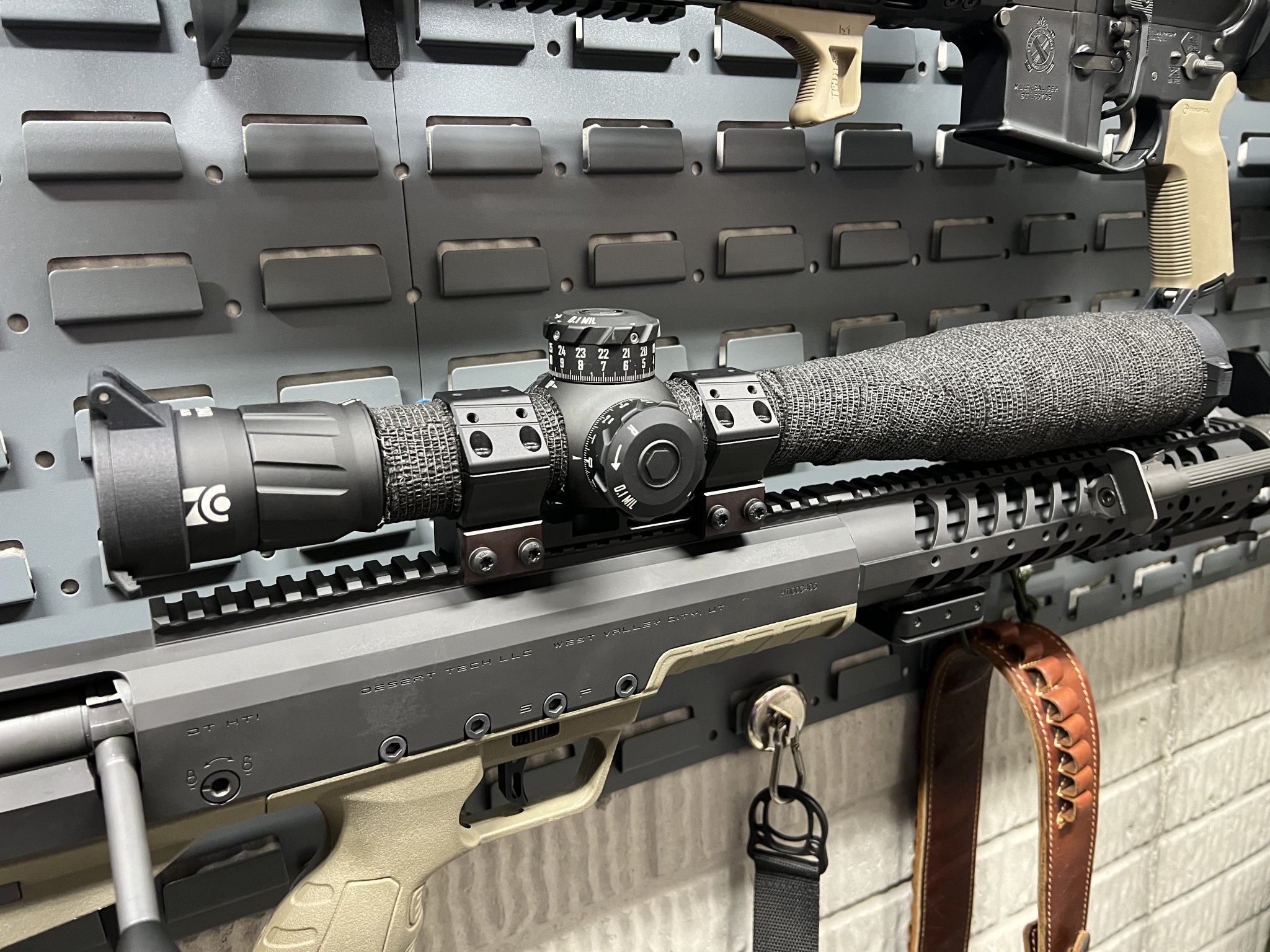

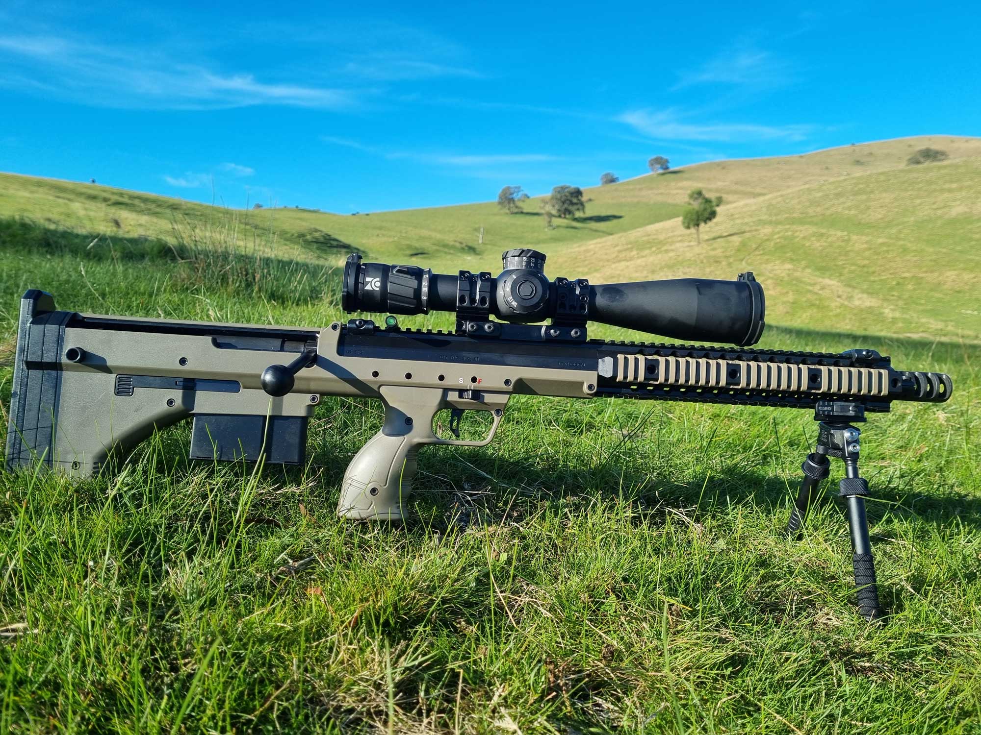

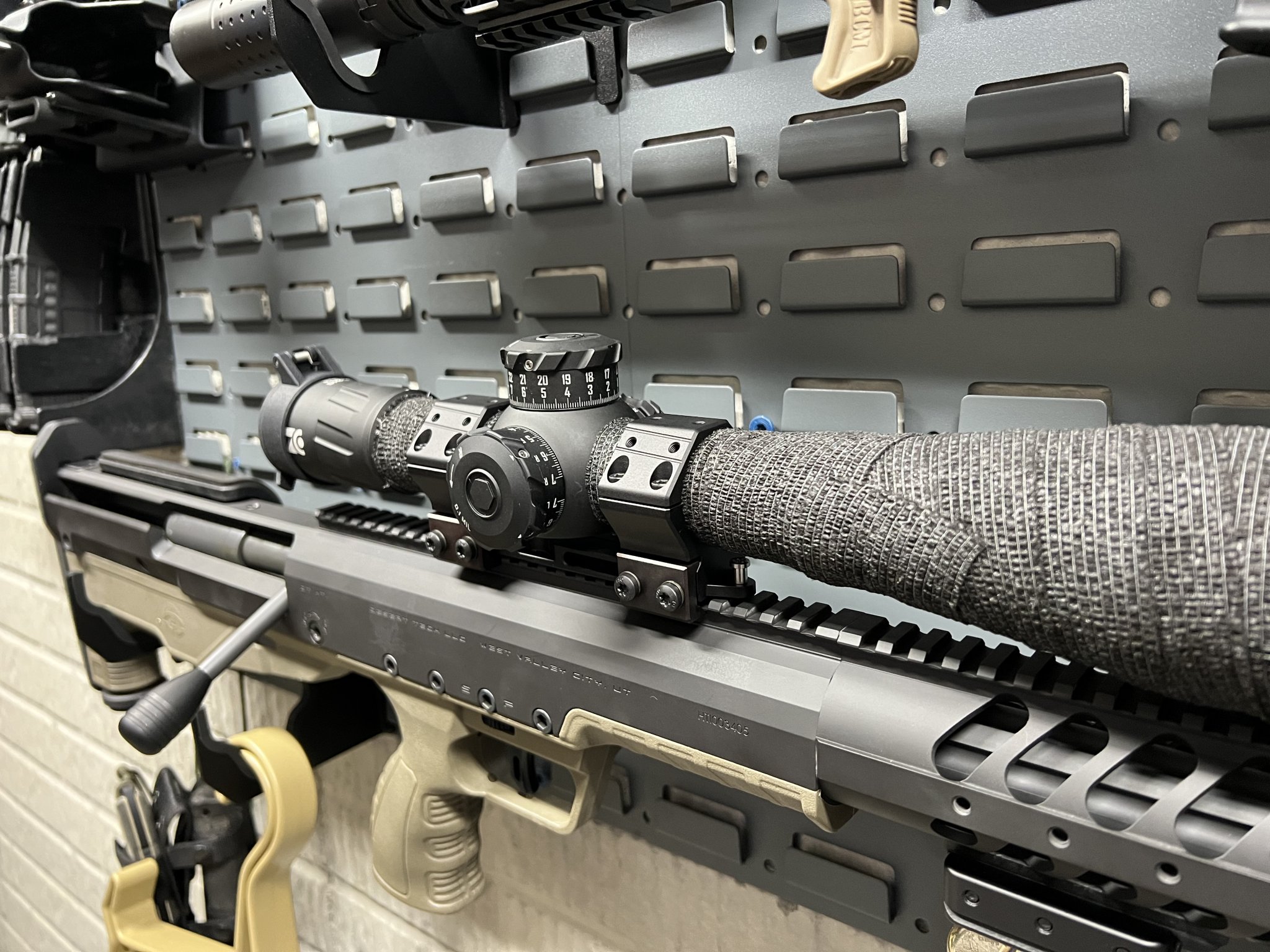

A young friend who purchased my old Gen 1 SRS Desert Tech 308 win / 338 lap and ZCO 5-27 has had no issues whatsoever , i shot many many rounds with that combo and my friend has put quite a few through it as well .... Scope and rifle are still performing Superbly
